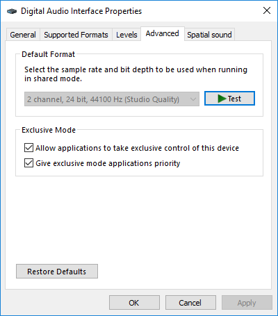

Here it is. Is there a newer firmware for MkII that works with Windows 10 UAC2 driver?
Ok, I see there were some updated drivers with Win10 UAC2 support. I flashed awx_20170830_mkII_RC06.elf and now I can select between two sample rates: 48 and 44. But whatever I set is again fixed during playback. Switching does not seem to happen in Foobar and again there are no clicks. Scope shows whatever sample rate I set in the advanced tab (44 or 48), but is not affected by sample rate of the flac file itself.
That is because most audio interfaces in most operating systems will pass the audio through a sample rate converter. They do that for two reasons:
1 - They believe the highest sample rate declared by the DAC is always the best
2 - They tell the "pling-you-got-mail" generator which sample rate to use when that signal is mixed in with your audio
Various OSes have different ways of dealing with this. In general, ASIO handles this very well. But the Windows ASIO drivers needs a rework. On Windows, WASAPI exclusive is the best choice, but in f2k you need to intstall a plug-in WASAPI interface.
On Mac I believe Audirvana solves a lot of it but I'm not sure. On Linux you can configure various audio solutions to skip sample rate conversion.
iOS is actually best in class of the OSes I have tested. It tends to use the music's sample rate. On Android I haven't yet found workarounds.

Thanks. I installed WASAPI component in F2K and now it does not play at all anything other than 44.1K. I'm getting this:
Unrecoverable playback error: Unsupported stream format: 192000 Hz / 24-bit / 2 channels
Tried both push and event wasapi, with all bit settings (16-24-32).
I'm totally stuck here. Foobar's WASAPI refuses to play anything above 44.1KHz with this dac and with Windows UAC2 driver, almost as if firmware does not support it. I tried many other firmwares with same result. Nothing in google search either. Same hardware worked perfectly fine with previous Windows 10 version and old ASIO driver, before creator's update.
