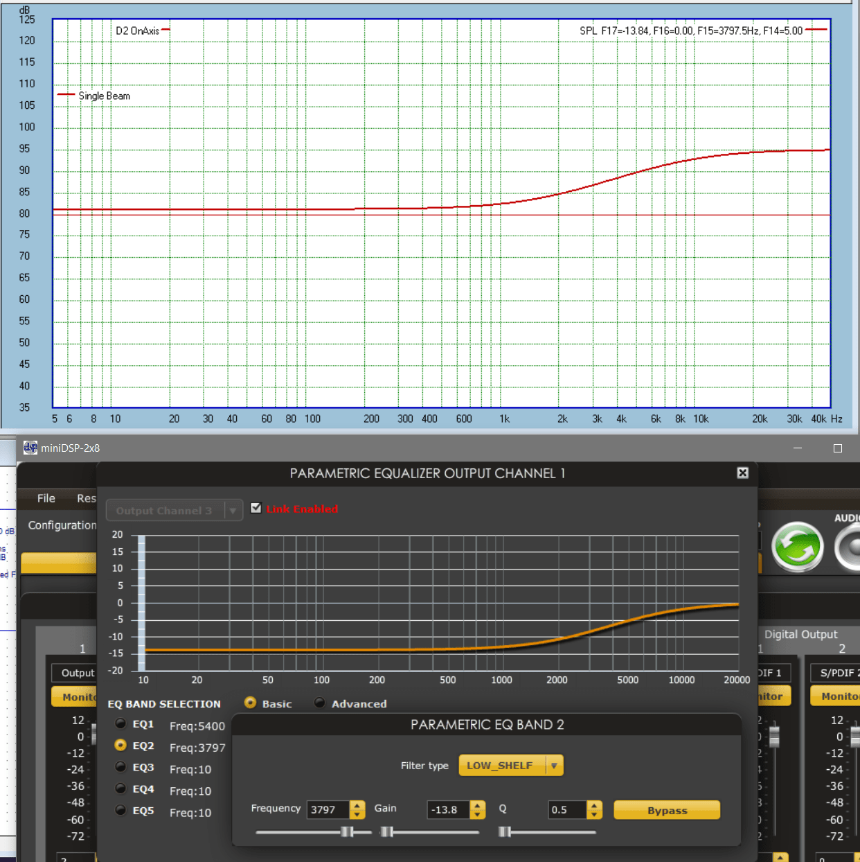

Does anyone know what the default Q is for shelf filters in Soundeasy? I need to make sure it matches miniDSP.
EDIT: SE also lists options of -6db and -12db for shelf filters (actual gain is adjustable so I don't know what this refers to), but miniDSP doesn't list any db value. Thoughts?
MiniDSP uses a slightly odd definition so there is a good chance it does not. A easy way to check is with a loopback measurement of a known EQ.Does anyone know what the default Q is for shelf filters in Soundeasy? I need to make sure it matches miniDSP.

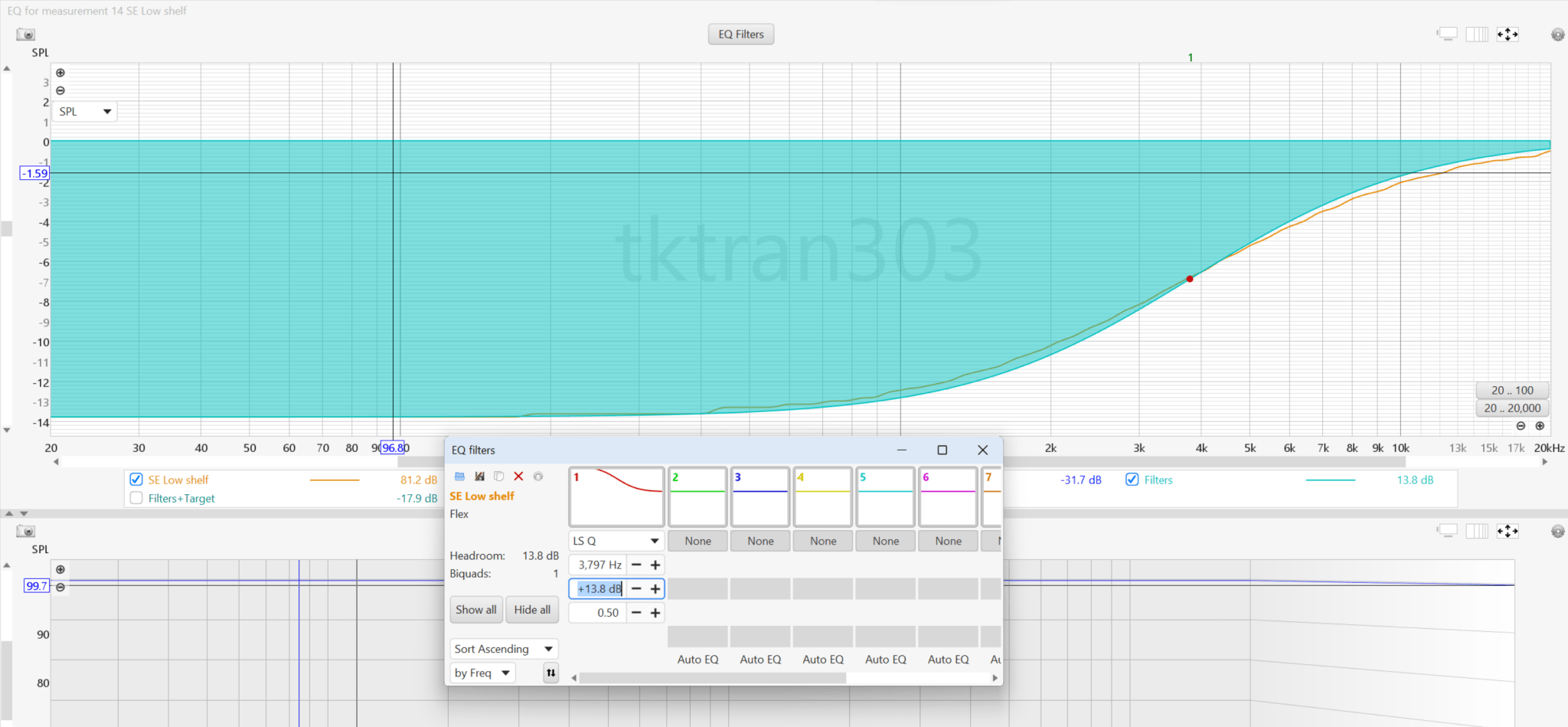

REW has the option to set it's EQ to MiniDSP then you can compare the traces and get verification.

In the above SE graph- What have you implemented?
SoundEasy's "+/-6dB/oct Low-pass shelving filter" ?
If so, then it is equivalent to miniDSP's "Low_Shelf" function with a Q=0.5.
For REW users, REW accurately models miniDSP's Low_Shelf and High_Shelf filters if one uses the "LS Q" filter function.
REW's "LS 6dB" and "LS 12dB" equalizers do NOT closely approximate it.

First order filters don't have a Q factor by definition. That counts for any first order filter.First order shelf with Q=0.5 is what MiniDSP use as far as I remember which matches your plots.
For shelving filters, there is a 2nd order shelving with a Q=0.5.
If memory serves well that's equivalent to a first order shelving filter.
Just a little practical tip, instead of eyeballing we can just trace both in VituixCAD and plot both 🙂😎Eyeballing the plot of SE vs miniDSP, it looks like miniDSP is the -6db version of SE's shelf filter, and Q=.5
Exactly right@augerpro

-6dB means 1st order shelf, -12dB(pro octave) is 2nd order.EDIT: SE also lists options of -6db and -12db for shelf filters (actual gain is adjustable so I don't know what this refers to), but miniDSP doesn't list any db value. Thoughts?

Yes, I meant setting Q=0.5 in MiniDSP makes a First order shelving filter which is their default.First order filters don't have a Q factor by definition. That counts for any first order filter.
well then I stand by what I commented on previously.Exactly right
And those 2 images you posted in #2105 ARE equivalent.
