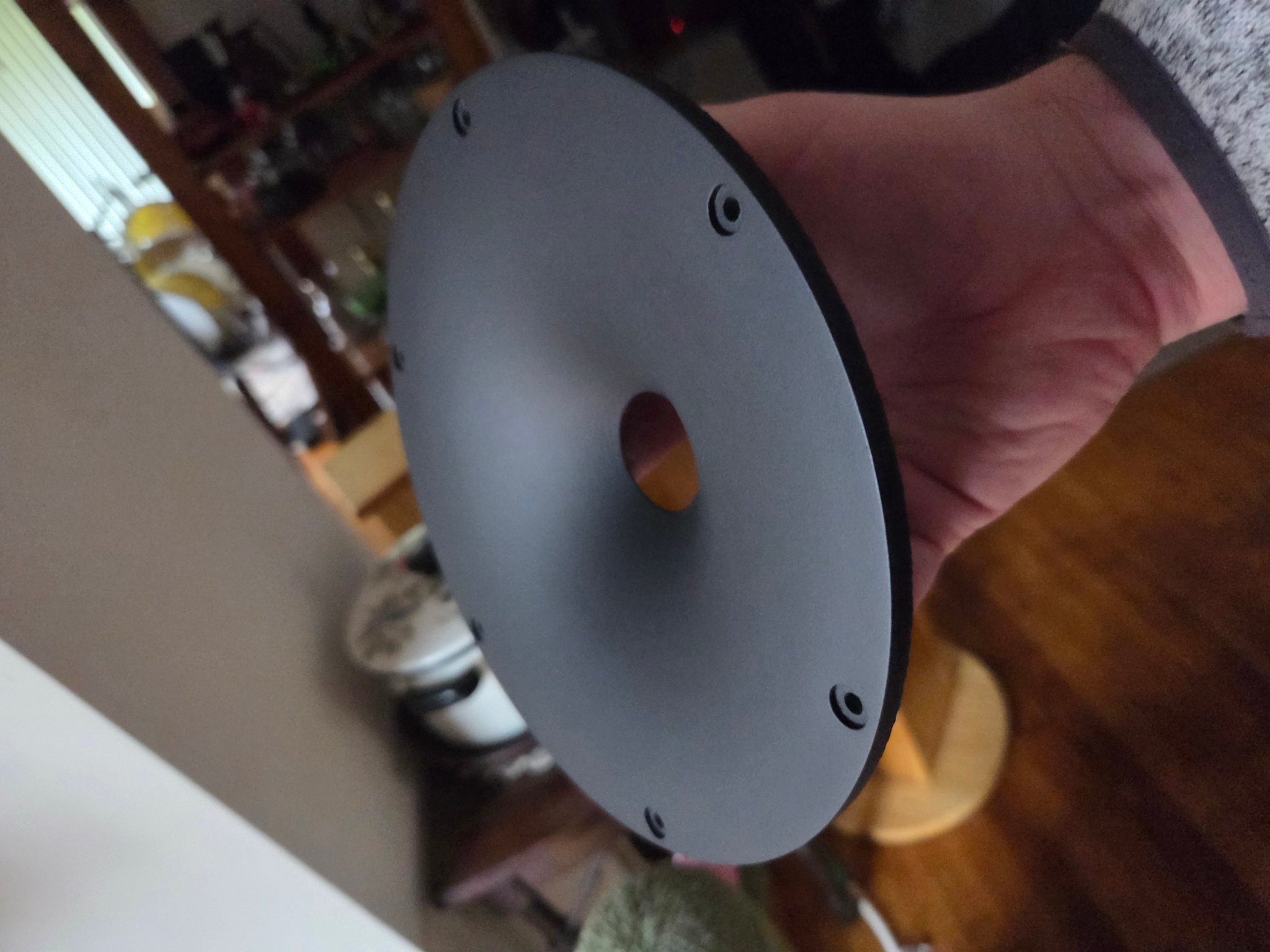

Took a lot of filling and sanding and filling and sanding, but I'm happy with the results on this waveguide. They're sadly probably going to sit in my driver closest for some time until money isn't scarce. Might just see if someone on here wants them.

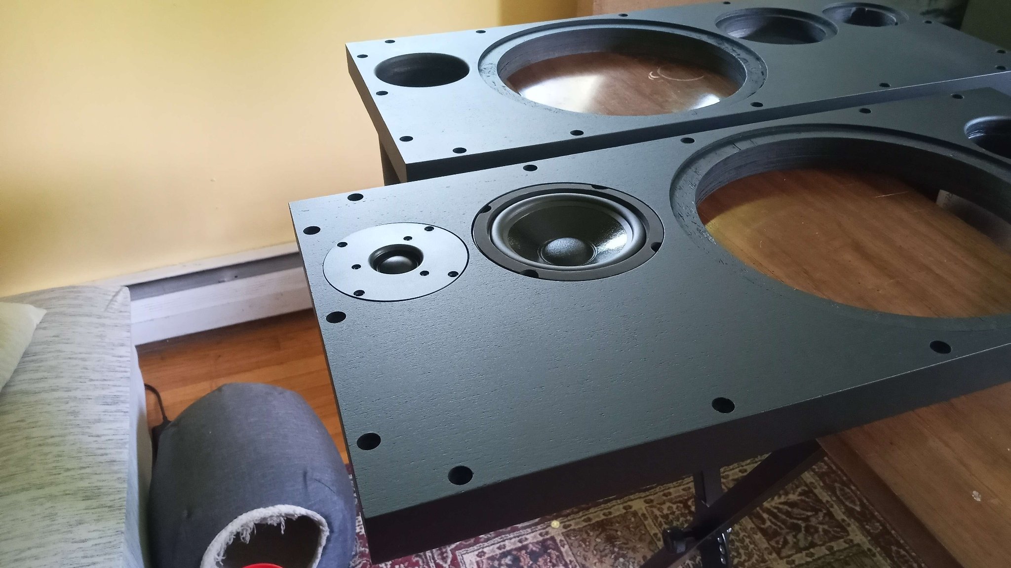

I spent last weekend finishing the boxes and this weekend I'll put all the drivers in. I should be able to get my measurements during this time also and begin crossover work. In the case of the model 2, I already have the crossover done with the roundovered baffle, but I made a box with chamfers and want to see if that will improve the crossover complexity.

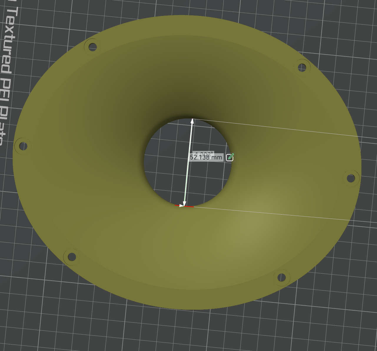

I'm interested in testing out waveguides for a 2 inch broadband driver, one to be crossed with a 6 and the other with 8 inch. I scaled X and Y to 118 percent on the satori 6 inch for a mouth opening diameter to clear the rubber surround. I can do the same with the 8 inch Satori. The broadband doesn't need a projection just like the satori.
Any issues with this plan or is there more involved? Could it work reasonably well?

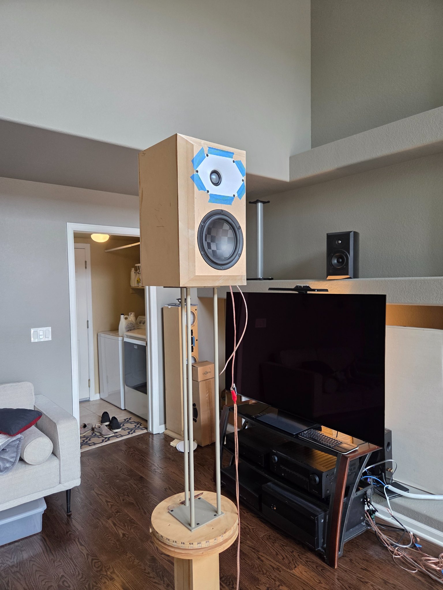

Measuring all 4 prototypes today. Verifying the baffle diffraction model and whether roundover or chamfer works best. I tried my best match the baffle diffraction to the native response of the drivers - mostly the woofer. Model 1 is Satori textreme and Be, Model 2 is SB "ceramic", Model 3 is SB's entry level drivers, and Model 5 is Scanspeak Discovery and either SB26STAC or CAT308. All tweeters on waveguides of course.

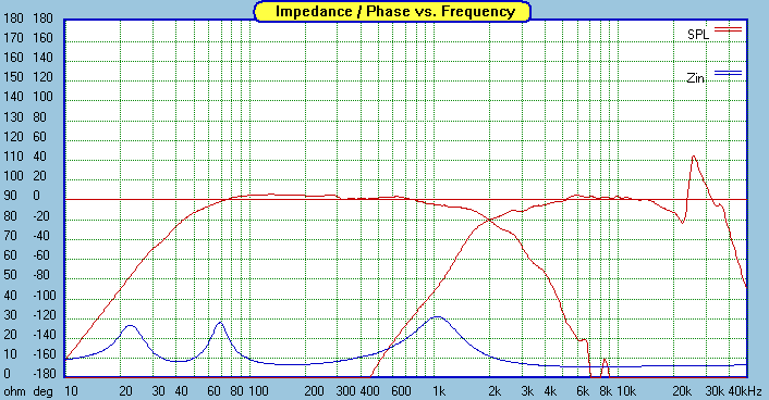

A) Who could blame them when they had difficulties measuring = difficult time doing crossovers for drivers with high Q resonances; not being able to simulate via software = not being able to do series notch filters; not being able to measure = not being able to verify etc Catch 22. The wandering breakup modes and slight imprecision of inductors/caps don't help to strike the resonance.
B) 2 decades ago I help some friends build this speaker: Zaph's All Metal System
It was OK but I never did quite enjoy it in the long term ie. >10 mins listening.
This was long before I had any measurement equipment to verify what I built.

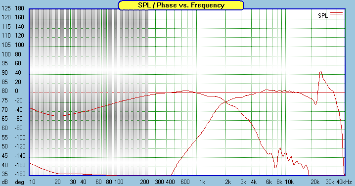

According to John, here's what his crossover was supposed to do:
This is what it actually did:
Our friend John accepted it, saying "...the notch does not take the extra high frequency garbage out as much as expected, but it's still 30 dB down and essentially off the radar"
(bold: my emphasis)
I finally got a chance to measure my friends- this is what my crossover actually did
only 22dB down !!!
A far cry from the original 40dB as planned.

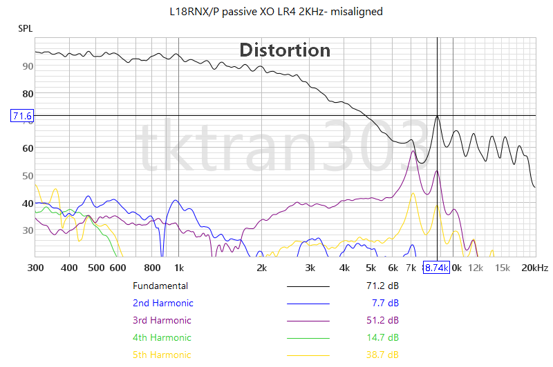

22dB is not far off what Joe D managed on his Thor kit for SEAS, using the W18E001 drivers. (7Khz resonance is 23dB down; page 20, Figure 14)
And yes, of course I can correct it now by fine tuning the inductor and/or capacitor in the parallel notch.
But that actually takes measurements to verify
A DIYer without measurement equipment could be excused for wondering why hard cone drivers suck (or has "extra detail" ?)
These days, we know a series notch filter is better (because it also takes care of H3), and therefore allows us to cross higher (unlike the late SL's insistence of crossing the W22EX and jkrutke's insistence of crossing the L18RNX/P at 1/3 the resonant frequency), and getting a better directivity match (if we're not using a waveguide). But it still takes measurement equipment.
