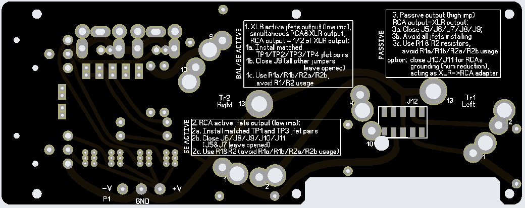

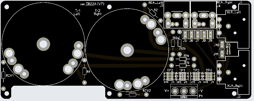

Meanwhile I am presenting a universal PCB for Ian's DAC, which can be used in both passive and active output options. The active option is based on excellent-sounding matched 2sk170/2sj74 jfet pairs connected as a current followers means output buffer stage. What for is this active buffer after transformers? It's simple - to reduce the output impedance, which will expand the connection range of the following amplifiers or preamps with low input impedance to this board. The needed PSU for active part is 2x15V (+15V_GND_-15V). Poor quality PSUs will degrade all the benifits at once, thus the quality of PSU for these jfet buffers is significiant for SQ! Suggested to use UC/LTO based PSUs (Ian's "direction" of PSUs). The output DC-offset using matched jfets is in 0.1-0.5mV range from practice. To minimize the impact on the SQ, this version uses only matched pairs, without additional balancing resistors.
Also in this version of PCB I am providing the installation of current-voltage conversion resistors before transformers (RIVs). Despite the previously declared theoretical substantiation of the advantages in using transformers in current mode (without resistors in the primary), practice shows that the use of good-sounding low-resistance resistors in the primary winding allows to get a better sound.
There are three main options for this PCB:
1. BAL/SE Active
2. SE Active
3. Passive (BAL/SE)
Price for assembled board varies from $205 to $320 depending on the options (and componets) installed.
The design was renewed a bit as well placing both RCAs and XLR outputs in the right side of the PCB:
Questions and suggestions are welcome!

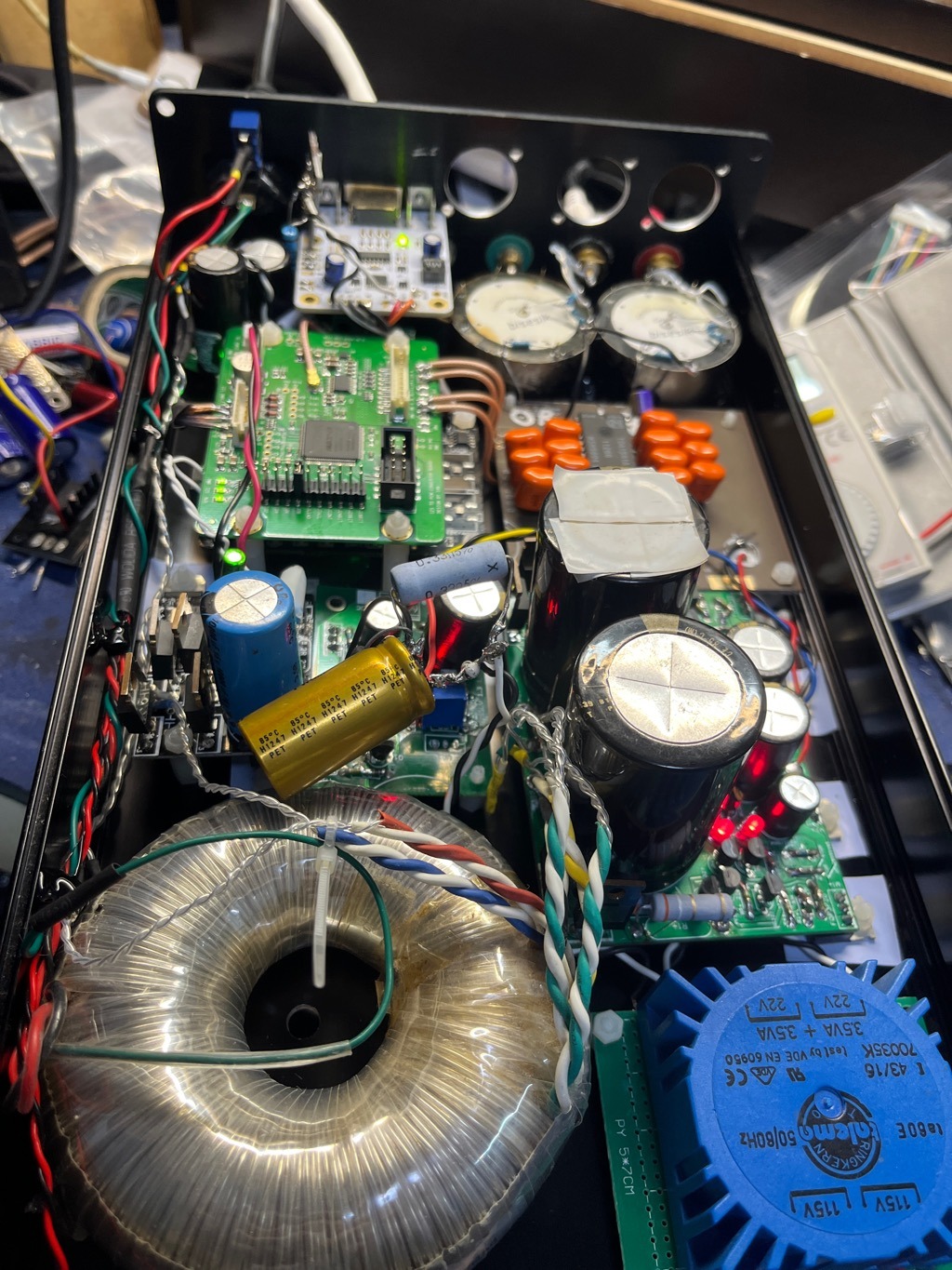

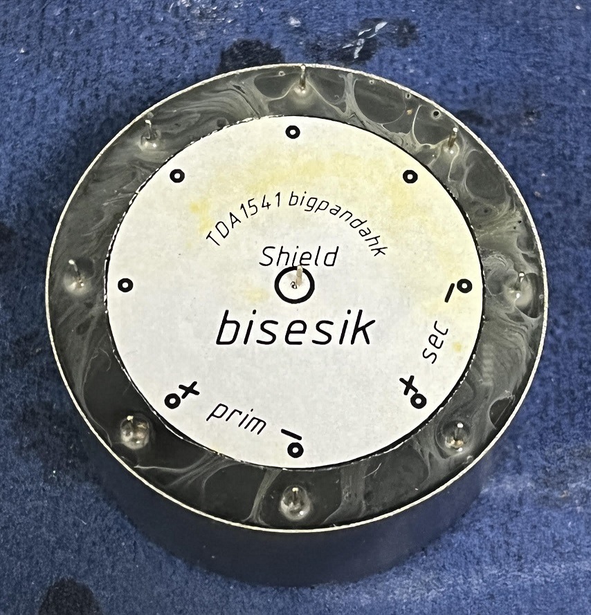

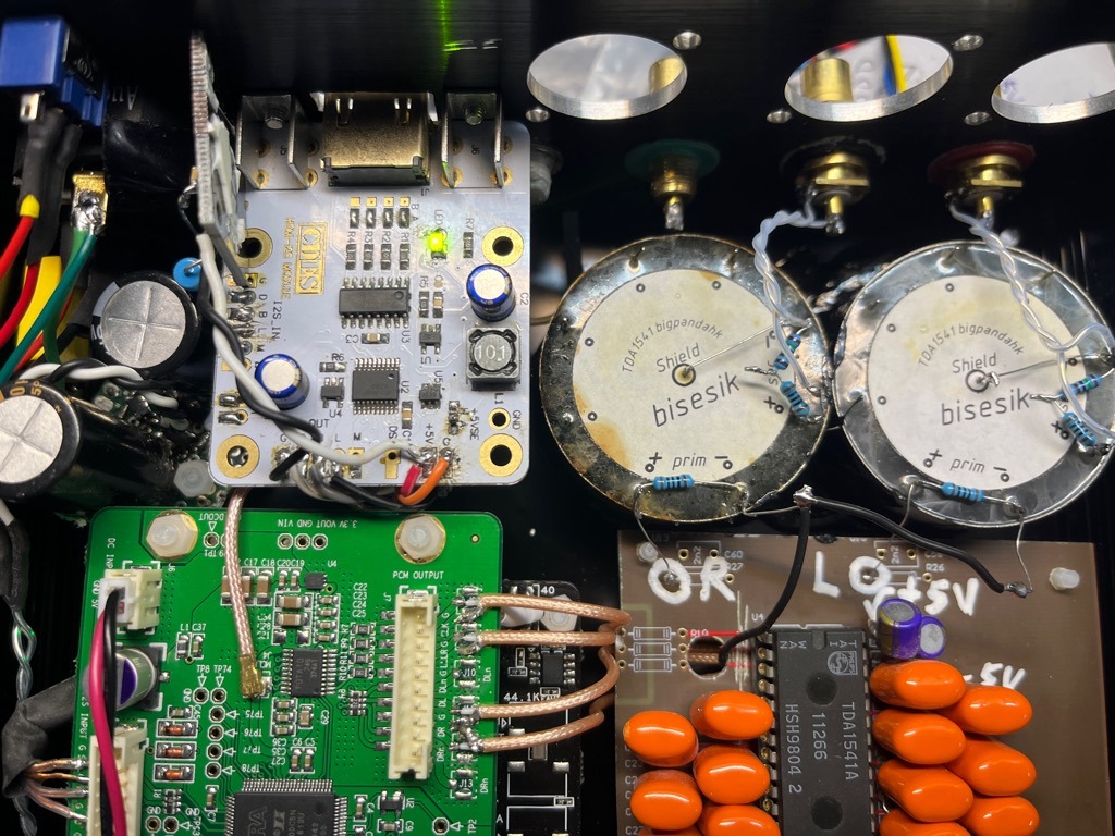

I bought the transformers for TDA1541 and PCM63 few years ago (2019?). Recently I found it from shelf and I would like to start modifying my 1541 DAC. I am not sure about the connection for the primary and secondary of the transformer. Would you please show me the connection diagram? Is there any additional components required? like resistor, capacitor? Thanks in advance.
Hi! Regarding connection diagram - a bit later...
1) TDA1541's Iout (pin 25 for the right channel, pin 6 for the left channel) goes to "+prim" of the left (or right) transformer.
2) TDA1541's agnd (pin 5 for both channels) goes to "prim -" of both left and right transformers.
3) "+ sec" is the output (tip of RCA).
4) "sec -" is the gnd of the output (SE output I suppoose?) - tie "prim -", "sec -" and "Shield" pins together -> RCA's gnd.
5) You can use i/v resistor across the primary side, across the secondary side or across both sides. It is hard to catch more than 0.25V from the single TDA1541A without active components (for proper THD+noise and LF response). So for 0.25V you need to apply (third approach, i/v across both sides of transformer):
6) 100R across the primary coil and 1k6 across the secondary coil.
No need to use extra LPF capacitors.
1541->i/v resistor->trafo_with_loading_resistor->RCA
Reactions: 1 user

Hi bisesik,
I found that the TDA1541 that I built sound so low volume. What's the disadvantage if I increase the output voltage? (increase the 1.6k resistor?)
And I have another transformer for PCM63 that I would like to build soon, would you mind tell me the resistors to use? What should the resistors to use if I use:
1. One PCM63
2. Two PCM63 in parallel
Thanks again!
Hi bisesik,
1. One PCM63
Thanks again!
In accordance with my notes your trafos was ~ 1:6. So 1.6k across the secondary gives you ~0.35V of the signal. Sure you can increase the resistor across the secondary to get louder signal. Disadvantage will be a shifted response at LF, but depending on your system you can simply not sensing it. So no doubts you can try.
Single PCM63 has a similar output capability as TDA1541, so similar approach is OK here as well. Two PCM63 in parallel will give you a doubled signal (simple story). Better to know the input properties of the next stage (amp/preamp) such as input impedance and sensetivity to provide you the needed resistors values.

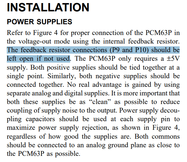

Sorry I have a few more questions about PCM63:
1. According to the datasheet, there are pinouts RF1 and RF2 that connects to the op-amp or left opened if not in used. So I just left open them?
2. The BPO pinout - Bipolar Offset Current Output (+2mA) still connects to Iout?
3. What should I connect for Vpot (Bit Adjust Reference Voltage Tap (–3.52V)*)?
Thanks again Ivan.
Yes
Yes
There is a dedicated circuit in the datasheet for this (Figure 5). As it called "Optional Bit-2 Adjustment Circuitry" then it is up to you if use it or not.
