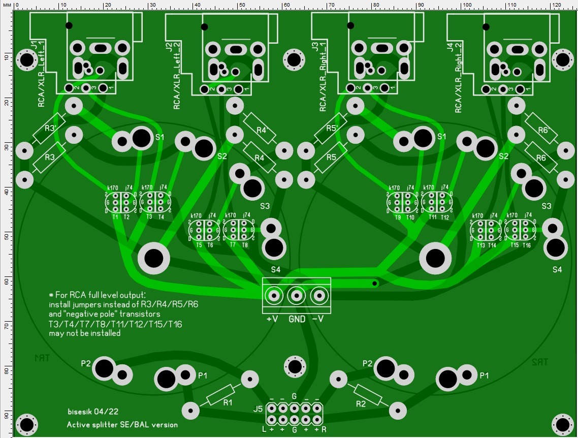

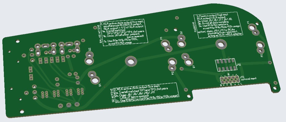

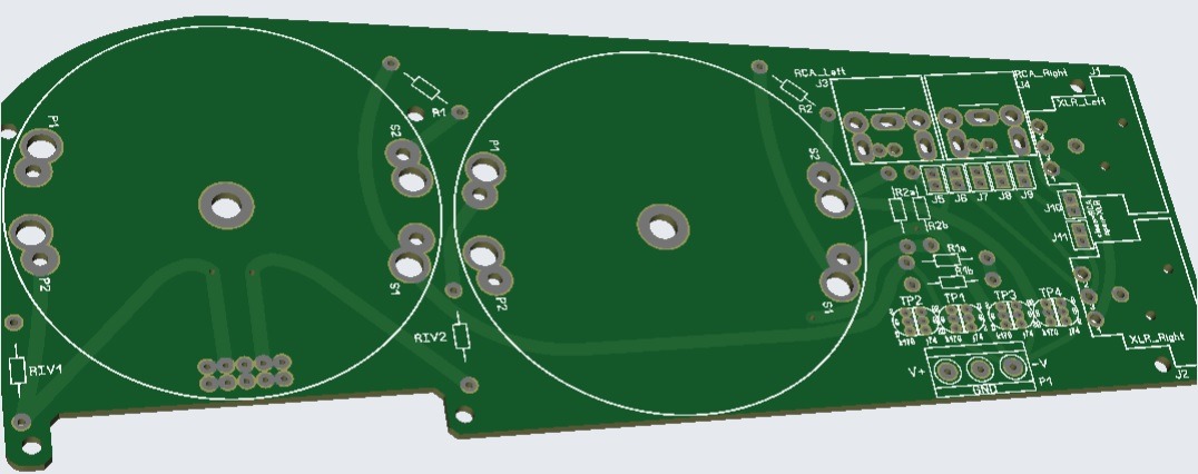

Some time ago I have got a task to make a splitter based on my transformers. So below is the PCB based on my transformers with buffered (jfets) outputs which realizing the simple approach of Y-splitter. Can be used either as a combined i/v stage+splitter for current-output-type DACs (using my SUTs) or as a line-level splitter solution (1:1+1). The combined SE/BAL version.
