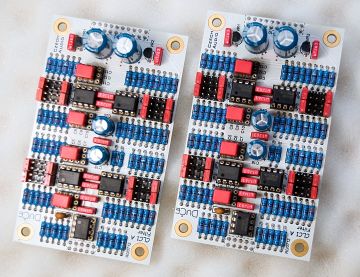

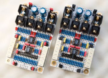

It is project of " CompromisLessCrossover " - CLC1 - with variable configuration ( 2 - 2,5 - 3 - 3,5 - 4 way ), analog - 24 dB/oct, with many setups ( switchable frequencies, phase correction, speaker correction, baffle step, subsonic filter etc... ). Project is still in developement, but I hope it will be ready this year... All is made by small modules, which are usable also in other equipment ... This is all in short...
