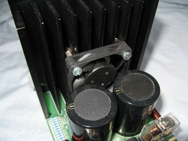

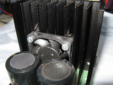

As promised, a little fan on the heatsink of the amp, just for in case that.
It's a 12VDC fan, but i runs it on 6VDC so you do not hear any noise.
