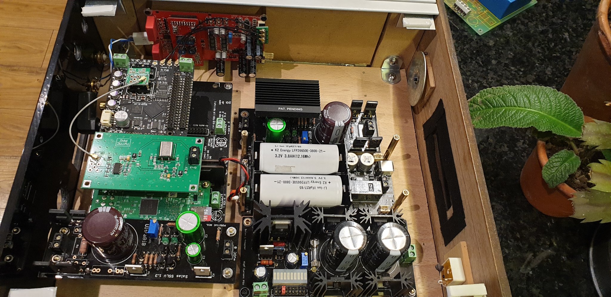

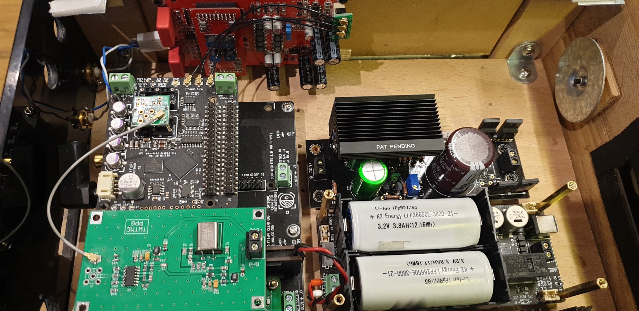

Hi Jim. Nice looking build you have there. Wondering where you got that adapter board to connect the u.fl cable to the I2S in puts on the PhiDeca? I have a similar set up going from Ian's FifoPi to a PhiDecaDac and would like to use the u.fl outputs but haven't been able to locate a source for such an adapter.
Busy old day today and to be fair its done my swede in a bit! Trying to fathom it all out and keep it neat. Still a long way yet but getting there.
Got the Fifo u.fl rigged up to the dac. This rig was all 'Ian Canada ' but I've taken his ess dual mono dac out and I'm using the digital front end to feed the Phideca. Powered by various Salas shunts and Ian batteries. Along with Andrea Mori entry level 22mhz clock.
Hope to hear it all soon! View attachment 1022588 View attachment 1022589

I dug through the thread and can't seem to find them. If you've got one to sell, I'll gladly take it off your hands. Send me a PM with info?@bm2352 they are small pcbs offered by a member somewhere in this thread. Maybe there is a link in post#1. I have some spare i can send you if you would like.
