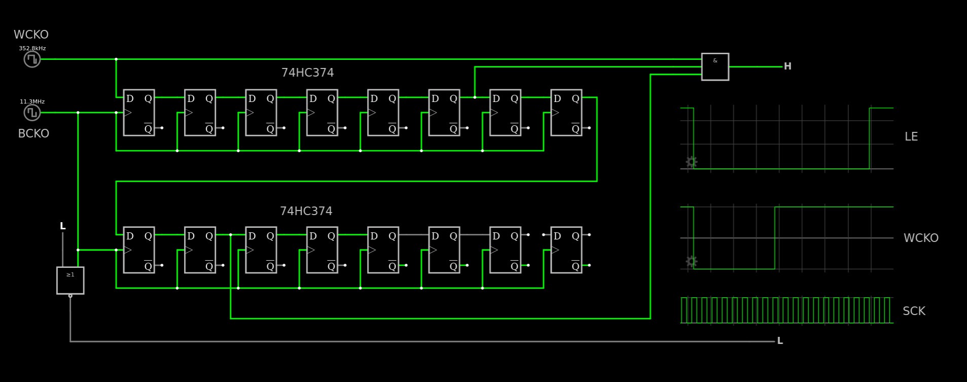

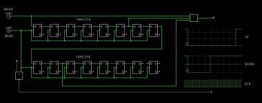

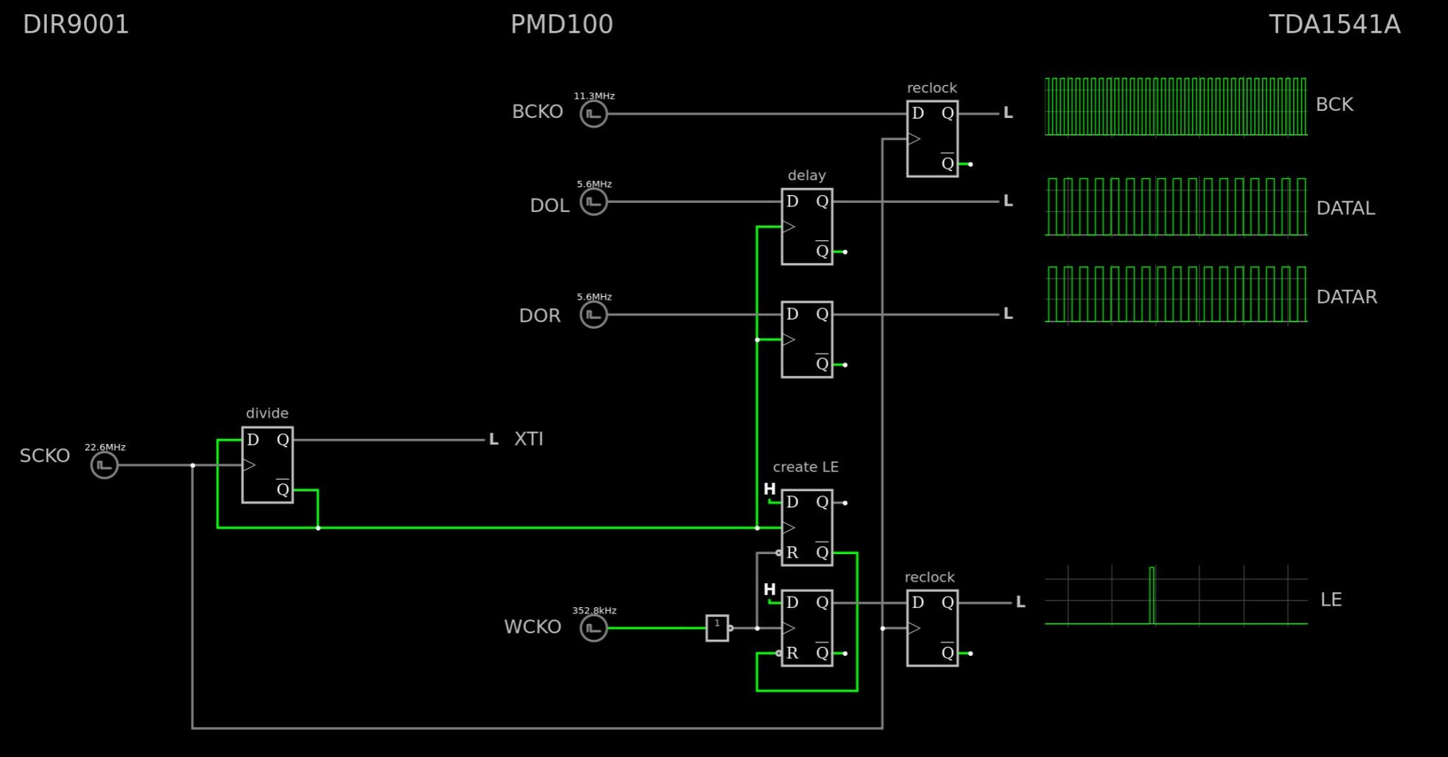

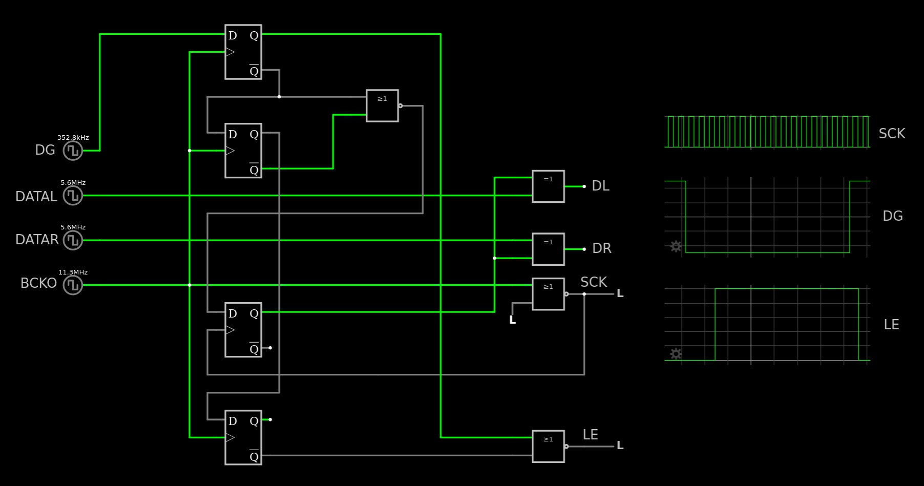

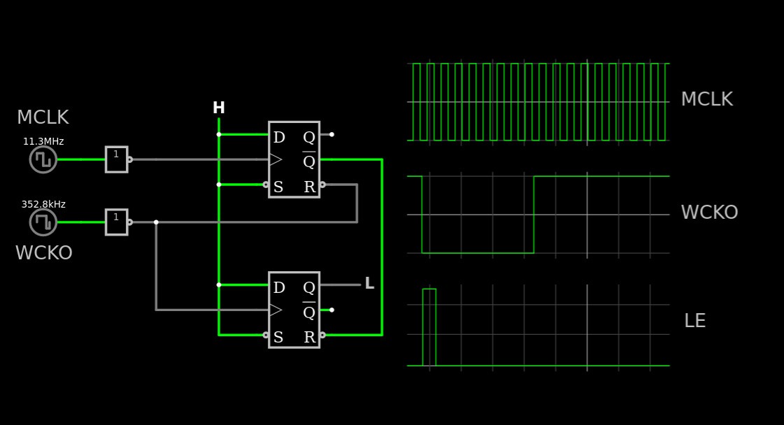

continuing from this thread I would like to open a new thread about interfacing a TDA1541 based DAC to a PMD100 based frontend, but the information about this topic seems to be lost. Here are the links I found:
I also found some information on hifidiy:
I simulated the mentioned circuits:
Attached screen shots of the simulations where the timing of the created LE signal is shown.
EDIT: simulation of PMD100 glue logic for stand alone mode. Post #102 gives a summary of the reclocked glue logic circuit I installed into my Arcam Delta Black Box v.1, post #228 contains the final simulation, #229 the latest mcu code to configure the PMD100 in programmed mode and the latest schematics, #230 shows the final state of my Arcam.

LE comes after last falling edge of BCK (during LSB) and before next MSB. That is what the datasheet is showing. The timing of PMD100 differs from that, and the glue logic translates between the two. You seem to indicate that one or more of the shown circuits violate timing spec: if so, why not giving clear words?
What the Philips datasheet shows is a clock and data set that meets all the stated timings including a minimum BCK cycle time of 156nS. As the data is simultaneous there is only one frame and it is 16 bits long therefore BCK is continuous at 16Fs. The PMD100, OTOH, uses the stopped clock method so there is only one clock cycle per active bit. The clock burst is always 32Fs which violates the minimum BCK cycle time but it still meets the data setup time which is probably why it still works. Point is so long as all 16 bits are loaded before the rising edge of LE the dac doesn't care.
I agree. The simulation of the circuit with the JK-type flip flops in my first post shows DATA half a cycle delayed in order to get the falling edges of BCKO in the middle of the DATA pulses. I think that should be correct. The Nakamichi circuit has even better timing but uses DG to generate LE - as far as I understand the PMD100 data sheet WCKO has the lowest jitter of all output lines, hence the JK circuit uses WCKO to create LE. I wonder if I could omit the inverter and use LE to reset the middle flip flop...?
Yes I will try. But which version...? Looking at the simulations my findings are so far:
  • the Nakamichi circuit uses DG to create LE, but the PMD100 data sheet says WCKO has the lowest jitter;
  • same with the SM5813 glue logic (BTW: SM5813 seems to have the same timing as PMD100 and YM3414); plus it just inverts BCKO instead of delaying DATAL / DATAR;
  • my JK-flipflop based circuit creates LE from WCKO and has the timing between DATA and SCK sorted, but LE is a bit short and I am not sure if any forbidden conditions of the logic ICs are protected correctly...
So what do you think?

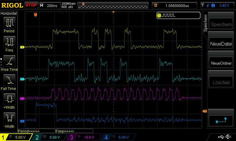

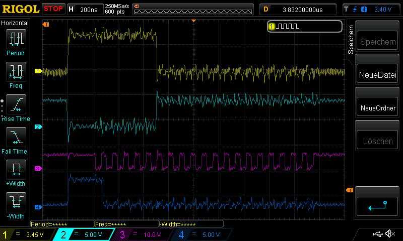

I built some of the circuits: one inverting WCKO and BCKO, the JK-type circuit and a D-type FF version. All of them seem to work identically: I can hear the music with very low volume and loud crackling noise from both channels.
The TDA1541A is fine (tested from an SAA7220). I configured it for simultaneous mode and pulled the COB pin at the PMD100 low.
Here are some scope shots:
inverted.jpg: yellow = wcko_inv, green = wcko, red = bcko_inv, blue = LE created with JK-flipflop (DATA not shown)
reclocked.jpg: yellow = dataR_delayed, green = dataR, red = bcko, blue = LE creted with JK-flipflop
(the screen shots are taken before I configured the PMD100 for 16bit output...)
