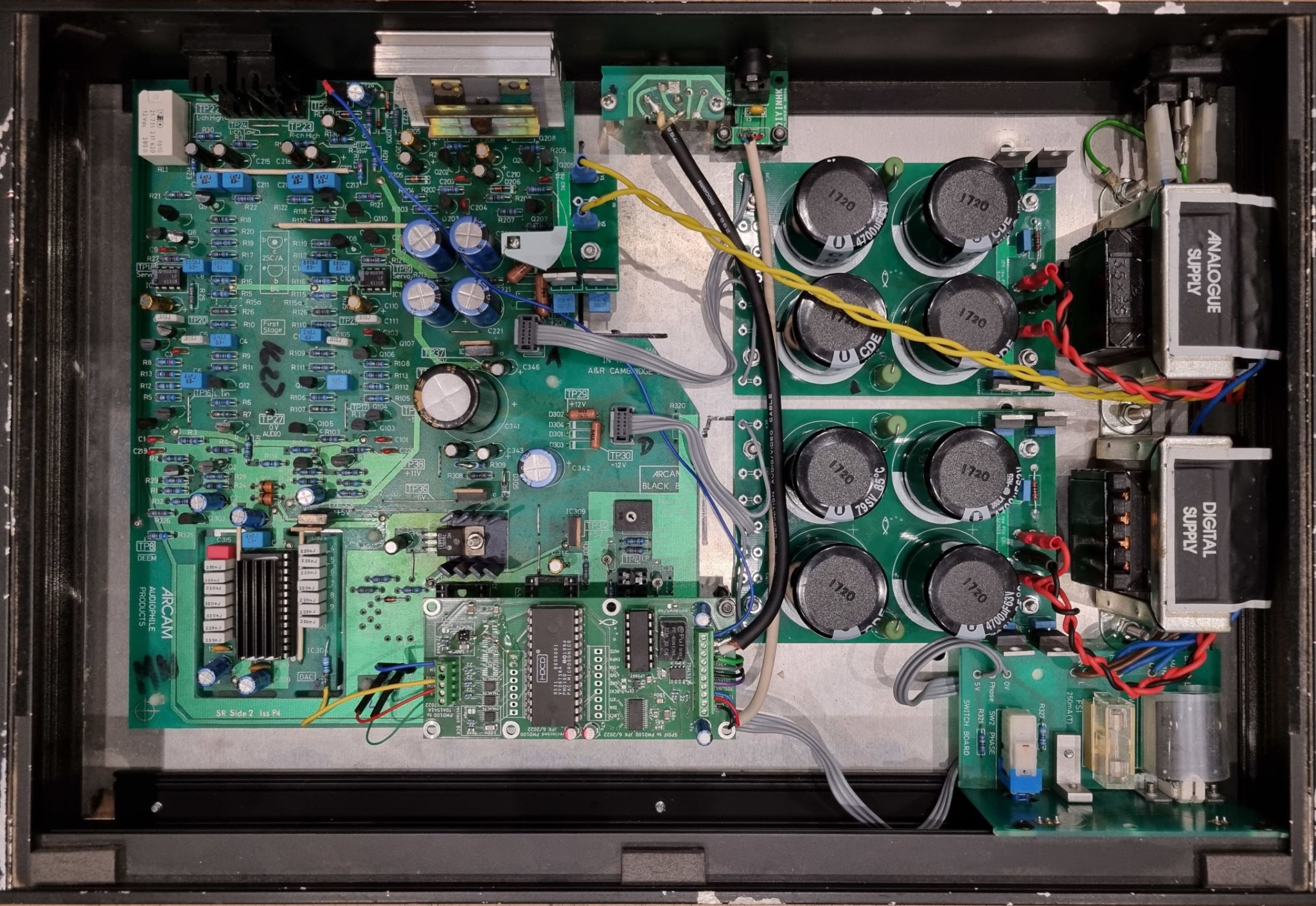

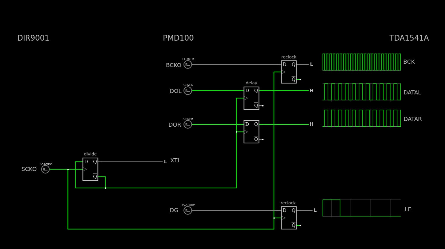

PMD100 to TDA1541 in smultaneous mode
I tried 4x oversampling and found out that there is no different timing: all frequencies stay same from the PMD100, output happens only half as often compared to 8x, so we can simplify the circuit and simulation and use DG of PMD100 to generate LE for the TDA1541A as it's reclocked in any case. The updated code:

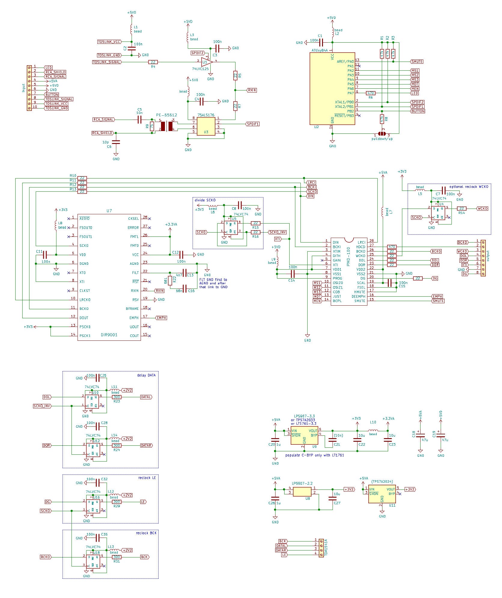

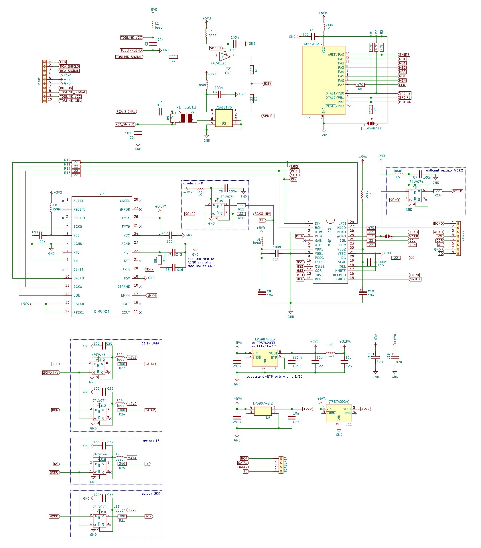

Updated schematics attached:
I played around with dither settings and found out that best is to disable dither, so here updated schematics and code:
