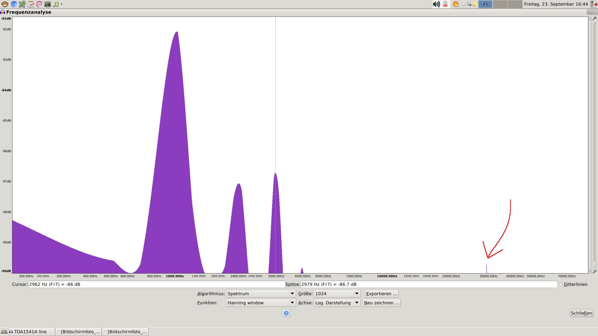

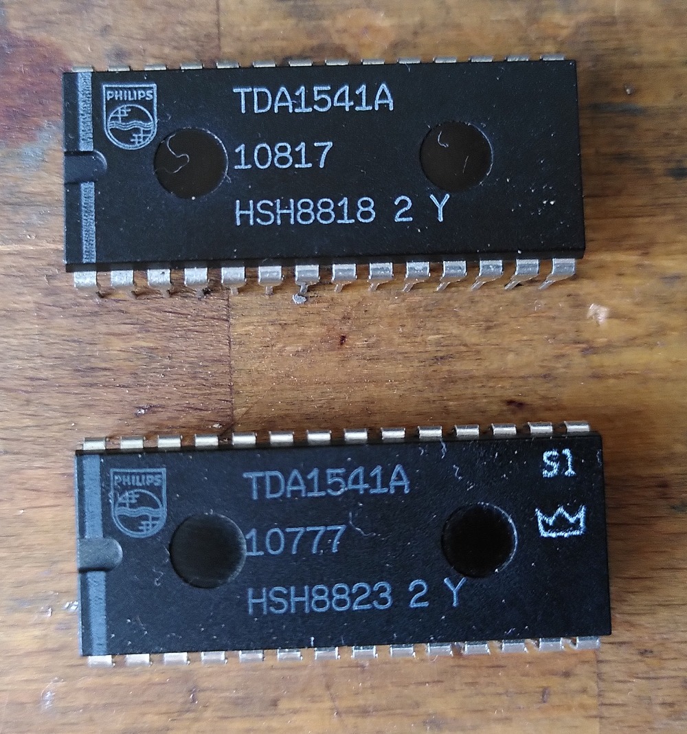

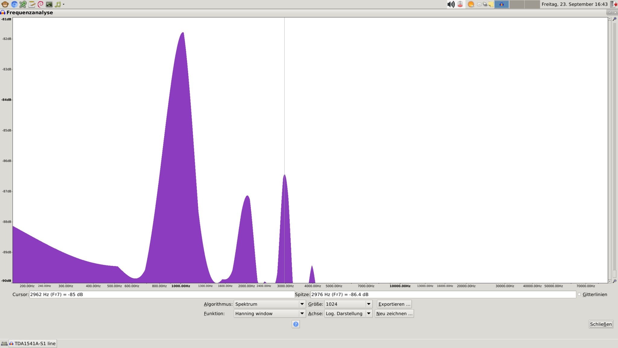

Today I recorded 1kHz sine wave files from the analog outputs of the Arcam and compared S1 to standard TDA1541A chips, see attached files. Any comments?

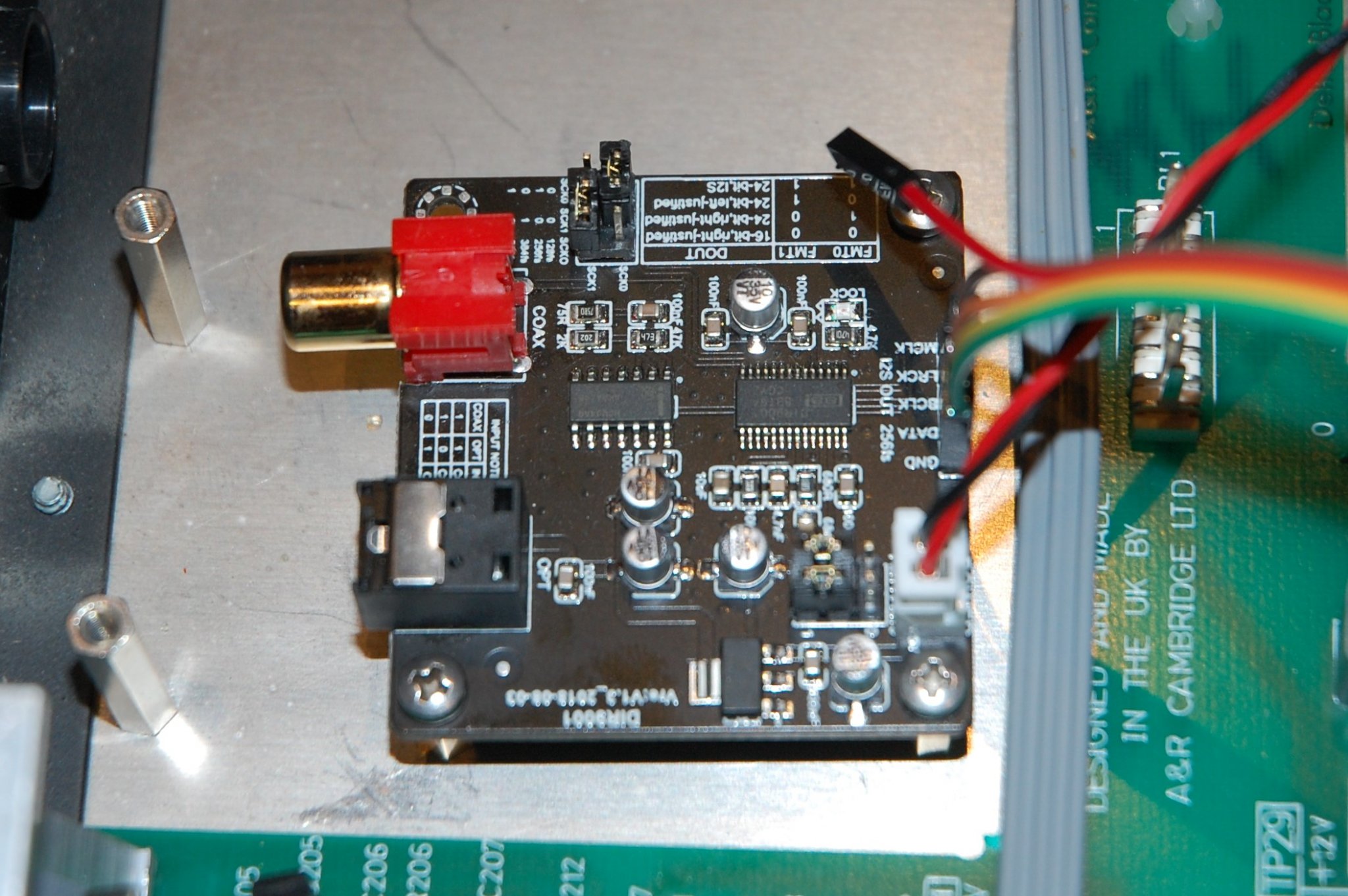

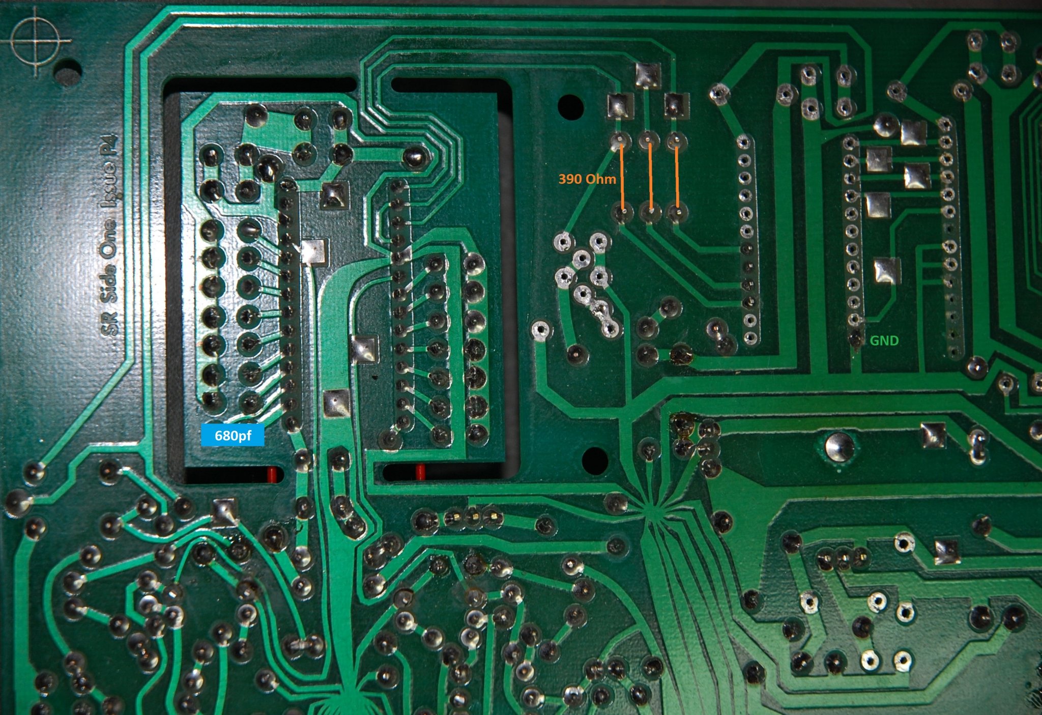

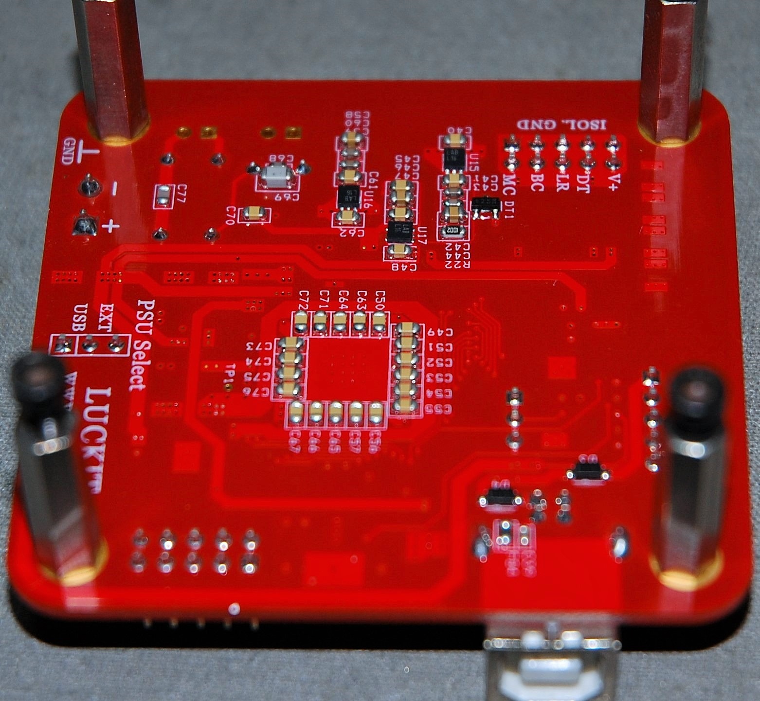

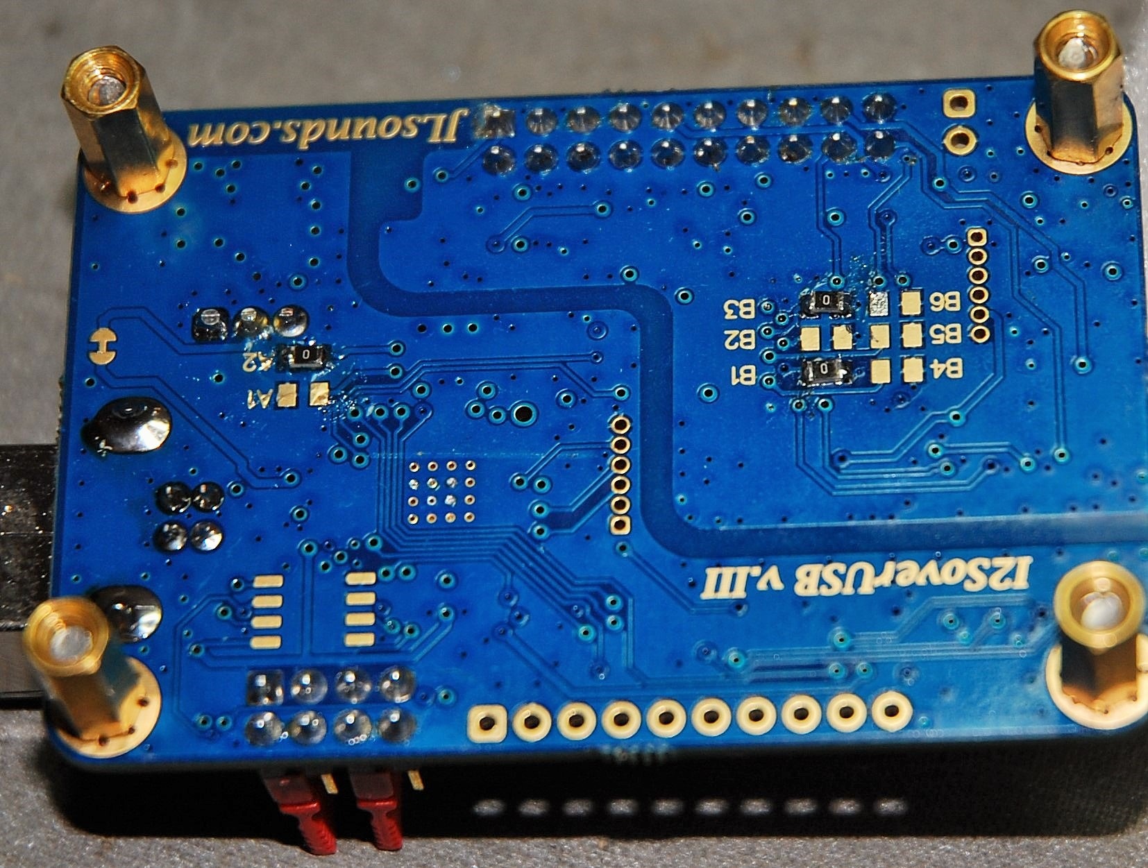

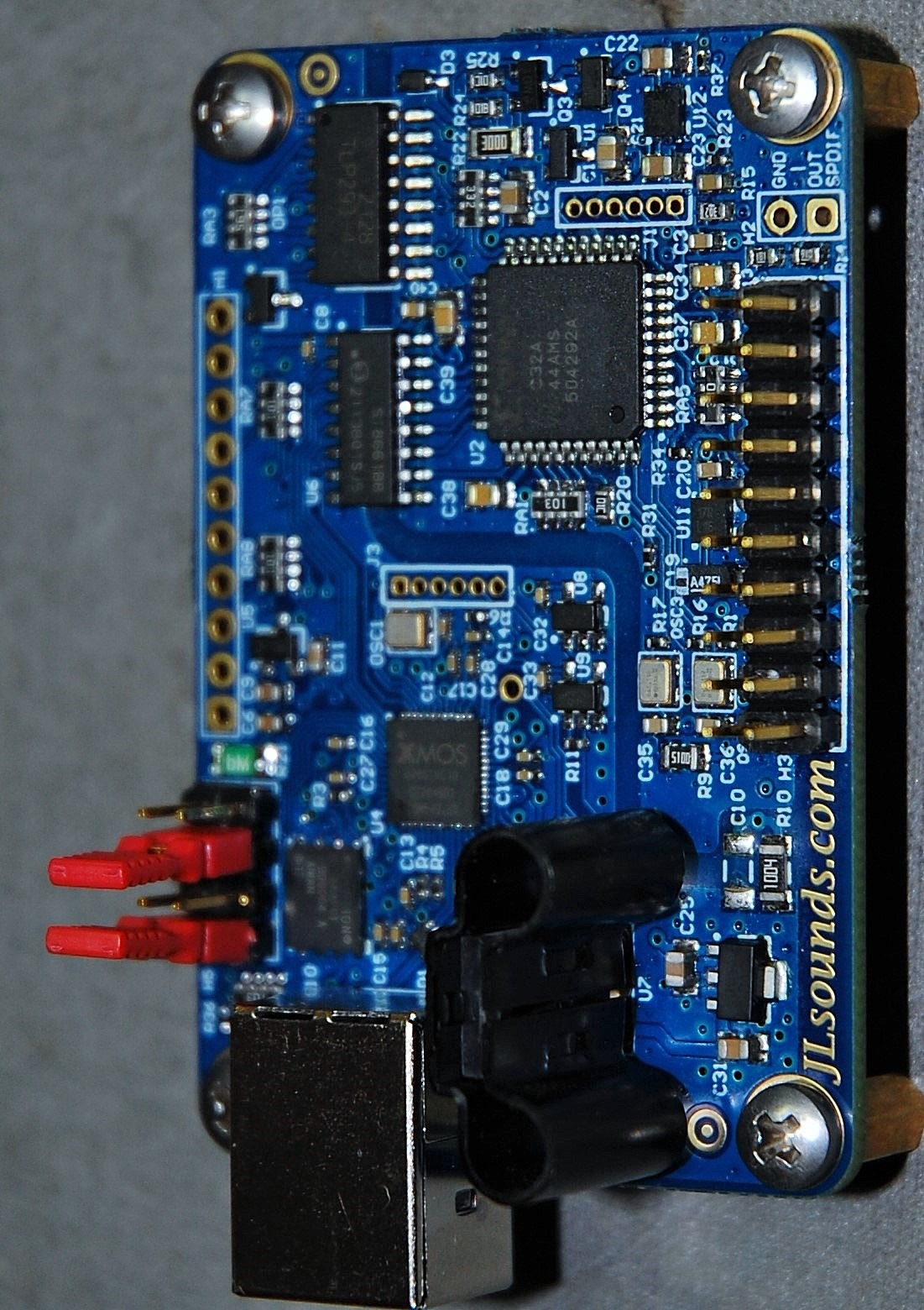

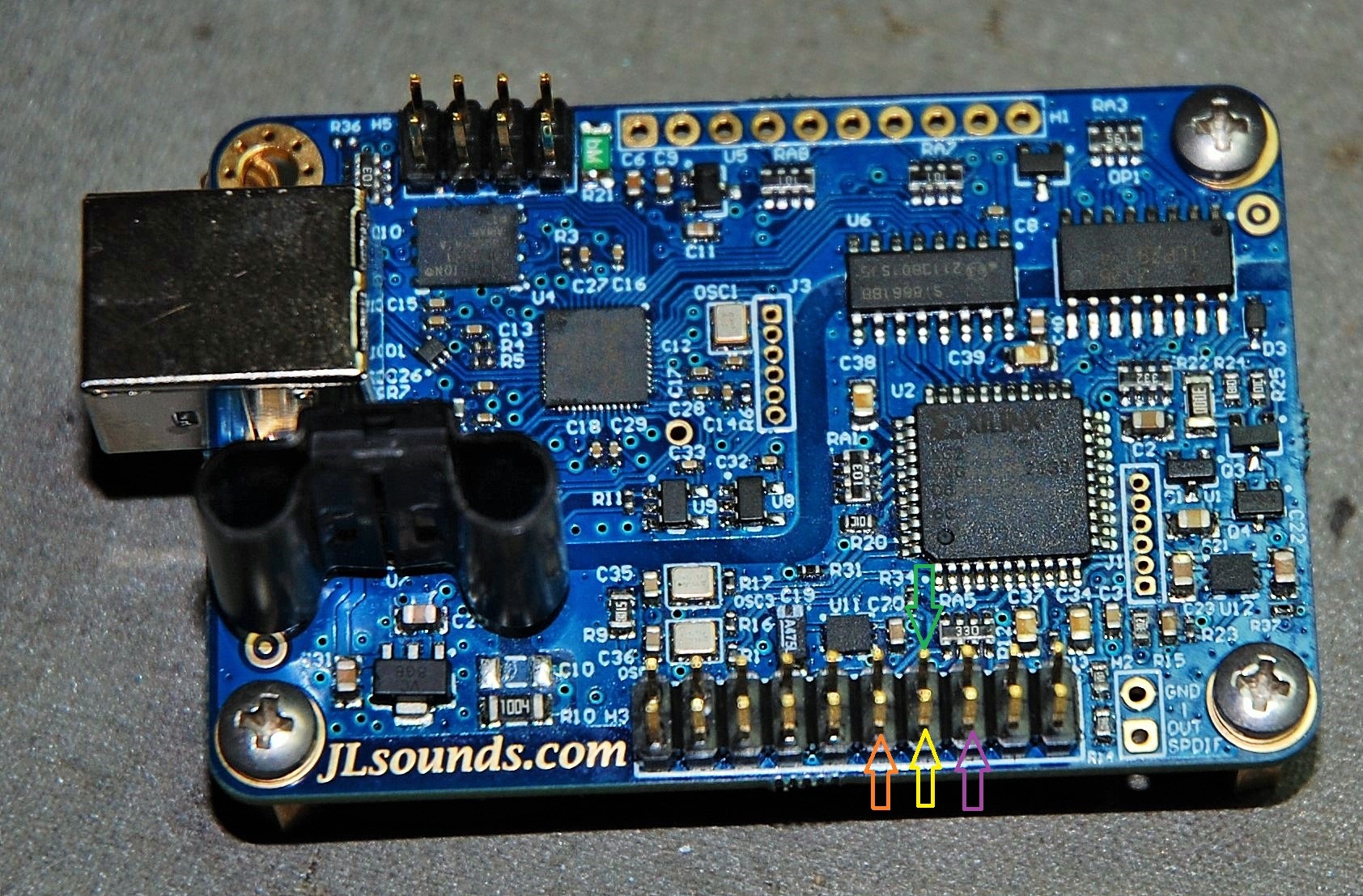

Dear jpk73:​

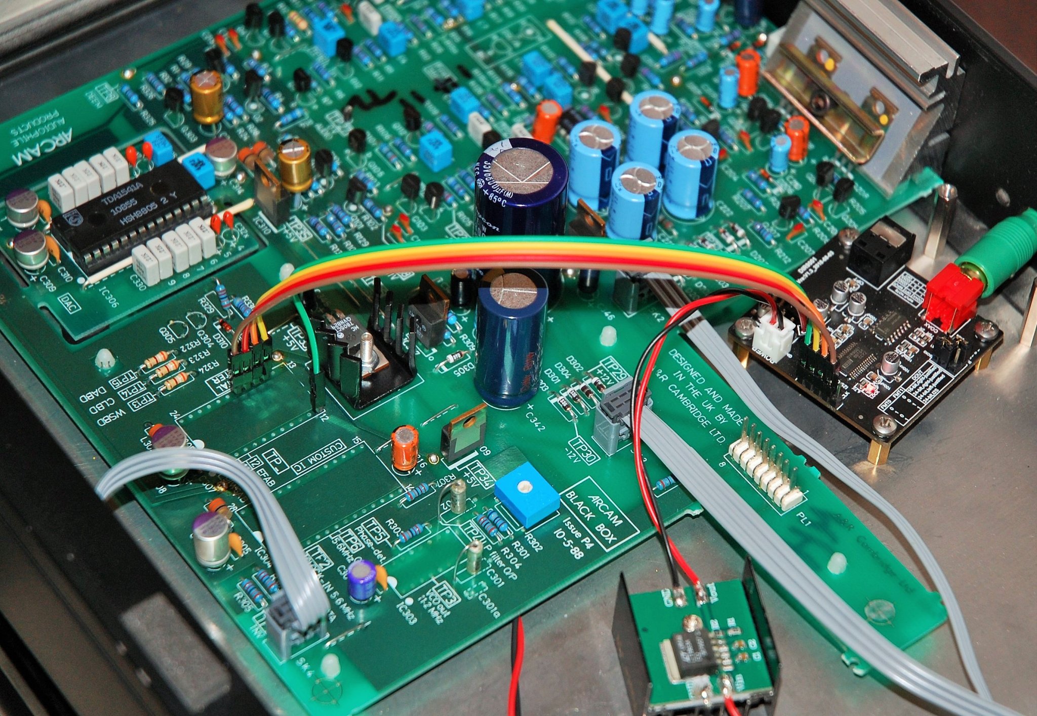

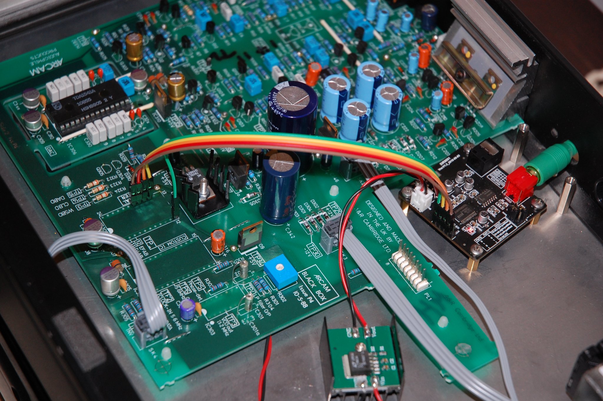

Do you know if it´s possible to use a WaveIo or JLsounds USB boards in the Arcam BB DAC?
I removed some parts that take control of the digital circuit, connect the DATA, BCLK and LRCLK but I have no sound at all from none of these USB boards!
If I use a SPDIF board with DIR9001 I´ve got sound at first attempt!
Many thanks in advance for your help!
Yes, the GND ins connected and digital (DATA) mute transistors are removed - as shown in the last pic.
What intrigues me the most is that I have the Black Box playing music very very well with the SPDIF DIR9001 card (clean, detailed, natural, focused), and no sound if I connect the DATA, BCKL, LRCK and GND lines on a JLsounds or the WaveIo USB card.
Any help will be greatly appreciated.
Thank you!

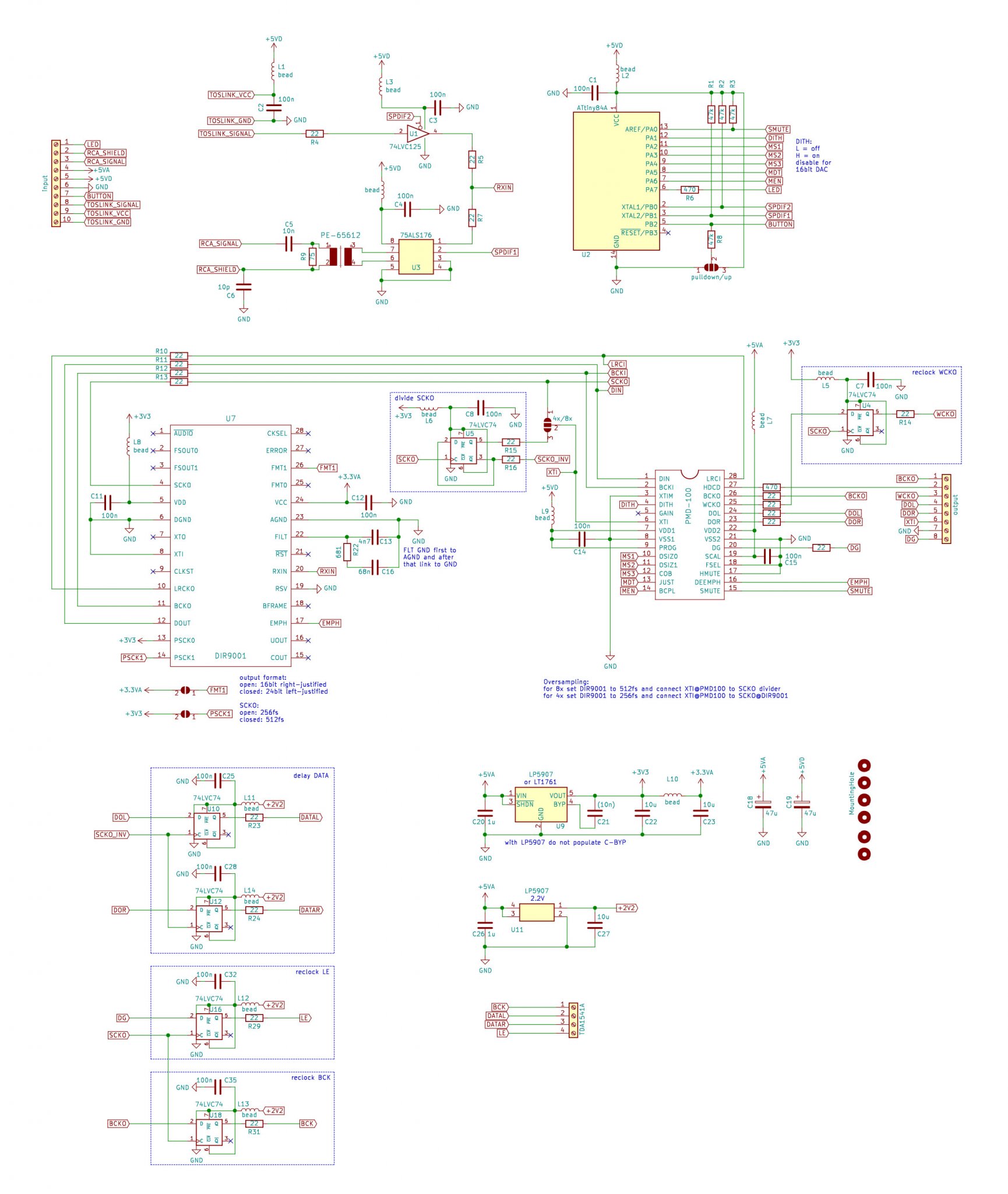

  • I2SoverUSB v.III.pdf

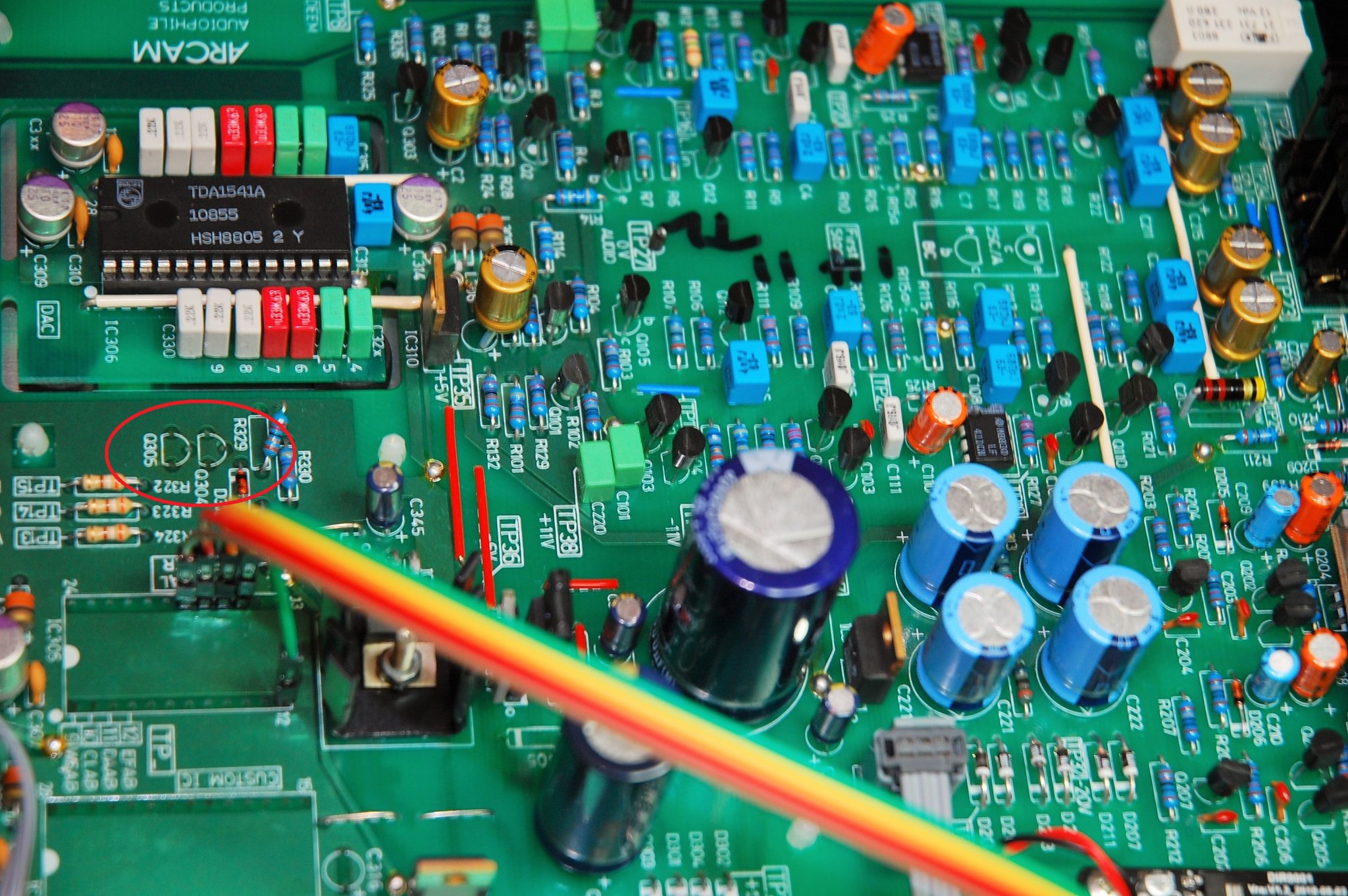

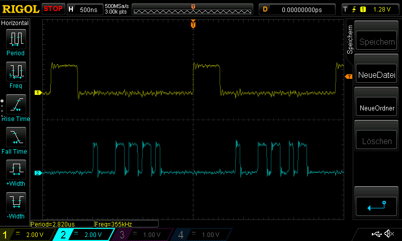

I found a stupid mistake in the schematic: the inverter in the EMPH line between the DIR9001 and the PMD100 needs to be removed. Also I managed to simplify the glue logic thanks to program mode of the PMD100 by using DG instead of WCKO to create LE. In the Arduino sketch set deglitch_high = 25 and deglitch_low = 31 in order to get the DG timing right. The result is shown in attached scope shot: yellow is LE, blue is DATA(R).
