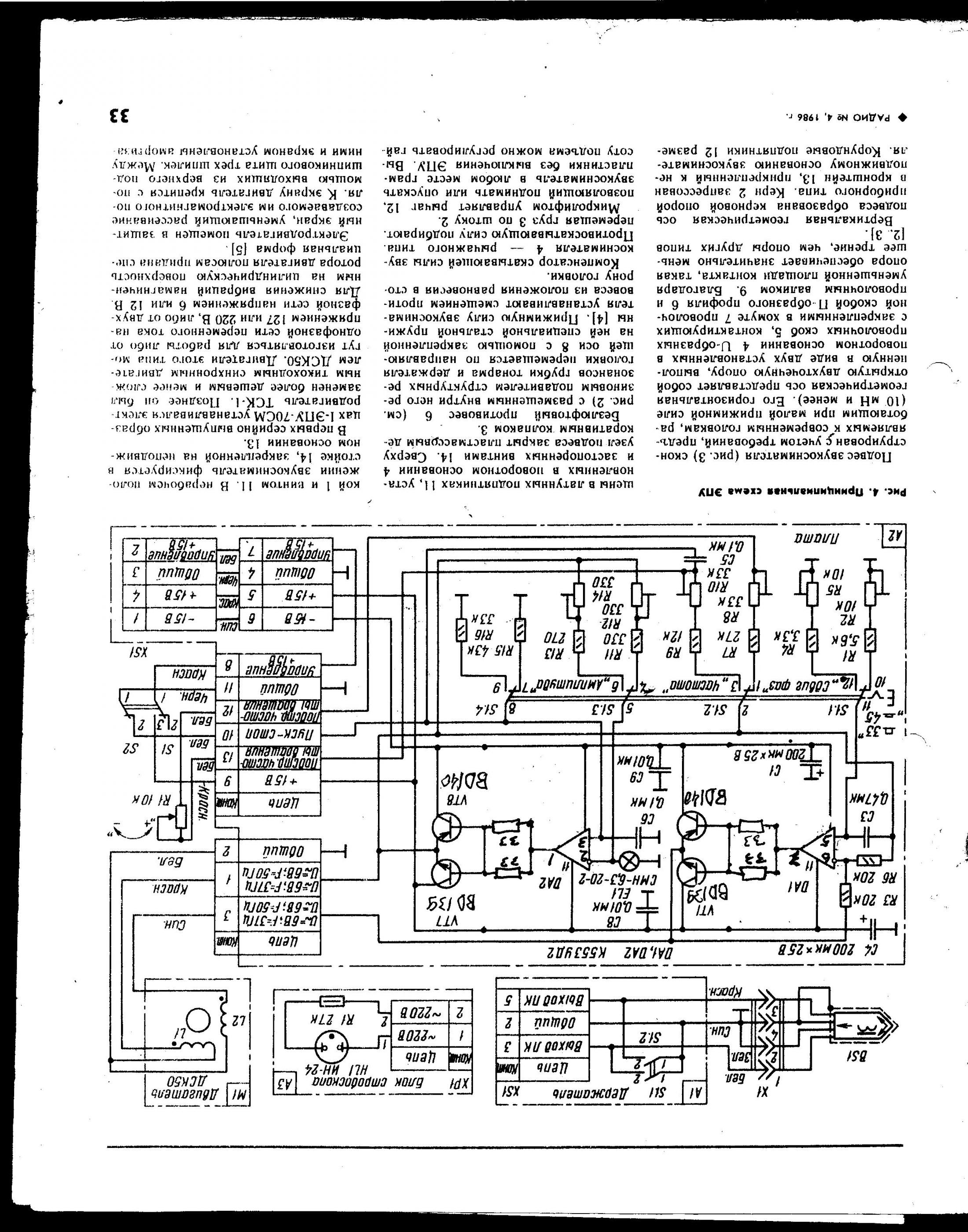

To work with these motors, I use this circuit

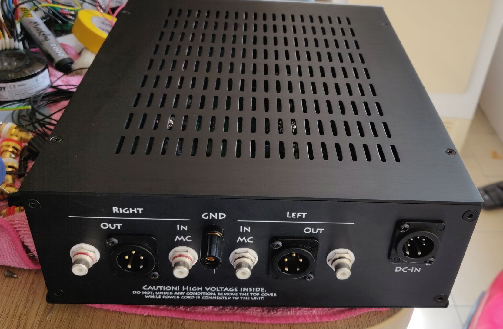

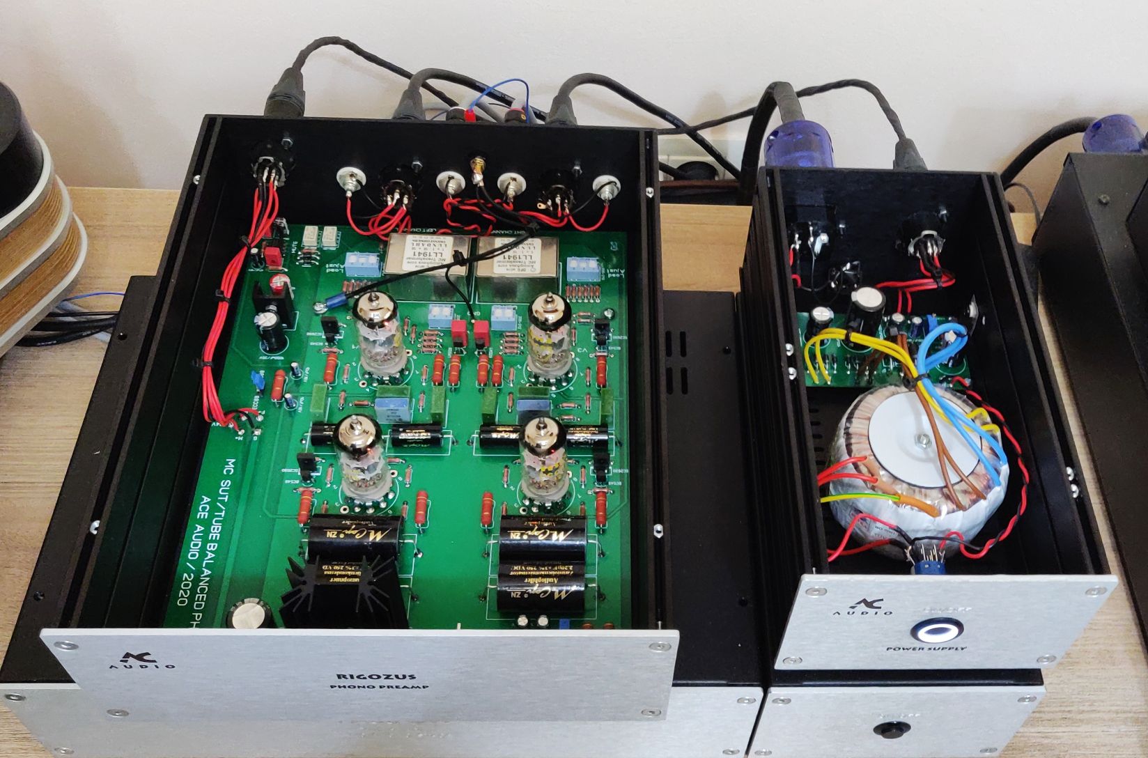

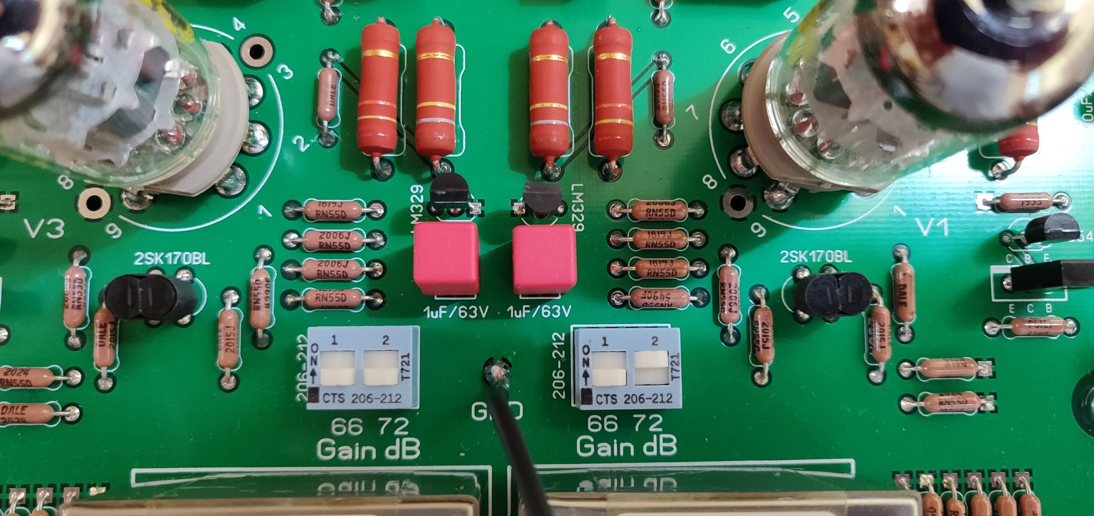

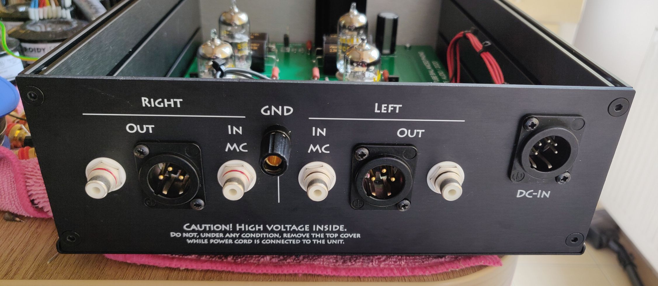

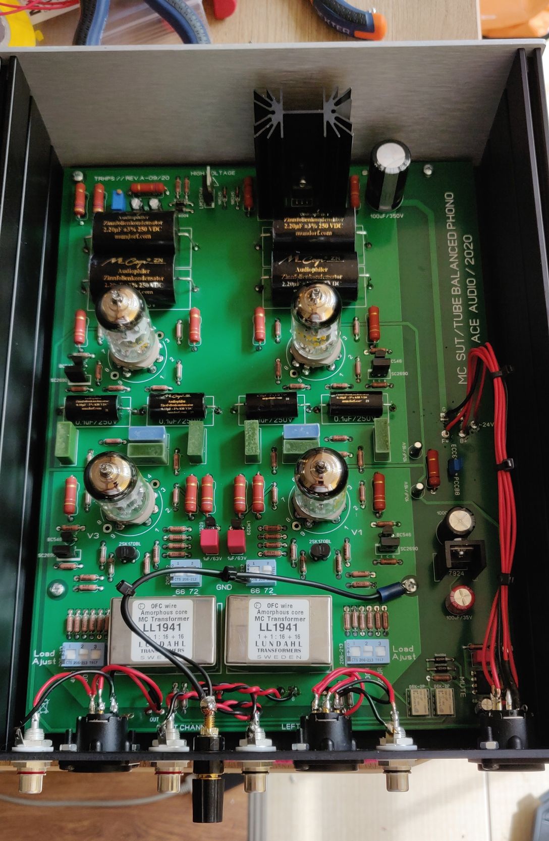

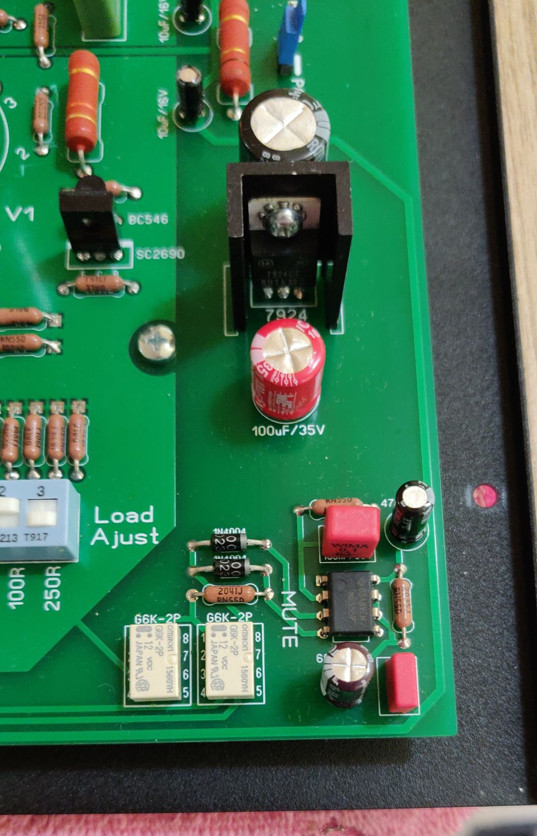

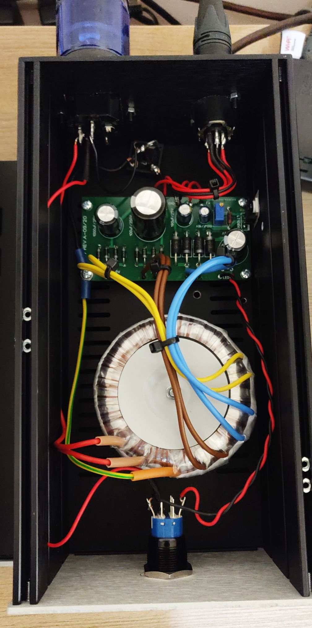

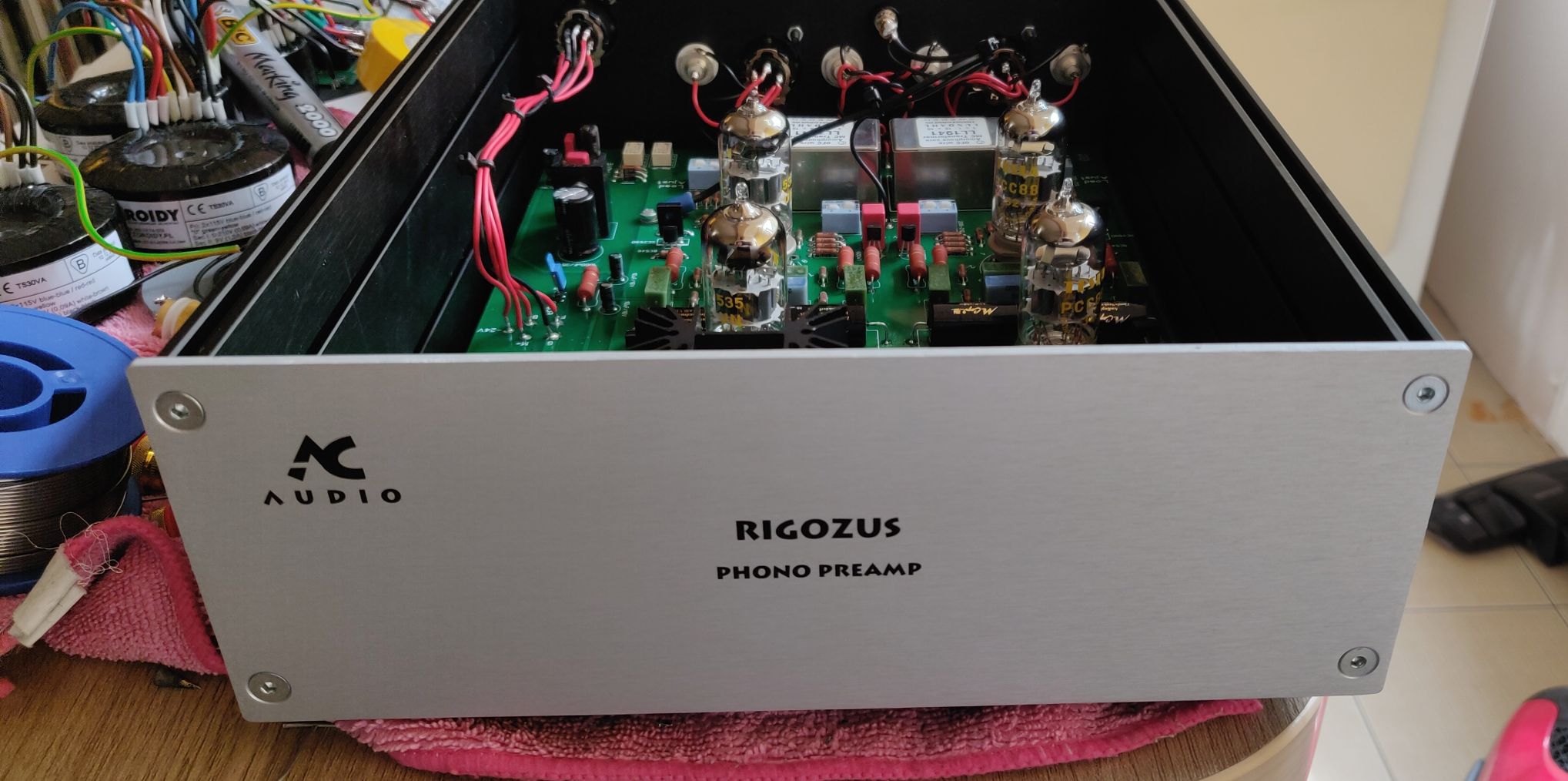

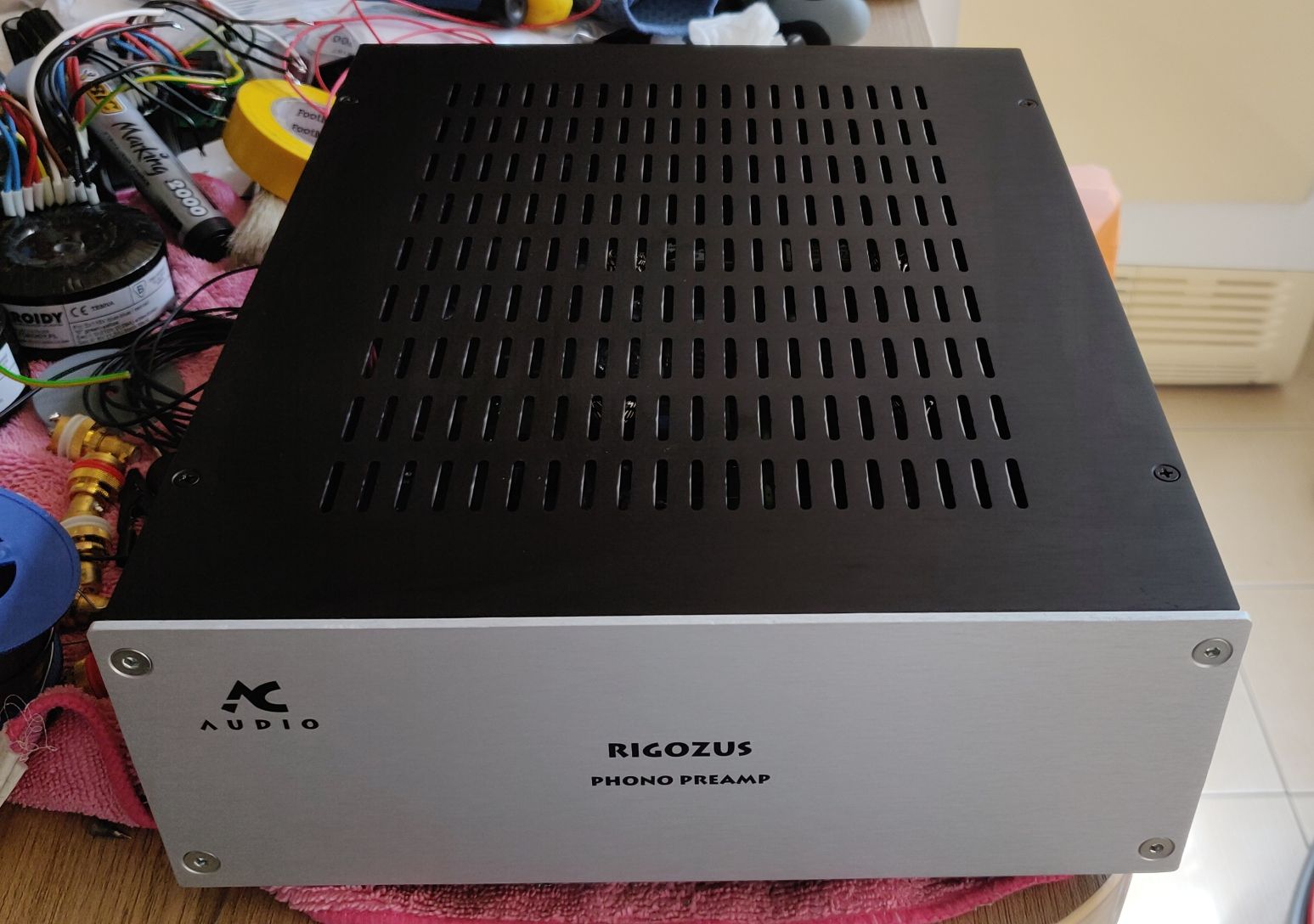

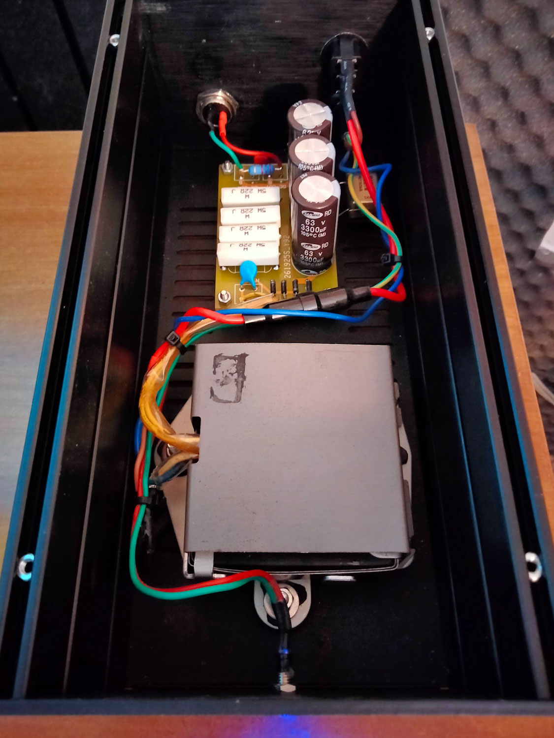

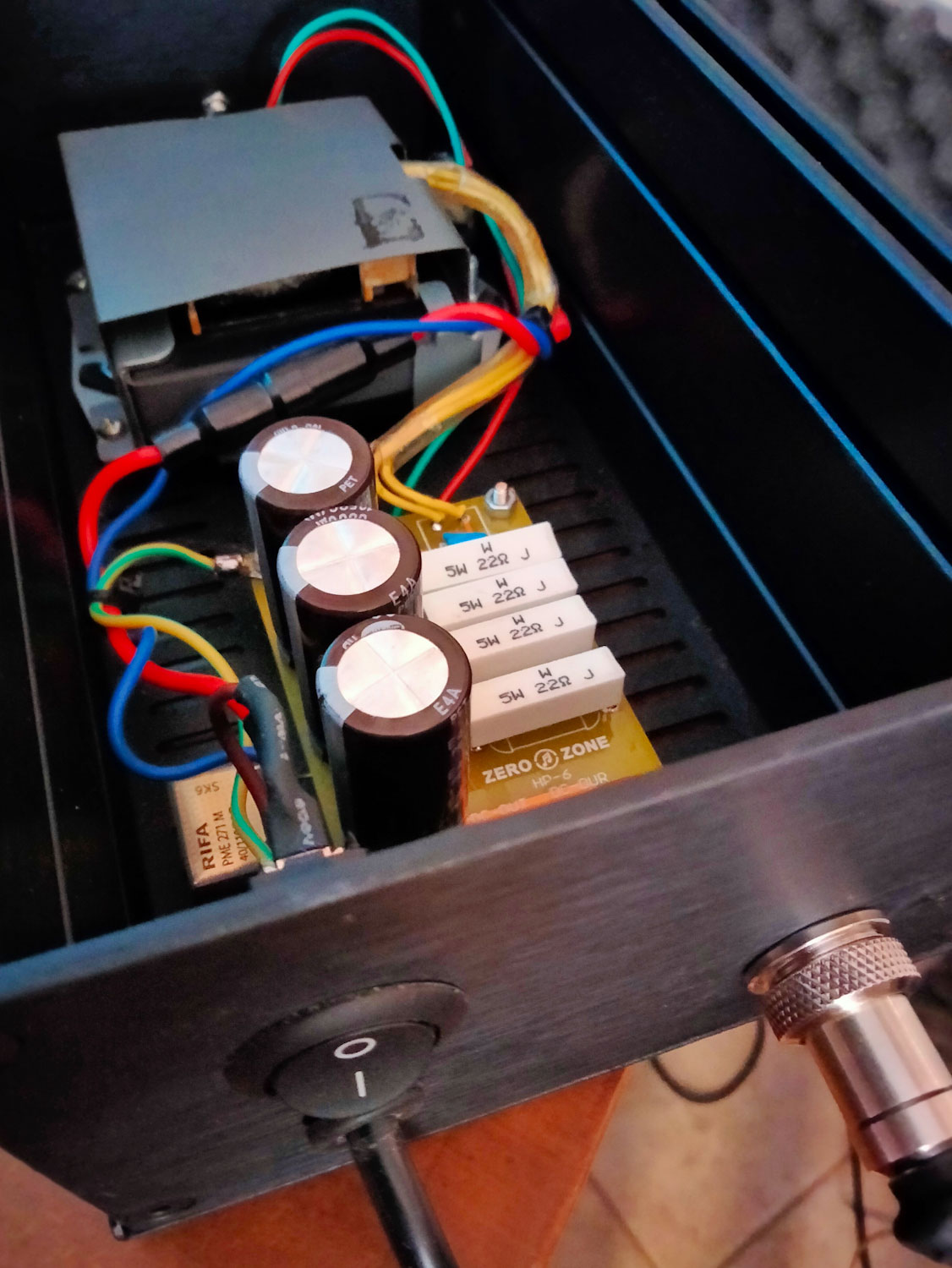

Fully balanced phono preamp
Here is my fully balanced phono preamp for MC cartridges, using LL1941 step up transformers and 4 X Tesla PCC88 tubes. Adjustable Gain: 62,66,72dB and Loading adjustment on secondary of LL1941 to match the cartridge. I used two case design for low vibration and to keep away the transformer from tubes. It has a mute circuit with delay. Maida style regulator on phono PCB, heaters are regulated.

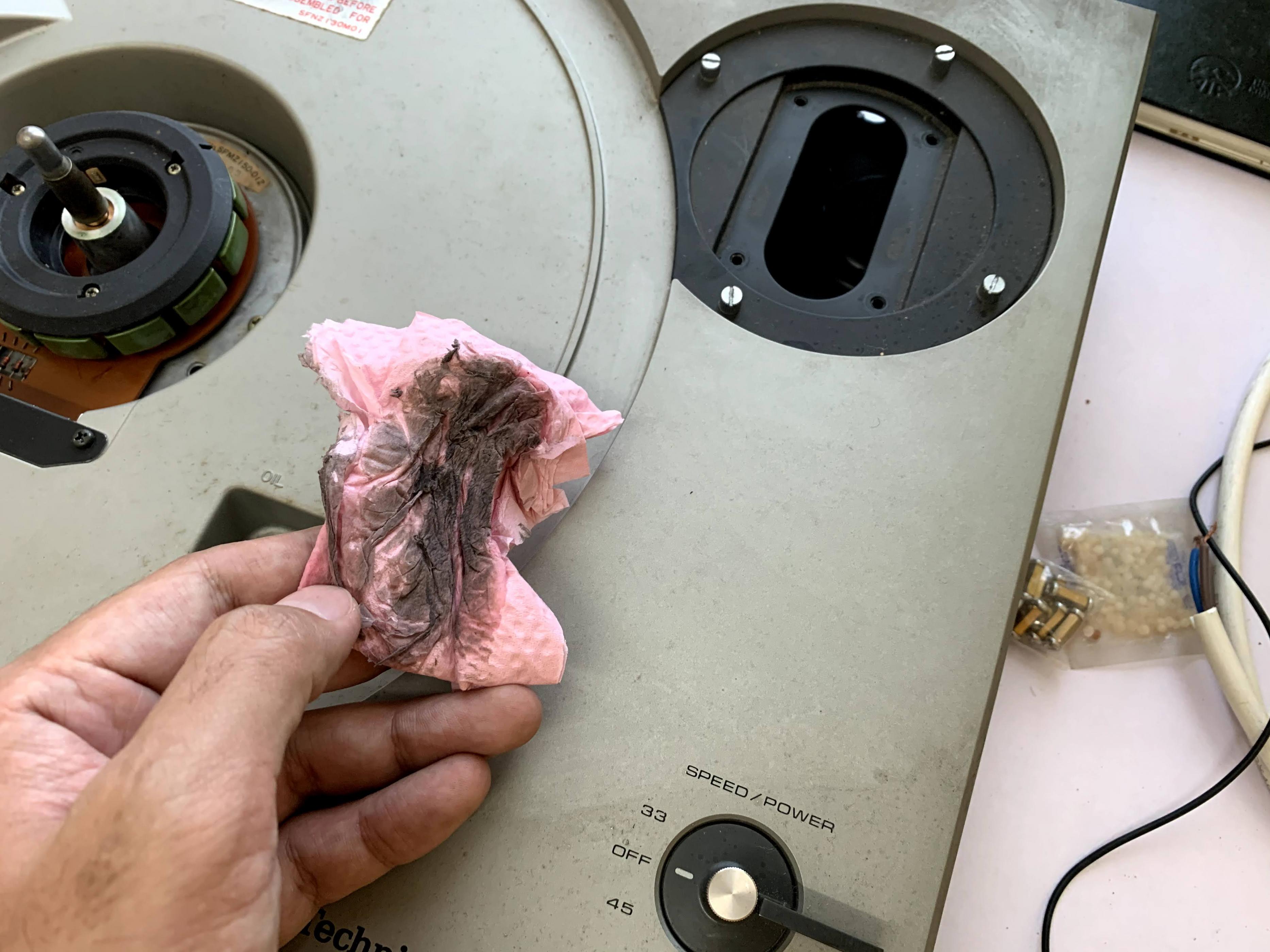

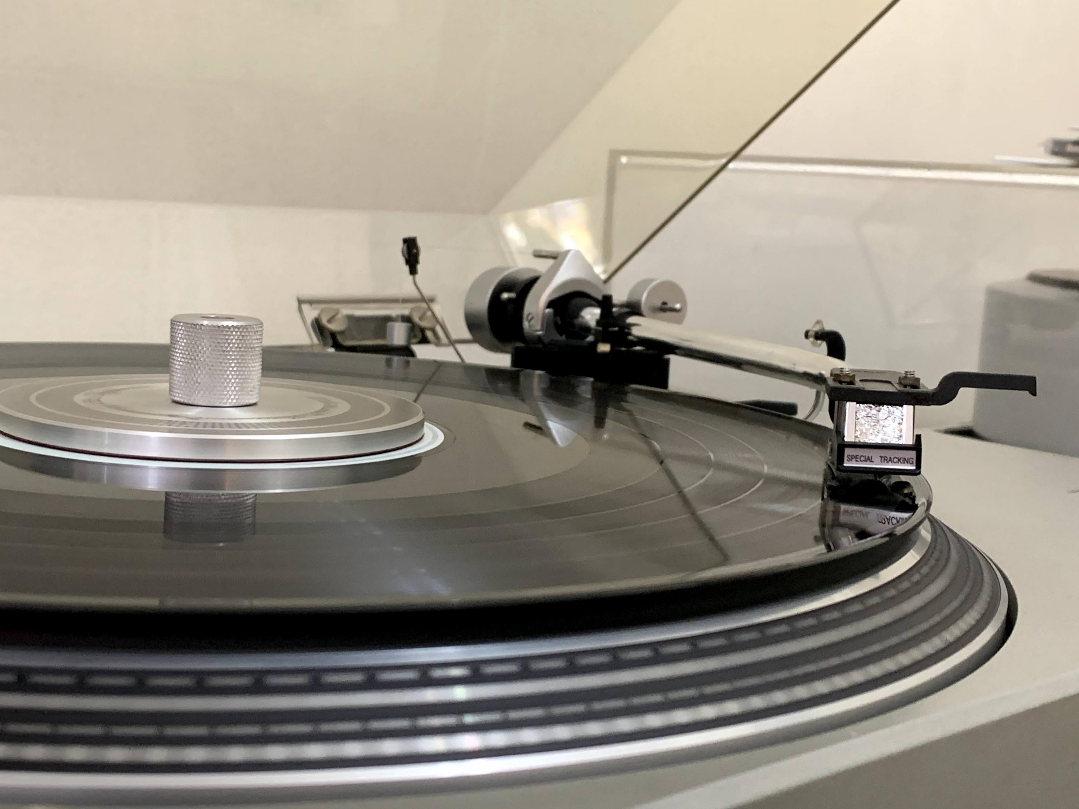

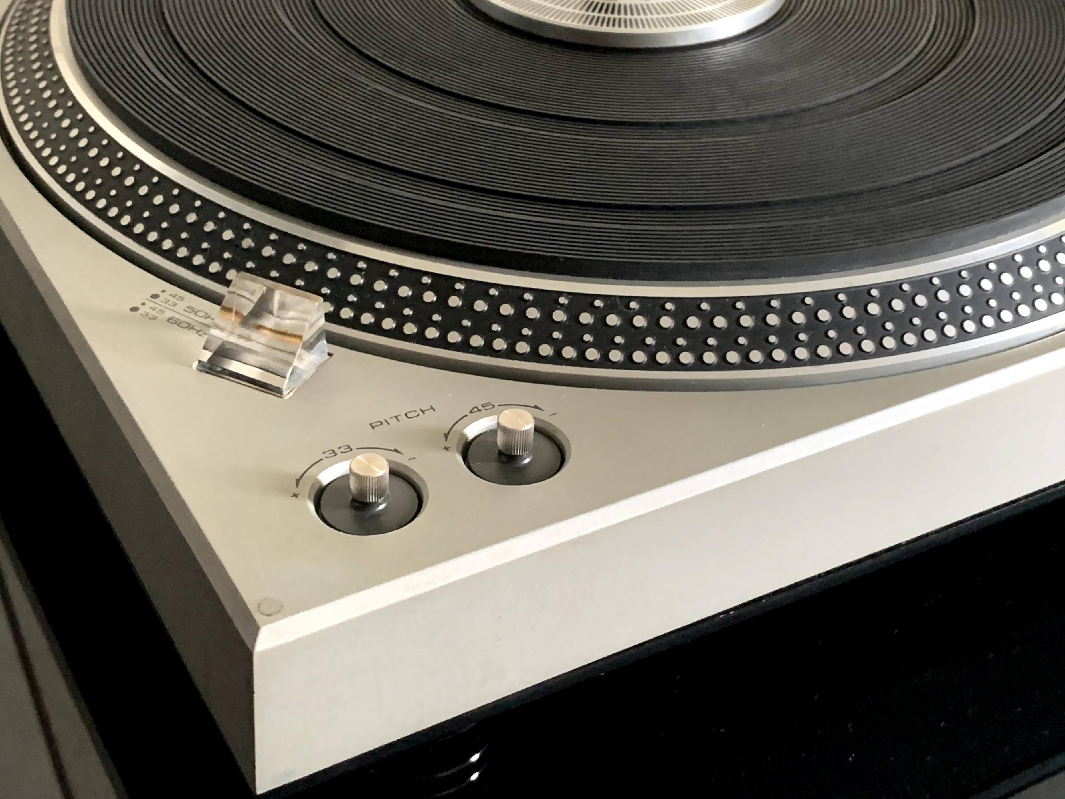

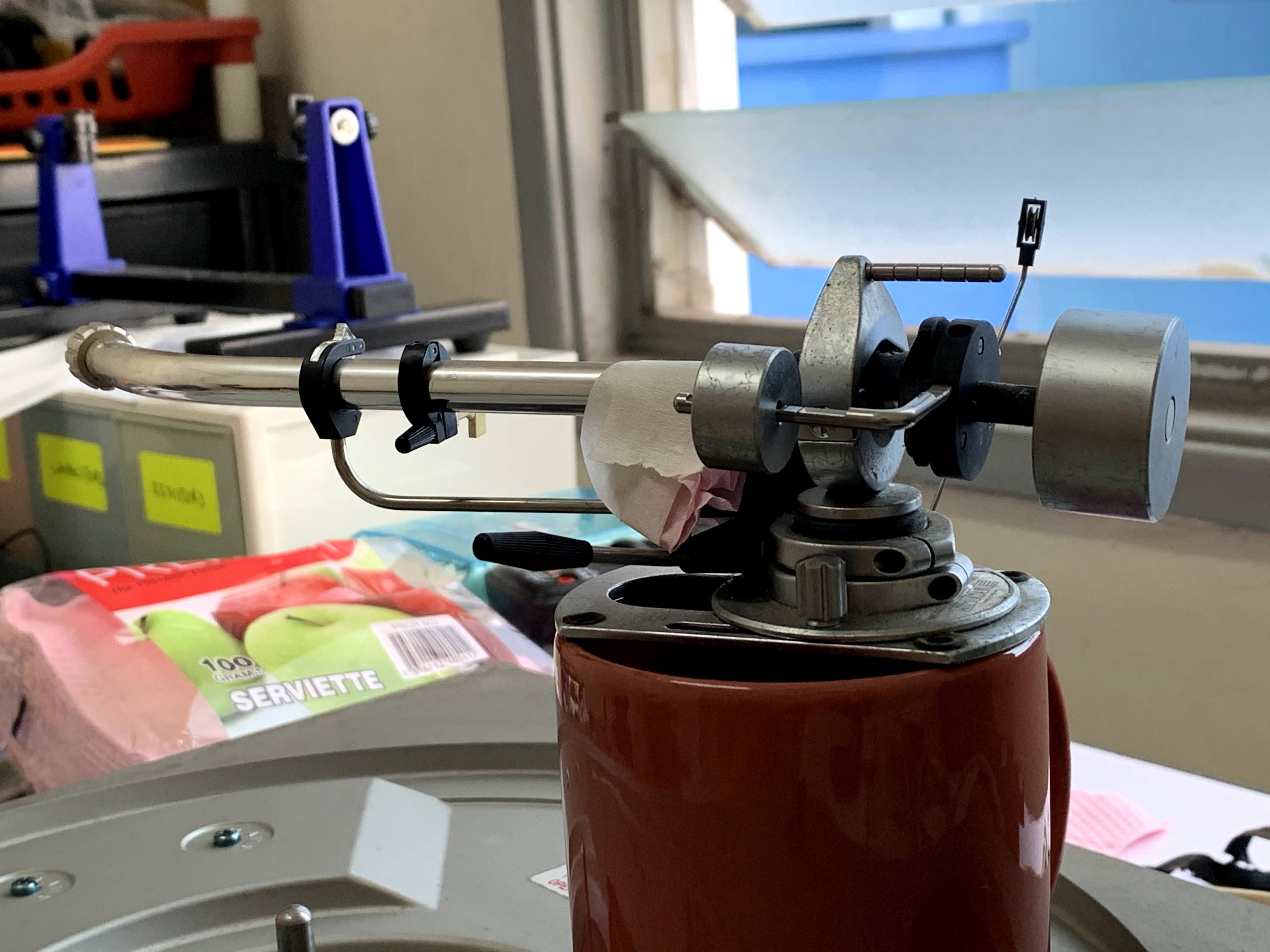

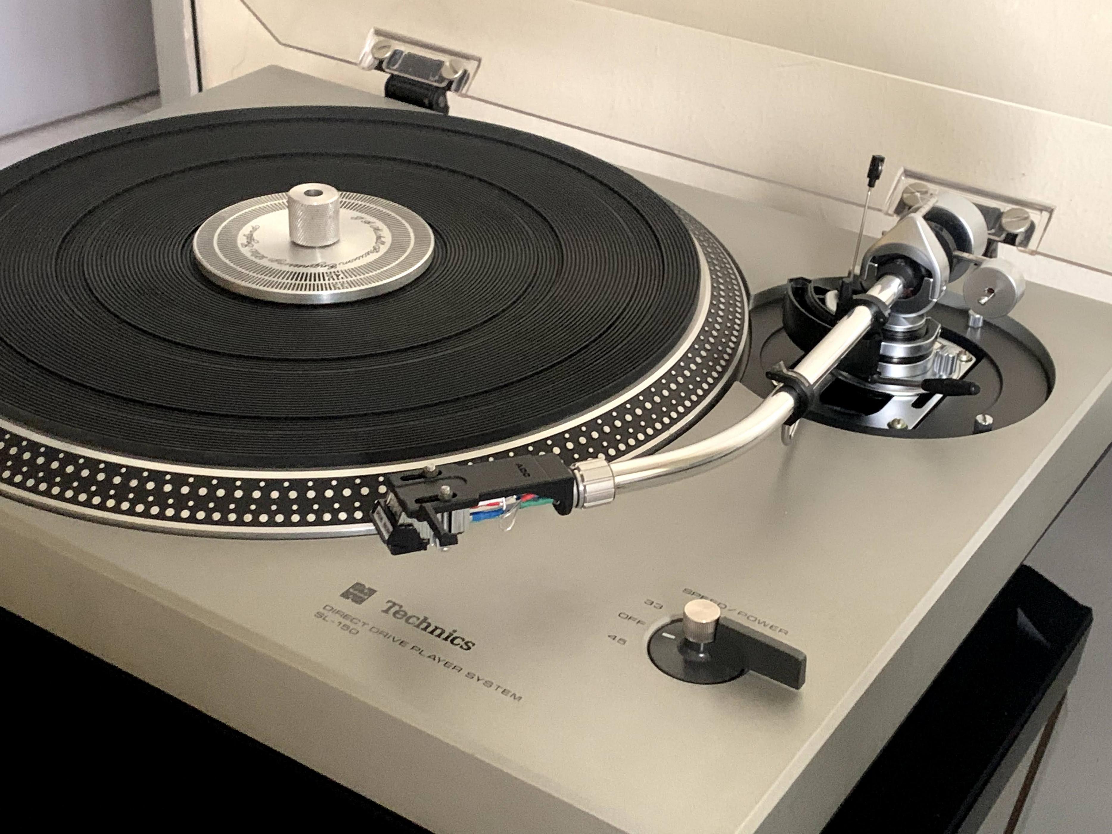

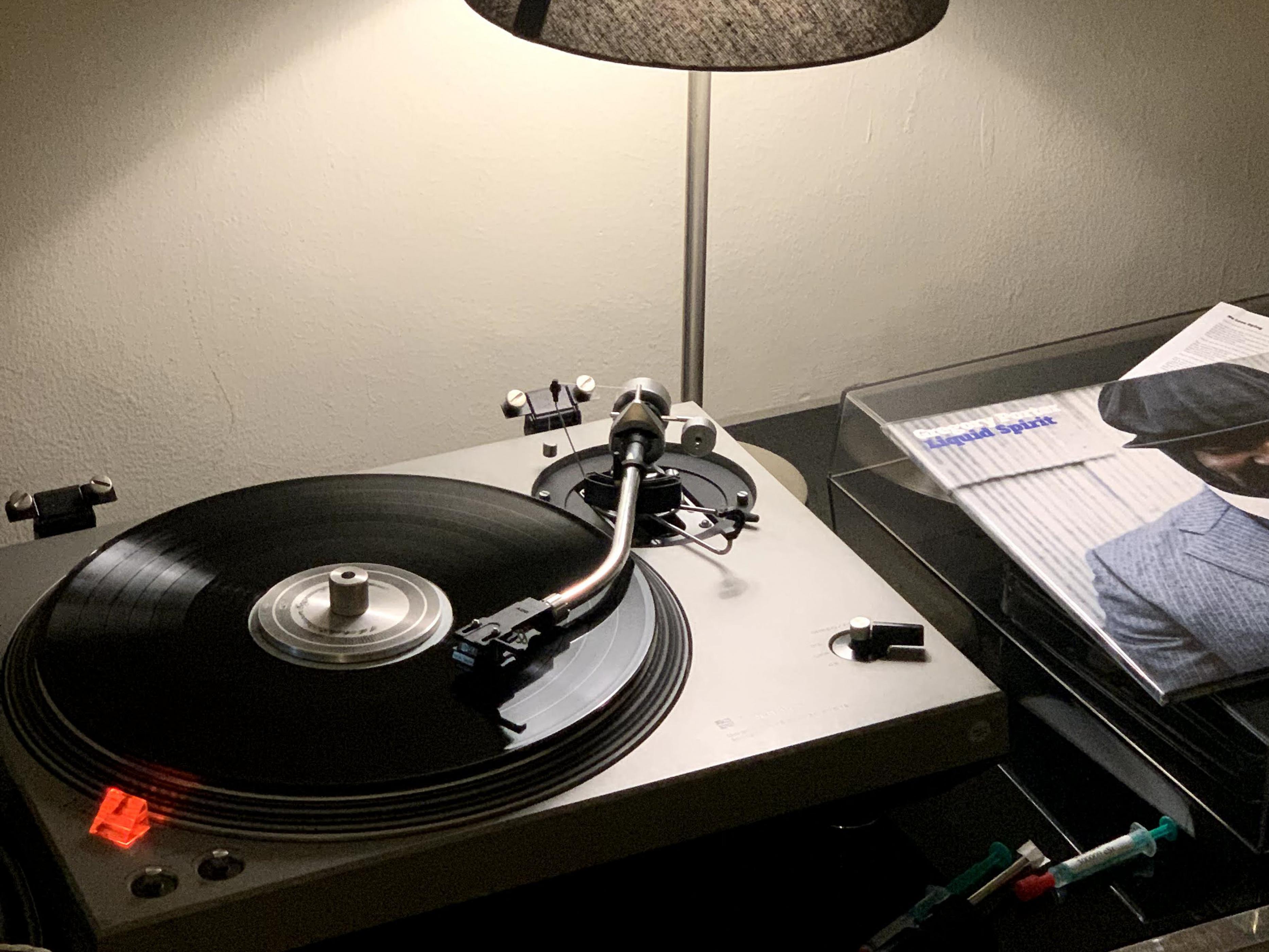

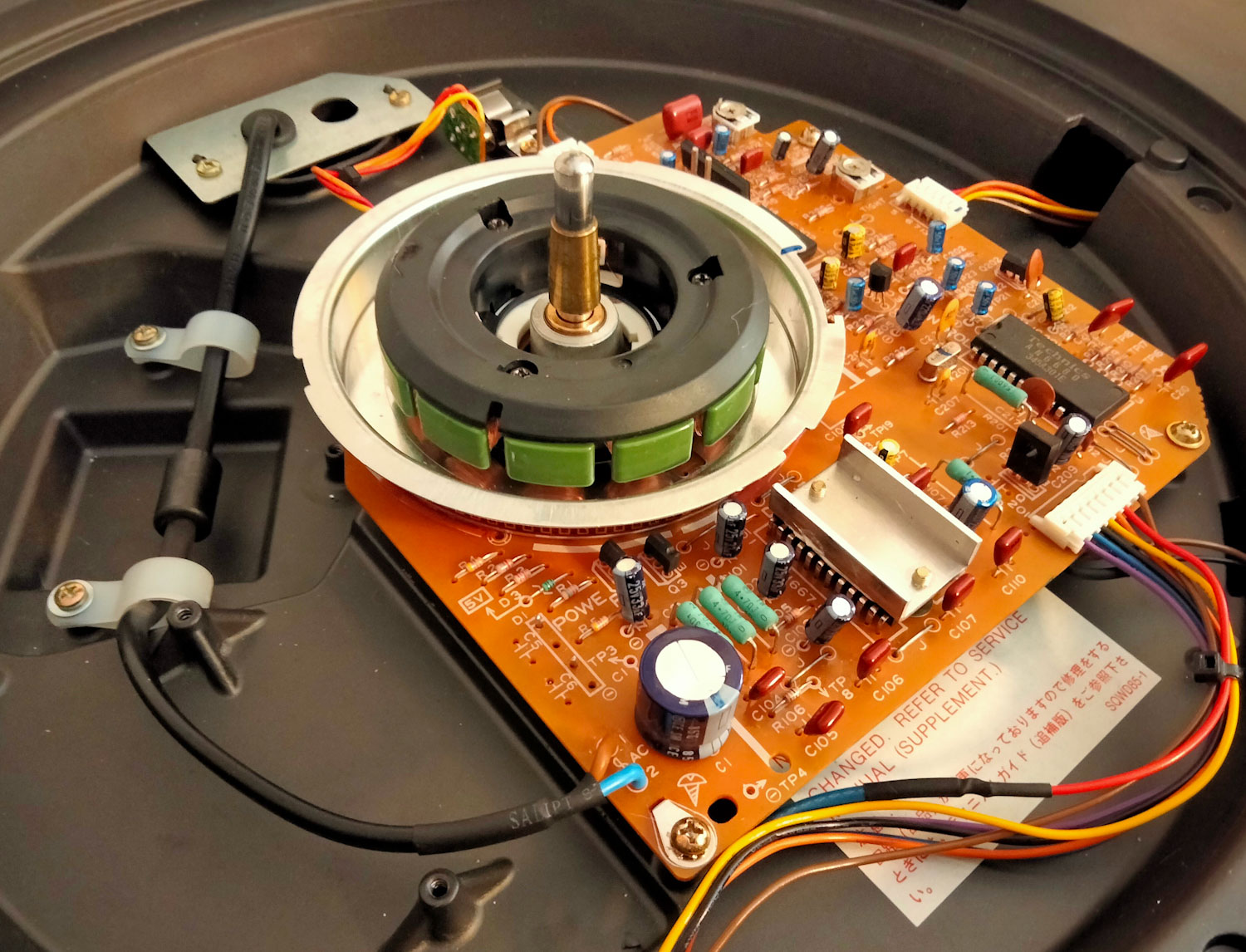

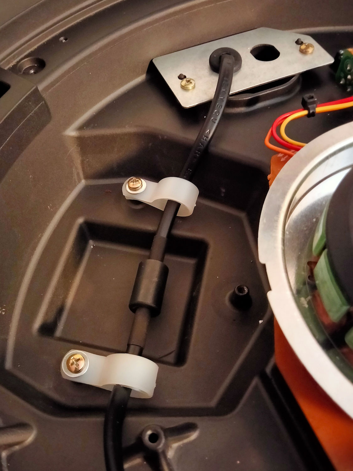

Here are some before and after shots of a recent restoration I did on a Technics SL-150.

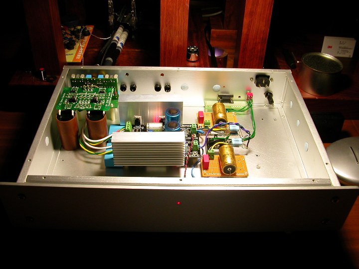

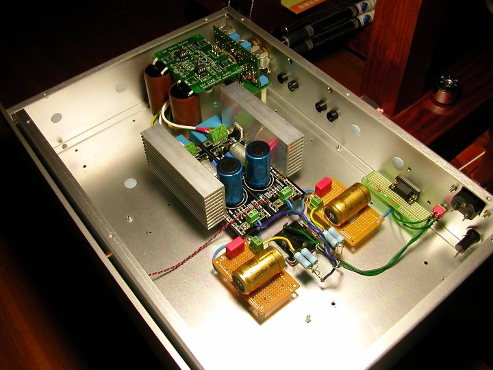

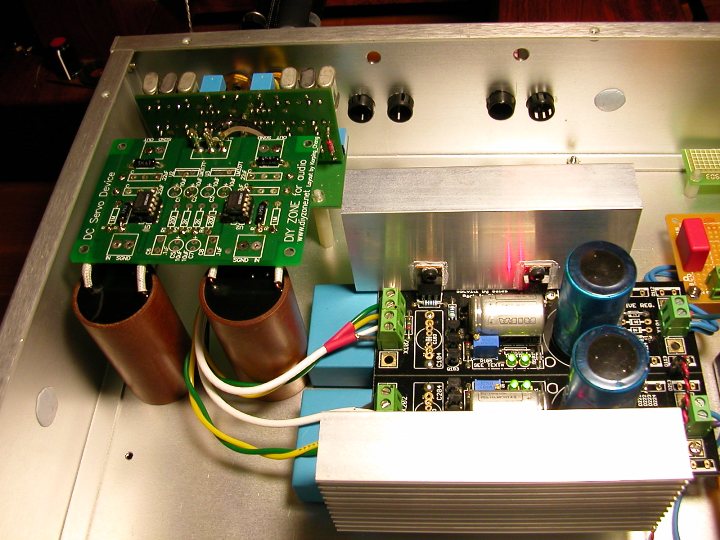

Phonoclone with Salas shunt regulator
[/URL]
[/URL]
[/URL]

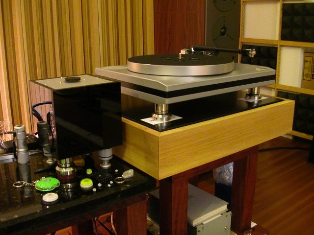

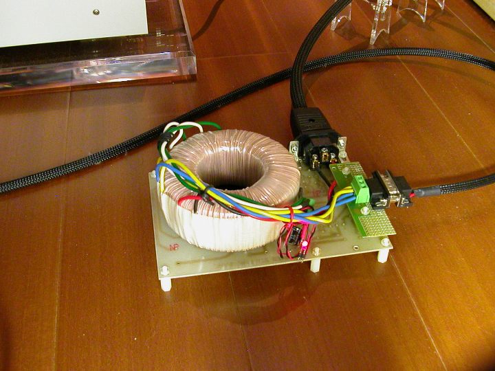

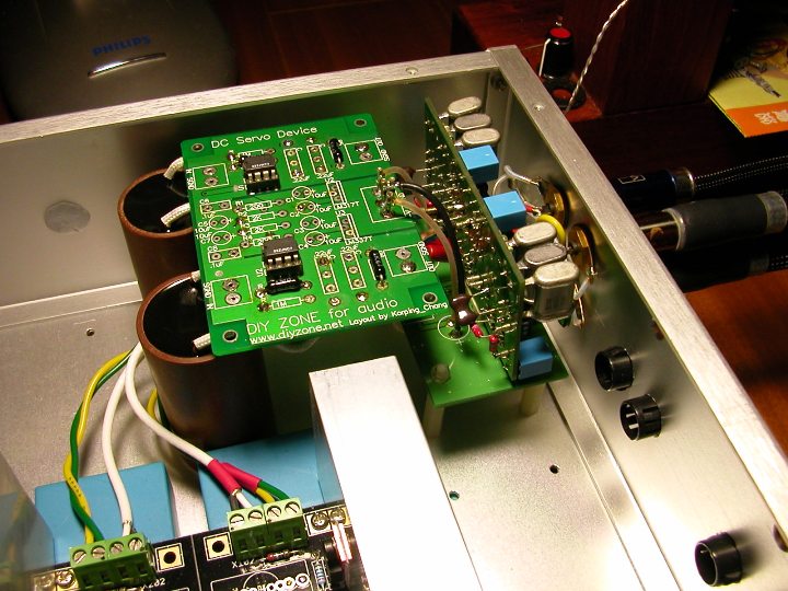

Thorens TD850 with SME309 tonearm
plus DIY motor power supply and motor base
