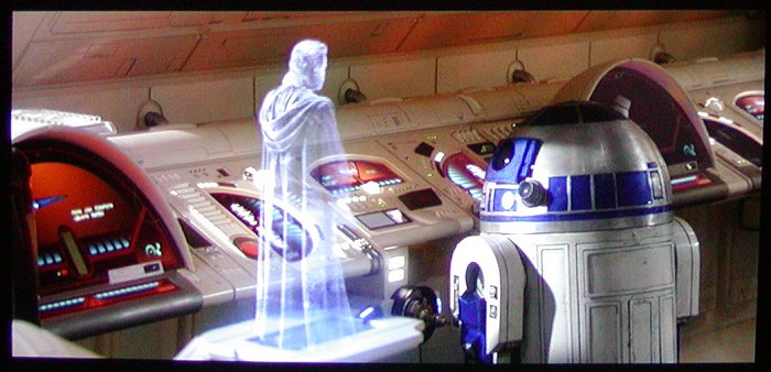

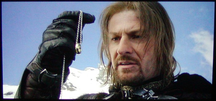

umeshkumar09 said:I cannot believe my eyes carpow.You must be using some sort of commercial PJ or some sort of a software to present such results !
Its diy PJ, 10.6 lcd (1280x768)
TV move:
http://tv.mofile.com/cn/xplayer.swf?v=MR6HN3UP
see pic.
40w philips daylight lamp power on:
TESCORP said:carpow has some nice pics here, of course the projector is close to the high gain screen. how well does it do at say 12 Feet. how far is it away from the screen now? really nice results!
on the wall, 70 inch
TESCORP said:so with your optics of 320 field fresnel and 320 triplet I calculate you must have your projector about 8 feet from the screen to get a 70" image?
70/10.6 = x/ 0.32
x= 2.11 m (lens to wall) = 8.3 feet
