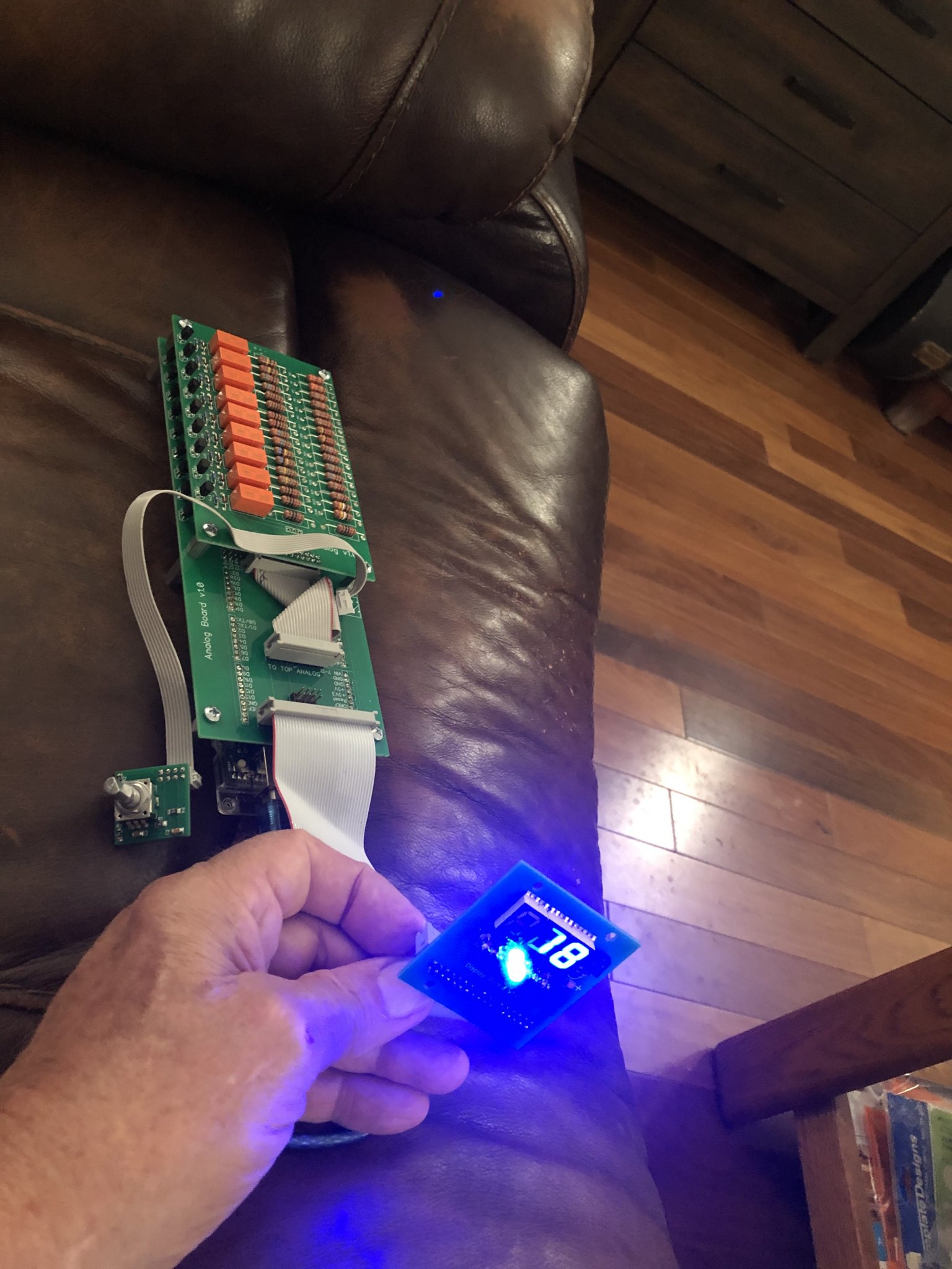

I have implemented a standby option, now over 1000 lines of code, granted their is some white space and comments but mostly code.
So I am on the horns of a dilema. The Pulse Width Modulation which is used for dimming the balance LEDS and display doesn't work on some of the pins where it should. I found that when the IR remote code is included the PWM on certain pins stops working. What do they have in common, the built in timers. So now I am having to go through the IR code and change over to a different timer, the Mega 2560 has 6 timers so not an issue, but have to see which timers are used for PWM and which pins they affect and choose the right one and possible change the PCB for these changes. Live and learn.

Tonight I dug into the IRremote code and found one module where an addition of a couple comment // on one line and deleting them on another line changed the timer from Timer2 to Timer5. An easy enough change but a lot of reading to find. I will find out if it affects the pins that are used as digital pins, D44-D46. Otherwise just have to work on the logic of the new code, then it is ready for listening tests. Fortunately no changes to the PCB required.
Reactions: 1 user
Still working on the code. Getting there. Here is a pic of the prototype.

Yesterday I finished writing and debugging the software. I then tried listening to it between my preamp and amps and found the volume control not working correctly. Found I had swapped the relay 1 pin with relay 8 pin, a couple minutes updating the code had it fixed and tested all the features with audio and found it to be good, great really. This morning I took it out to my audiophile business friend who will evaluate all the features and see if any changes are needed, might like different brightness on the LEDs or more volume difference in the balance control.
So as it stands now the Volume control will do: Volume (or course), Balance, display dimming, muting, and inactivate the preamp with a line to shutdown the preamp and amps if you want to wire that in.
The front panel will have a display for volume number and balance LEDs, Mute LED, and Standby (inactive) LED, and the IR receiver on one board. A Rotary Encoder that does volume up and down and the button on the rotary encoder is dual purpose, when the preamp is in Standby the button will "wake up" the preamp, when active it will mute and unmute. The IR remote is an Apple clone, or a real one, NEC coding; it does Volume up and down, Balance +3 db left or right in 12 1/4 db steps, mute/unmute, and activate/inactivate (standby).
I am turning the Display board to add an LED/resistor to use the RGB LED, with Red for mute, Green for Standby, and Blue for Active. The bottom control board is turning to reverse the board to board connector so the ribbon cable will be straight rather than twisted. Once I receive the new boards and test them then I will post the gerbers. In the meantime, here is the Schematics, BOM, and the code. Using the CCF Vishay/Dale resistors over the RN65/70 saves about $65, and sound so close I can't distinguish the difference. The PCB has a dual stuffing option for the load resistor which sets the input resistance at 10K, you can use the Vishay/Dale or a Caddock in that position. The Caddock spec better but I can't hear the difference and they are Freaking expensive.
I have also tested a couple different versions of the Arduino Mega2560 Rev3, one a real one $32, one a Chinese clone at $20, works fine, since the design is open source they should all work.
