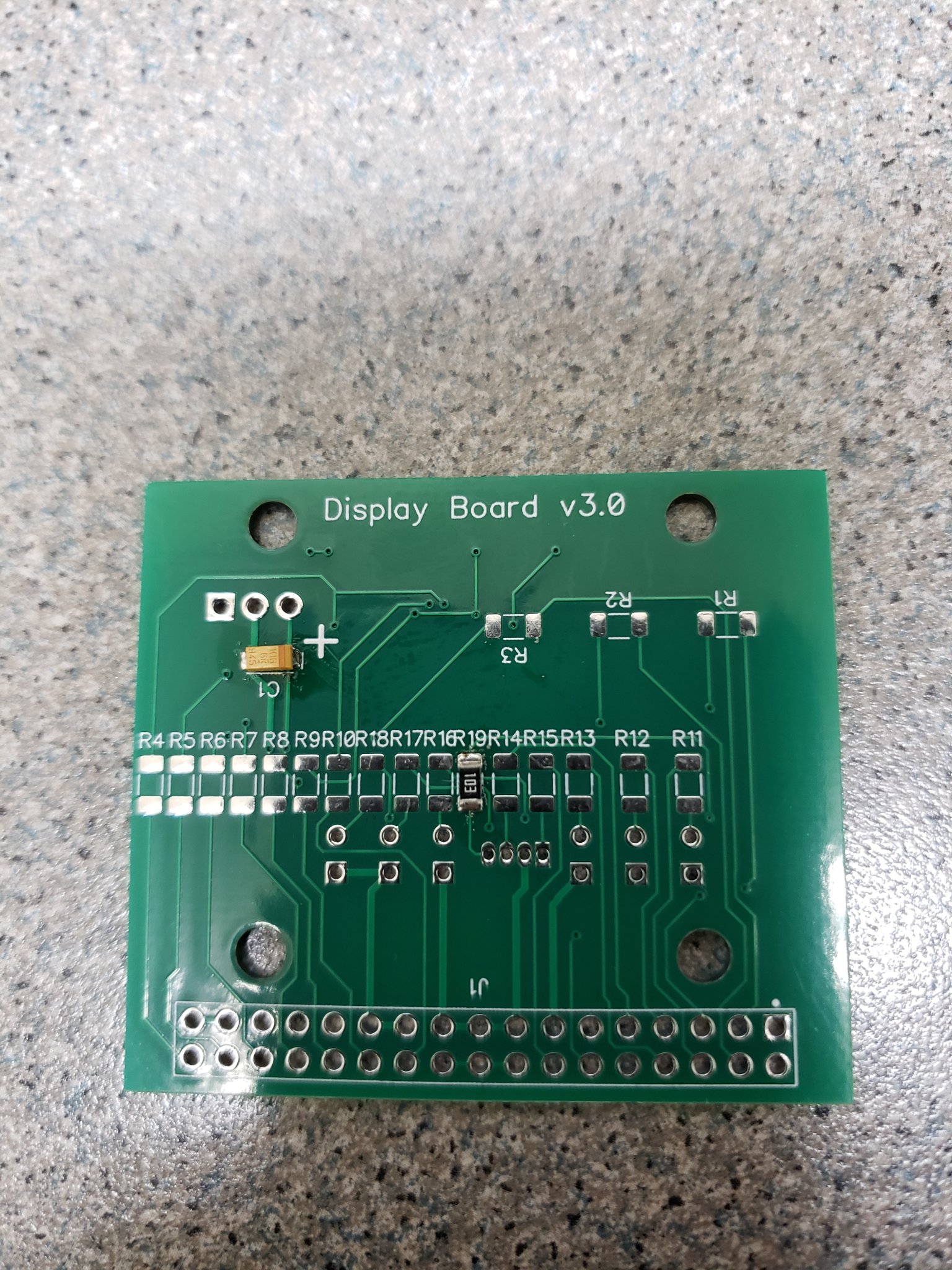

Over the weekend I built up 3 more fully sets of boards for my friends business uses and thought I would list the things to watch out for.
First mistake I made was the 3mm LEDs on the display board in backwards, there is not a flat on the side of a small LED. The PCB has a small dot on it for the Cathode and a square pad, the Cathode is the short leg. :)
Second most likely mistake is the SMD Diode on the encoder board, there is a polarity stripe on the top of the diode, not easy to see but it goes to the edge of the board, not towards the center as I did on one of the boards. You know you got it wrong when the button push of the encoder doesn't mute the preamp.
And finally be careful crimping the Insulation Display Connectors, IDC, on the ribbon cables, smaller ones are easy but I let the cable slip on a long connector as I tightened the vice. If that happens and the cable doesn't work you can lift the ears of the connector gently, pop off the top and remove the ribbon cable for another try, just don't pull straight up on the cable, kind of start at one side and roll the cable out of the cutters so it doesn't pull any of the cutters pins from the connector.
A tip for the header to Arduino Mega board connectors, put the headers into the Mega connectors, put the assembly on the underside of the lower, long, PCB and solder the pins, this keeps them lined up perfectly so you will be able to plug and unplug the Mega from the main board easily, if you need to, I haven't had to yet.
Most everything else is fairly obvious, If you have a lead forming tool then use it on the volume resistors for a good looking board, .8 width.

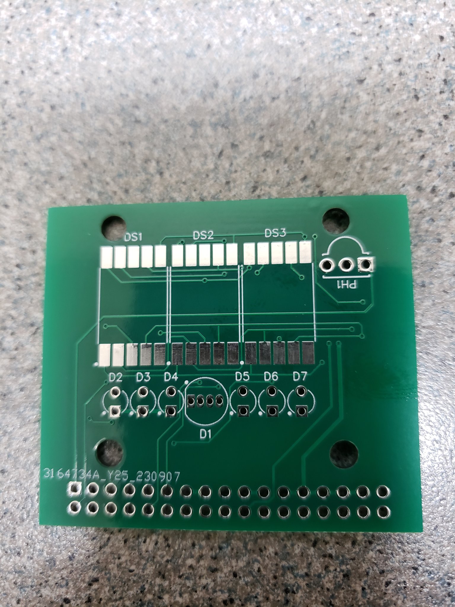

@johnhenryharris on the V3.0 Display Board, are D2, D3, D4, D5, D6 and D7 populated? They are not listed on the BOM and not quite sure what they would indicate since D1 indicates almost everything.
Well damn, don't know how I missed that one, the BOM should have six 3mm blue leds and display the balance. The D1 is an RGB LED, Blue is active, Red is Mute, Green is standby. There should have been a line like this on the BOM:
Blue LED, display3.2fv 20maD2-D7C4SMK-BJF-CQ0T0352941-C4SMKBJFCQ0T0352M44$0.18$0.72
Joined 2014
OK, that makes sense. I'll add them to my next order. I populated the volume encoder board and about half of the display board tonight. Had to order the power supply board and input encoder board from JLCPCB, missed those the first time around. Making progress. Mouser doesn't have the 20 position cable ends. I'll search for them from somewhere else tomorrow.
Well, I have egg on my face again. The part number listed for the 20 pin IDC cable end was wrong, it was for a 24 pin. So, I have fixed the part number for the cable end and added the LED line to the BOM. There are over 3000 20 pins in stock at mouser. Here is the updated BOMs. So hard to cross check every part number in a timely manner.
