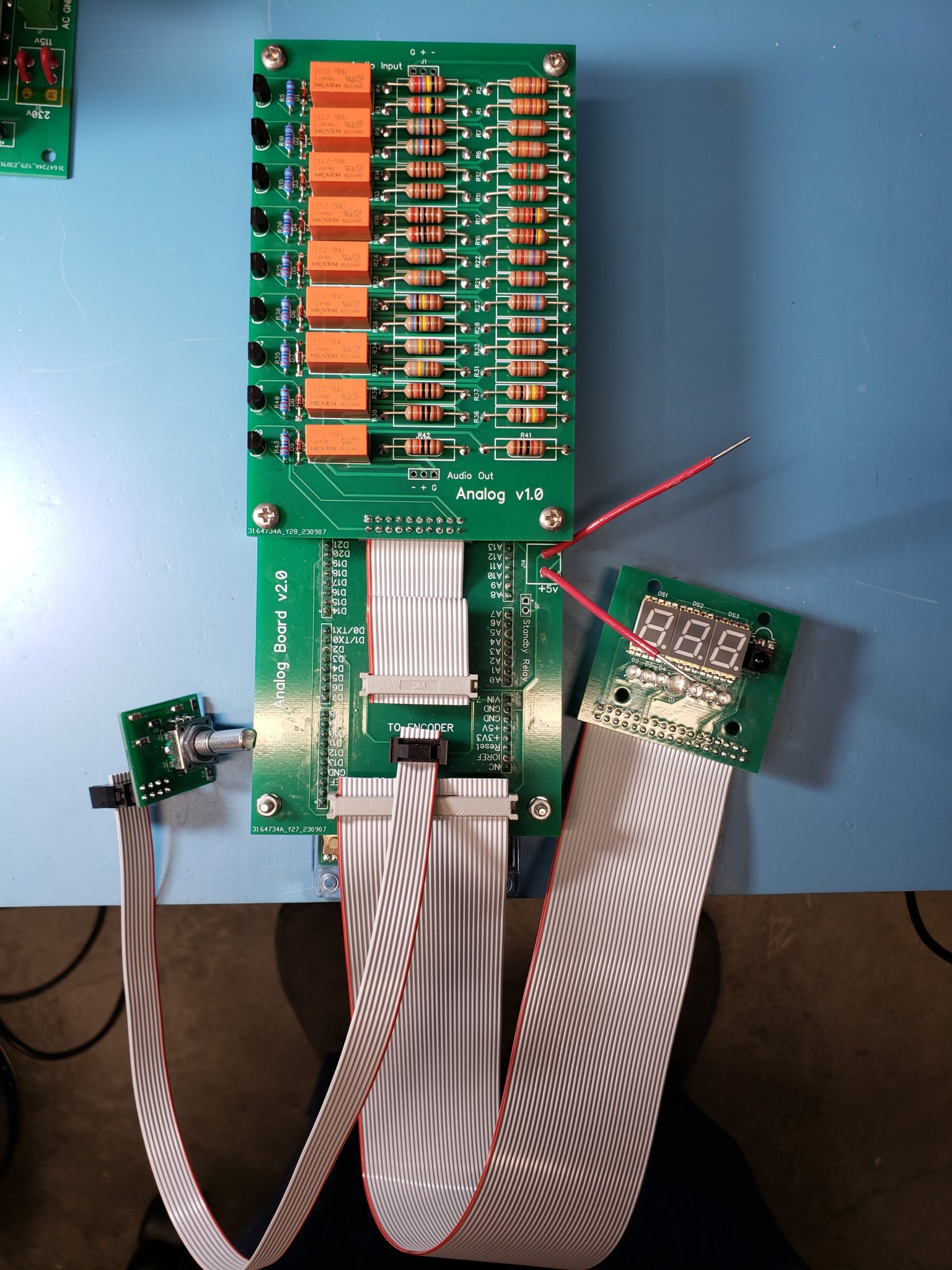

Making progress, have both the Arduino Mega and Nano uploaded, both analog boards populated, the volume encoder populated except for the 6 blue LED's and ribbon cable ends, the Display board populated except for the ribbon cable ends. Waiting on the input encoder board and power supply board to show up and the parts for both.

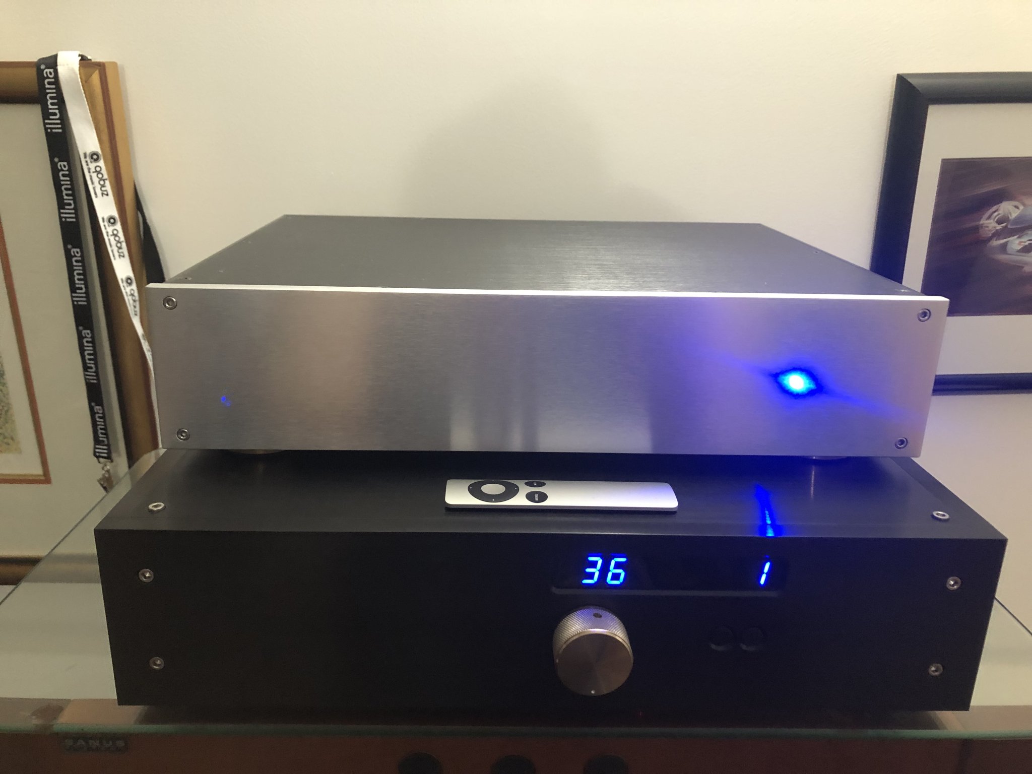

I use my preamp in both single ended, Turntable to phono-pre to line pre, and balanced from CD to preamp. And for grins here are more pictures of the preamp. It uses the previous generation of preamp controller, Arduino Nano based (no balance, standby, or display dimming) same good sound. The chassis is one I did CAD drawings for and had made at my favorite machine shop. The power supply chassis on top is from ebay and customized to the task.

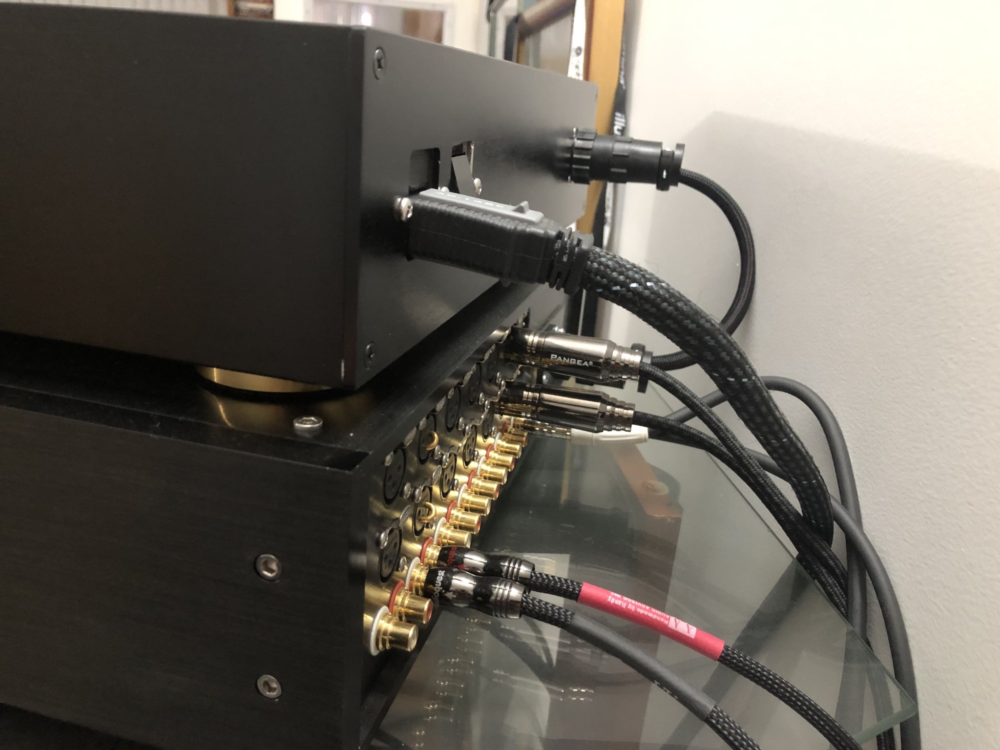

And a rear view with connections and DC umbilical. Notice on the rear panel above the used RCA connections is a piece of 12 gauge copper wire, ground wire from Romex, bent in a small U and inserted from pin 1 to 3 on the Balanced input connector. My Preamp gain section is fully balanced so if you use single ended must ground the negative input.

As soon as you supply power to the boards the Arduino should power up, run through its setup and light up the display with a Zero and red on the center LED for mute, provided it has been loaded with the code. If it is not coming up, if you power the Arduino through a USB with the main power off does the board power light come on, if not you have a short in one of the boards. Unplug the Arduino and power it up, if that works connector it to the main board with all ribbon cables disconnected. Does the Arduino still power up, if not, the short is in the main board, if it does, power off and connect the encoder ribbon cable, power on, does it still work, if so power down and connect the encoder board to the ribbon cable and power up. If it doesn't power up the problem is in the ribbon or encoder. If it does power up then repeat with the display ribbon then board, powering off each time between, then the second relay board.. You can see you are trying to isolate the problem area.
So far I have seen: solder shorts on the display, a reversed polarity power connection (took out the Arduino and IR receiver), and a bad ribbon cable from main board to display. Also found one Arduino the was bad, would overheat in a couple minutes and freeze. Good luck and let us know what you find.

I wasn't clear. I am powering up for the first time. I have powered up the selector board and encoder and it is working perfect. I do notice the selector encoder only moves the selections when turned clockwise. It does nothing when turned counter-clockwise.
I will power-up the other boards and see if it comes up as expected.
Joined 2014
Powered it up and everything worked great except for one left balance LED. I will troubleshoot that. May also order the LED's you recommended, these are not changing brightness very much. Scared the hell out of me, I powered it with a bench supply so I could limit current to 500mA. Well at volume step 255 it pulls about 500mA and tripped, LOL. I heard Wayne Coburn is releasing another preamp design, I may put this in that if it looks interesting, if not I'll retrofit it into my BA2018.

Also the input selector should go up and down turn right and left. If it continues to not work first check you are getting pulses to the Arduino per the schematic. Worst comes to worse you can mail one setup to me and I will troubleshoot it for you.
