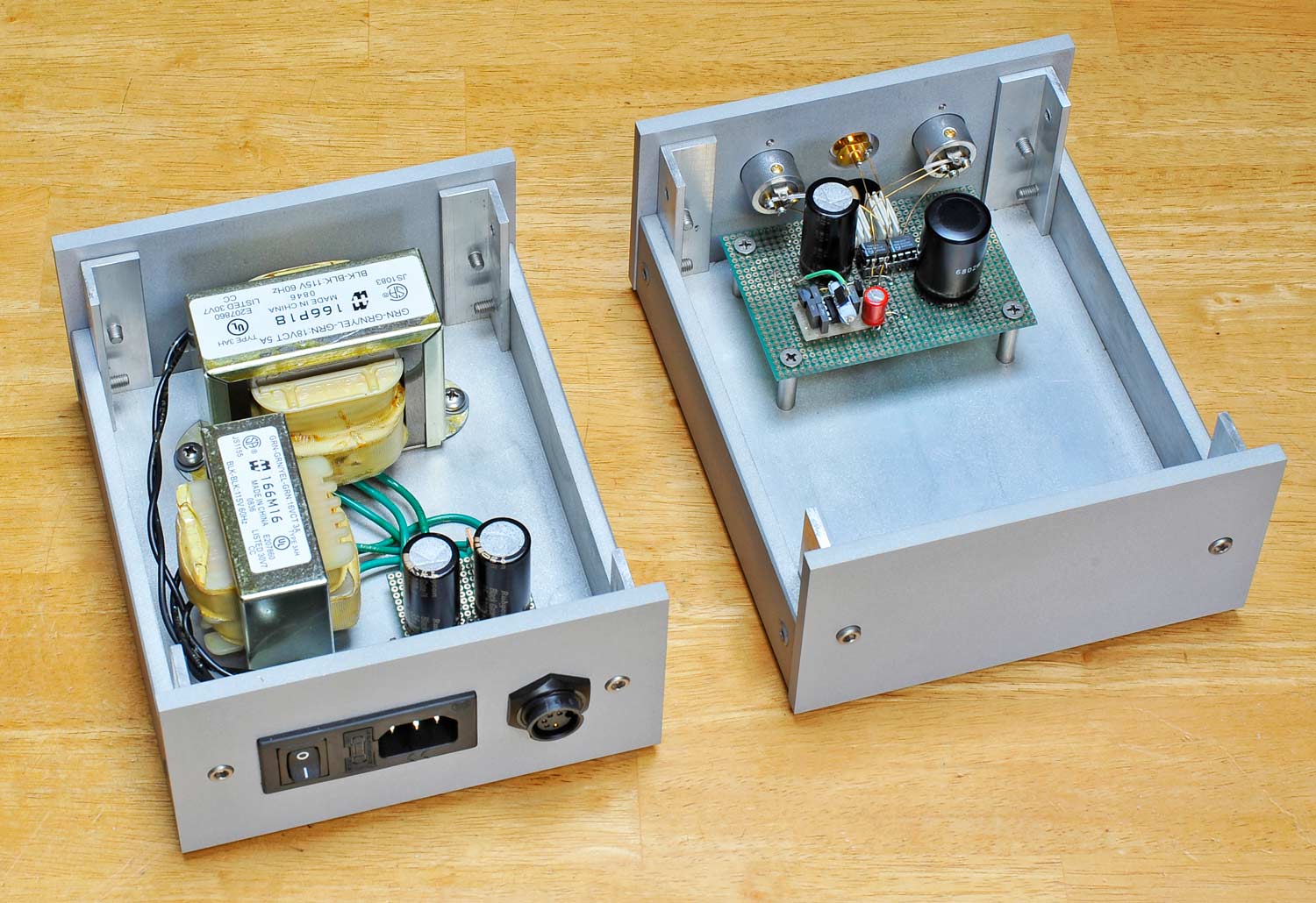

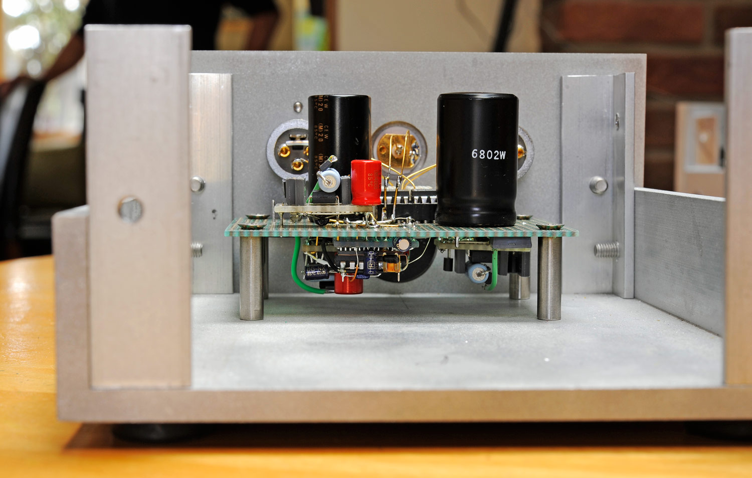

While Bobken's DAC is unbalanced, I decided to go balanced as in my tests it sounded superior. Feeding the output into S&B TX102 line stage allows me also get rid of any coupling caps. With careful chips selection the differential offset is below 10mV.

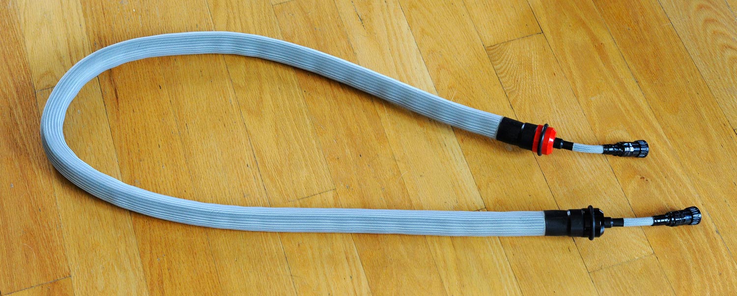

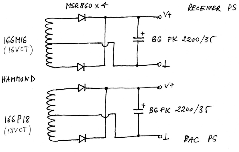

Here are the picture of the most recent version; the separate PS with dual transformers and special umbilical cable are important part of overall performance. Since I didn't produce any boards for that design yet, everything is hard wired.
I will post schematics tomorrow.

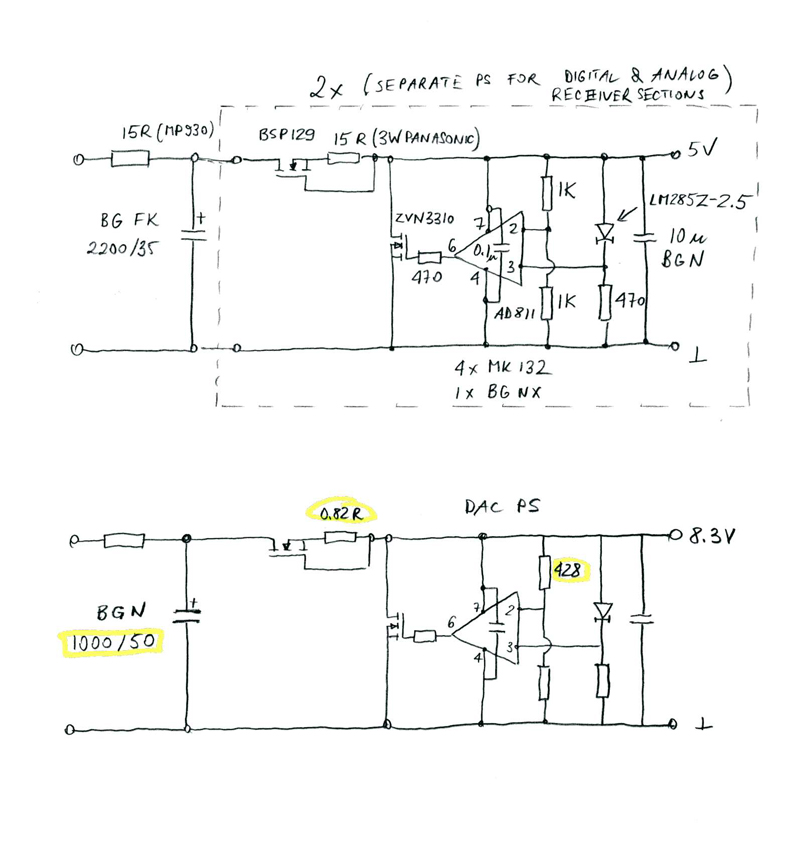

Here are the regulators. I'm using two separate 5V regs for receiver's analog and digital sections and 8.3V for the DAC chips. If using a single DAC chip (unbalanced topology) the current setting resistor should be 3R8.
Except for 3 highlighted locations all the parts are the same.
For best results, the parts choices are critical.
The shunt regulator is based on Paul Hynes Z7808 Series1 module and was suggested and later optimized by Bobken

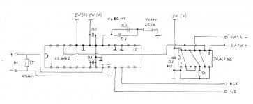

This is receiver and phase splitter circuits.
The three BG NX 0.1uF caps are mounted directly on the chip pins. The 10uF BG NX are directly on regulators daughter boards.The 5V analog supply is connected only to pin 22 of CS8412, the 5V digital supply is shared between receiver and phase splitter chips.
The PLL filter components are very critical. Countless hours have been spent here and initially different values were used. As the voicing and tuning of DAC circuit progressed, different values have been selected here as well. Most of the input for this section comes from Bobken, I was mostly checking out what he suggested. There are two 0.1uF caps in parallel. When I was checking my BG NX stock, it seemed like those caps were usually on a higher side and it's quite possible to find one that is already 0.2uF in value.
Nude Vishay works much better for input shunt than Caddock in this particular circuit, also nude Vishay was selected for PLL section, although I also tried S102 and it worked fine.
The data signal is converted through a logic chip into positive and negative signals and fed to a separate DAC chips. If balanced output is not required, the logic circuitry can be omitted or it can be still used to control phase of the DAC as reversing inputs at CS8412 will not reverse polarity and the passive I/V DAC will reverse polarity.
I tried quite a few digital transformers at receiver's input and it's my conclusion that all digital transformers were actually degrading sound with no benefits observed at all. The worse were Newava, while old stock SC and Lundahl were actually quite good, but still introducing their own signature.
I decided not to use any coupling caps as sound purity was my main objective. Two of my listening associates actually preferred the caps and for their DACs I installed them. It seems like TFCu V-Cap works best here (to them it was sound improvement) with higher value preferred (0.1 vs 0.022). To me the coupling caps, while smoothing the sound, will also affect immediacy and micro detail.
Also, you may notice that I'm not using 75R BNC connector. The listening tests I've done, indicated that connector type influence was rather subtle, if noticable at all, and not important in a bigger picture. The digital cable type was OTOH very influential and since all my cables were RCA terminated I went with RCA input connector as well. I also compared so called 75R digital RCA from Canare with stock Furutech, and again, we didn't observe anything unusual.

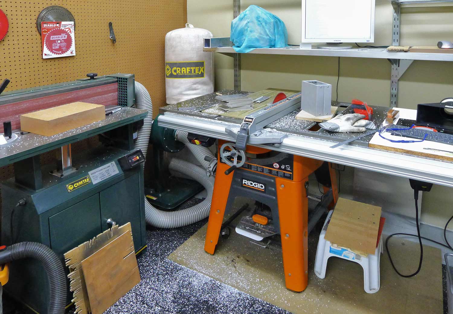

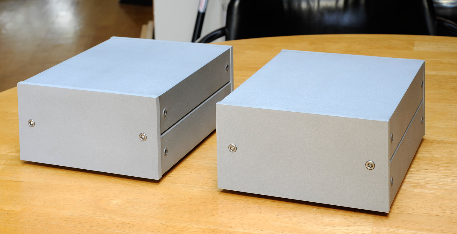

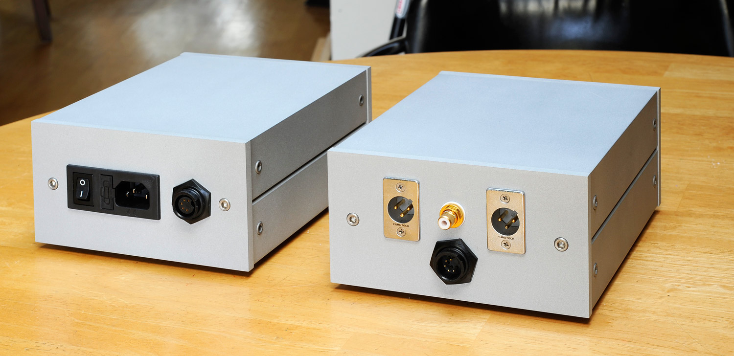

I wanted to make the cases out of 3 x 6" aluminum extrusion but it was hard to source it locally. So instead I used 4 x 6 extrusion, cutting it in half to reduce the height. It actually came out better this way, with a ventilation slot and less resonances.
4 angles and 12 screws hold the whole structure together, it's all very rigid.

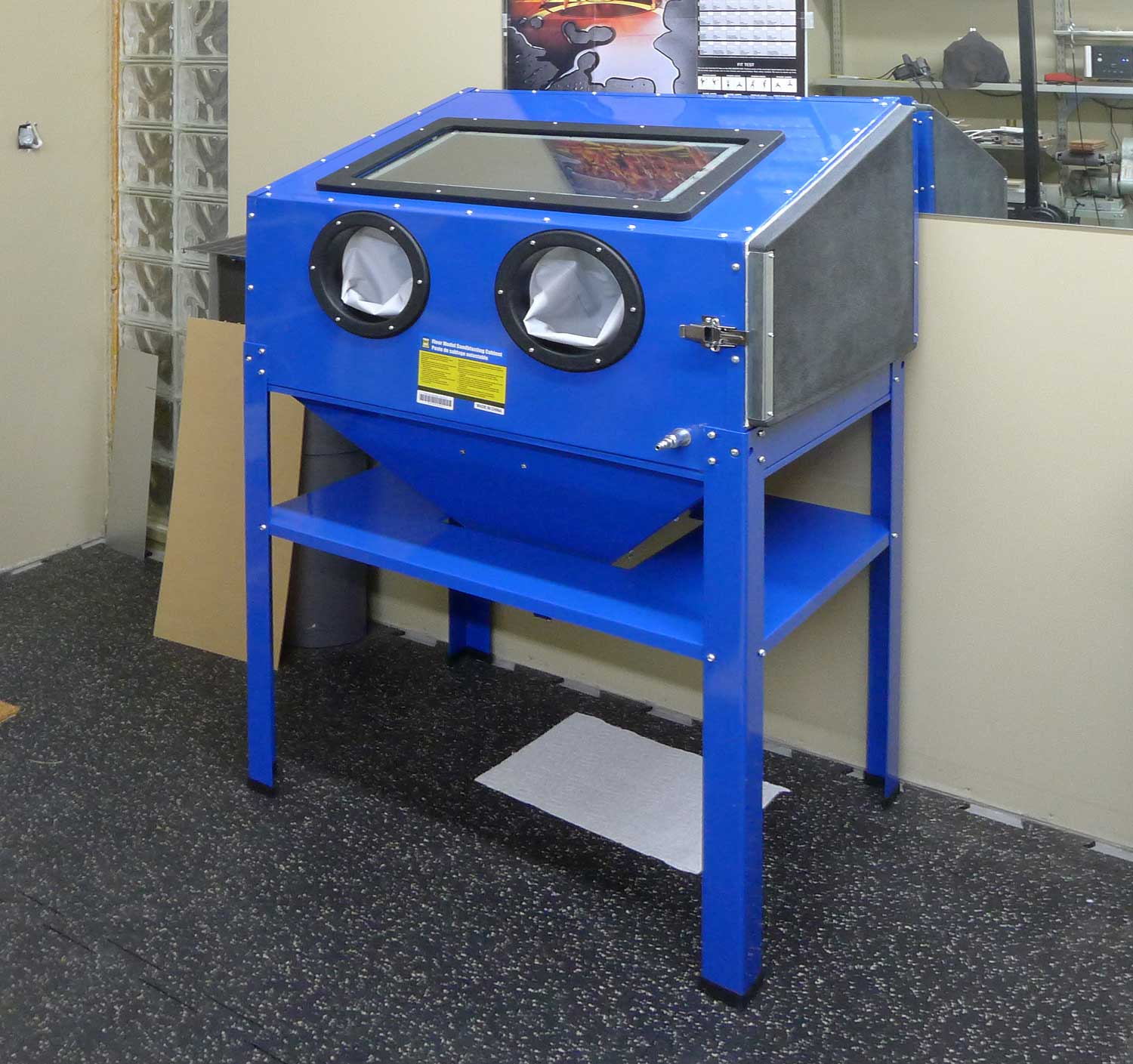

I cut everything myself and finished with bead blasting (aluminum oxide, 80 grit). Later it was sprayed with Engine Finish which produces quite durable and basically invisible shield.
