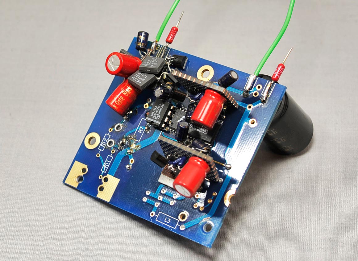

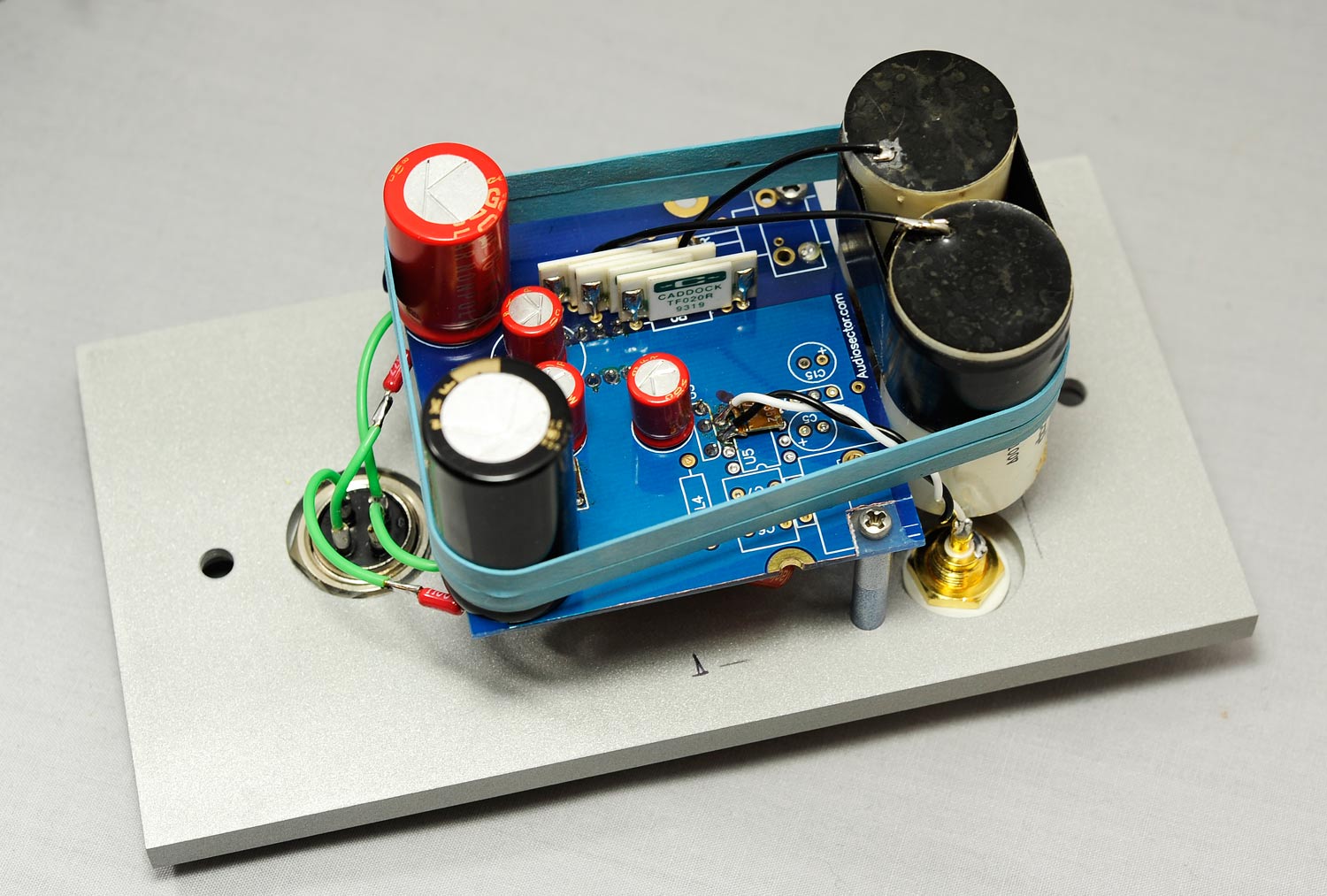

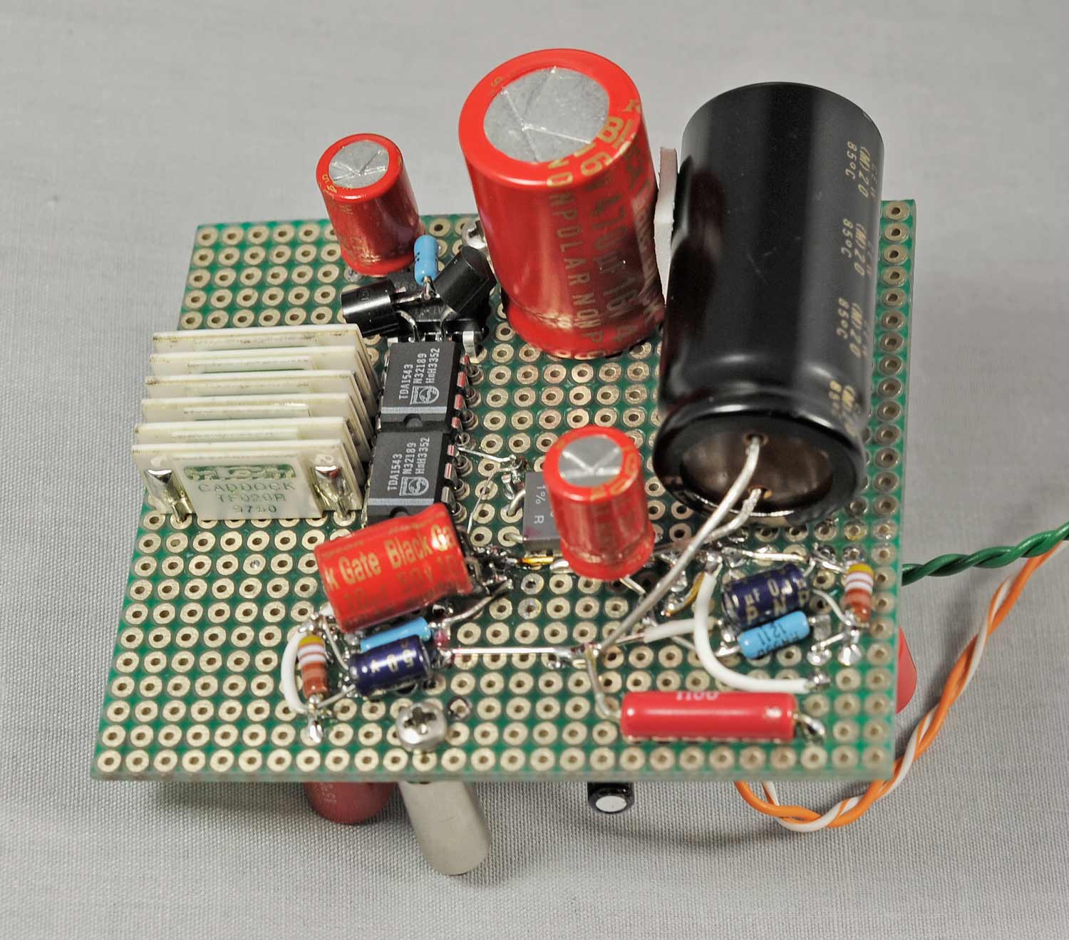

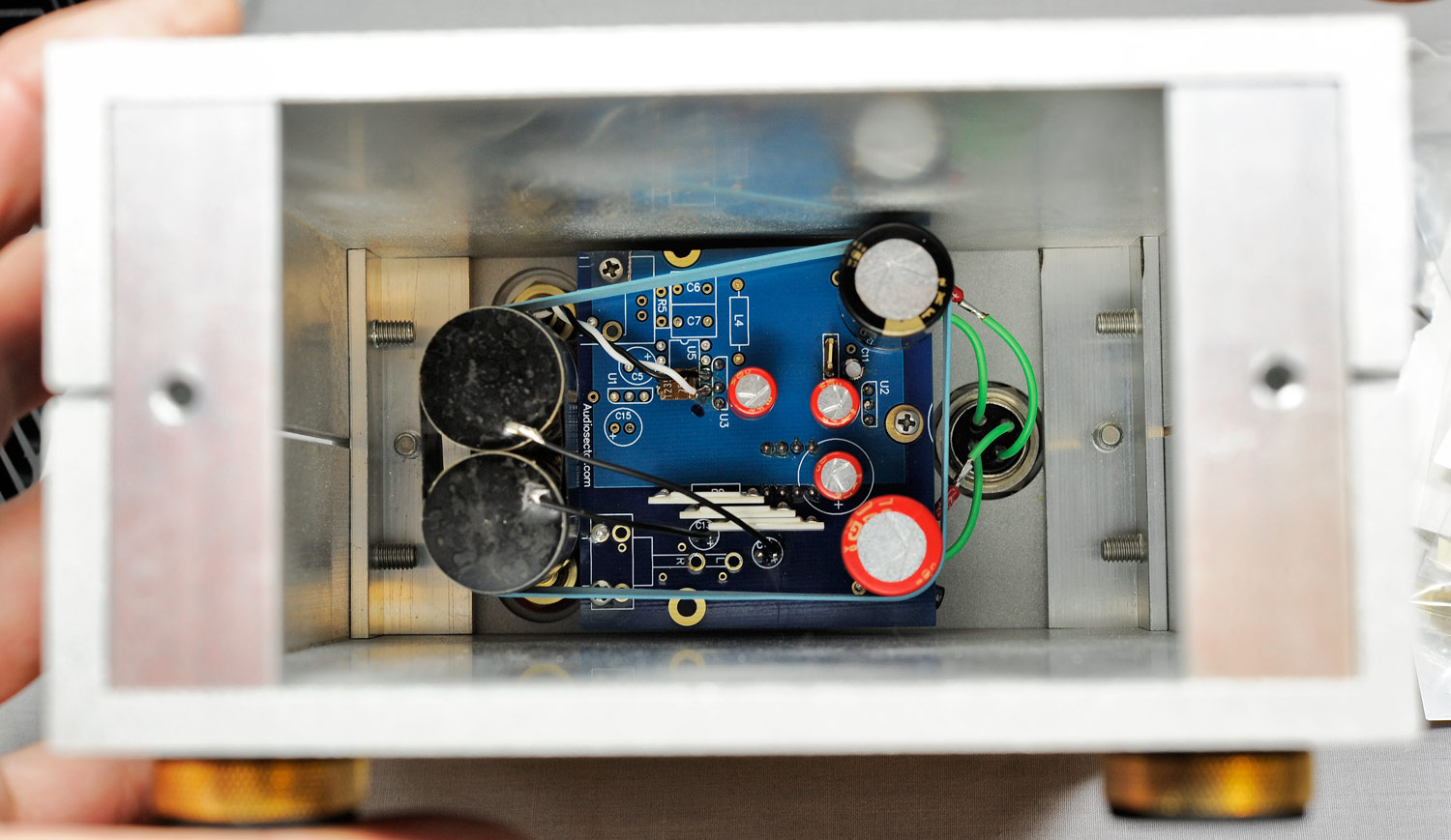

Here's how the stock DAC board can be modified: all "unnecessary" components have been removed and 3 discreet regulators added. I'm using MIT RTX 1uF output coupling caps. External PS is the same as in the balanced DAC. Instead of costly BG N 1000/50 I'm using here BG NX 470/16 which works fine too.
I'm also attaching Word document which was compiled by uncle_leon who tried some of the mods already.

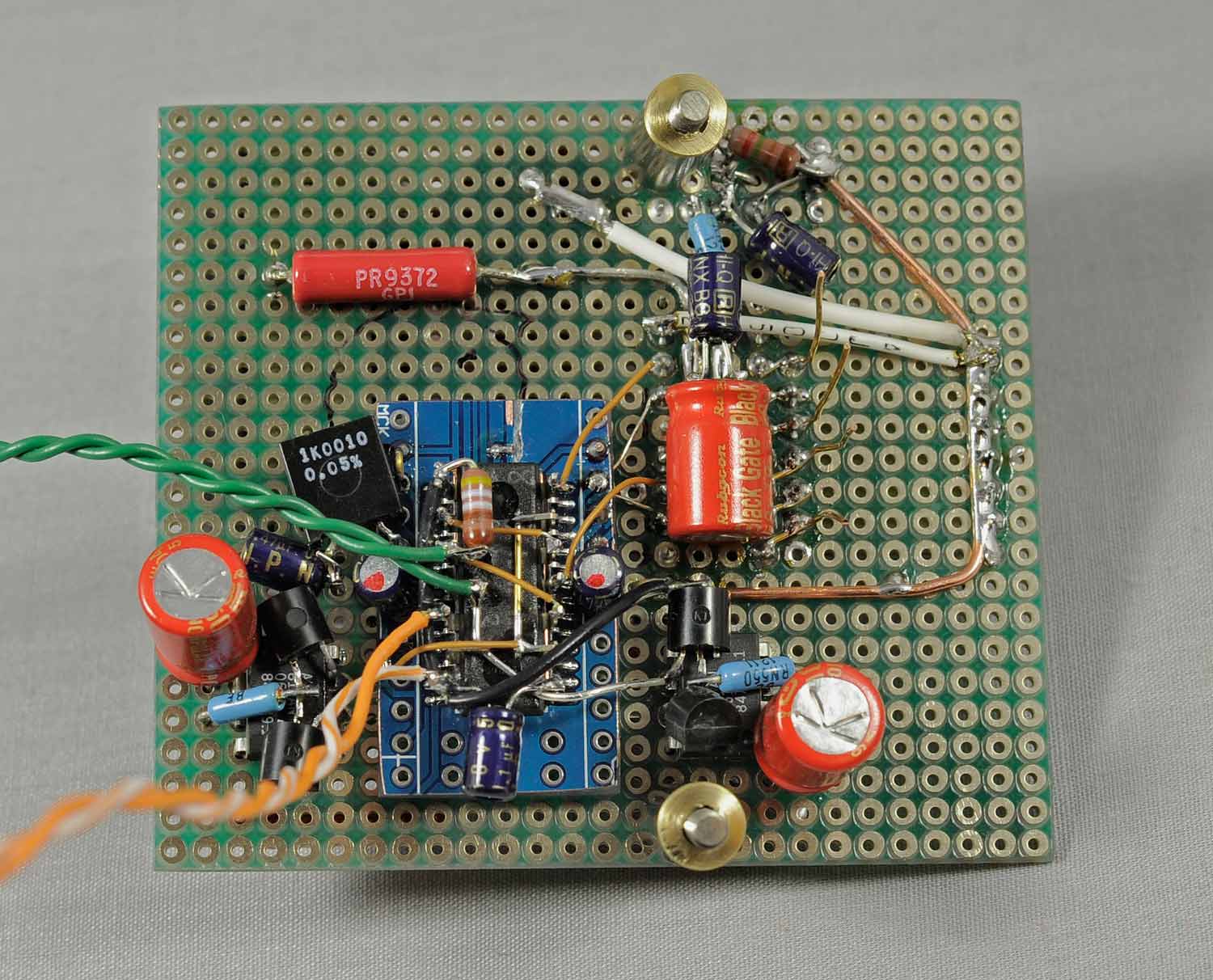

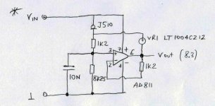

Some of the components in a shunt regulator can be hard to source, so this is series regulator we've been using initially. It also works very well and the difference between those two regulators is rather subtle, although shunt seem to sound a bit better when the circuit is built exactly as described.
For 5V output, change 8k25 resistor to 5k. That regulator circuit was also developed by Bobken.

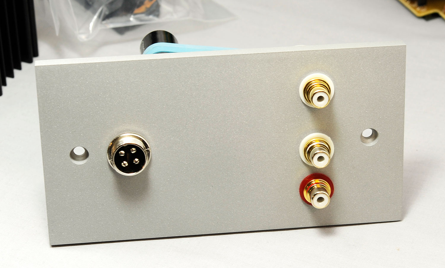

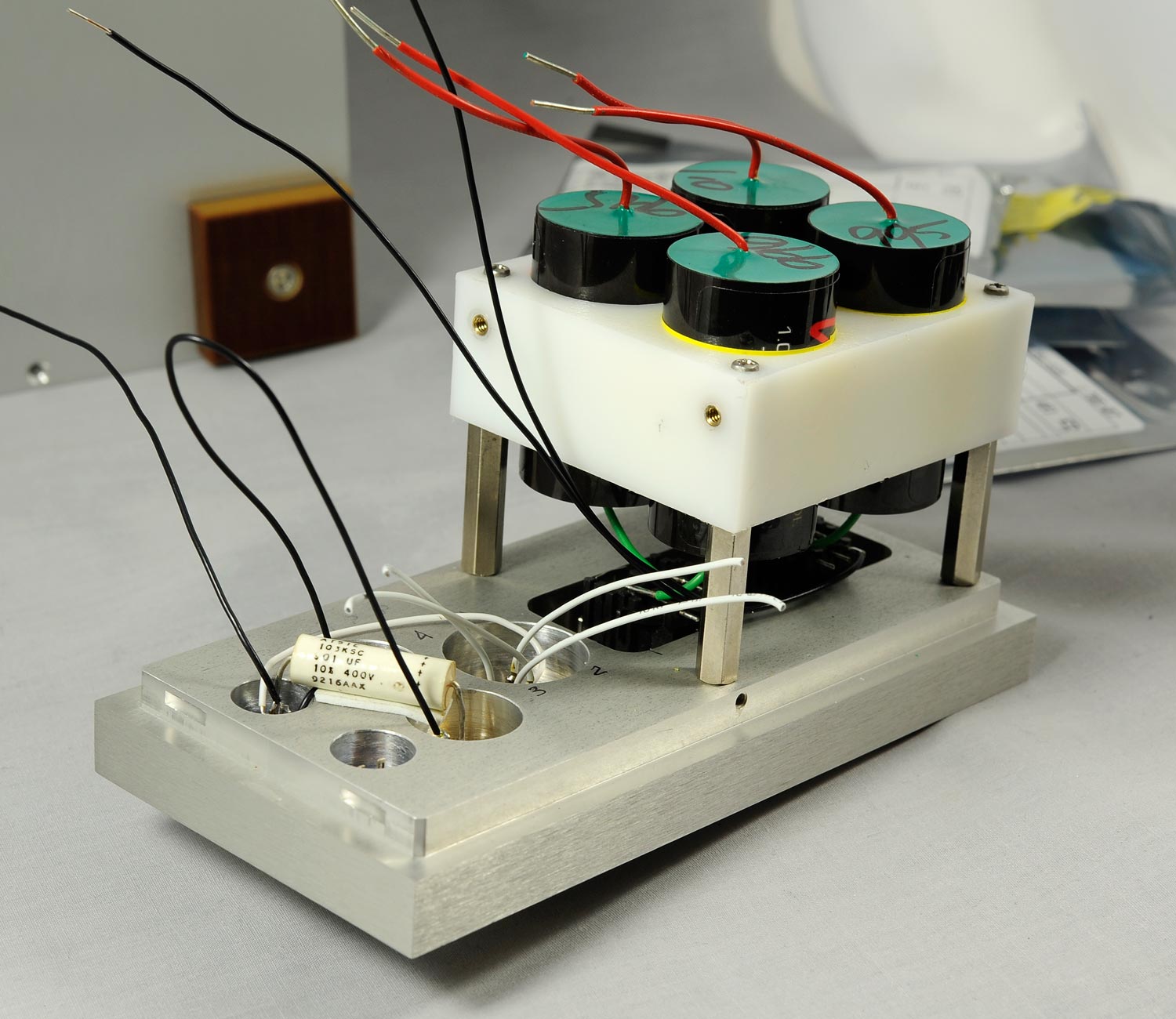

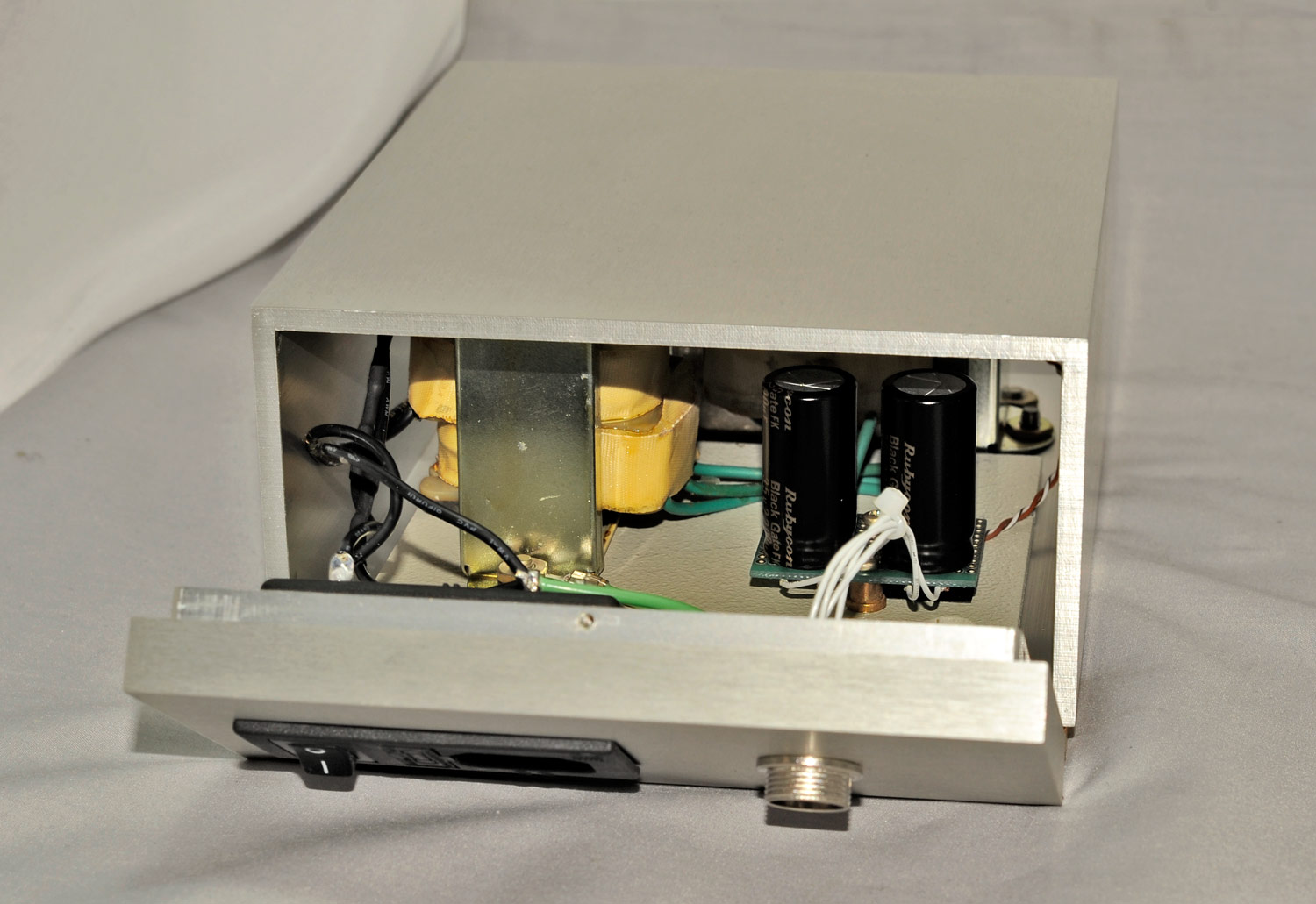

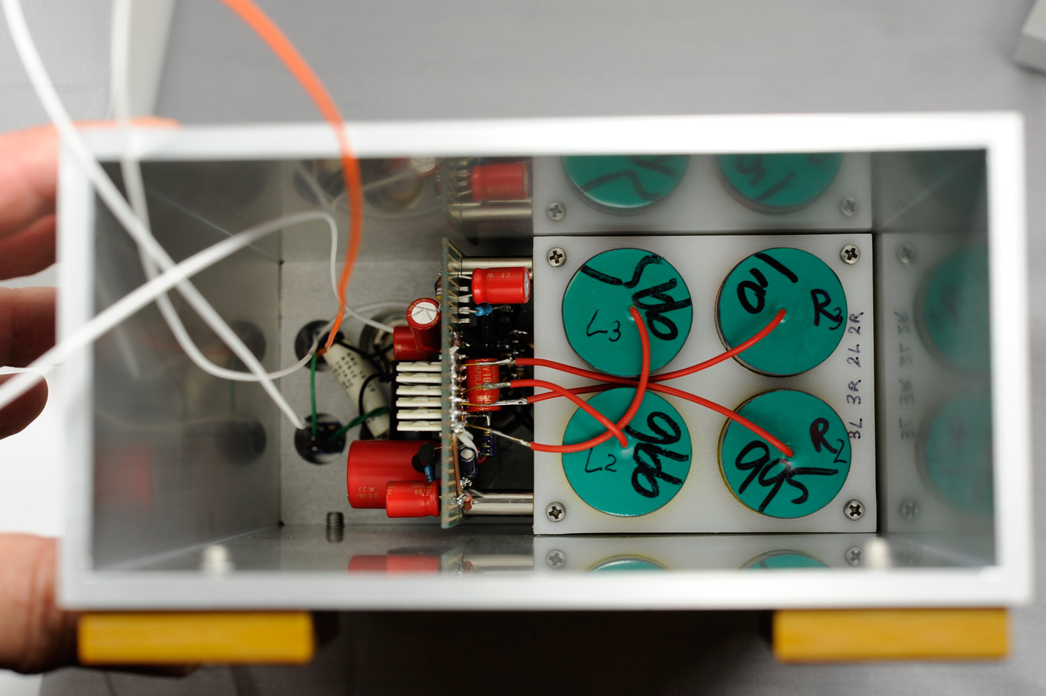

Coming back to the topic, here's a DAC I built for a local customer around Christmas time. He was initially searching for Bidat, but when he audition the Bidat and this DAC in my system, there was no doubt what sounded better. His system required coupling caps so we went with 1uF TFTF V-Caps. The enclosure is a modified AMP-2 chassis.

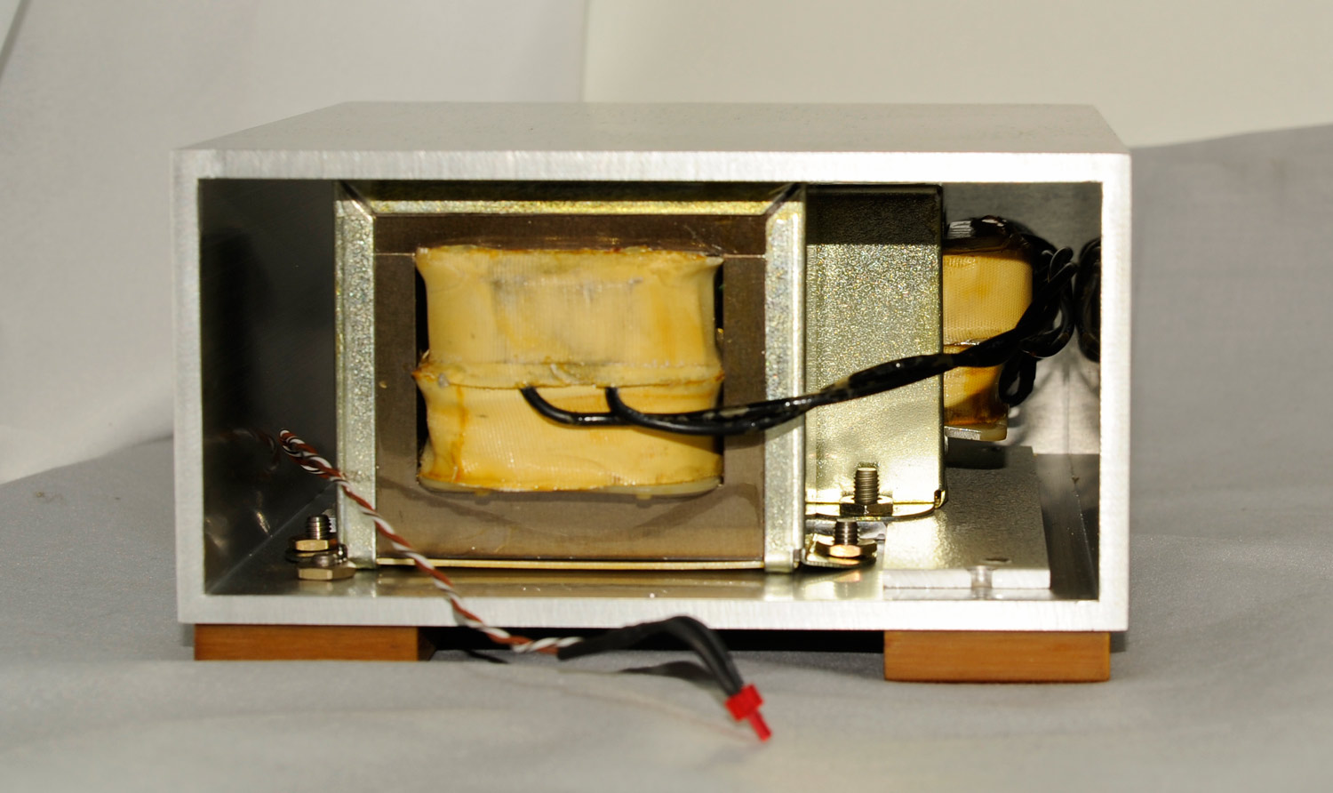

Is anyone sure that Peter does not have a machine shop that is not int the pictures he posts? J/K.
That is absolutely beautiful work Peter. How are the ends attached to the case? I don't see any hardware. Is this the same circuit with the addition of the coupling caps?

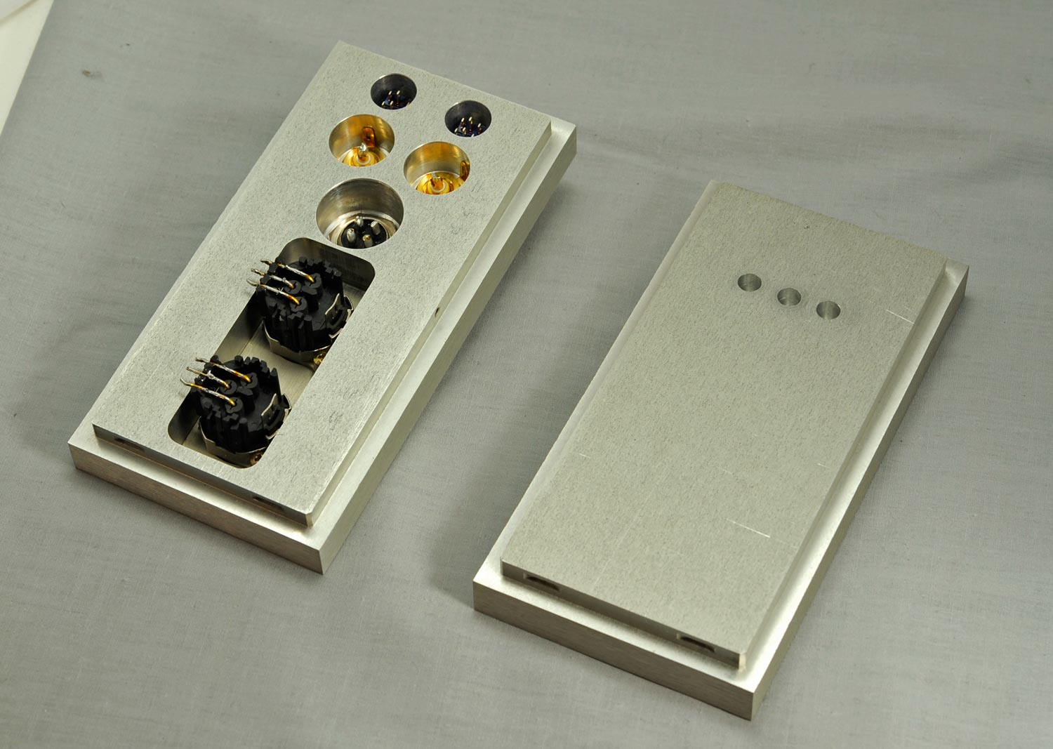

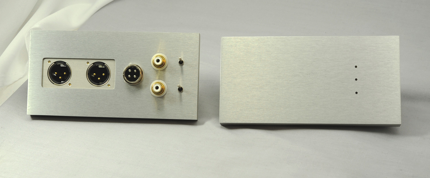

Those are the enclosures that I had fabricated for AMP2 mono blocks that were on a cover of hi-fi+: http://www.audiosector.com/downloads/hifi+review.pdf
The 3/4" aluminum panels are press fitted into tubing and secured with a single screw only.

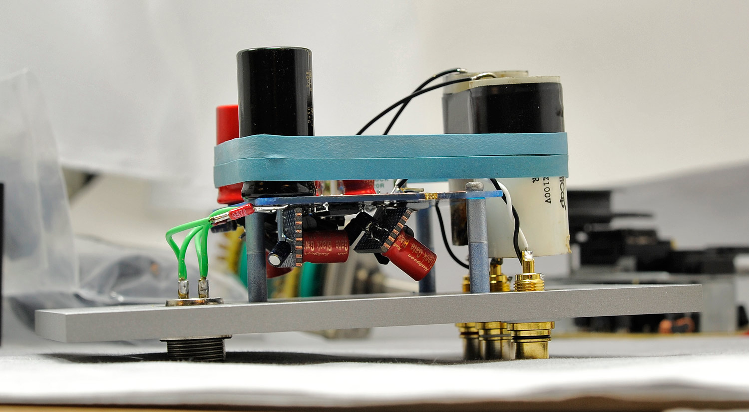

The connectors are from Switchcraft (Multi-Con-X), digikey part# SC1221 (for female cable mount).
The caps are BG FK 2200/35 and BG N 1000/50, the latter can be replaced with BG N 470/16

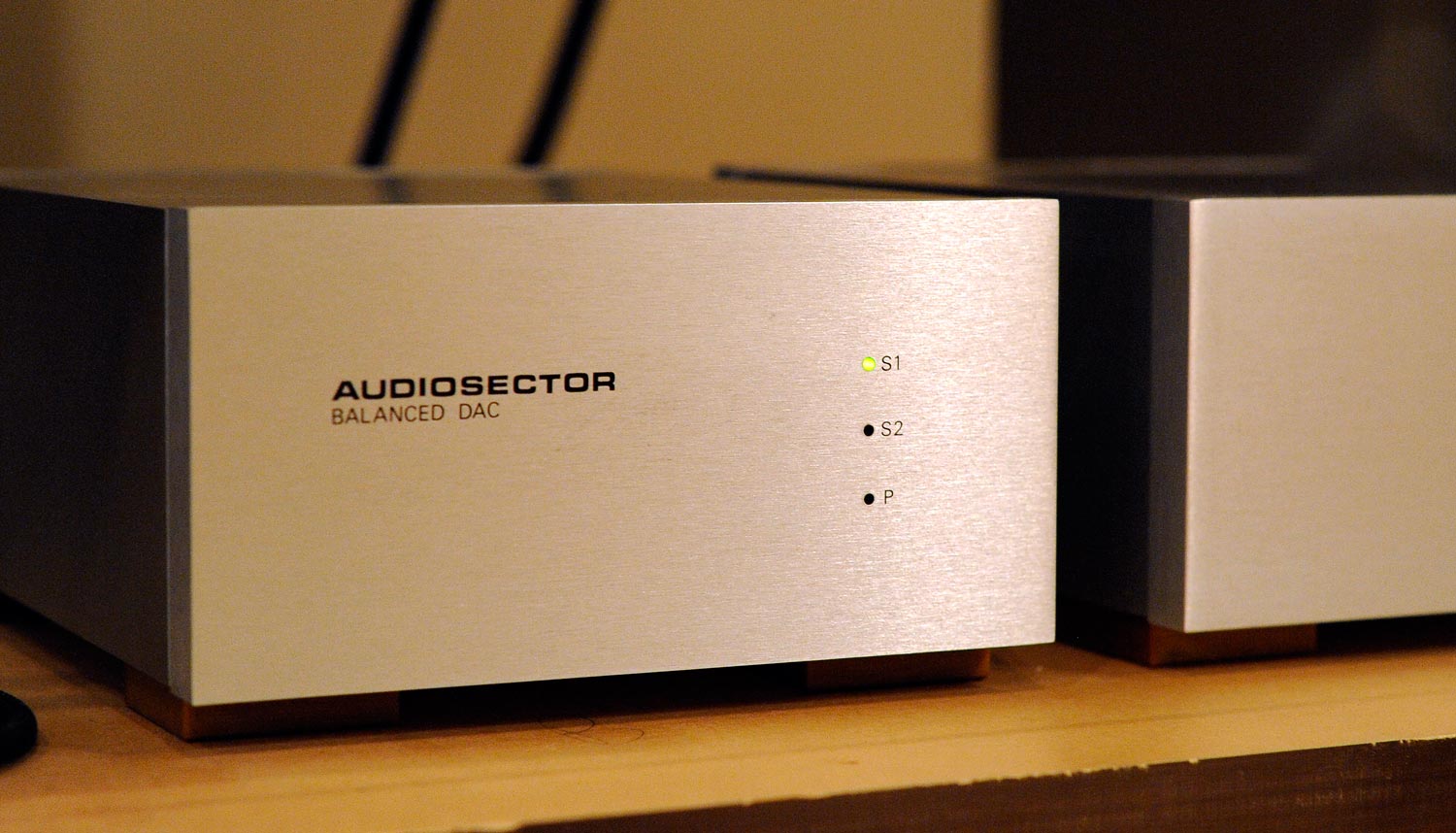

Just because i´m curious, Peter at post 24 what for is LED
S1 S2 and p on the front?
Greetings ulf
Greetings ulf

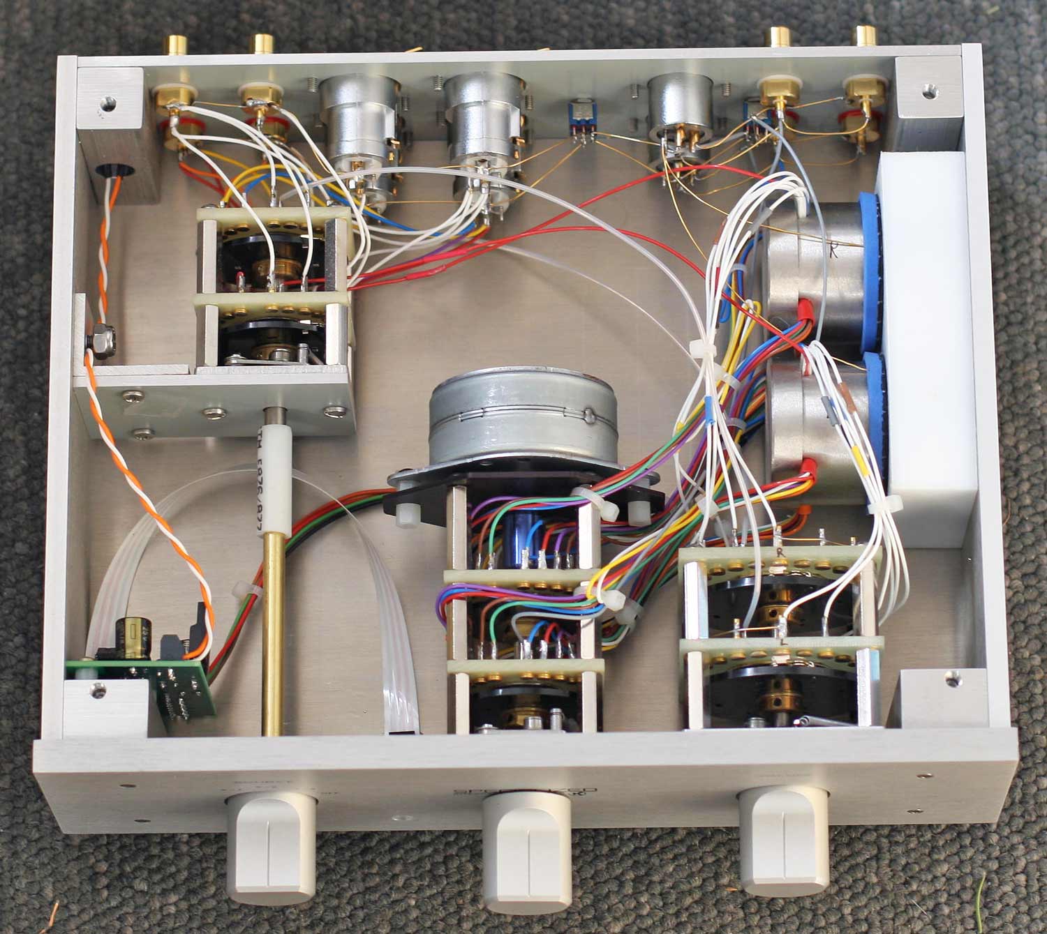

It would be interesting to see if Lundahl or Jensen had any transformers that would convert balanced to unbalanced without coloring the sound.
Dan 🙂
The main reason I'm using transformer is because it is also my preamp. I mentioned it already that I can't imagine better passive line stage than TVC: it adds gain, converts balanced to unbalanced, unbalanced to balanced, allows phase reversal and of course, attenuates. There are kits available with stepping motors that allow adding remote control function. It also sounds better than most active preamps out there, if system is set up properly.
Jensen or Lundahl are certainly fine, but then you need additional line stage, which increases complexity and certainly affects the sound.
My preamps are based on S&B TX102 which are not available for diy any longer, however, I also tried Sowter and it seems as good as S&B.
I've built one such preamp for a local guy (using Sowter 1035) and he replaced his AR Ref 3 with it. Recently he asked me to build another one.
1035 offers balance control, if that is not needed, then 9395 would be a good choice: SOWTER ATTENUATOR TRANSFORMERS TVC VOLUME CONTROL
Those are probably not much more expensive than Lundahl or Jensen, but offer so much more...
