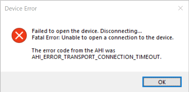

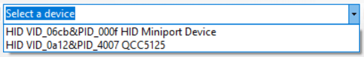

I've installed the drivers from \drivers\cda\Qualcomm_Drivers_WIN_CDA_104.0.0.exe and tried ADKConfigTool.
Before installing them the Windows device manager showed these devices:
Also the QCC_Tool from this post does not recognize any devices:
If there are any advices how to establish a connection I would be happy
BR
thank you very much for the link!
- Audio devices > QCC5125
- USB controller > Generic USB hub (HW ID USB\VID_0A12&PID_4010&REV_1669)
- USB controller > USB device (HW ID USB\VID_0A12&PID_4007&REV_1970)
- USB devices > Qualcomm USB Hub Filter Device - 0001 (HW ID USB\VID_0A12&PID_4010&REV_1669)

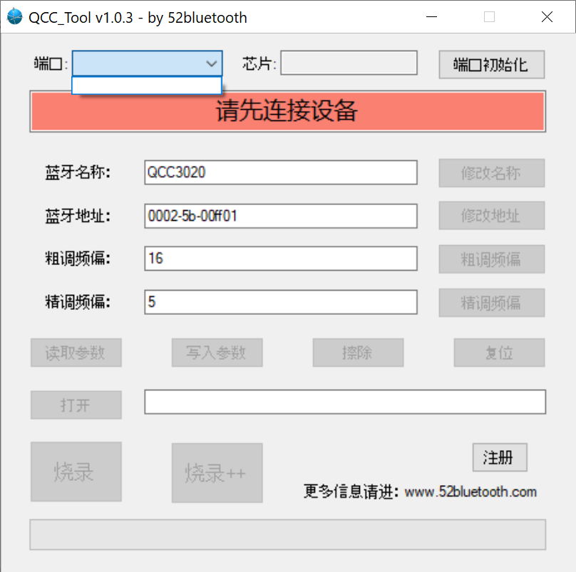

What is your operating system? Recommend Windows 7.
Perhaps something needs to be short-circuited on the chip to enter the programming mode.
Perhaps the debug needs to be disabled.
Perhaps you need version ADK6.3 ...
Alternatively, try changing the PID and VID in the driver...
Perhaps you need to unlock the interface.
After the installation is complete, the MDE cannot confirm the USB Debugging interface, and you need to write an unlock key through the following command to let MDE know that it is not through TRB but USB.
ADK's tools\bin\TransportUnlock.exe writeunlockkey ..\..\..\unlock_usb.txt
unlock_usb.txt I used the default 0000000000000000000000000000000, a total of 32 characters, as the unlock key
https://www.codetd.com/en/article/12619811

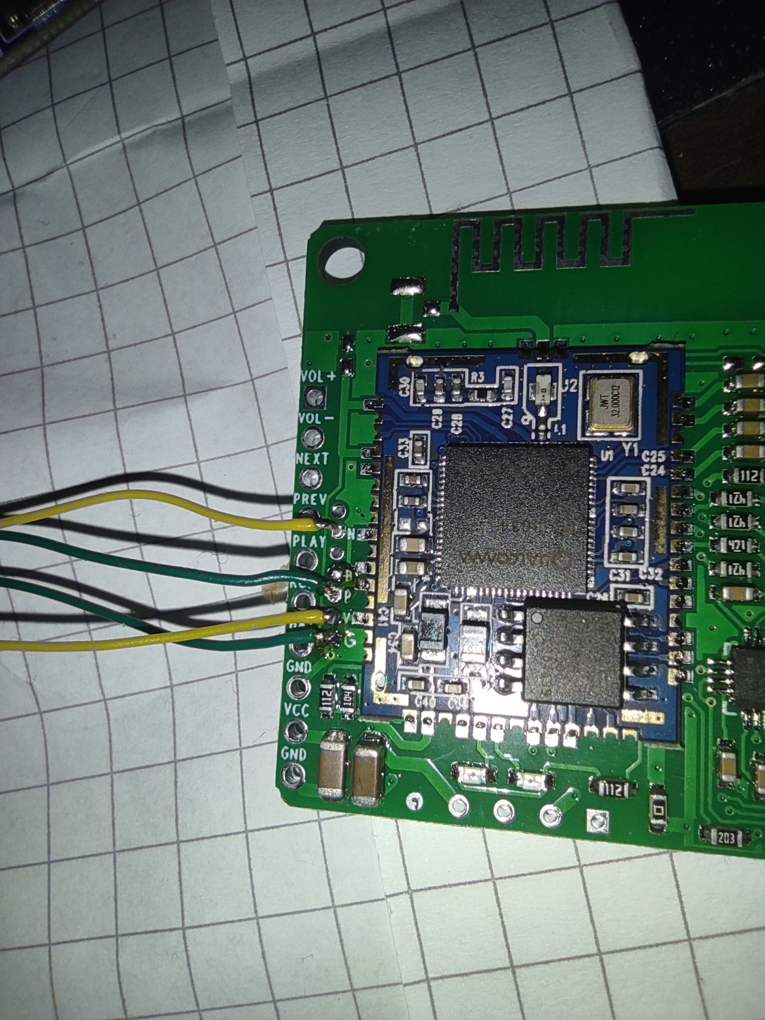

Hi,From the picture you sent 1.27mm pitch pins are top to bottom
1 - NC
2 - D-
3 - NC
4 - VBAT
5 - D+
6 - VCC
7 - GND
I have the same board and I don't remember where I found it but I found a datasheet for the BTM331 and was able to trace out the pinout to confirm them. To be clear your connections between the two will be
USB QCC30XX
VCC 1 --> 6
D- 2 --> 2
D+ 3 --> 5
GND 4 --> 7
I have the same module with the qcc3031 and I have connected them as supposed by Maddnezz.
My PC (Win10) detects something (Hardware ID matches with the one from the unlocking guides). But it keeps disconnecting every 1-2 seconds, then reappearing. When I try to install the driver I get an error message.
Is there something else that needs to be connected?
Tried powering it with 3.3V at VBat in addition, but it did not help.
I tried with a second module with the same behavior, so either both are broken or I am doing something wrong.
Anyone else had this issue?

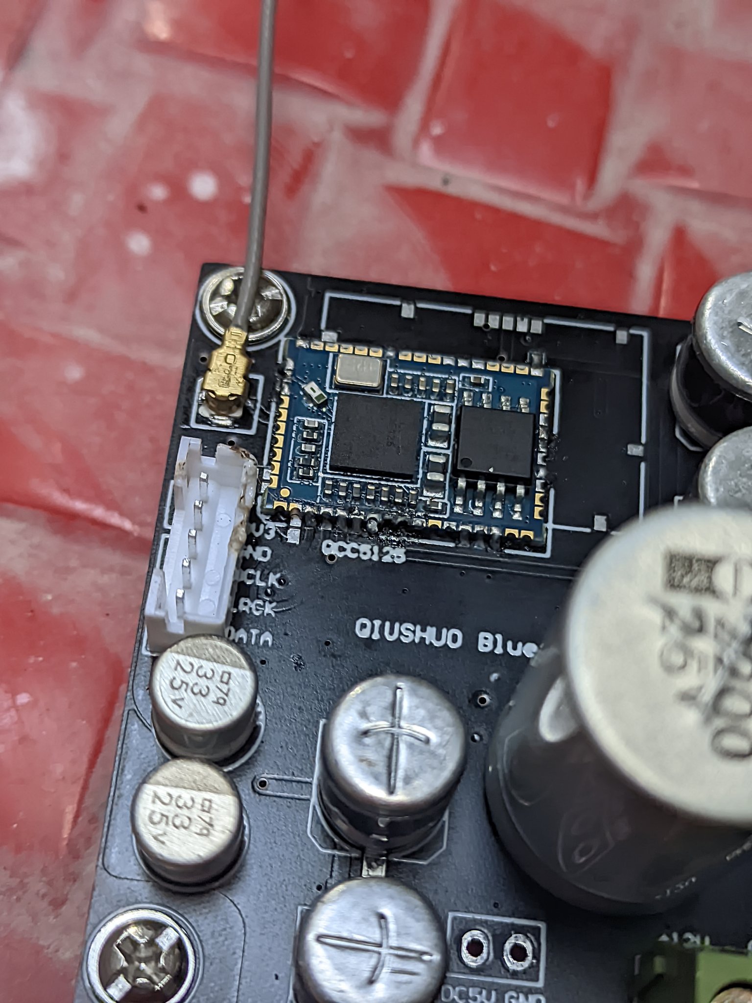

The board I posted earlier burned out before I tried the USB connection so I don't know if it's not programmable because part of the chip blew up. These boards are too expensive to try random boards to find out which one can be programmed. Especially since they appear to break so easily.
