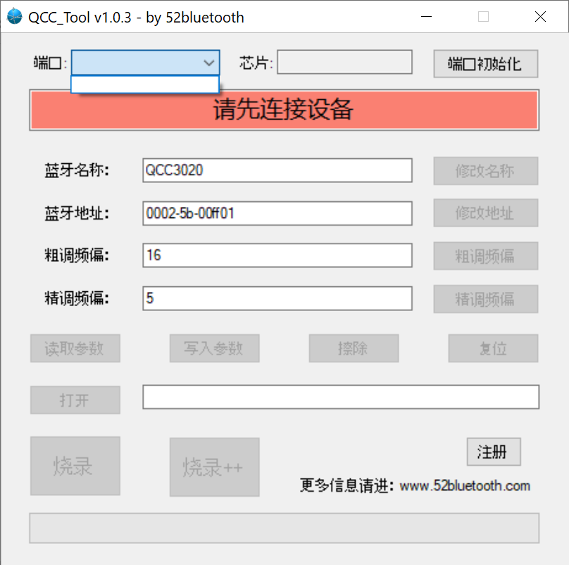

Hi German1212,Hi all, I have updates about configuring QCC3034, and let me share those with you guys.
First many thanks to @hvmcsa, he shared with me qcc_tool where I can change the name of the chip.

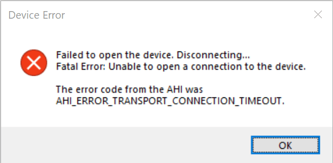

I'm new to QCCXXXX chips and I have the F-3020 module with QCC3031 IC. I managed to enable the USB programming and can connect to the IC with all the tools (ADK configuration, QACT etc.). I'm able to set parameters with QACT (online mode) and tune EQ but I seem to be unable to save config to the chips. I've tried both Set Data and Write Persistence and they both work online but all changes are forgotten after power cycle.
Any help with this would be appreciated

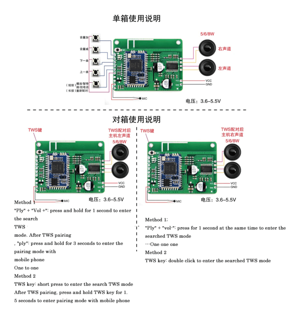

Hi did one of you say you had the ADK for the QCC3034? I've used the universal front ends for the CSR and QCC3003 chips before and it goes ok, just dont know if any of the EQ settings really work. I suggest getting those pogo pins from aliexpress and then you dont need to solder to the chip. I've also changed the name of them before. But i use those BT amps similar to whats shown on the other pages.
I recently bought this one as it claims i can get 8watts per channel using a 4ohm driver, which is an extra 3watts on the QCC3003, i find these low powered amps go pretty good in a low powered BT speaker build.

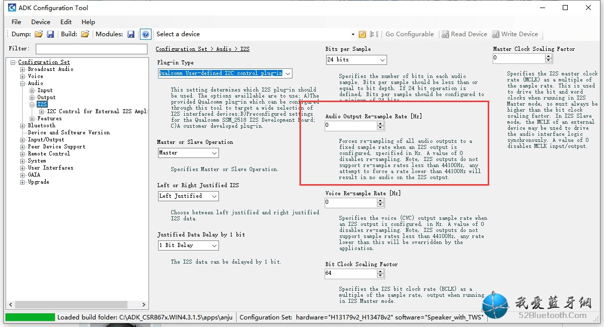

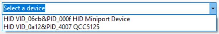

I've installed the drivers from \drivers\cda\Qualcomm_Drivers_WIN_CDA_104.0.0.exe and tried ADKConfigTool.
Before installing them the Windows device manager showed these devices:
Now the Windows device manager shows one changed driver - the rest remains the same due to unmatching device IDs in the .inf files:
- Audio devices > QCC5125
- USB controller > Generic USB hub (HW ID USB\VID_0A12&PID_4010&REV_1669)
- USB controller > USB device (HW ID USB\VID_0A12&PID_4007&REV_1970)
The ADKConfigTool shows two devices but no connection is possible:
- USB devices > Qualcomm USB Hub Filter Device - 0001 (HW ID USB\VID_0A12&PID_4010&REV_1669)
Also the QCC_Tool from this post does not recognize any devices:
If there are any advices how to establish a connection I would be happy
