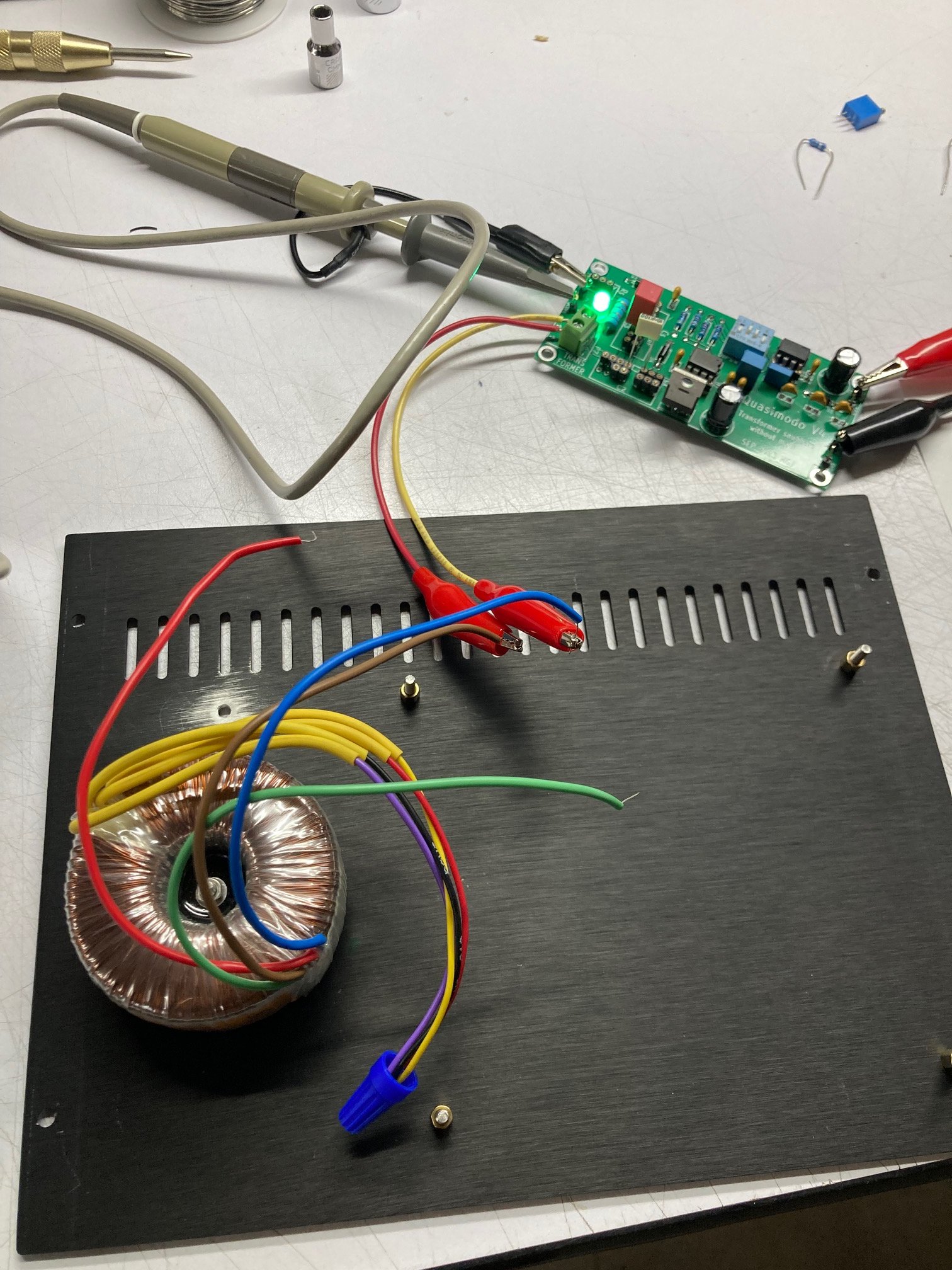

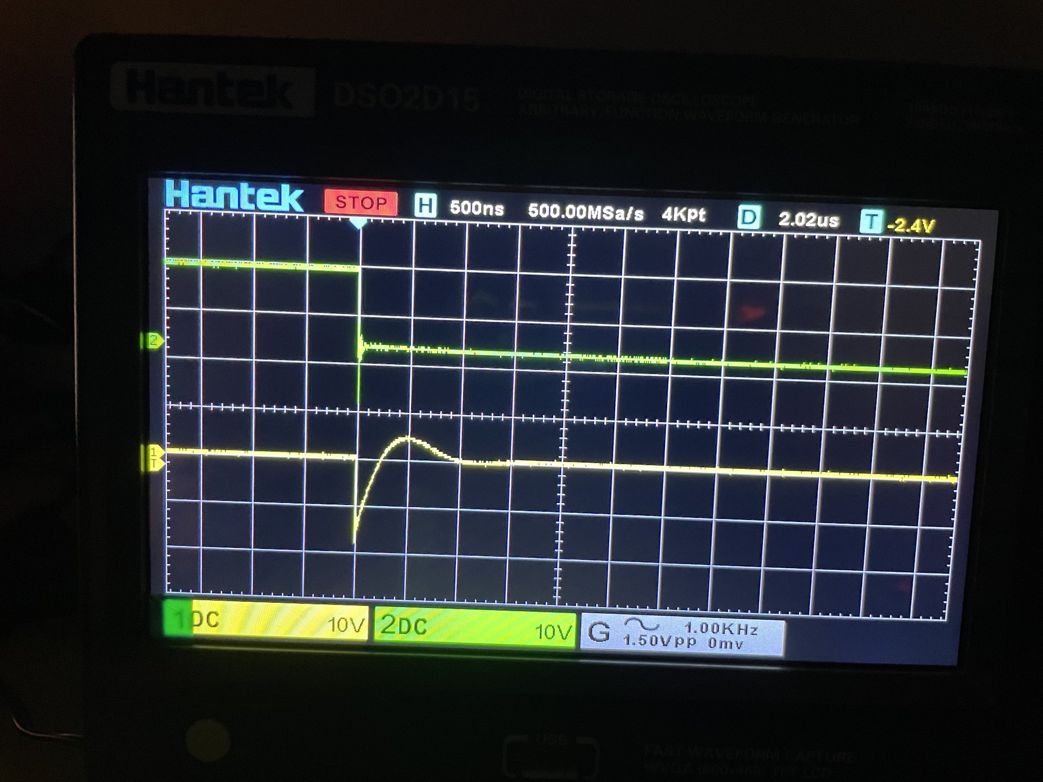

Quasimodo results (ONLY)

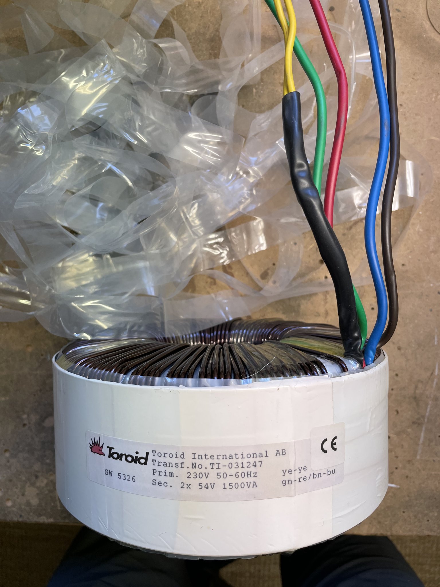

Toroid Int AB
1500VA 230VAC, unwinded some turns for lowering sec voltage to 2*50VAC.
Cx=10nF
Cs=100nF
Rs =22ohm

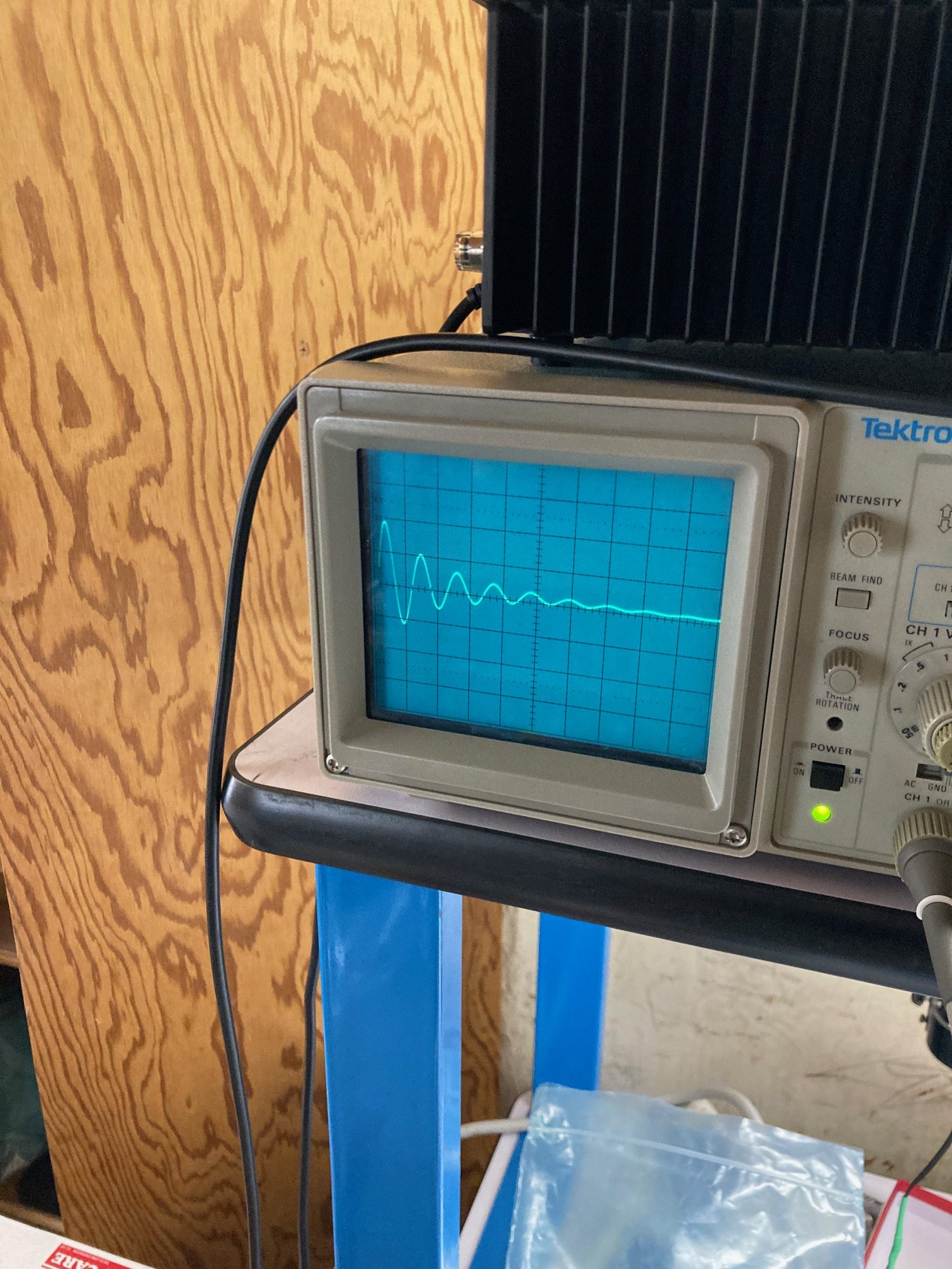

Picture shows undamped also.

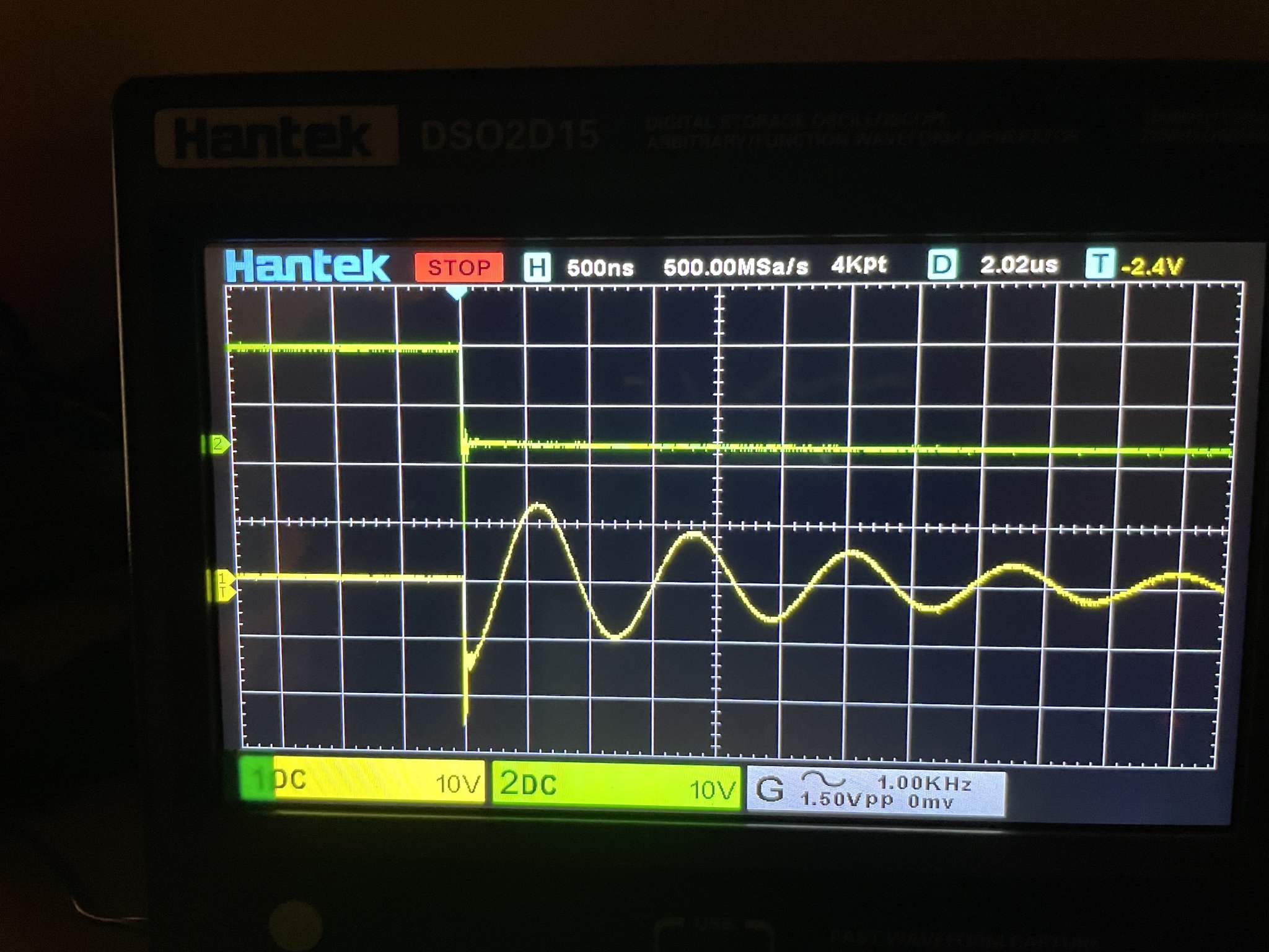

Joined 2020
Talema 62065-P2502
25VA, 2 x 22VAC
Cs = 1uF
Cx = 10nF
Rs = 33R
Note these Cx, Cs values are different from the default Quasimodo values, These values are the ones used in the onboard snubbers of the UDP3.

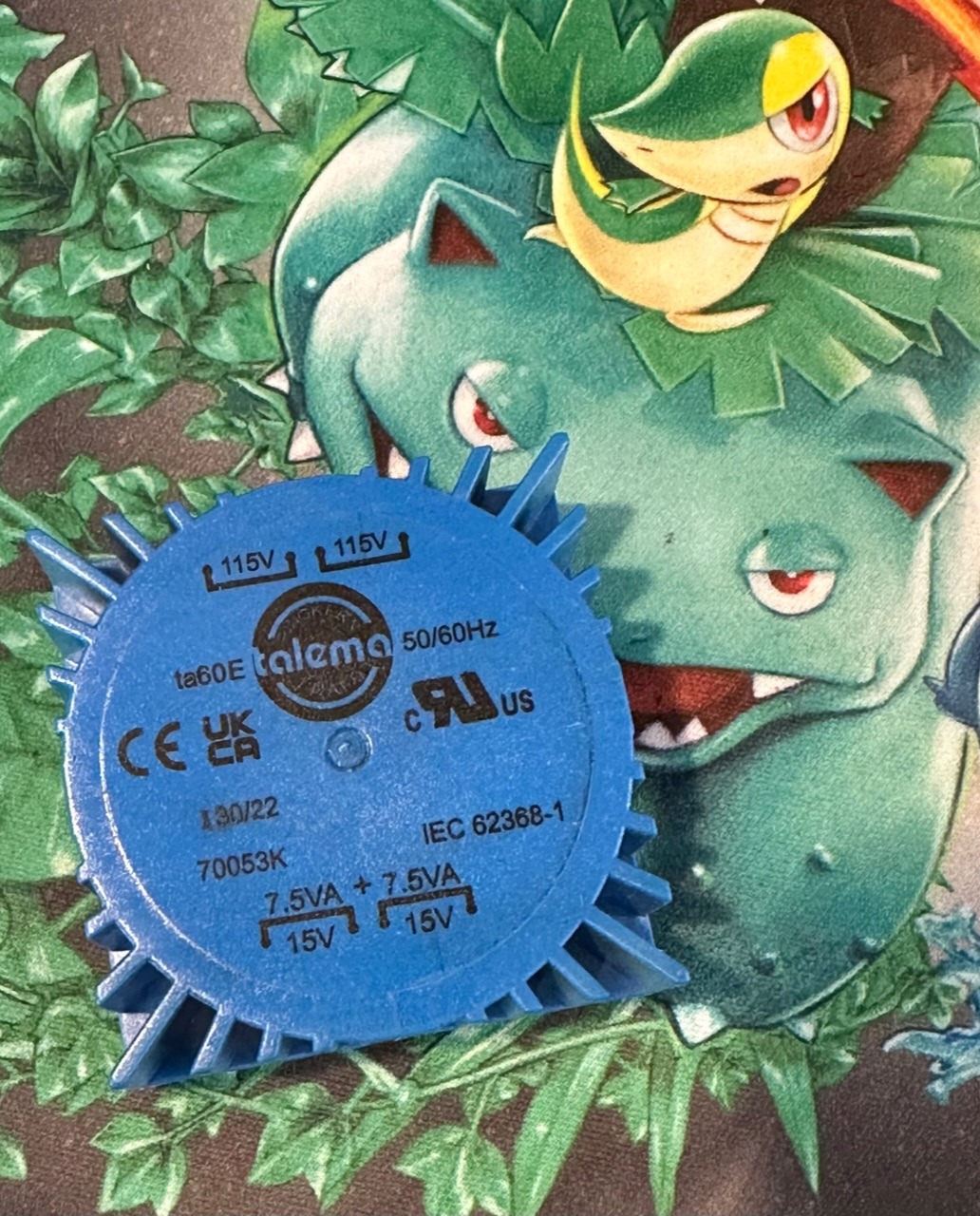

Talema 70053K 15VA , 230V in 2x15V out
Cx = 10nF
Xs = 150nF
Rs = 68 Ohm
