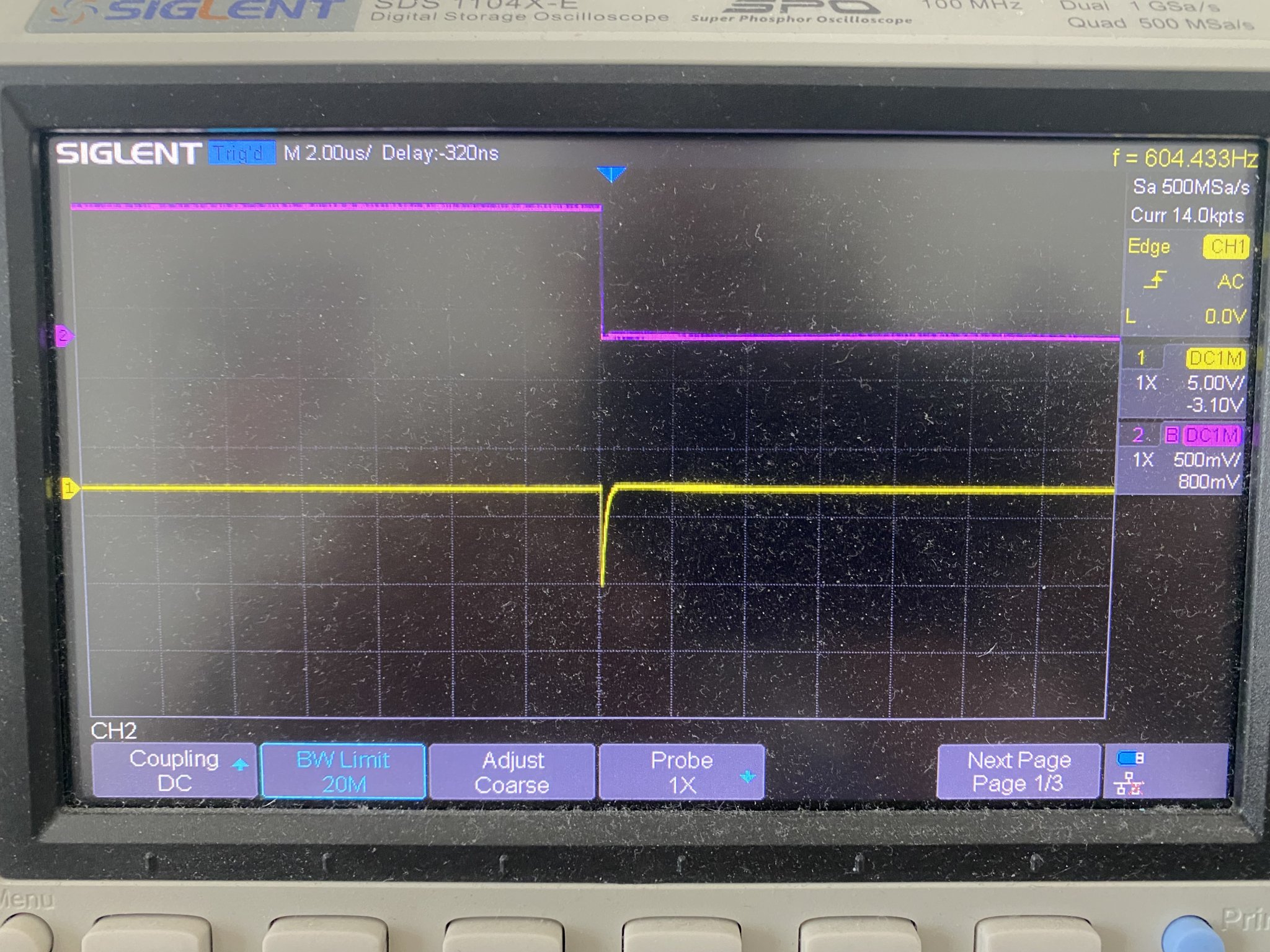

18R works like a champ if you’re using independent secondaries and Cx 10nF and Cs 150nF

did someone happen to measure the Antek 3218 with the primaries in series (230v)? For 115v I find results in the range of 10 to 12 ohms, would it be ok for 230v too? Thanks in advance.
I didn’t put the primaries in series, but I did a read with open primaries, and there was a slight ring at 10R under that condition. So more damping than when shorted (10R-12R range, or anything less than 22R really). I assume whatever trend prevails with other trafos when the primaries are wired in series vs. in parallel would apply here.
Joined 2021
Many thanks! The 4225 works fine with 15R @115/230, so this seems to be the trend.

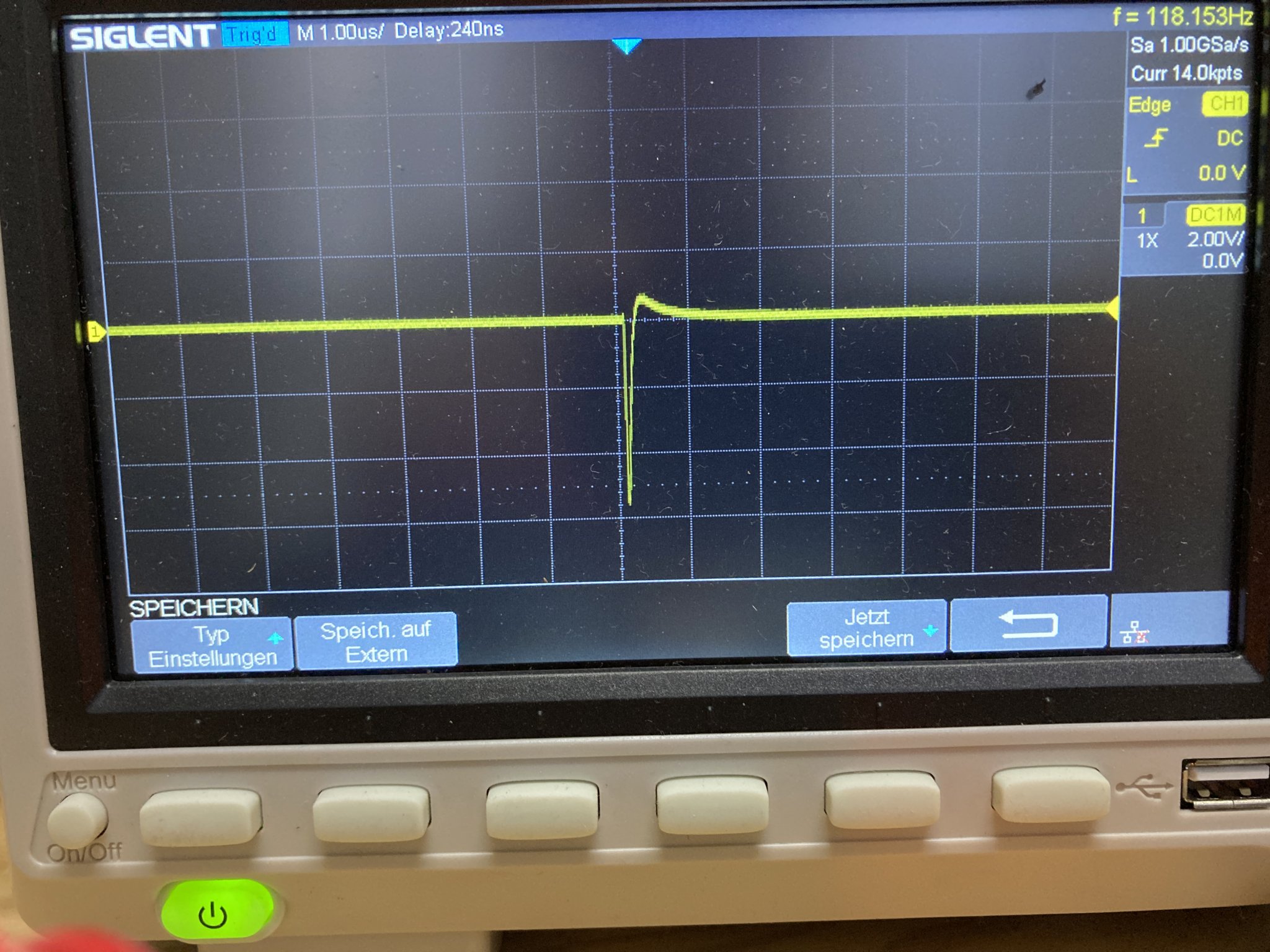

Joined 2017
Toroidy TS50VA 2 x 18 V
Secondaries parallel:
Cx 10nF
Cs 150nF
Rs 12.8 R
Secondaries in series:
Cx 10nF
Cs 150nF
Rs 23.1 R

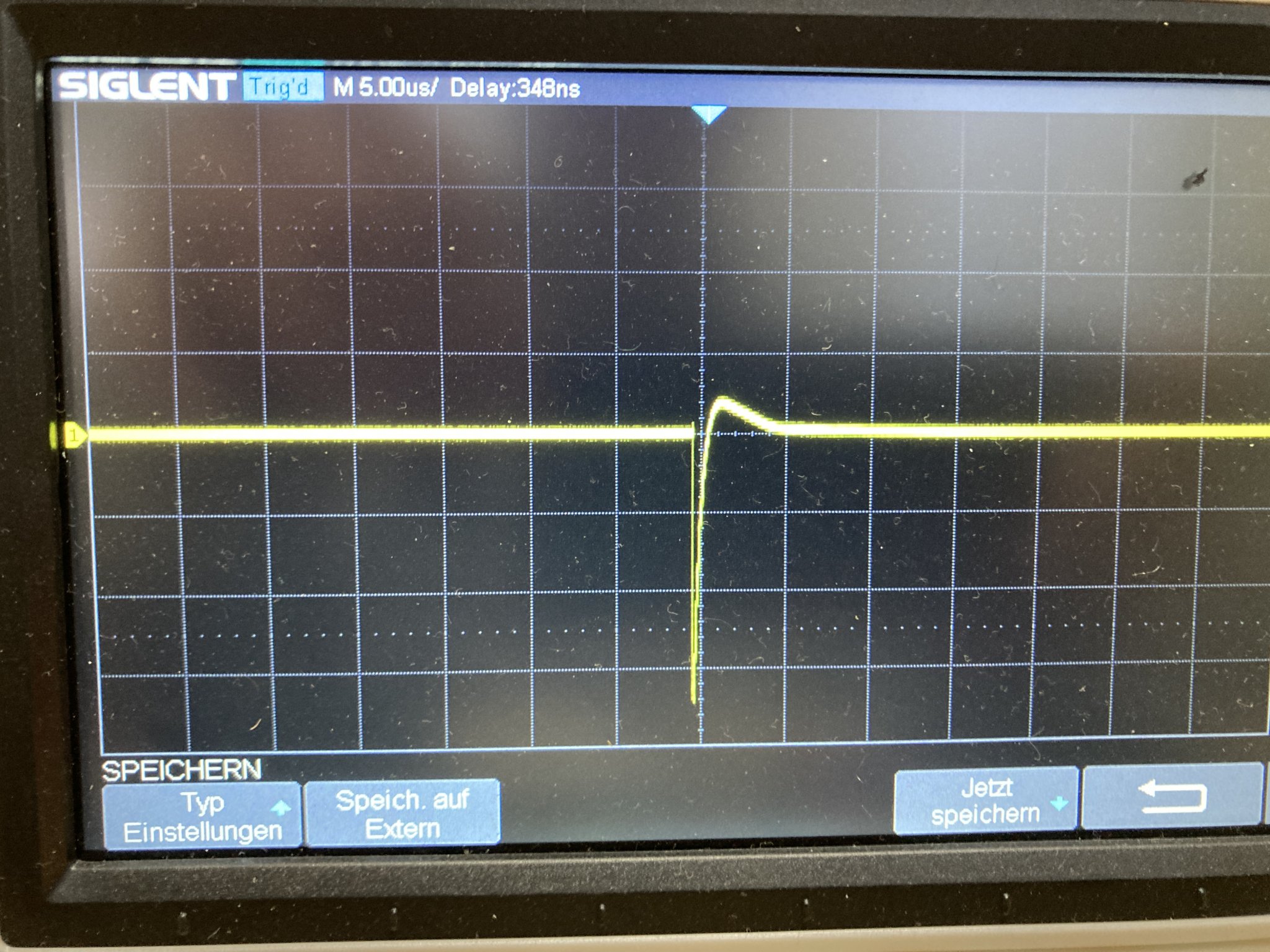

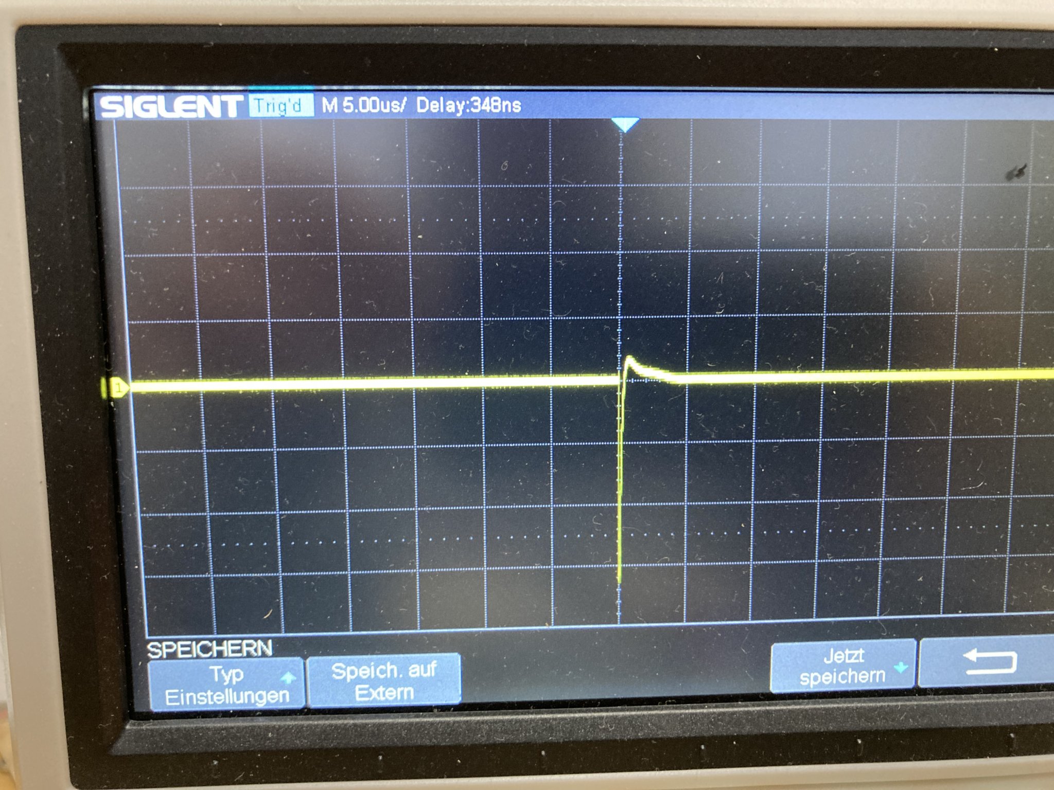

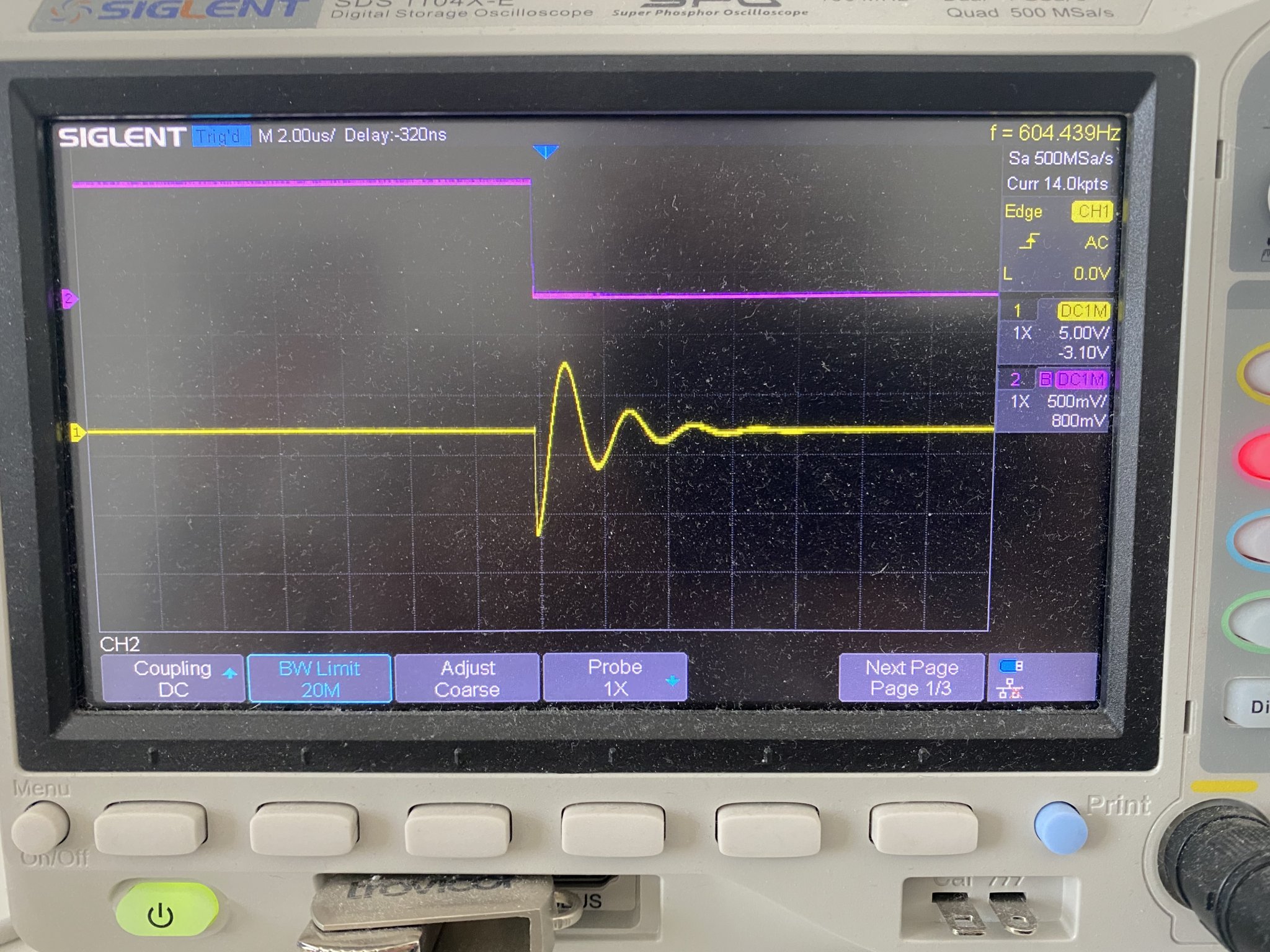

Secondaries independent:
Cx 10nF
Cs 150nF
Rs 19.8 R
Reactions: 1 user

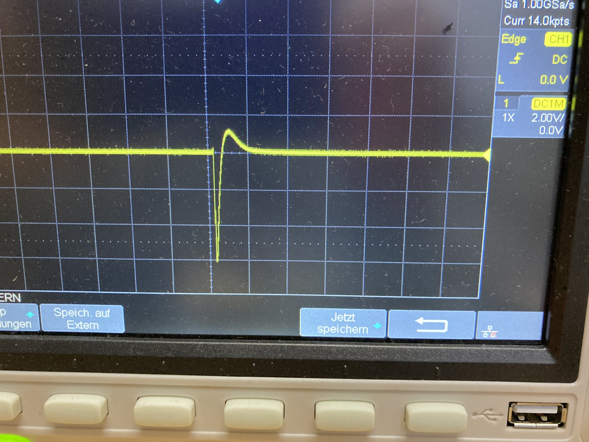

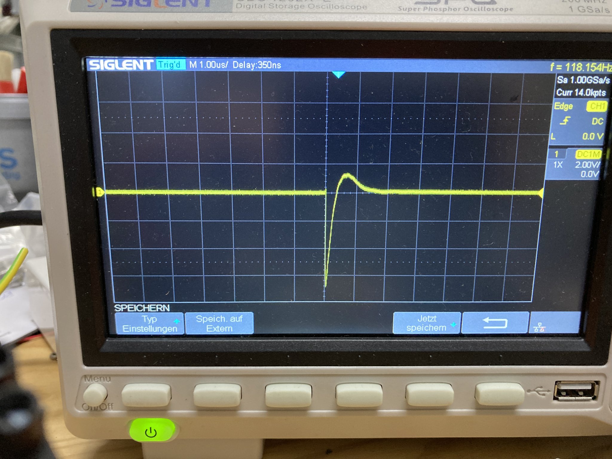

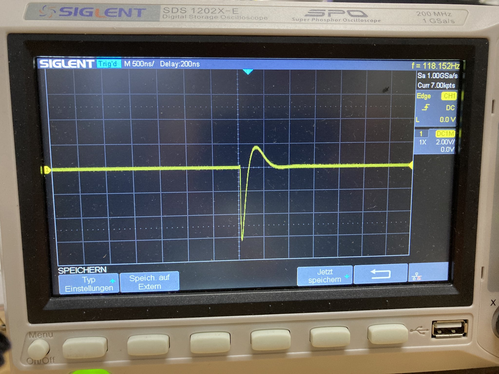

Joined 2017
Toroidy TS50VA 2 x 15 V
Cx 10nF
Cs 150nF
Rs 18 R
Cx 10nF
Cs 150nF
Rs 44 R
Cx 10nF
Cs 150nF
Rs 13.8 R
Reactions: 1 user
