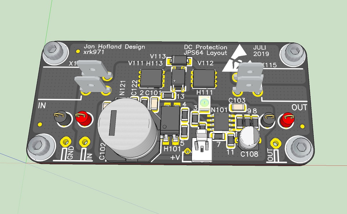

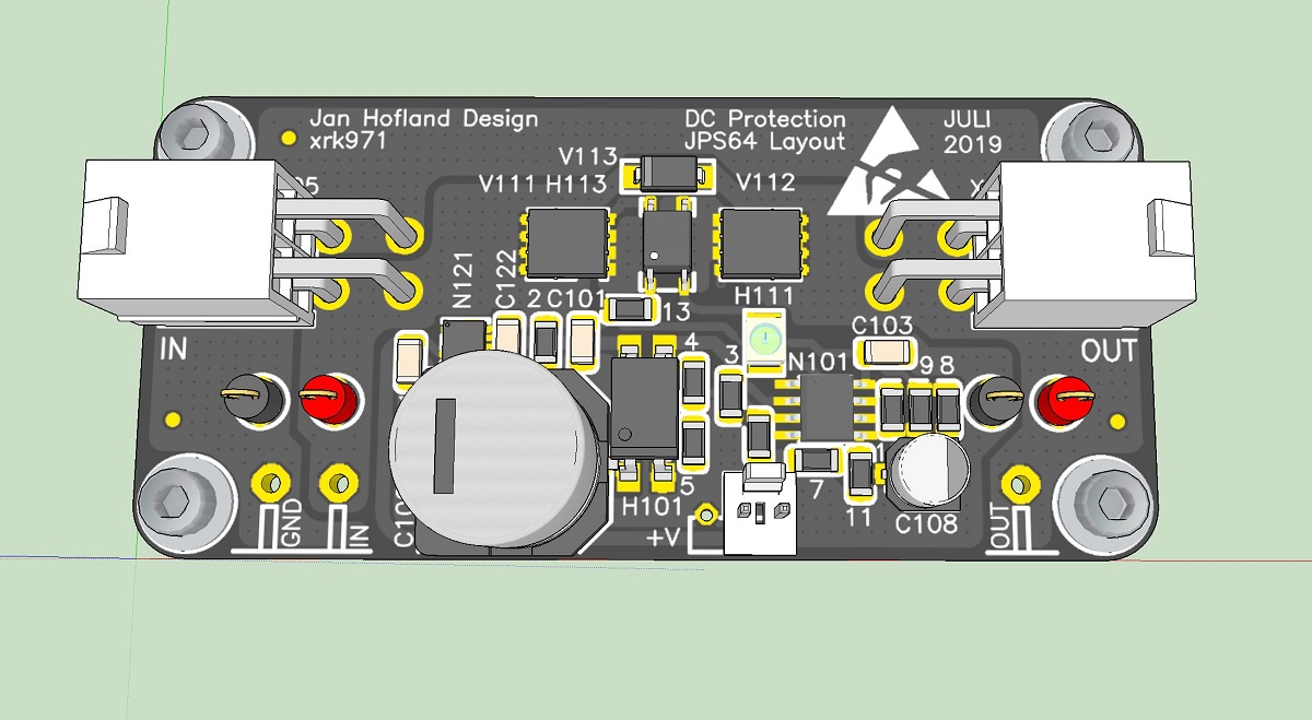

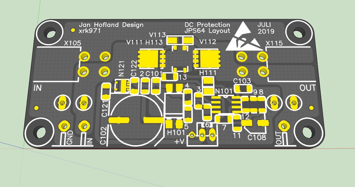

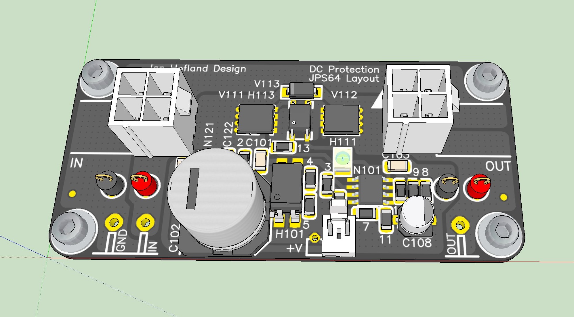

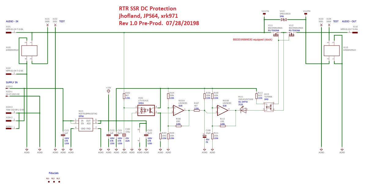

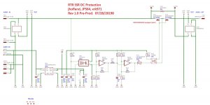

Rev 1.0 Updated Pre-Prod Schematic
Here are the latest 3d renders and schematic with voltage regulator IC for supply voltage control, 100v MOSFET, and protection transorb diode.
PCB only:
attachment.php
Your choice of connectors to speaker, Faston:
attachment.php
Molex Minfit Jr Horizontal:
attachment.php
Molex Minfit Jr Vertical:
attachment.php
Schematic:
attachment.php

I make it clear from the outset that I often miss detail that's obvious to others.
How is the board placed in the overall circuit, in terms of where it sits in relation to incoming mains power, transformer, amp PCB and speakers?
The way I'm reading the base detail is that one board per channel is required.
Pardon my confusion because the diyAudio Store equivalent has the soft start between the mains and the transformer and the speaker protection between the amp PCB and each speaker. I'm just trying to relate this bit of gear to an architecture that I currently understand.
Thanks in advance.
Founder of XSA-Labs
Joined 2012
It goes after the amp’s speaker outputs and before the speaker terminals. It needs a connection to the amp’s +ve supply from the PSU. This provides it the power to work and do its thing. It does not have a soft start - that’s part of the power supply. What it has is a delay that doesn’t connect the speaker until after 3 seconds to allow the amp to release its start up transient with the speaker not yet connected.
