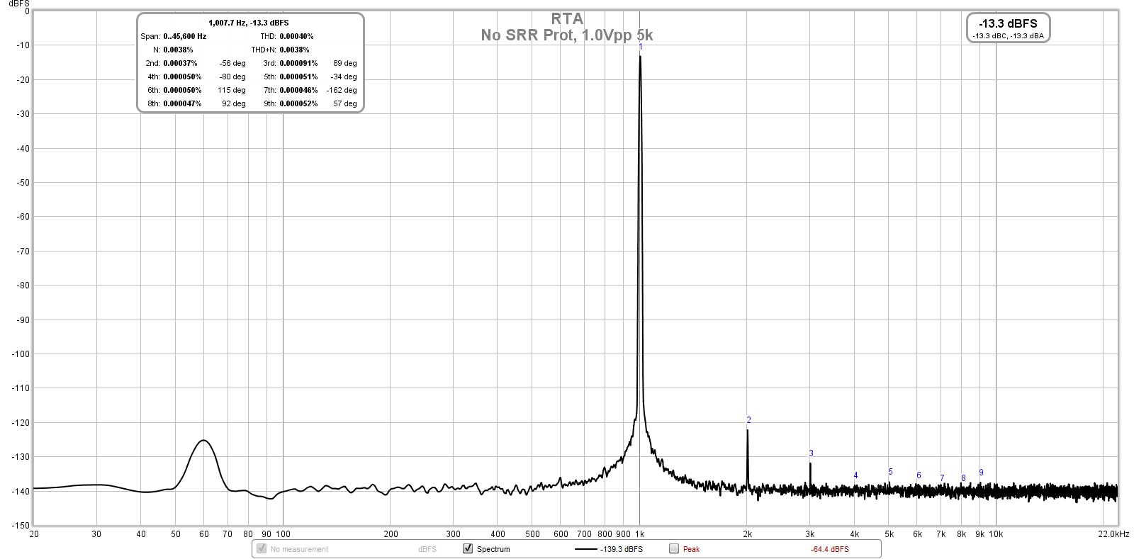

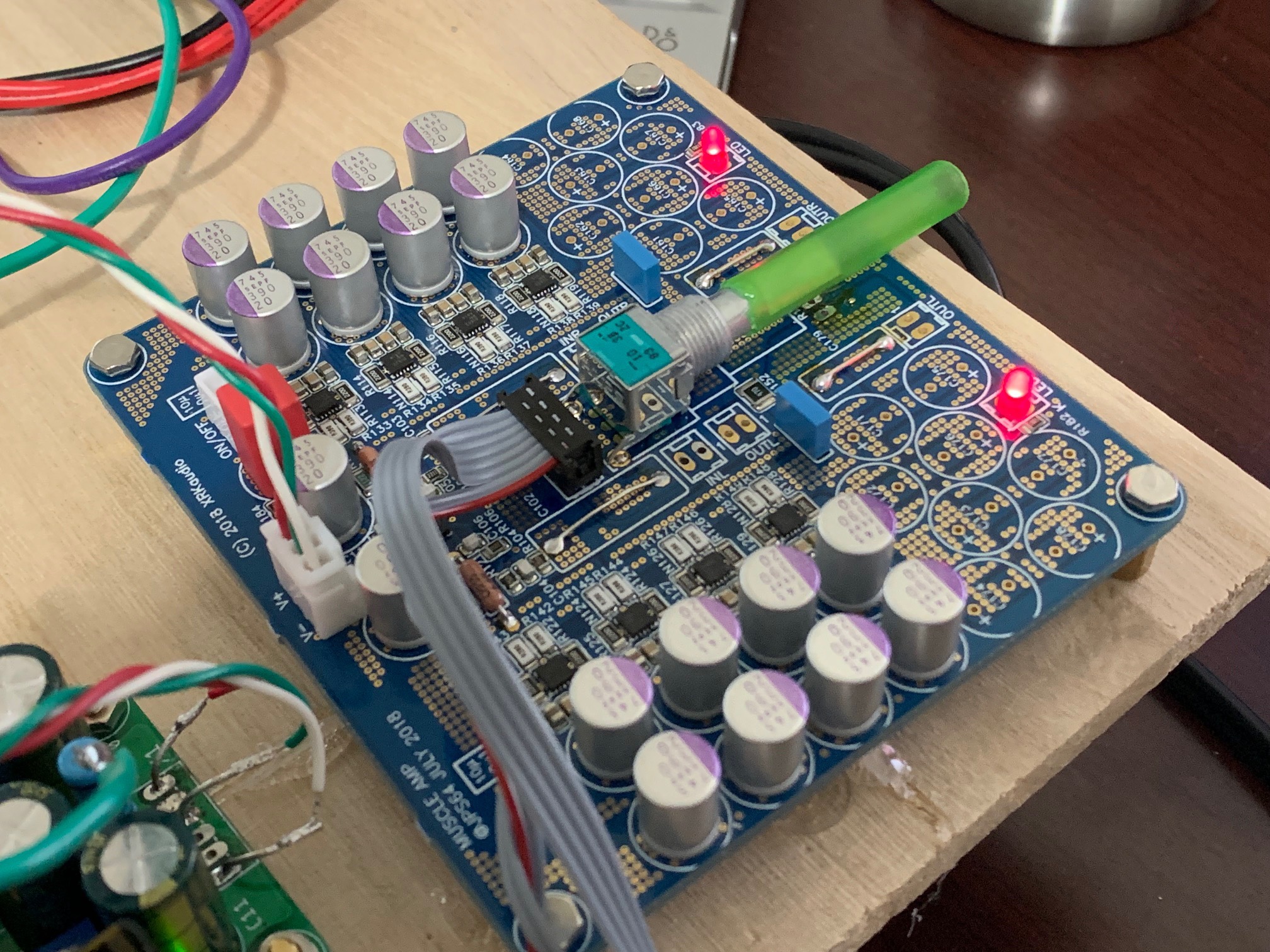

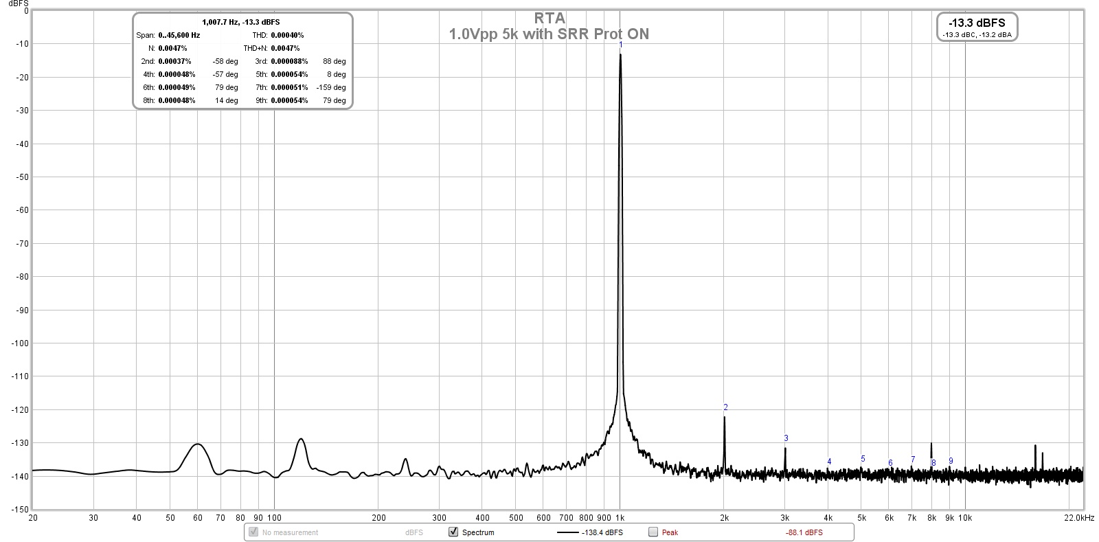

Here is test with a low THD 8x OPA1622 headphone amp driving the intrinsic impedance in the input stage of the Focusrite Solo (2nd gen) mic input (3kohm). I have a typo on the plot label as 5kohm, but it is 3kohm according to the spec's.
Using this HPA:
762056d1560169148-cheap-chips-opa1688-low-thd-muscle-amp-c1c18ca1-713a-4d46-88cf-c538bd805c4a-jpeg
Using the Akitika 2ppm 1kHz source, 1.0Vpp into 3kohm load, direct shot no SRR protection circuit in place:
attachment.php
Here is with the SRR protection circuit in betweent the amp and the input stage of the Focusrite:
attachment.php
The THD was 0.00040% for both cases, and there was a little more added higher harmonics (8th) at very low levels (0.000048%). FFT settings were 32k points, 0.94 exp averaging, Blackman-Harris 7 window.

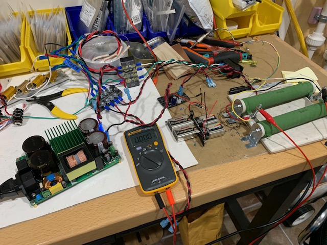

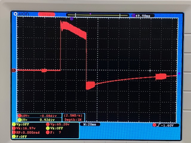

A member contacted me via PM asking me to test an extreme case of a low impedance load (say, 3 to 4ohms) and an amp stuck at max rail voltage (say, 48v). It was suggested that this condition might cause the MOSFET or other parts on this protection circuit to overheat and fail.
The test was simple enough to do: I used an 800w 48v SMPS and made a hand momentary switch with two bare wires that I would engage manually. This connected to the input of the SSR protection circuit, and the output goes to a massive 200w x 4ohm dummy load resistor. A DVM is connected to the PSU to make sure it delivers the goods and doesn’t switch off in self-protect, and an O-Scope connected to the dummy load to watch the transient. The protection circuit is powered by 4x9v batteries throughout to make sure it has the continuous power to do the job.
I then manually touched the contacts to close the circuit and each time, the circuit would work and turned off the conduction path and LED would go out as long as the DC held. Reliably, each time the DC was removed, after 3 seconds, the circuit would work again. I repeated this test over 20 times. There was not any sign of heating, funny smells, smoke etc. The circuit continued to work flawlessly. I left the 48vdc connected continuously for 5minutes to see if the board would get too hot. An IR thermometer showed 36C and touching by fingers could barely feel warmth. This was the dissipation in the DC sense resistor which was very well heatsinked to the PCB. The o-scope showed that the circuit reacts and cuts out the DC in 25 milliseconds, thereby preventing any further DC from damaging the speaker cone.
So the short story is, this protection circuit will continue to work and protect your speaker in the event of a full-rail stuck-voltage amp failure. It gets the job done reliably every time.

It was a conveniently available one. My low distortion amp would be a parallel 8x OPA1622 headphone amp. I don’t think any of the Alpha Class A amps would be what you consider a low distortion amp (compared to the Mod86 and its variants). My “low THD” amps are typically 0.005% THD 1w into 8ohms. If I have time, will try it on the OPA1622.
This is 1Vpp into 47ohms with parallel 8x OPA1622:
This is 4Vpp into 47ohms with parallel 8x OPA1622:
I had a TimS simple HPA that was pretty good but I gave it to Byrtt so can’t test it anymore. It was capable of this for 1Vpp into 47ohms:

It is for speakers, I don't have any ultra-low distortion speaker amps on hand. They are designed for monotonically decreasing harmonic distortion (with frequency) and overall THD will be in the 0.007% to 0.05% levels at high power.
Jhofland did measure the SRR protect circuit with an amp at 100w rms into 8ohms and posted the input signal and output signal on an O-scope and they overlaid perfectly. So perfect that you can't see the yellow trace below the blue trace. This is 80Vpp into 8ohms (or 28.27Vrms), is 10 amps enough current? It's quite apparent that there are no gross or even minor distortions from just visually looking at the perfect match of the traces:
770901d1564239251-ready-run-rtr-ssr-dc-speaker-protection-delay-gb-ssr-dc-protect-100w-8ohms-oscope-jpeg
Jhofland doesn't have the FFT measurement setup to do the distorton measurements at present.
If you want, I could send you a sample and you can put it through your nice AP setup and tell us what you think. Let me know.
Neurochrome.com
Joined 2009
I have plenty of Modulus-286 modules and Modulus-686 boards in stock... ;)
How do you know? From simulation?
That's fantastic! However, even a few percent THD is actually hard to spot on an oscilloscope.
Really? No FFT on the oscilloscope? No sound card (with a resistive divider so the input doesn't fry)?
I'll be happy to do that. Toss me an email with the measurements you need and I'll create a quote for you.
