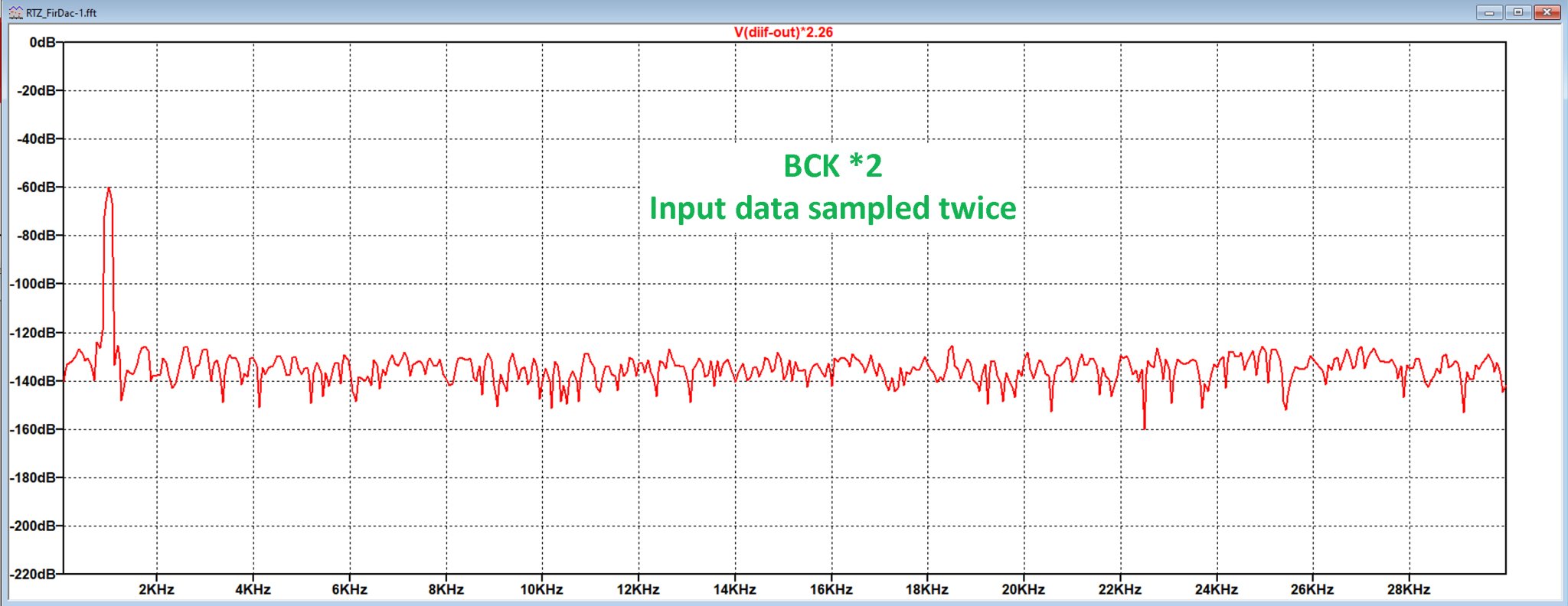

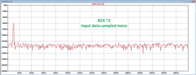

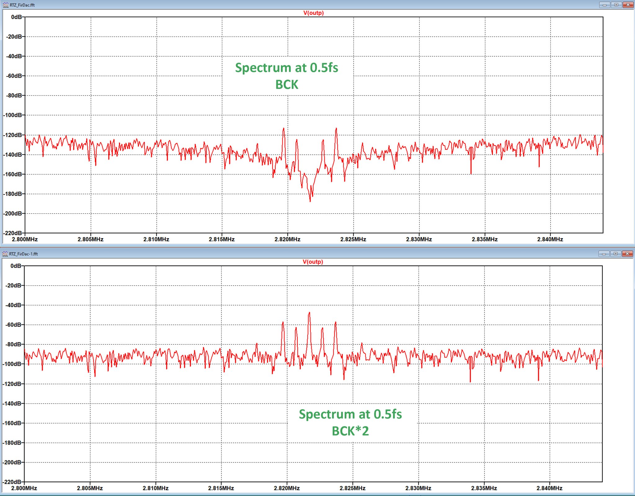

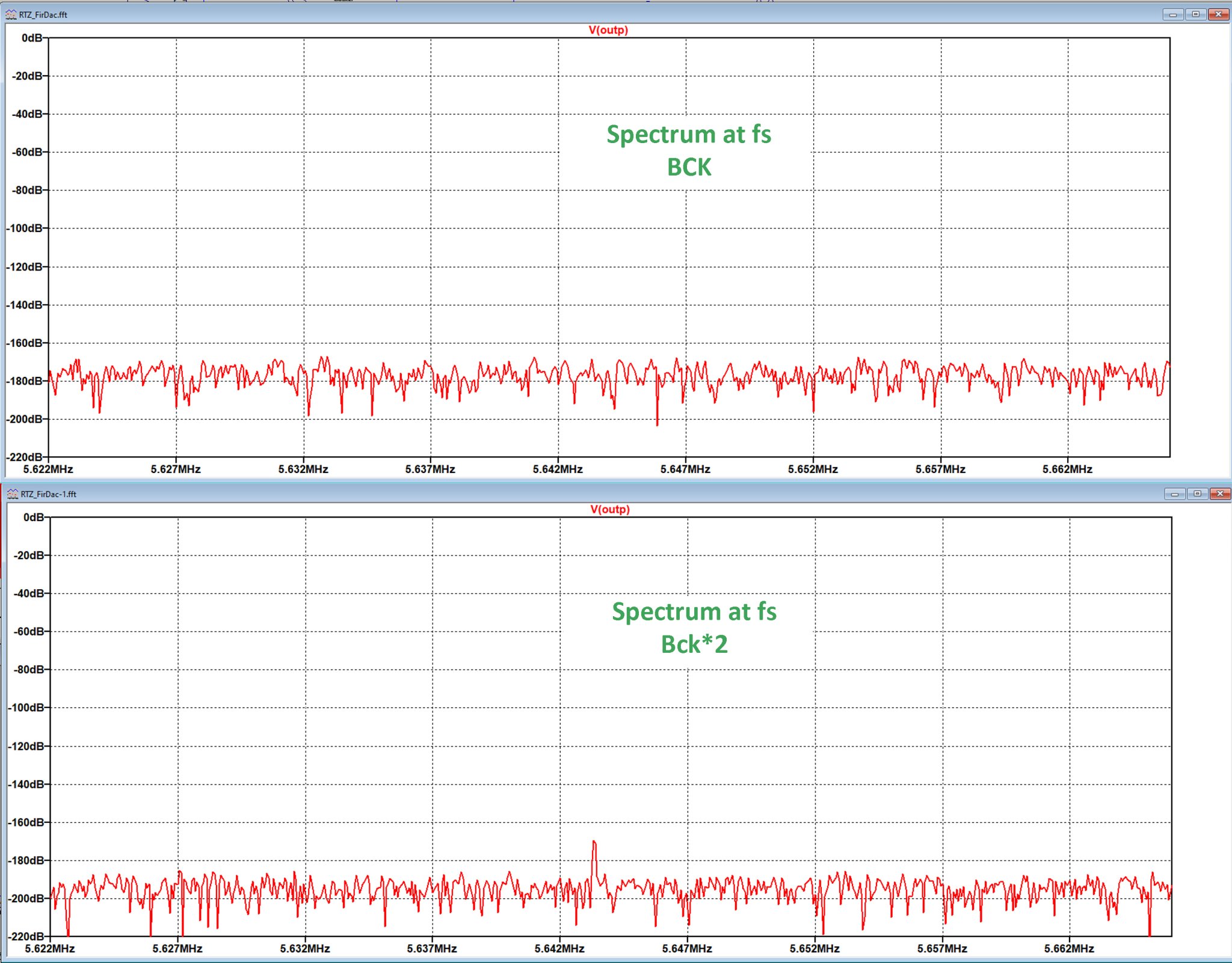

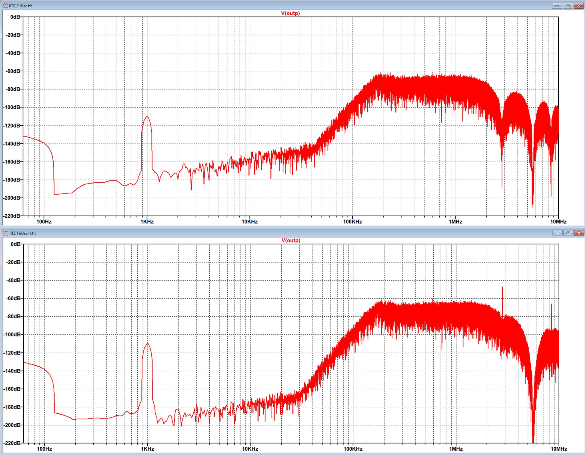

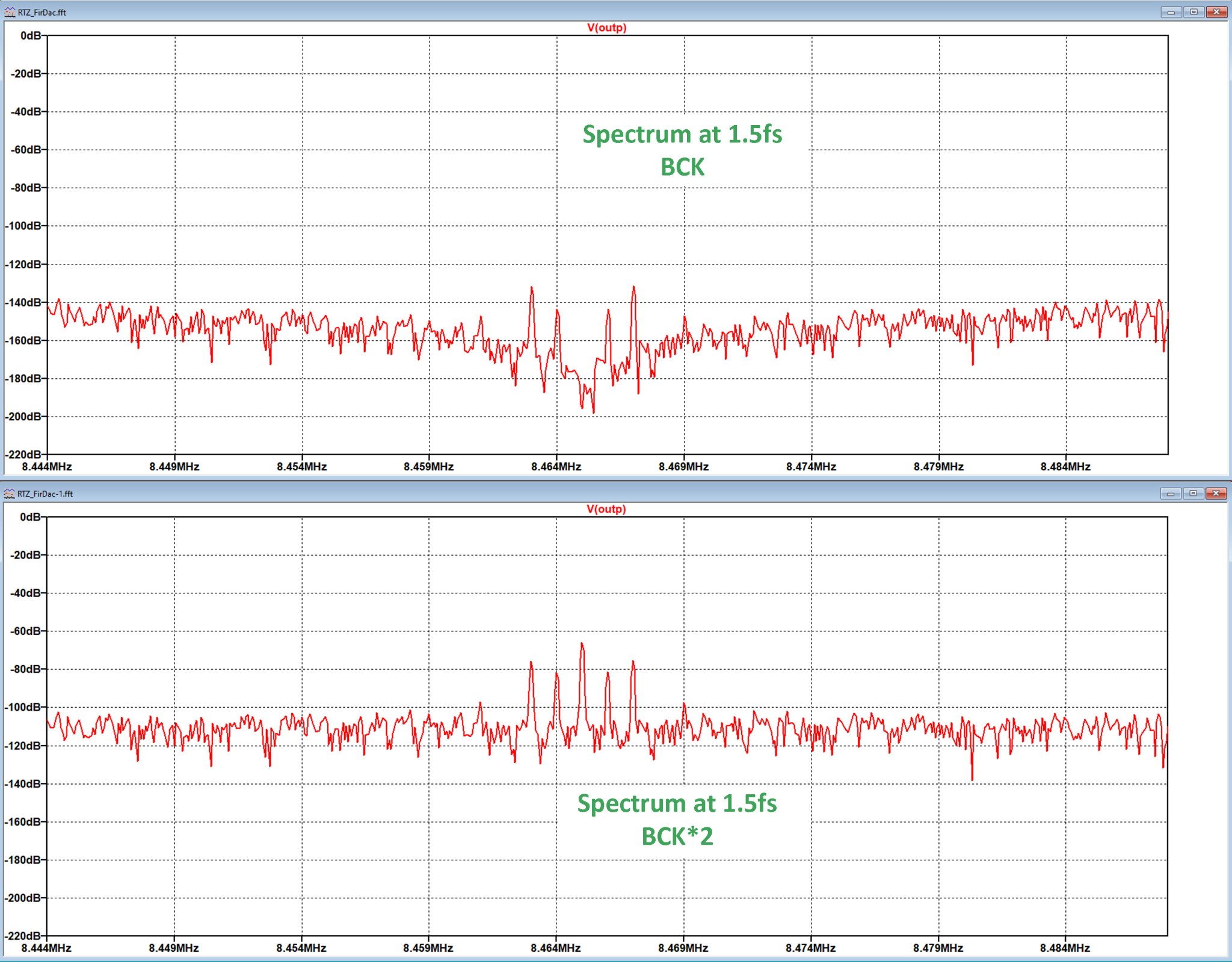

Since it seemed not possible with LTSpice to simulate the odd spectral lines caused by HF modulation when playing low level signals, Marcel suggested to look at the Firdac’s summing point with the original OPA2210 filter module attached, instead of looking at the filter’s output signal.
And also to possibly make the cause of the problem even more clear to double the speed of the whole RTZ Firdac and sample each original DSD128 sample twice

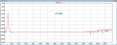

The spectrum of an unloaded summing point, as well as a summing point loaded with a LC filter’s of several orders, starting either with Cap or Inductor, all simulated to the same 105dB S/N up to 20Khz, perfectly corresponding to real life measurements, so this seems to be a reliable simulation result.
I tried 18Mhz OPA2210's and LT1468's op-amps, the latter being a 5nV/rtHz low noise op-amp with a 90Mhz GBW, and for both cases the S/N came out correctly with the right S/N.
And although the 18Mhz OPA2210 model performed, it could be that LT1468 is be a better choice for the first stage to suppress the odd spectral lines because of its higher BW.
Setup
  • For this specific set of simulations I used 2 different loadings at the Firdac’s summing point,
    1) the original filter with 18Mhz OPA2210 and 2) same filter with 90Mhz LT1468
  • File used was a 1Khz@-60dB .dsf file as provided by Bohrok.
  • Simulation time window was 16msec giving a 62.5Hz bin width.
  • Signal was sampled in all cases with a 2^24 point FFT, giving a 500Mhz BW to prevent as much as possible aliases polluting the signal in the band of interest
Results.
Since at the Firdac’s summing point there was no real difference visible between the spectra loaded with the OPA2210 or the LT1468 filter, only one set has been attached from resp. the spectrum zoomed in to 10Mhz, and the even further zoomed in spectra at 0.5fs, fs and 1.5fs.
Attachment 1, Spectrum up to 30Khz after the OPA2210 filter, confirming the correct functioning of the simulation model.
Attachment 2, Time Spectra at the Firdacs summing point.
Upper image part driven with BCK , lower part with double BCK repeating each input sampled twice.
See the high level spectral lines around 0.5fs and 1.5fs in the lower image, far above the above the same spectral lines when using the original BCK since its attenuation at the fs/2 is no longer there.
Attachment 3, Zoomed in at the spectrum around the original 0.5fs
Attachment 4, zoomed in around the original fs
Attachment 5, zoomed in around the original 1,5fs.
In any case, the idea of lifting the spectral lines by sampling the input data twice with a clock at twice the original BCK, made the spectral lines 0.5fs and 1.5fs raise by 60 to 70 dB, as visible in the attachments 3 and 5.
But now looking at the filtered spectrum, the filter with op-amps gave crazy results maybe because of overloading its input, that's why I used a 4th order LC filter instead.
With this filter no signs of modulation products are visible, see sixth attachment.
So in this case LTSpice doesn't have the right op-amp models to replicate what's happening in real life when huge amounts of HF are added to the signal.
Hans
An LC filter made of ideal components is linear and time invariant, so it cannot create intermodulation components. That's as expected.
I'm curious what your crazy spectrum at the output of the op-amp filter looks like. With 60 dB larger spectral lines around fs/2 and its odd multiples at the summing points, second order intermodulation products at the op-amp outputs should increase by 120 dB if nothing clips (to be more precise, if the second-order term still dominates). It is very well possible that the distortion gets larger than the intended signal.
By the way, using the normal clocking but changing the value of one FIRDAC resistor a bit (such that it doesn't match the others anymore) could be a way to increase the stuff around fs/2 by less than 50 dB ... 70 dB.

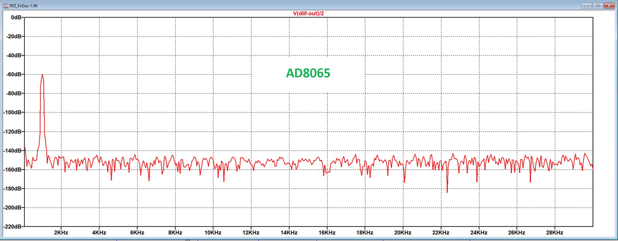

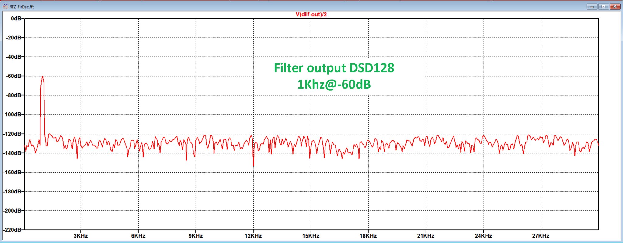

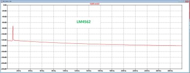

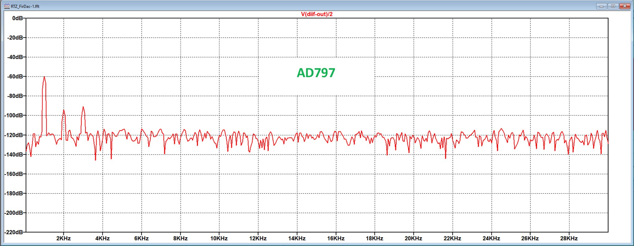

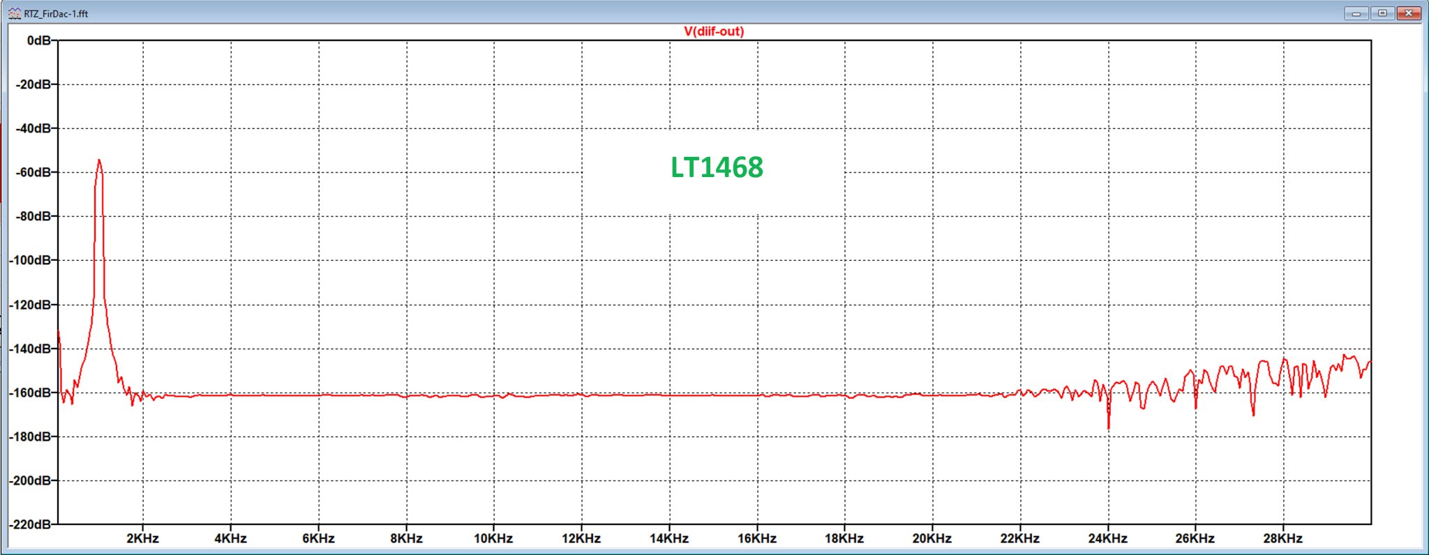

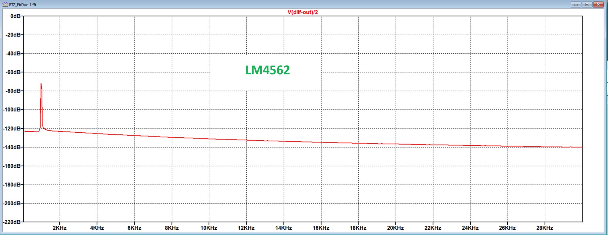

The 4th order LC Filter was used as the refence to prove that the whole setup worked properly.
Here repeated again as reference in Attachment 1.
Same setting as before, 500Mhz FFT BW, DSD128 sampled twice with a 11.29Mhz clock.
I used several op-amp in the original RTZ Firdac MFB filter.
OPA2210
LT1468, very fast low noise
AD797, also very fast
LM4562, according to Syn08 as the most correct implemented Spice model so far
OPA1656, a fast low noise Fet opamp
AD8065, also a very fast low noise Fet op-amp.
The OPA2210 and the OPA1656 kept hanging during the simulation, even after being restarted a few times without any result.
The LT1468 gave a spectrum without any credibility.
The AD797 came through with ca 6dB too much noise in the audio band and with odd unexpected H2 and H3 distortion levels.
LM4562 performed somewhat similar to the LT1468 with a spectrum that's far off
AD8065 looks nice but with a noise level at ca -150dB which is 20dB too low.
So not one of them gave the same result as the referenced LC filter.
That's what made me conclude in my previous posting, that this test is one bridge too far for simulating Marcel's MFB filter in LTSpice.
Getting these results took several days in full time simulations.
Hans

Transient simulations do not normally include analogue circuit noise; some simulators have a transient noise feature, but it is usually off by default, because it slows down everything substantially. I think numerical errors and aliases just happen to have about the same level in some of your simulations as analogue noise has in reality.
The AD797 result looks quite reasonable when you take into account that the noise floor is not representative and that the distortion products will be much smaller with the normal FIRDAC clock. The other op-amps either don't converge or don't distort at all; is distortion even modelled for the latter group?
