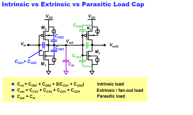

Regarding a calculation of the output Z of NBL553 at 20R driving a 50R line, IIUC the model of the source in would be a switch followed by a 20R resistor (inside the buffer)
Nope. The correct Model are two Mosfets, N/P-Channel. More precisely, the correct model for a clock buffer is this:
Unfortunately manufacturers are unlikely to provide non-encoded macro models at this level of detail and worse, in an encoded model we cannot even guess what is modelled and what not.
As remarked, when the signal is steady state, it will be equal to the N or P-Channel device saturated.
In dynamic state (when the actual edge happens - which may be what we are interested in) the impedance is poorly defined.
Seeing that current goes up as we approach crossover, it may be that at edge near mid-supply we actually have the lowest impedance.
Due to way N and P-Channel Fet's are made we can either balance capacitance between N & P or static impedance. Neither one is ideal. So there is always a problem somewhere.
So we have a voltage divider with 20R on top and 50R on the bottom that give the pulse voltage launched down the line.
Nope. The 50 Ohm termination is at the far end of the line. To what degree we get transmission line effects depend on a wide range of factors.

@ThorstenL : Thanks again for sharing your thoughts above in #2910 ... When reading about the P & N impedances of a gate:
it made me think of R2R DACs where a precise determination of the used gates' impedance is important to keep distortion low. Given the dynamic and varying conditions of the gate when switching I have been wondering how such a precise and reliable determination of the relevant gate impedance can be made?
It cannot, using discrete logic.
In this case, probably one would use a bit switch on chip that is designed to have precisely equal resistance. Something that is sometimes seen is a trim resistor in the N-Channel source that increases the resistance statically to match the P-Channel device. However this now again messes with capacitances.
With a complete chip to design there are no doubt ways to deal with it, Marcel would be the one to ask how.
If making a discrete DAC we have a problem that is likely intractable and also likely ONE of the reasons for the rather poor measured results, even with 0.001% naked bulkfoil resistors for 10 bux a throw.
Hence the spring Audio solution of a secondary "error correction DAC" running in parallel.
There is a wide range of logic families and only certain specialised bus driver IC's for use in driving impedance controlled backplanes have controlled and equal impedance. It seems to be a little challenging to achieve.
The 74ALVC164245 I intend to use as actual bit switch seems to be equal impedance of appx 35..40 Ohm in +/- directions and thus could be included in the calculations of the Resistor values for a Kaiser (or other) window function.
Is this something you have considered/know about?
Yes, naturally. In a true balanced DAC structure the effects of unequal drive impedance should wash out mostly. And using the bit-switch IC should equalise the issue.

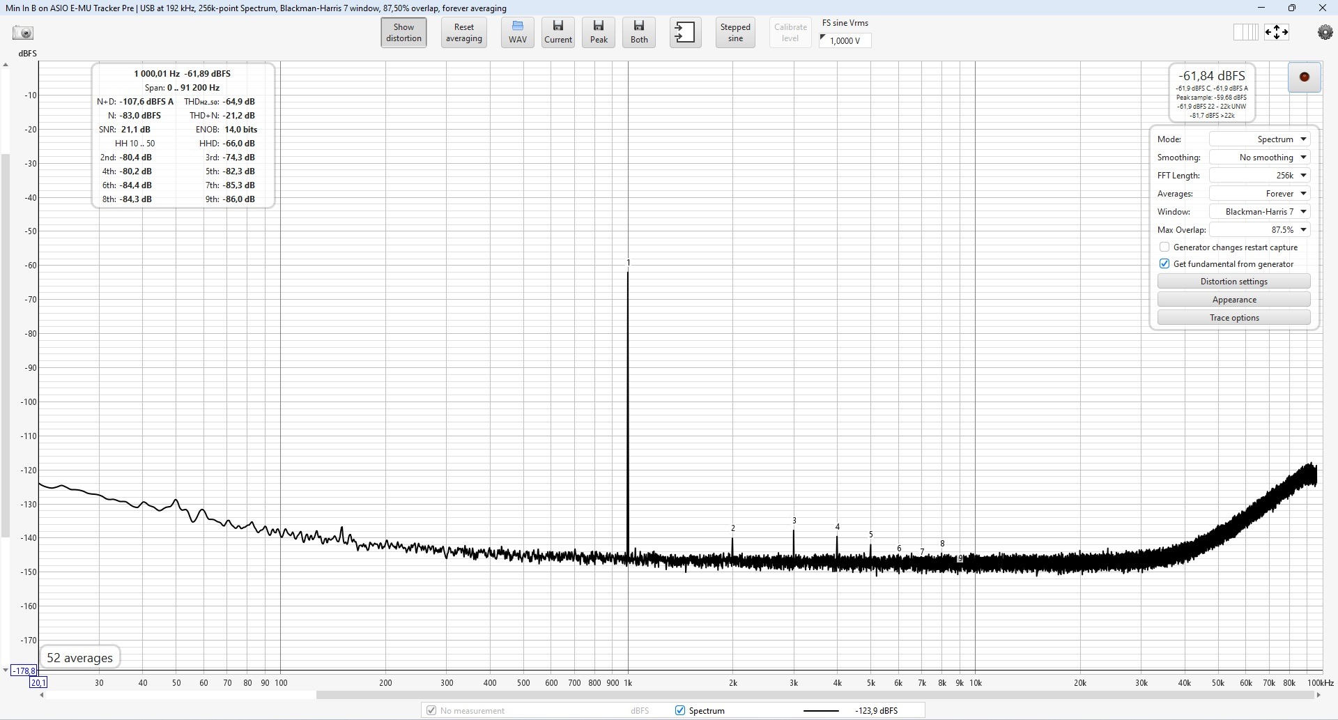

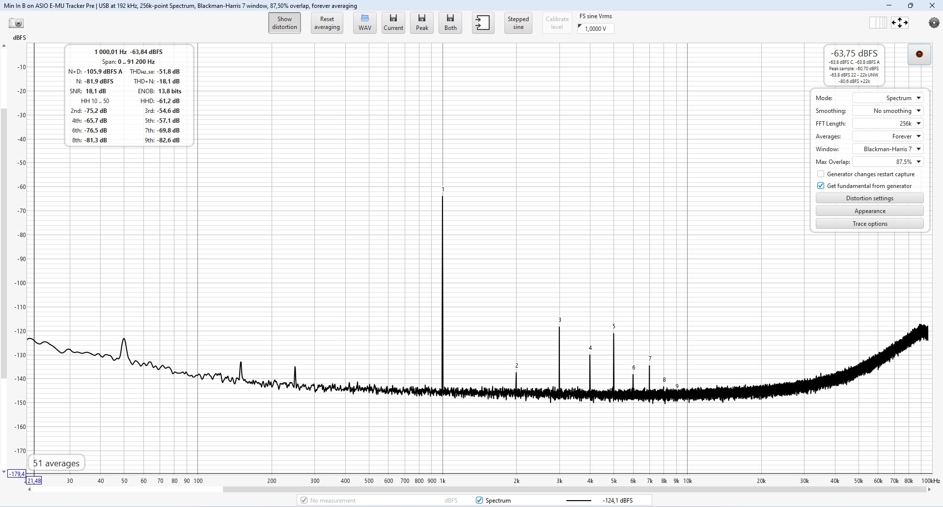

There is a little more to say about PCM2DSD today. Previous version does have what sounds like some birdies/state-variable-settling at when a note goes to silence. Its almost like a little "rattling snare drum wires back in the other side of the recording room" type of sound. Not all PCM to DSD converters have the same quirk, but they seem to have their other problems. So PCM2SDSD is not perfect, which I think we always knew. That said, it sounds better in terms of transient-attacks, imaging, and low level music details in the previous version, as compared to the latest version. Whether or not that is solely attributable to the dither I don't know. What I do know is that the dither level of the previous version was sensitive to very small changes on the order of .01dB. Maybe dB isn't the best way to measure it however, could simply be a particular pattern of dither occurs at a very specific level.

Both transistors are in saturation in the midpoint, so the output resistance is much higher than when the output is high or low. With series termination, if the transmission line delay is larger than half the transition time, the output will be high or low again by the time the termination resistor needs to absorb the reflection.
I use the term saturation in the way analogue IC designers use it when they talk about MOSFETs: VDS > VGS - Vth (according to overly simplified strong inversion equations), MOSFET acting as an amplifying device rather than a switch. Power MOSFET designers use the exact opposite definition.
??? I would posit the opposite is true.
Both transistors conduct at maximum, so in effect they appear for AC more or less in parallel (depends on parasitics and bypassing) the impedance is in fact lowest. We certainly see this in Transfer Gates (aka analogue switches) where impedance is lowest midpoint.
However, if instead my "inductive" reasoning is wrong and instead the impedance at midpoint is the highest, it does not change my core contention that the output impedance of a CMOS Inverter dynamically is nothing near constant, but very variable.
My main point is to highlight this, as there seems to be an assumption of a reasonably constant value.
On PCB's we often do not have traces long enough compared to the output rise time to get TL effects.
So in this case we drive a capacitive load. With a nonlinear impedance.
There should be no problem to look at these differences in DeltaWave as they should be higher than the tiny spurs which you could not hear although those were easily seen on measurement. So do you have a recording or a passage which I could use for this?
Of course it possible to show differences between any two PCM to DSD algorithms; it can be done with two different HQ Player modulators. The question I have is how do you make sense of the differences? How do you know if one sounds better than the other? If you want to know that just listen to both on a good enough system. Its more direct and to the point.
As I have said before the improvements made to PCM2DSD firmware were intended for Marcel's RTZ dac. Listening to it with another dac and making sweeping claims based on that without any real evidence is just your normal way of trying to get attention.

...they were also distortion at low signal levels...
Except as Marcel reminds us from time to time, its not necessarily distortion in the traditional sense. Its more likely birdies, chirps, and other weird little noises that have some correlation with a bin frequency. Thus the level of such a spur only represents an average level of correlation, not peak quirky noise. Right?
So the spurs are indications of one of the things that is changing. That's not necessarily everything that changed though. Transients don't show up well on typical FFTs because they are very dependent on phase, which is not shown in the graph of correlation-magnitude versus frequency.
Measuring transient behavior to similar accuracy requires a very different type of test. Its possible to produce more of a transient time-domain waveform by using a multi-tone test signal in the frequency domain however. But we need to look to see that phase is preserved at the output for each tone of the multitone test signal.
Or as someone else effectively summarized in another thread: we know the result of our measurements, but we are blind to anything we don't measure.
