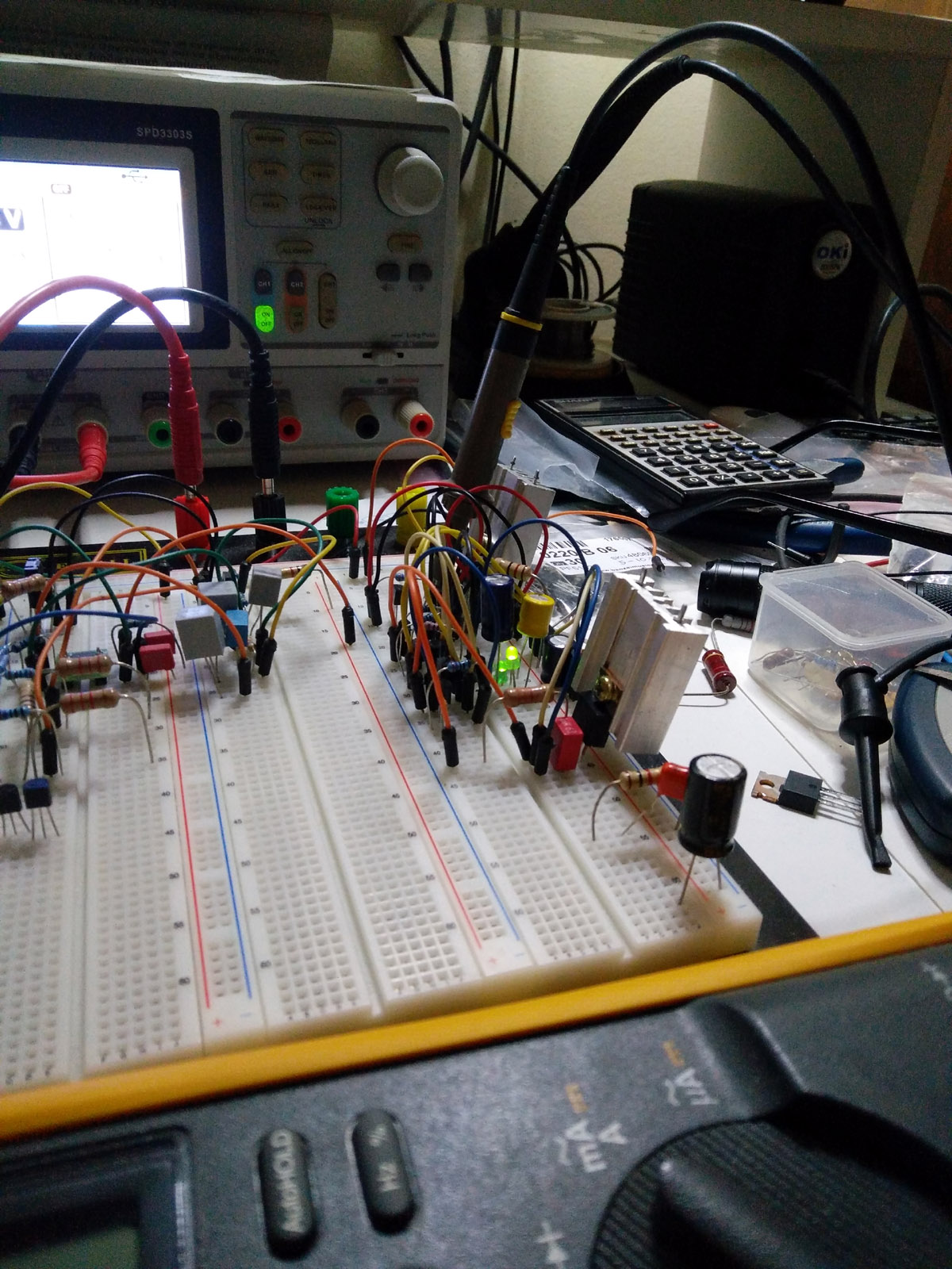

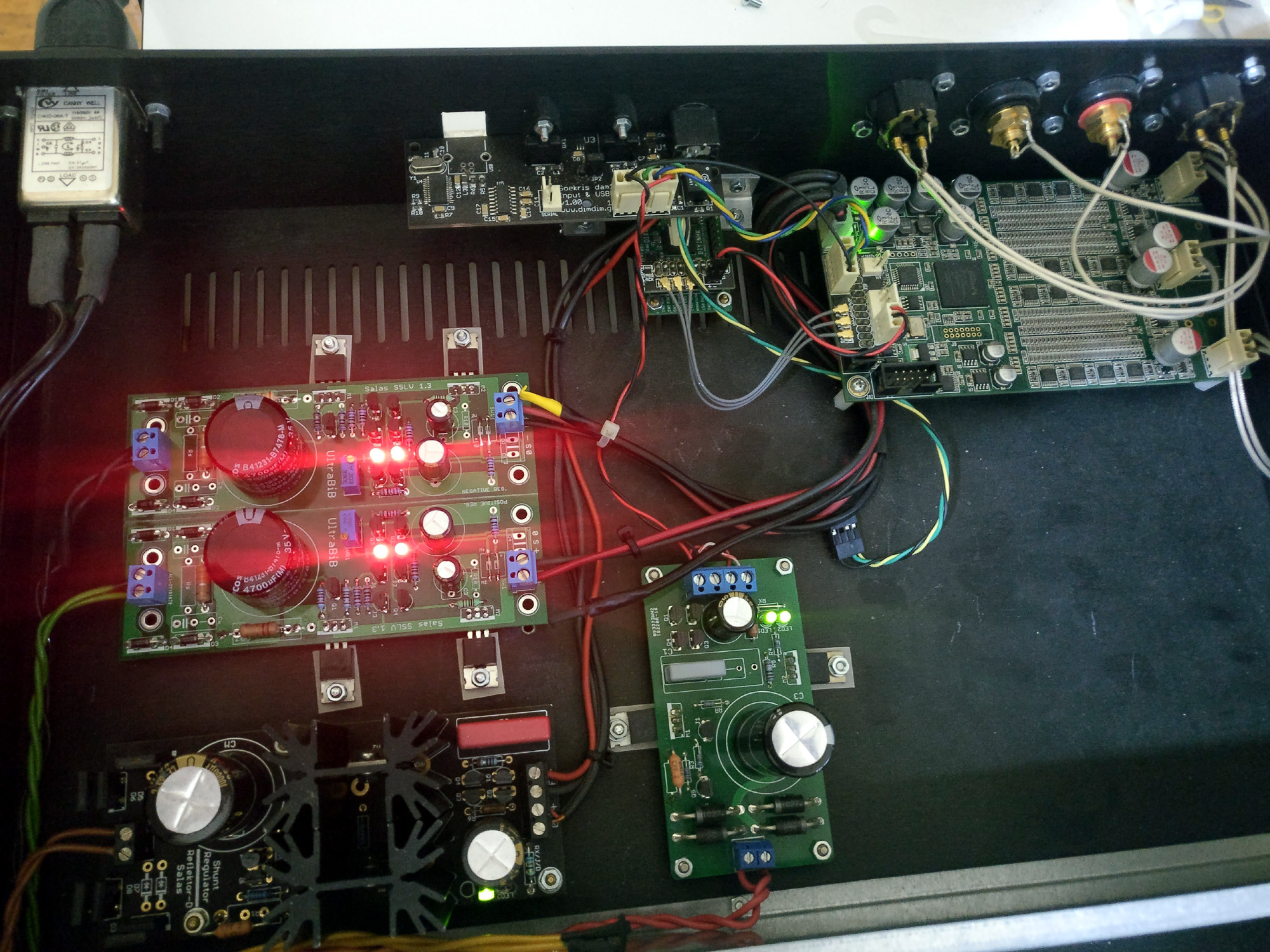

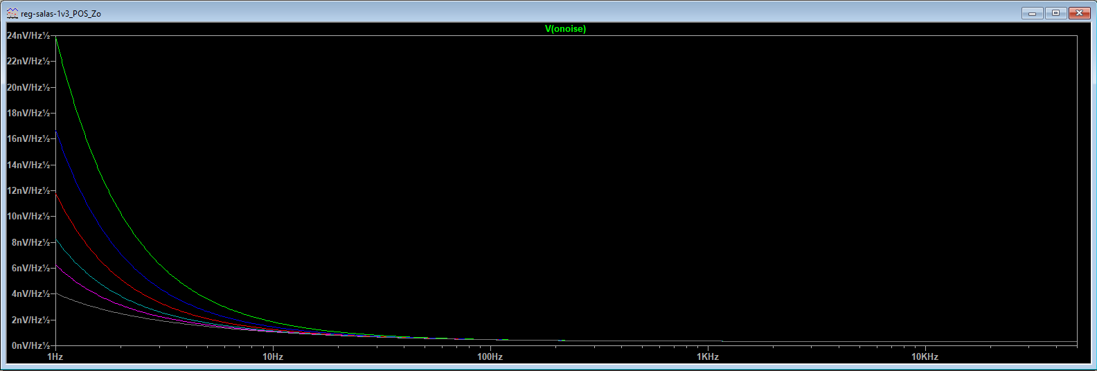

As the beloved SSLV1.1 BiB shunt reg was getting long in the tooth, especially for NOS JFETS, I had in mind for some time now to design its successor. The goals were: 1. In production parts 2. Much simpler to set up. 3. Better technical and subjective performance.
After many breadboard experiments and two prototype PCB iterations I feel that my goals were finally met. So here comes the UltraBiB
-Uses no NOS parts.
-Can do 5V to 40V output without changing a thing in its parts configuration.
-Nothing to choose and match. No tolerances in predicting its CCS limit setting.
-Has 45dB more open loop gain and many times less output impedance than 1.1
-Sounds easily better.
-Its an electrically and mechanically drop in replacement for an upgrade.

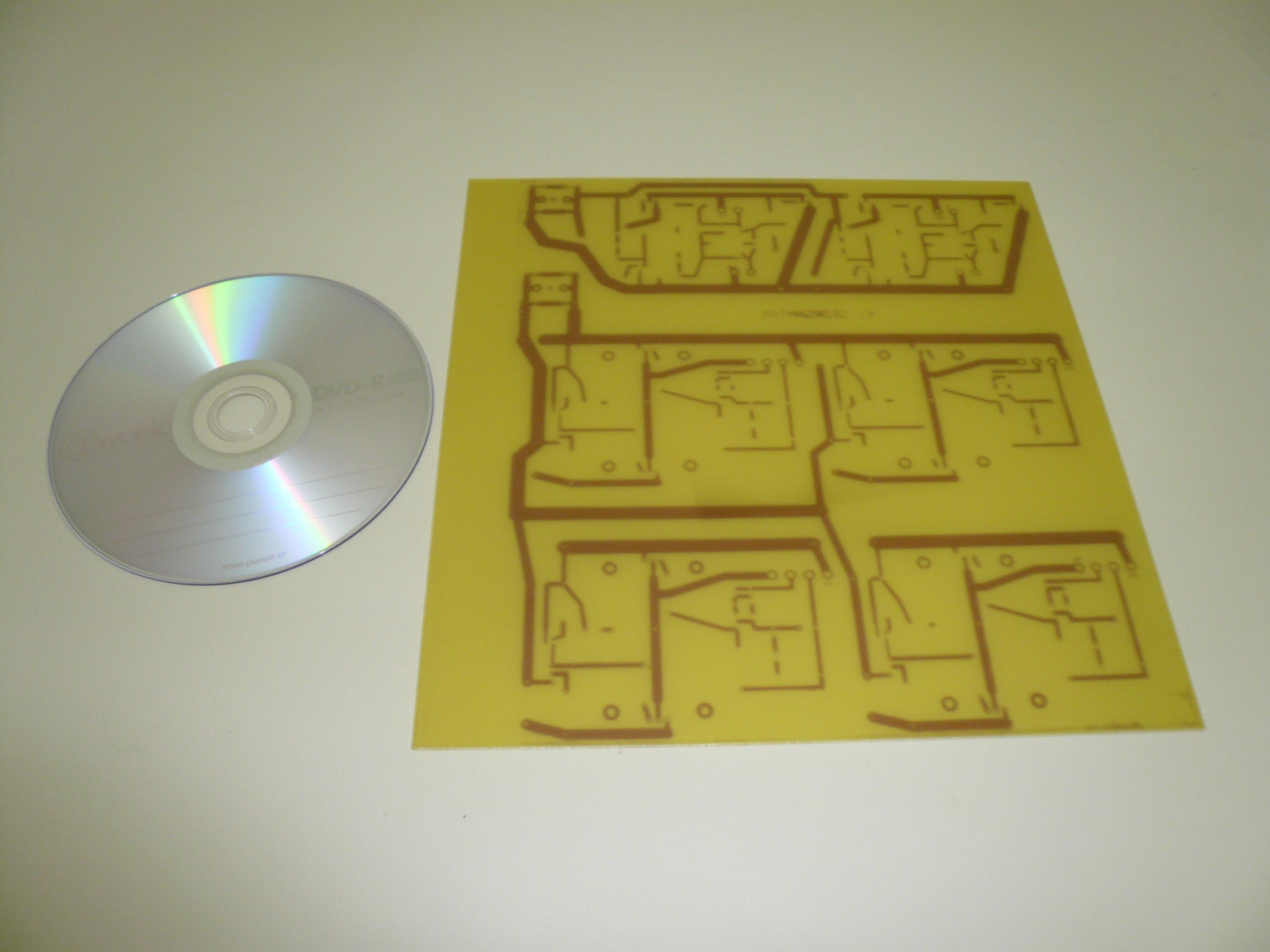

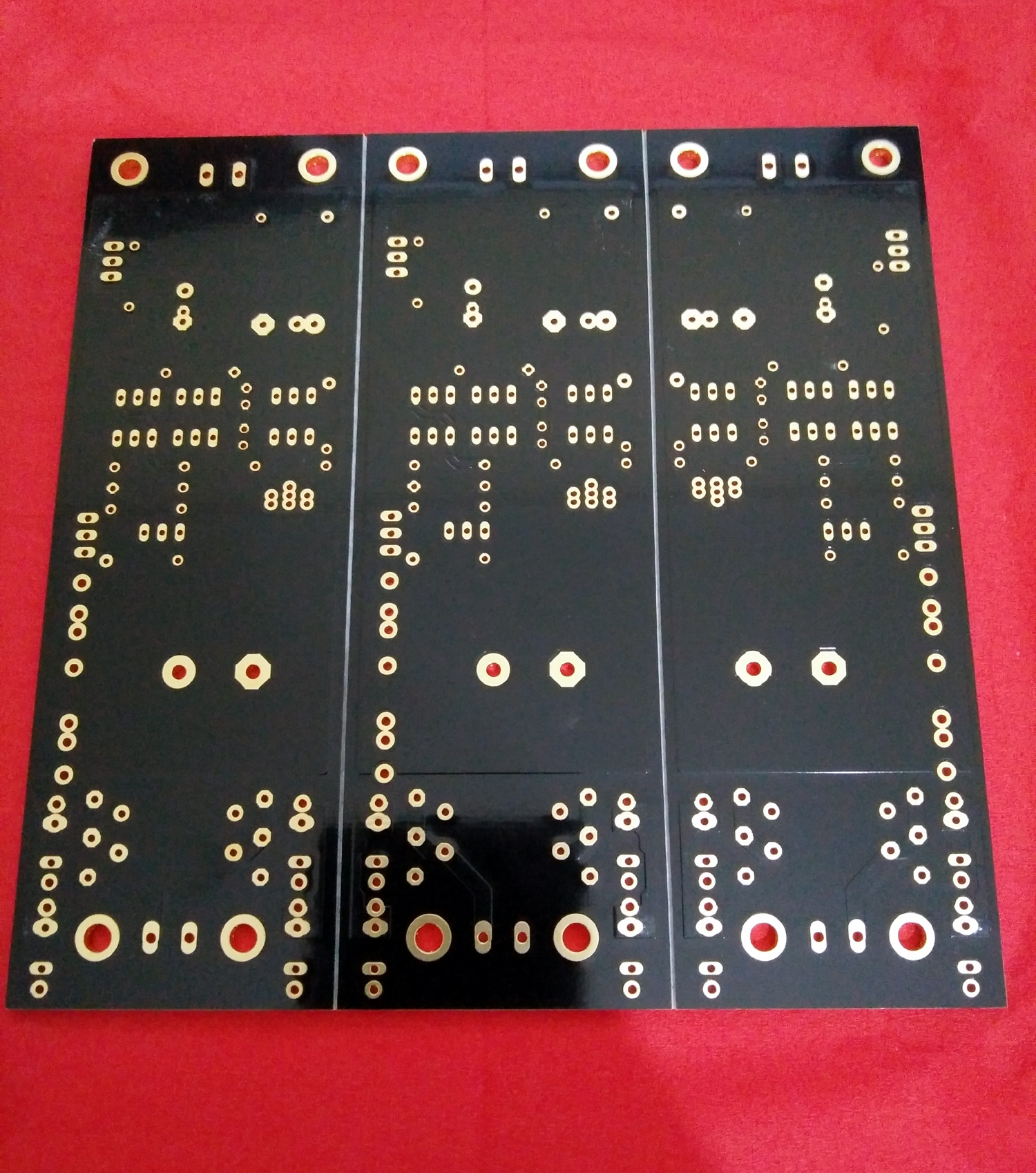

I have already given spare earlier proto boards with now deleted experimental features to few local beta testers. They are all happy by now as far as I know. The pictured board in green is the final layout in just cheapo proto that's a pain to rework and its pads vaporize in the end. It will come in proper grade black solder mask and immersion gold three sections board just like the original.

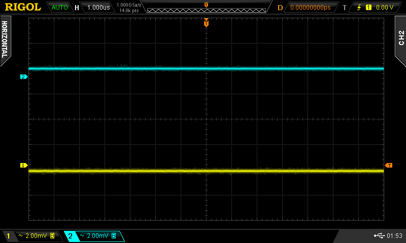

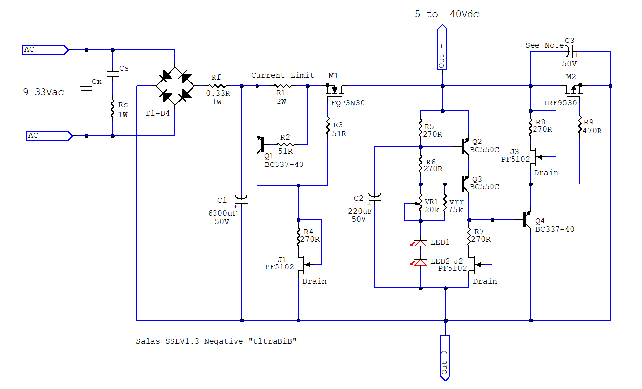

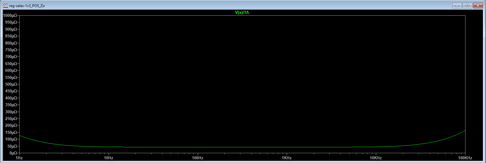

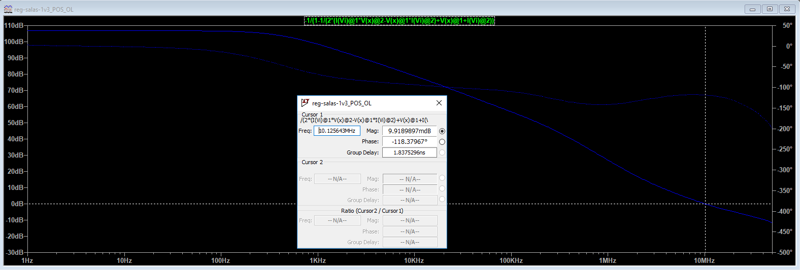

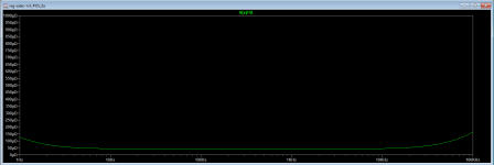

Attached: Zout plot for 150ma spare current and noise plots for 100,150,220,330,470,1000uF C2 (red 220uF). Also the rails probed on the scope for positive and negative sections. Here are typical values schematics also. I will write a PDF with instructions. Not that there is something truly special to consider when building it with the suggested parts but to describe it better as an item and to clarify details and precautions.

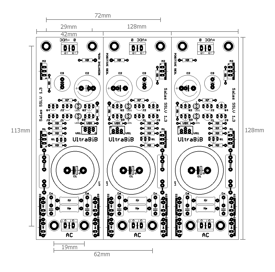

24/5/19 Triplet board dimensions picture

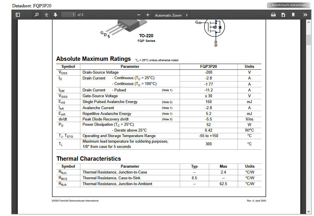

Will this be able to supply 2A continuously at 25VDC output?
The 100C core temperature continuous ID limit for the FQP3P20 is 1.77A and 2A for FQPN30 as M1s and you can push them when having enough sinking for them as the ID max goes up when cooler inside. The spare current (current limit CCS seting - load pk current draw) can remain low circa 100mA to 150mA since the Zo spec is very good with little spare and you save on output Mosfet's heat at least.
nice results!
How was the ground plane? Only on pcb bottom?
Have you made a star ground in relation to rectifier diodes, or covered all areas?
Can you show any pictures?
Best Regards
Regards
Edit: There is an error in the prototype board. Corrected in the normal GB issue black triplet boards.
Edit2: Here are the normal issue boards (some weird stripes on the first's right side are light effects)
Salas, thank you for sharing! Can we use BC560C throughout the regulator or you had “hidden agenda” for the 327’s?
Yes you can use BC560C/550C only. The 327s and 337s are lending bit more phase margin in the CFP driver role and bit less noise in the current limiter's ref. This way its little better.
It was time for the succesor of BiB 1.1 and voila the UltraBiB 1.3.
With a simpler design but more performance and with a Quasimodo snubber at the input.
Welcome UltraBiB 1.3!

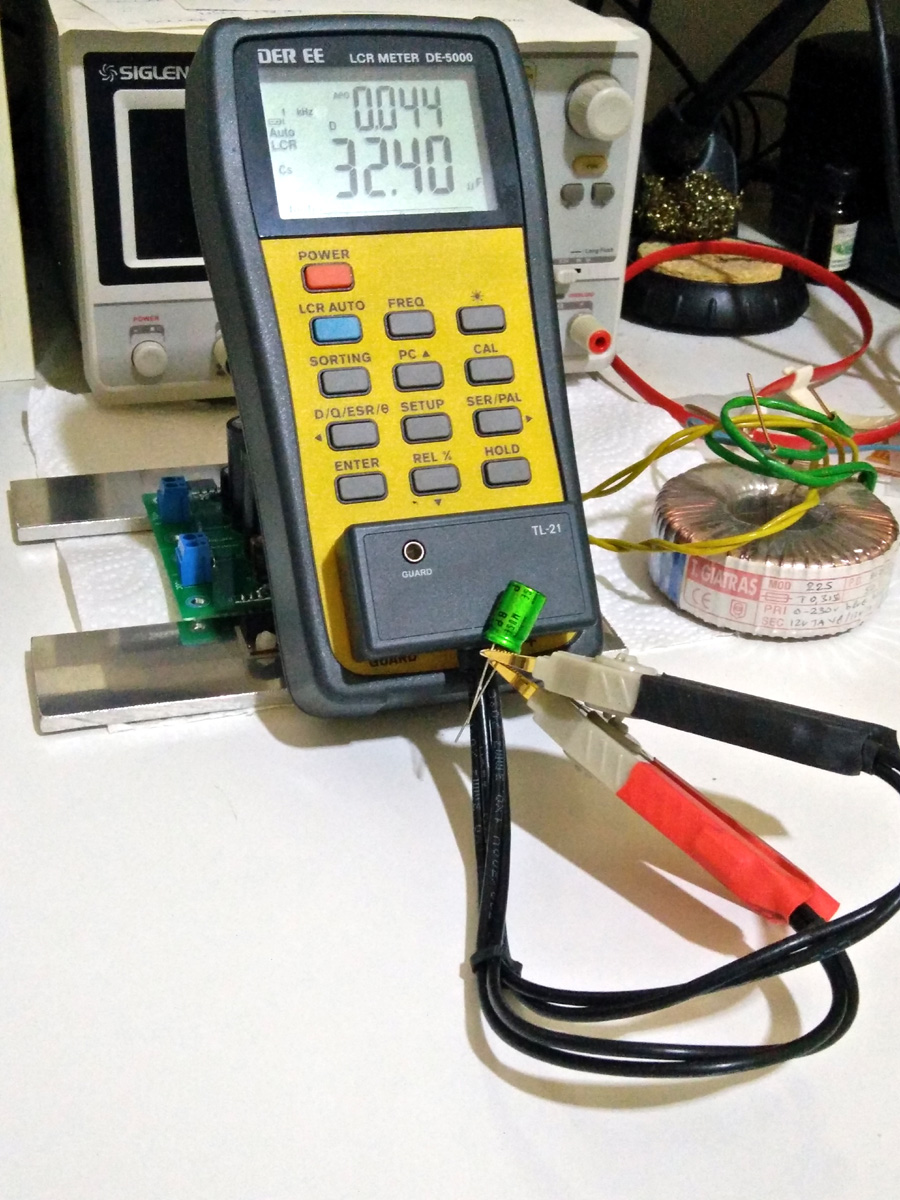

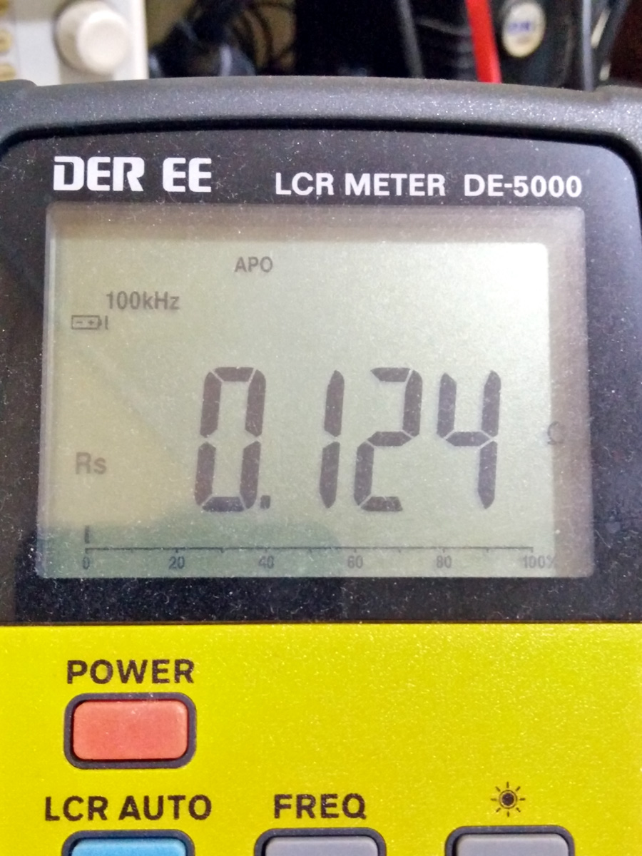

Keep in mind that the board design and C3's cap choice are critical. Thus the 100kHz ESR note (coming from real tests on the LCR meter). I have already proper C2 & C3 suggestions from Panasonic and Nichicon to propose.
