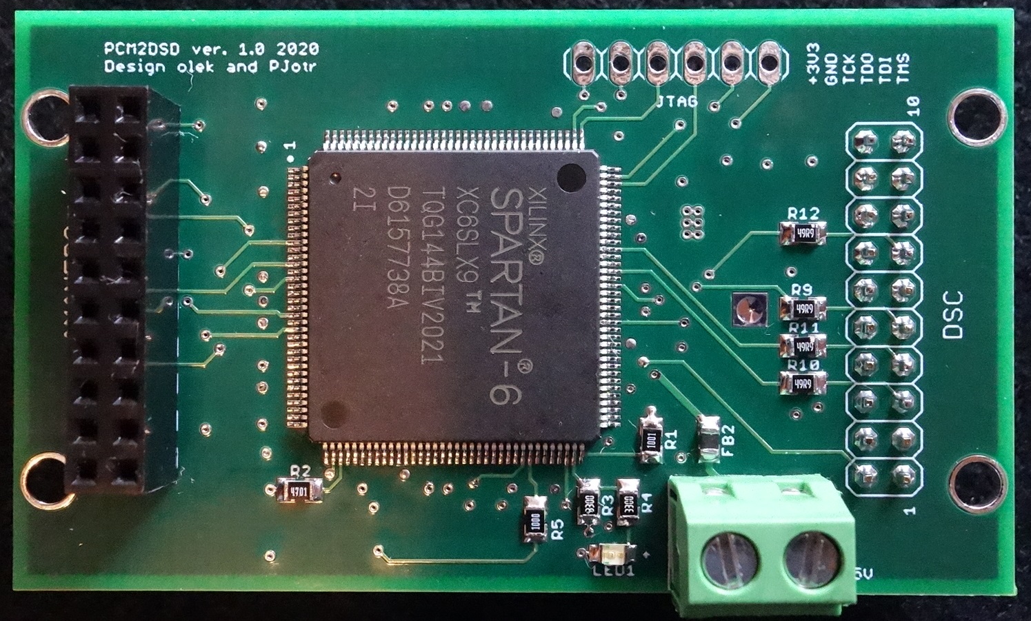

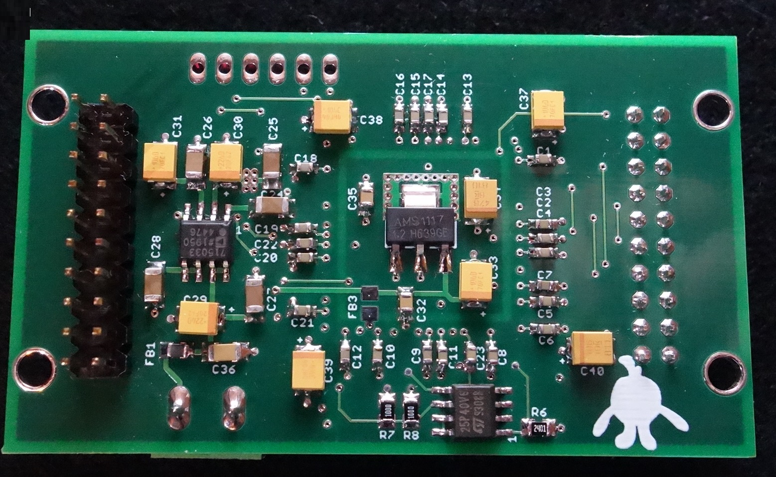

It's nice to present this project - separate delta sigma modulator for a dsc2 dac.
Special thanks to Jussi and Pavel.
The basic idea is to convert pcm to a dsd stream without the use of a PC.
Design flow goes as follows:
i2s serial data is converted to parallel, next we have the first interpolation fir filter,
in this filter the data is oversampled x2, x4 or x8 - this depends on the incoming data rate.
(for 44.1kHz we have x8 interpolation, for 96kHz x4 and for 192kHz x2)
next, the data is going to the two stage CIC filter and is oversampled x32 to final x256
Then the data is going into the sigma delta 7 order modulator, which has classical CRFB structure,
as I said earlier all arithmetics are done in CSD arith, so no multipliers here.
all coefficients are carefully optimized using delsig package
If someone asks, yes, there are g0, g1, g2 coeffs.
At the end the dsd streams are time aligned using ODDR2 primitives
XC6SLX9 is almost full, so there is no ability to add anything :)
The device was designed to run with a mclk of 22/24 MHz.
To upload the attached bitstream file to the board you need a Xilinx programmer cable and Xilinx program Impact.
In the next post my friend PJotr will post gerber files, BOM and some measurements.
I hope this project will be interesting for someone.
DIY use only!

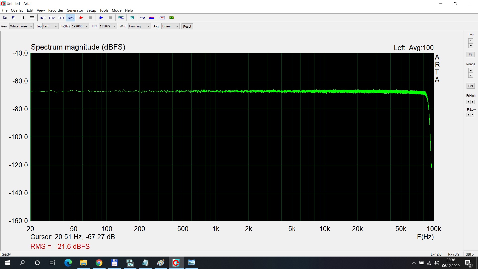

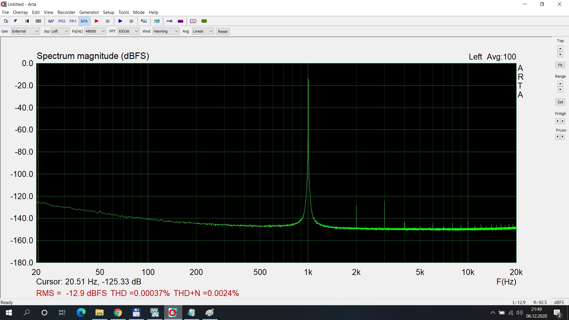

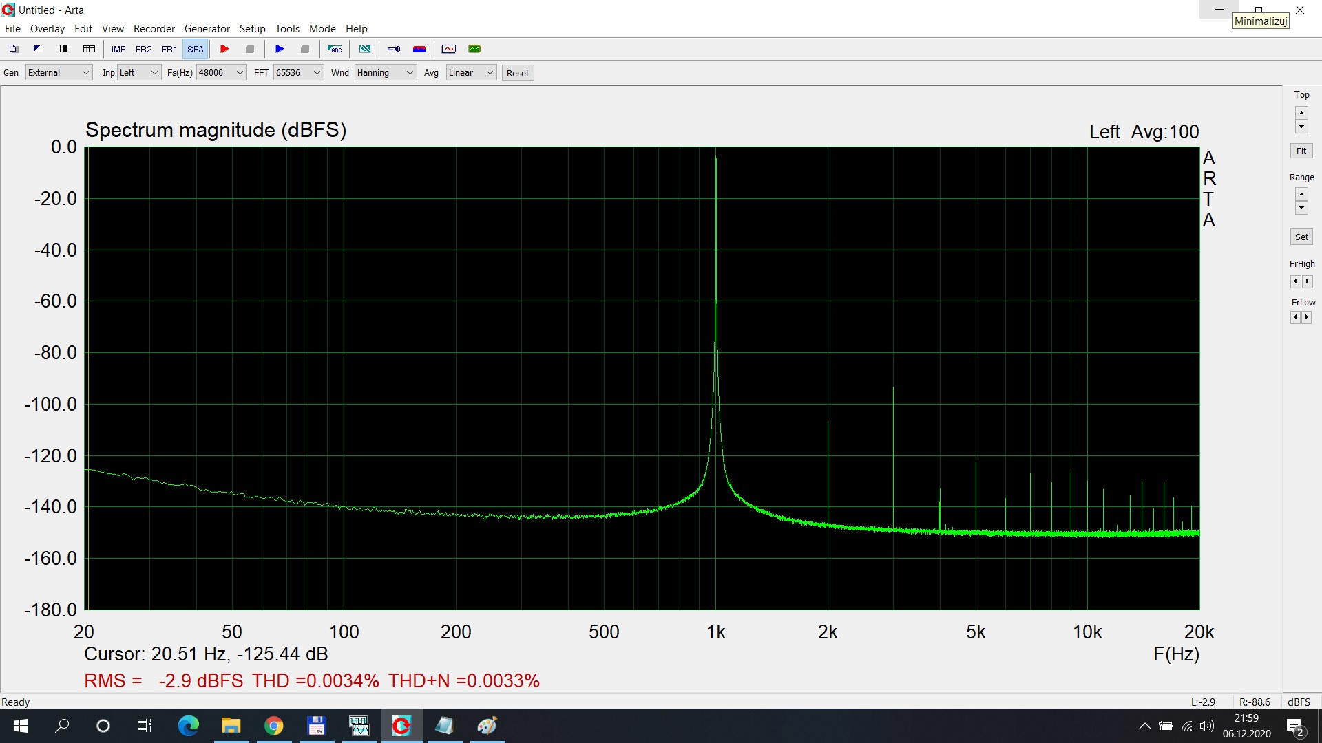

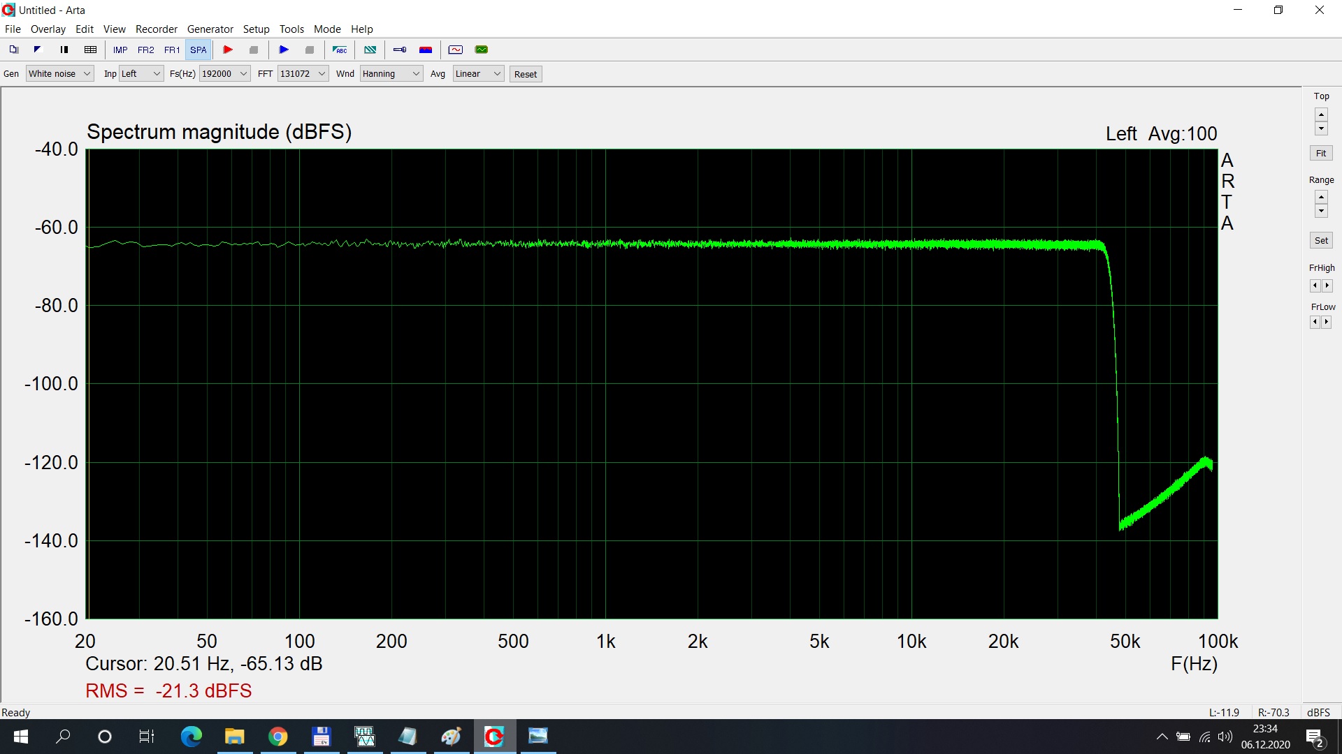

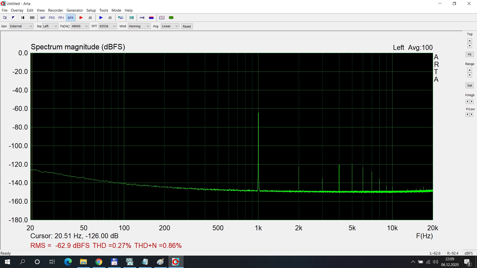

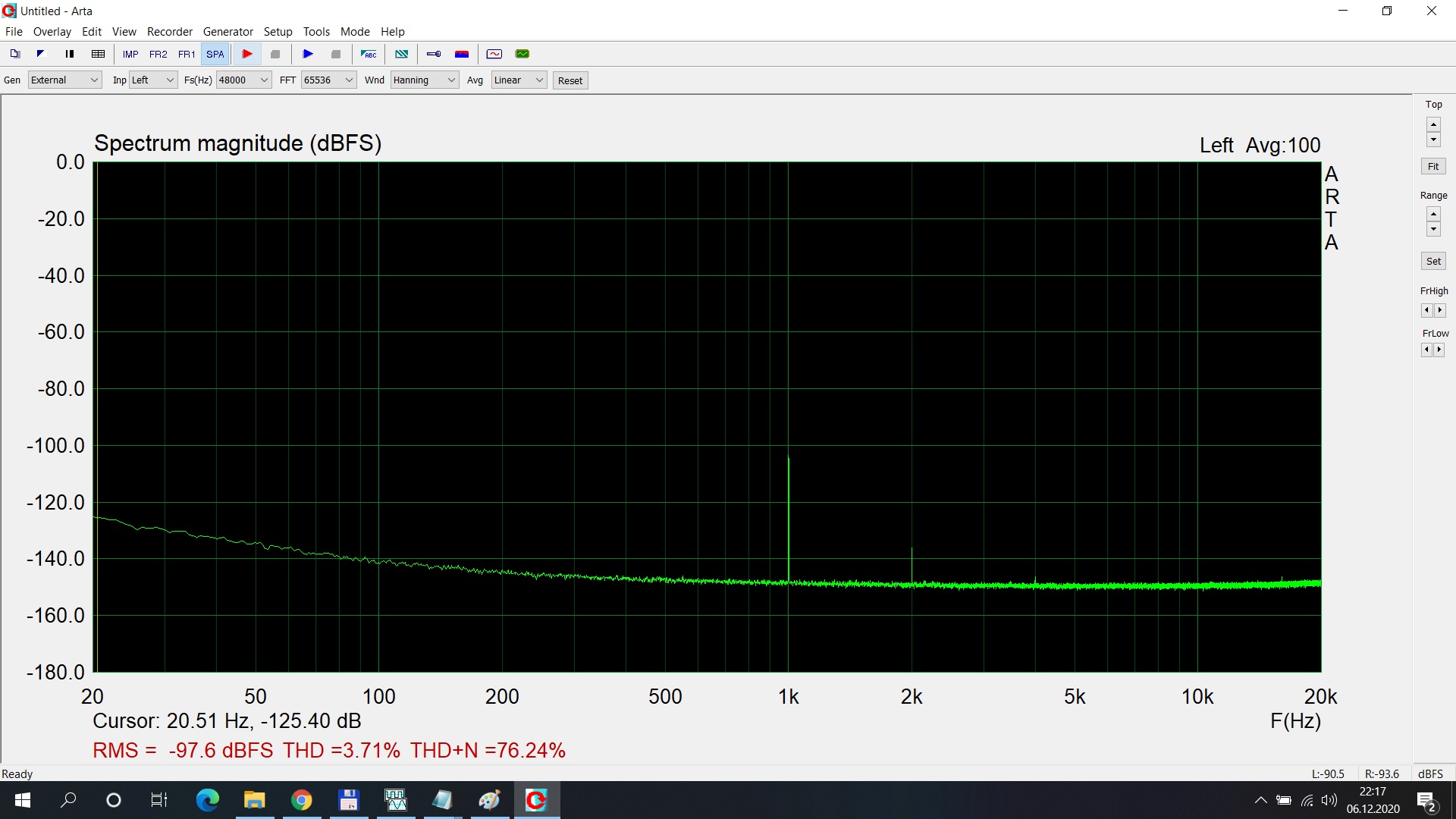

And now some measurements.
4 pic with THD for signal 0dB, -10dB, -60dB and -100dB.
3 pic with band of this modulator for input signal 44.1kHz, 96kHz and 192kHz.
These measurements are with DSC 2.5.2 (thanks to Jussi and Pavel).
