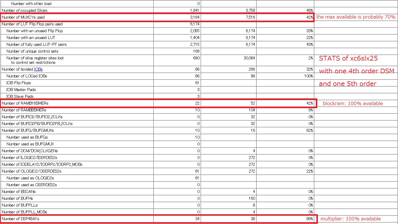

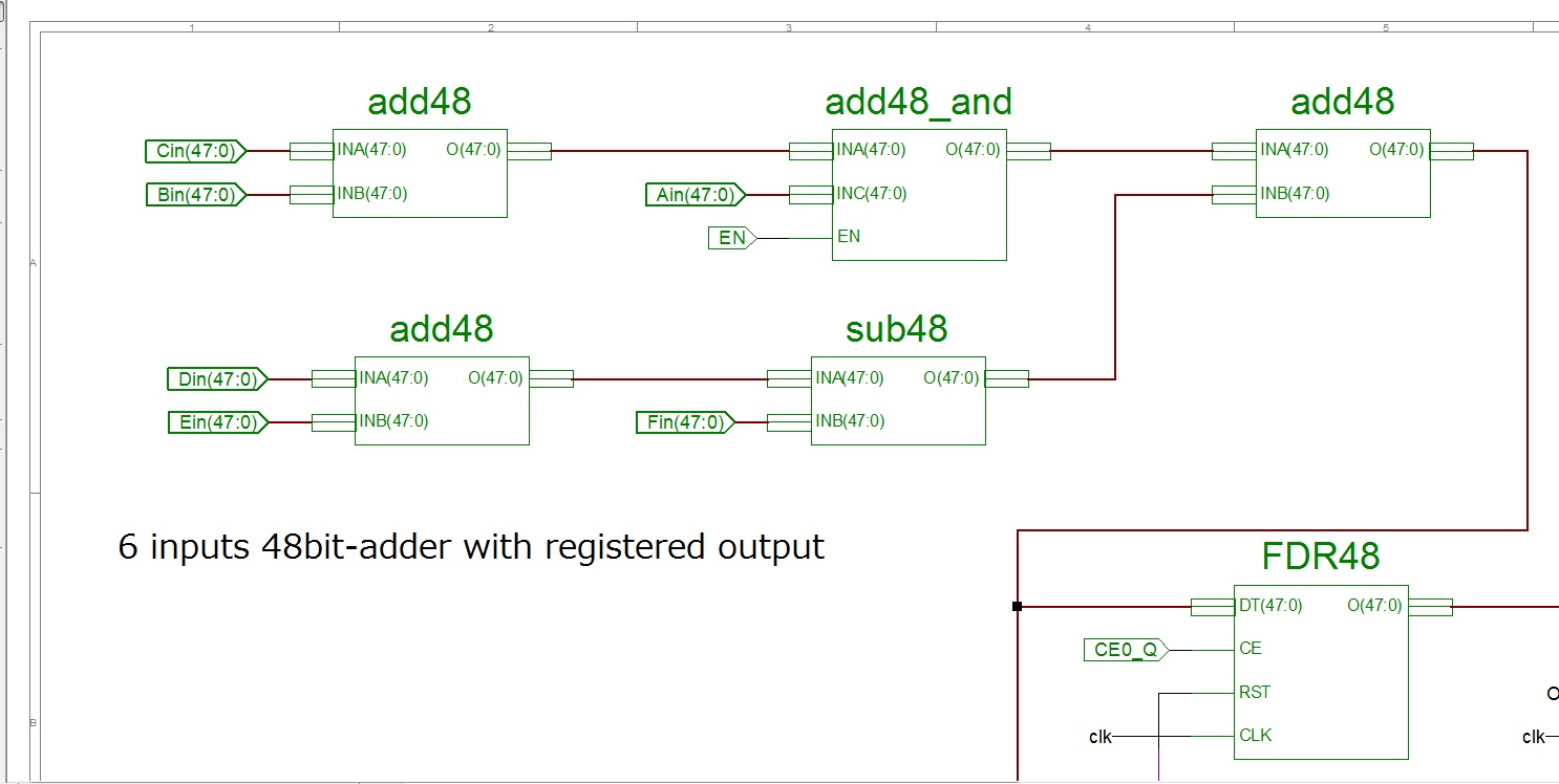

olo111 and Markw4, Thanks for your information. I have almost understood what CSD means. Multiplierless solution is fantastic, indeed.:) But I think you need to tweak CSD for a specific FPGA architecture because the adder also has the limitation; available numbers and speed. As you know, CRFB requires six inputs adder if you include local FBs(g0,g1,g2). Three stages adder(pic.1) is probably max due to propagation delay. It occupies many adders. The very trouble that forces me to fail the routing is not the lack of multiplier but adder, which is invisible even in ISE circumstance(pic2). My strategy is usually full usage of block ram and multiplier(100% guaranteed) and as little usage adder as possible. Xc6slx25 can implement up to two 6th order DSM in 160OSR. Of course, I guess you have a CSD-based strategy. ;)

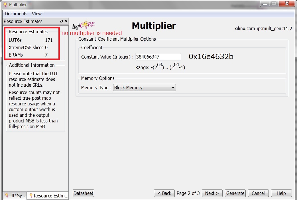

A similar technique like CSD is a constant coefficient multiplier, which replaces a multiplier with block ram. Pic3 is multiplier less calculation of g1(0x16e4632b) for local FB. The calculation of a0,a1,,,, and a6 doesn't need a multiplier, too. The total number you need to calculate DSM is six 18x18 multipliers, acceptable even with a small FPGA(xc6slx25). That's my strategy, and you have another one. It's wonderful everyone has their way. :):)
