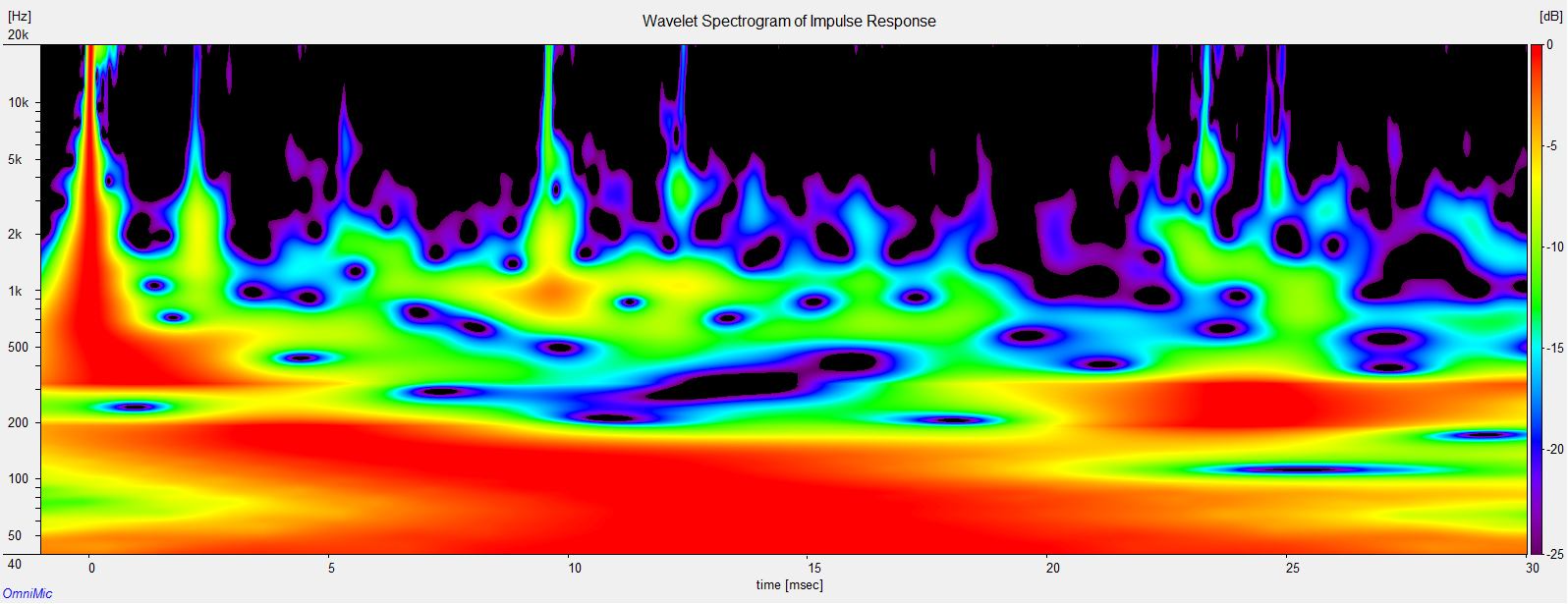

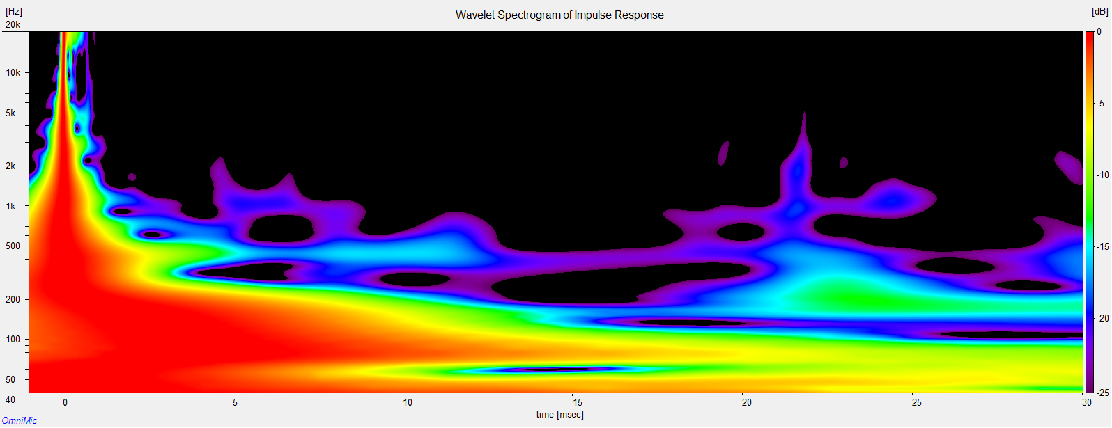

Here are some wavelet spectrograms, measured close in and near listening chair. (The EQ isn't set up for a sweet spot, as there are several regularly used seats and seats get moved around).
Don't know if these are comparable to WeSaySo's plots, I set for: 1 octave, response normalized, 25dB range. Different software, too.

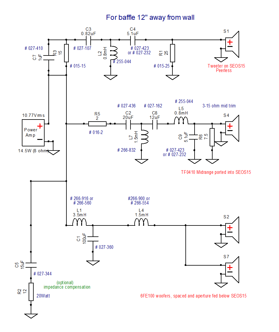

Someone pointed out to me that I never posted the final passive crossover schematic for the SmallSyns, so here it is for anyone who might be considering making these or something like them.
I've got the material for the next build now (the shelf-ported version), but not a chance to go cut it yet or start building. I'm going to put that together before doing the full build blog, since there will probably be some adjustments to the port and maybe the drawings to get it right. Might be schematic changes, too (but I hope not!). I'll document the progress here, as usual, though. Mistakes that get made on the way, too, as usual!
