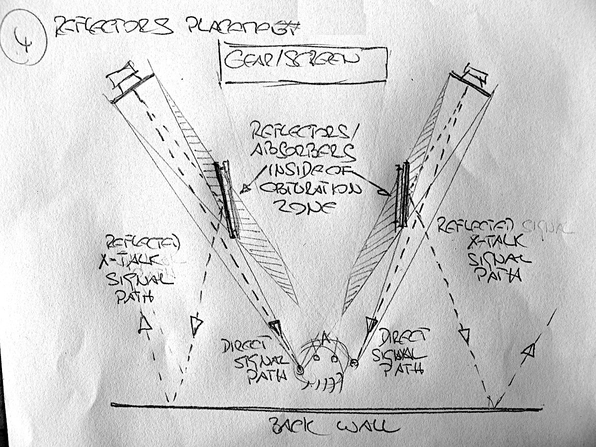

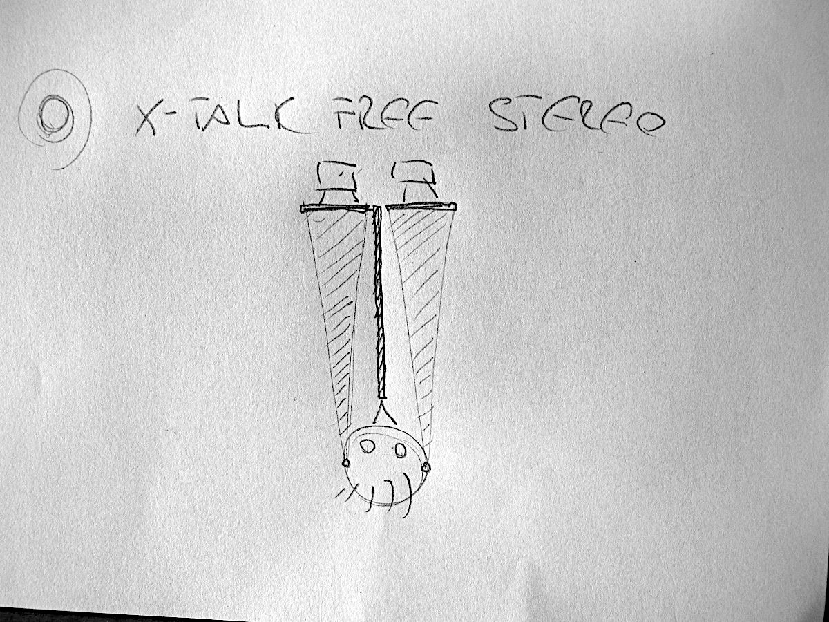

Stereo inter-ear crosstalk minimizing for typical stereo loudpeaker setups - can it work?
A stereo listening experience without inter-ear crosstalk can be quite amazing, and can be archieved quite easily within a really simple, but effective setup. Just grab any board and sandwich/squeeze it between your two speakers. Then, listen with your nose as close as possible to the outer rim of the board. Despite the quite owerwhelming listening experience you get from this one, nobody does want to listen like this for a longer time. Neither did I. I tried this one out with the mounted-away bathroom door. No kidding.

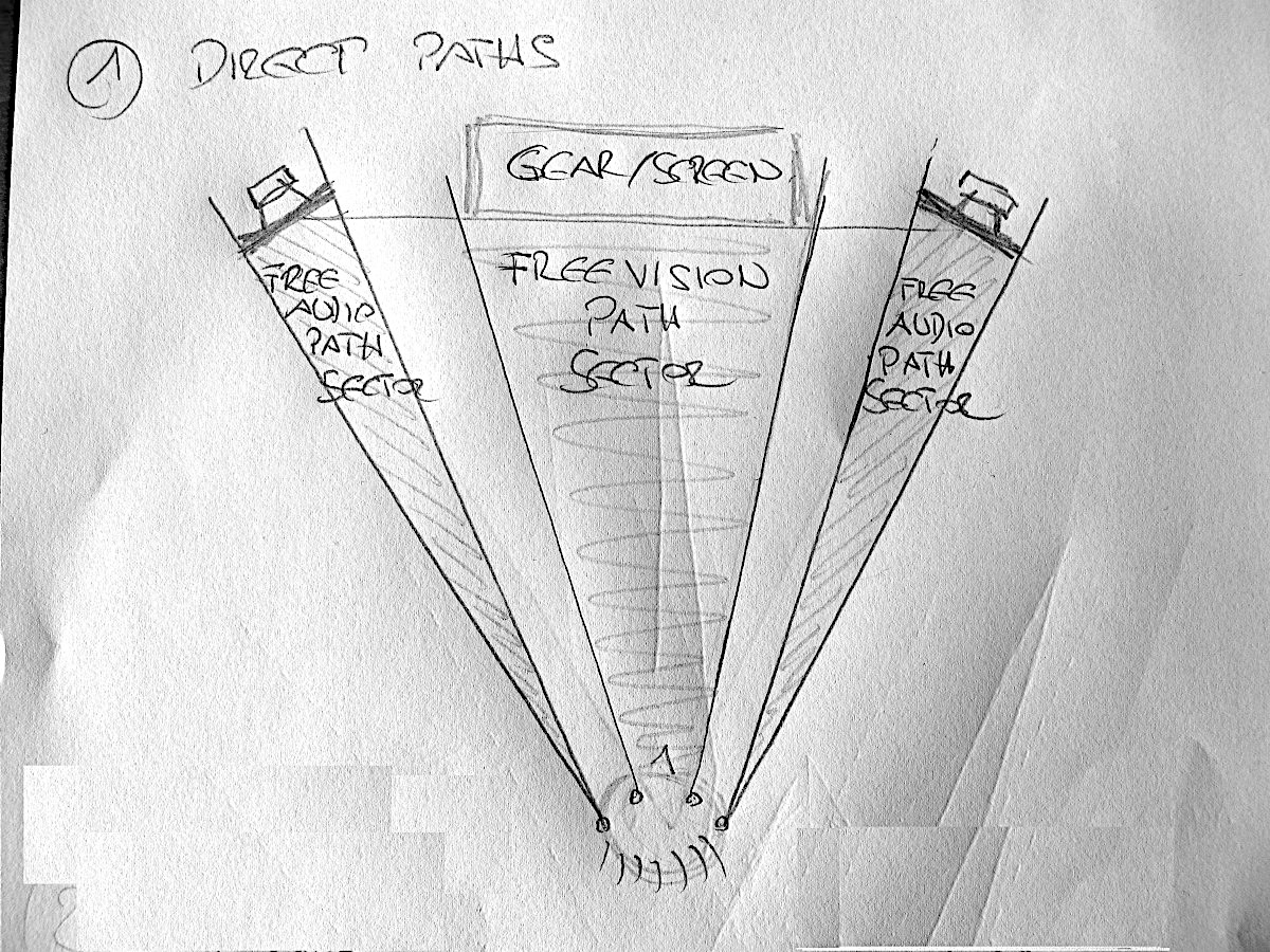

In a more normal stereo setup, typically you need two direct auditive paths/sectors, and for general convenience also one optical path/sector to listen to stereo in a home environment. Especially the audio paths/sectors must not be obstructed by any kind of structures, and also the visual one in case of a central screen.

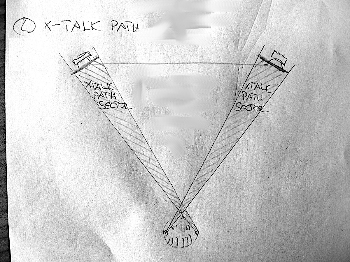

Then, within this setup, there are these nasty xtalk-paths/sectors, inevitably making stereo to become xtereo. In order to theoretically avoid any interaural stereo crosstalk to the contralateral side, the sound energy within these paths/sectors to the contralateral ears should be either completely absorbed, or completely deflected away from the direct path to the contralateral ears. This might be performed by inserting obstructive structures right into these pathways:

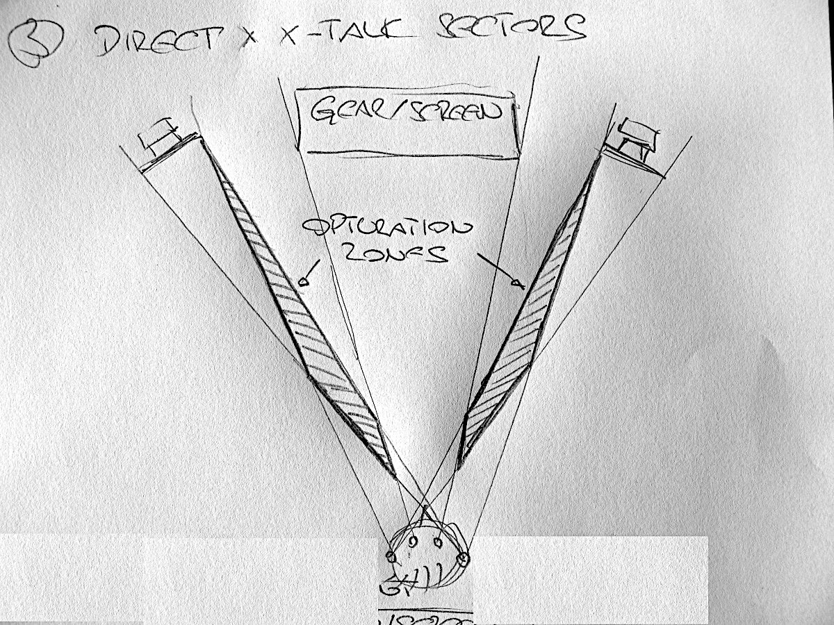

By geometrically intersecting all the necessary and all the unwanted pathways, two aeras (or, more precisely two room volumes) will become evident, where the direct contralateral x-talk-path/sector can be obstructed, without obstructing the direct isolateral audio and optical paths/sectors. And only there you may place absorbing and/or deflecting structures, in order to be effective against xtalk without disturbing stereo. As the dimension/space of this intersection aera/volume is very limited, these structures necessarly will be acoustically small and ineffective at low frequencies. This means, that only higher frequencies will benefit from these anti-xtalk-structures:

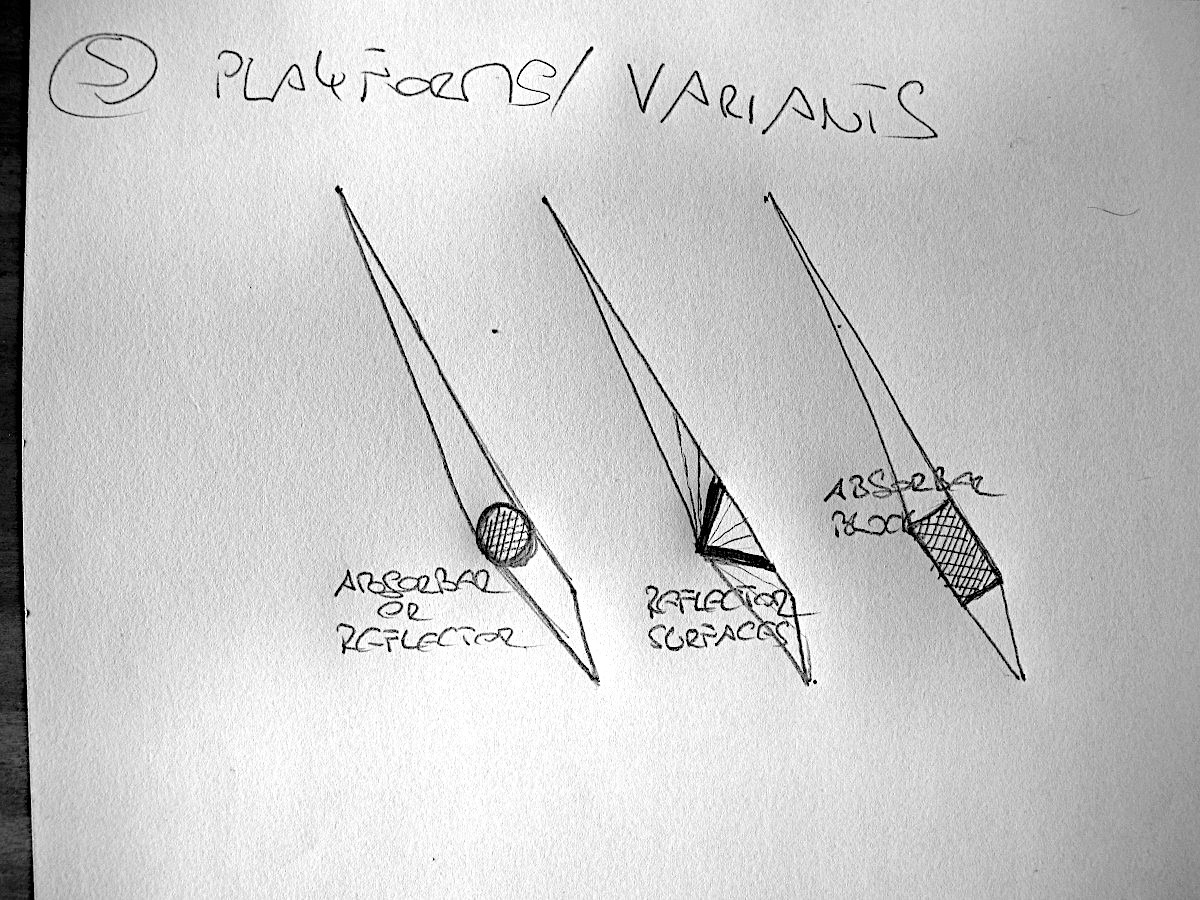

The obstructing anti-xtalk-structures could be e.g. a hard board for deflecting sound away from the straight path to the counterlateral ear, or a woven PET acoustic absorbing board for absorbing sound energy, a combination, or anything else which might be suited. Also the shape of these structures might be quite variable and would have to be empirically optimized within a trial-and-error cycling process:
To define the the sectors in the above graphs, I arbitrarly chose to define them by the horizontal boundaries of the speaker baffle. And as said, because of the limited possible size of the x-path obstructing structures, only a frequency-dependent and partial x-talk minimizing effect will be archieved by this kind of setup. The higher the frequency, the more effective it might act against acoustical x-talk. And also, this is a first draft without proof of concept: I did not yet set up any experiments with this one for my own yet. I think an optimizing process should begin with a clean stereo geometry variant especially adapted in order to make the obstructable aera as big as possible. To allow for acoustically relevant obstructors.
If anybody already has own data about this approach, I would greatly appreciate to hear from these real-world-findings.

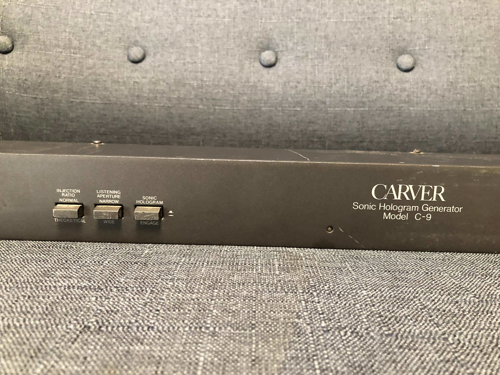

Carver did a lot of work on this. Check out his sonic holography stuff. There are speakers that use properly spaced opposite channel out of phase drivers in each speaker to create binaural sound without headphones. The left ear only hears the left channel etc.. The drivers are a heads width apart and out of phase cancels the other channel to the ear. It only works over a limited sweet spot. Some love it, some hate it, some get sick from the sound messing with their brain!

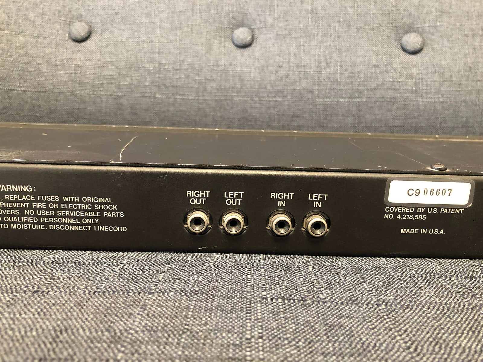

Matthew Polk believed that using actual signals from the speakers to cancel out crosstalk was the way to go. He brought his ideas to life in his SDA speaker series.
Another approach came from Bob Carver, who believed that an IC could be programmed to eliminate crosstalk through signal alteration.
Carver Sonic Hologram Generator Model C-9.

Back wall FAIL. Do whatever you have to do to avoid being up against the back wall....
And NO, don't add extra vanes, reflectors, baffles, or whatever.
I read in early 90's someone did this with a mattress to block out the crosstalk, but I can't remember the conclusion.
I say point the speakers differently, obsess over the L-R symmetry of first reflection points, and enjoy the stereo. They worked all this stuff out back in the 40's...

OK, then. So let's go on here. And I will refer to your thread as the FTSPC thread (FTSPC will stand for Fixing the stereo phantom center) whenever it is appropirate to do so.
Thank you for all these pictures sent, which are some kind of proof of concept. Except that this approach here would place the obturator gear into the room, and not necessarily onto the listener's head.
In the FTSPC thread there is a discussion about the tonal changes caused by notching in the frequency response because of the inter-aural delays between the ipsilateral and the contralateral signals. And in the context of this FTSPC thread, how to best cope with these artefacts.
Instead, here exactly this notching will be very welcomed. Welcomed, because of every notch is a sensible indicator while tweaking for the best compromise for these acoustic obturator devices inside the obturation zone: You simply may make a simultaneous L+R (mono signal) measurement at the room location of one ear of you listening position, and then shift the obturator of the contralateral signal path around. If there were any effect, then these notches would become less deep. The placement at which the notches are the shallowest would then be the best compromise location for the chosen obturator.
I am really looking forward to get two 500Hz ... 5kHz horn drivers in arrival, to set up a bare-bone prototype xtereo-to-stereo measurement environment. We will see ...

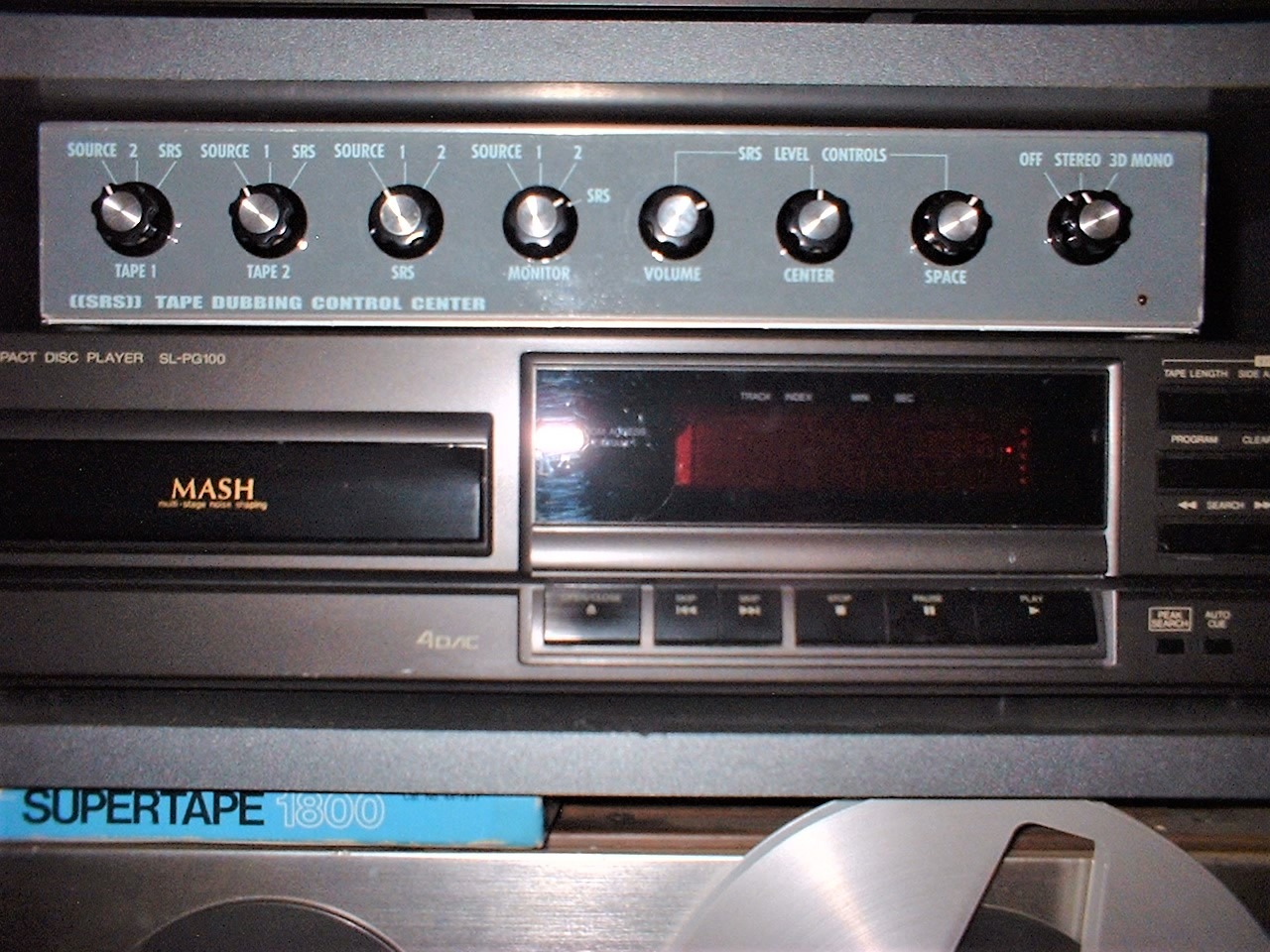

If I want to "play around" with the recorded stereo image, I use my SRS (Sound Retrieval System) which gives enhancement to the sound.
It makes the speakers dissapear, can widen and vary the stereo image, and give increasing concert-hall depth to the music and vocals.
CD's or tapes recorded with it can make a tabletop boombox sound like its 6 feet wide, you can imagine the effects in a car too.
