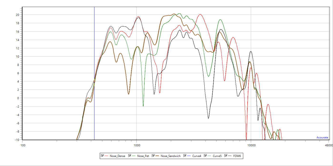

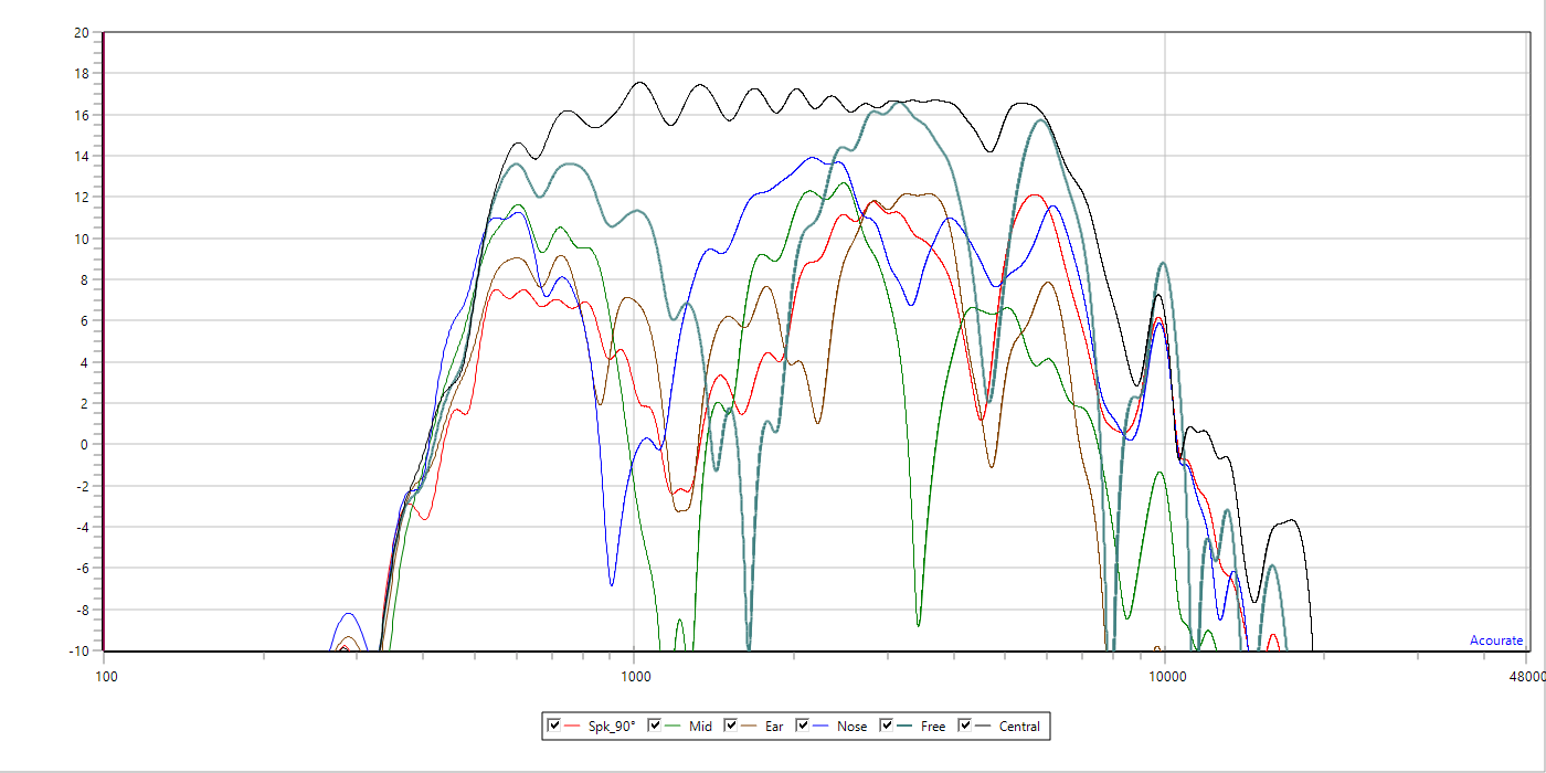

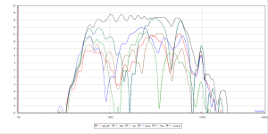

It works !!! Finally !!!
After numerous (!) attempts I finally managed to cancel xtalk in a specific test setup to the extent that there was a max. 2dB deviation compared to switching the x-channel completely off. This for the good news. The bad news is that this very specific setup contained a vertikal, central tube of 50cm diameter, placed 35cm ahead of the microphone line. This quite huge tube then shaded the lower frequencies of the x-channel, which otherwise would be causing the first low-frequency notch. Then there was further up another notch, which could be flattended out by a 100% absorbtive, centrally (sagittally) placed wall between the microphone line and the tube. In german there is the saying "ein Brett vor dem Kopf haben". Which discribes a situation when you lack some clear view regarding the things around you happening ... I would say this wonderfully effective setup in terms of XTC also comes along with something like that "Brett", but more precisely as a "Röhre" instead. Anyone resorting to such a setup at home therefore inevitably might end having a "Röhre vor dem Kopf" altogether ...
Unfortunately, all other, domestically more tolerable setups were not very efficient in terms of wide-band XTC. My cherished playforms in the obturations zones of my initial drawings are all acoustically way too small to be effective. So, no acceptable XTC within an usual stereo setup. I am sorry for this regretful insight.
Let's look a bit into this iterative fun I had:

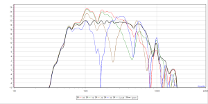

First, the effect of shifting the microphone to one side. Black is the fully symmetric placement, the mic is supposed to be placed at the mid of the head's location, the stereo sweetspot. Then the shift to the right side is performed by n samples delay between right and left channels arrival time.
All further setups for XTC then were tested at a sample shift of 30 samples for the arrival times between L and R, corresponding to a lateral shift of some 11cm. So the blue line would more or less show the notching for a human head. First, three examples of shading, absorbing and deflecting by different means at different locations ...
How does that measure?

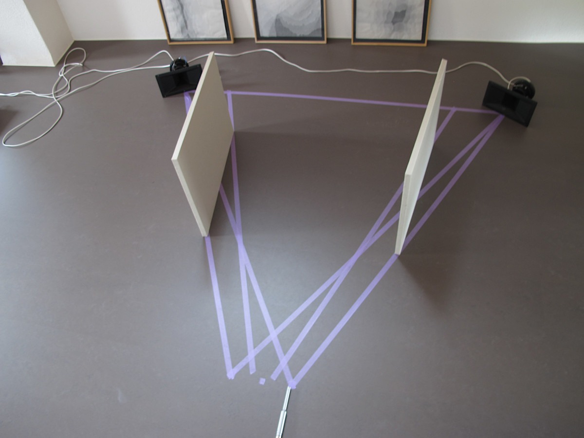

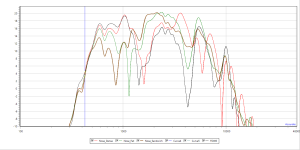

First for vertical plates at different locations, more or less paced in a 90° ange related to the stereo base:
And then the outcome of different boards of more or less the same size, all used at the same location, e.g. in the plane of the nose placement:
Deep notches everywhere, as signs of x-talk notching. So no real XTC effects along while using more or less acceptable structures. And then, in sheer despair, the final monster-tube-game-changer iteration(s):

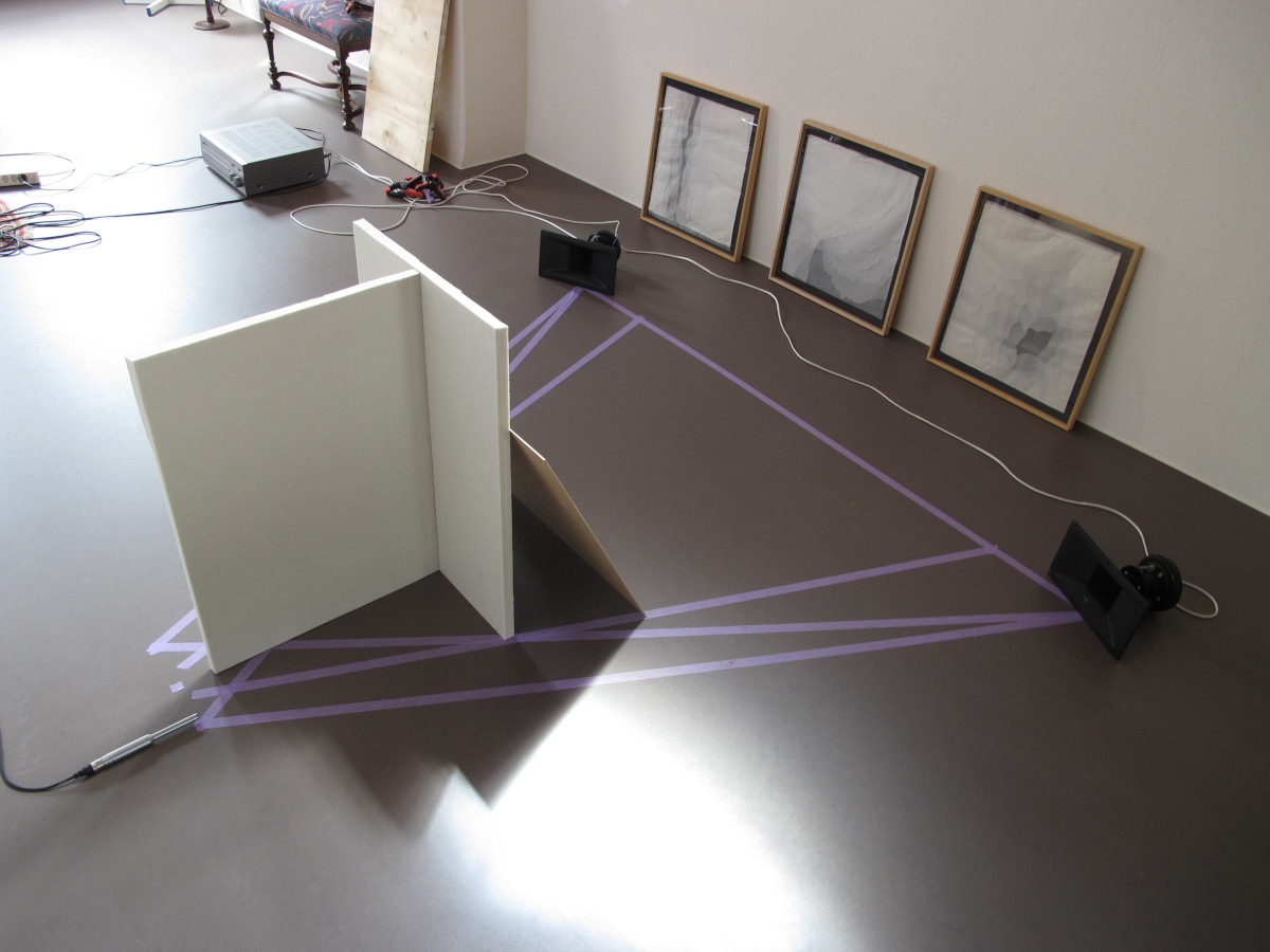

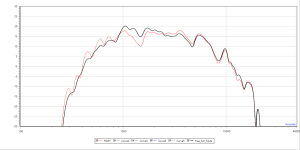

Black graph is no structures at all between mic and the stereo base, mic. offset by 30 samples. In order to simulate a no-x-talk situation the x-channel is muted.

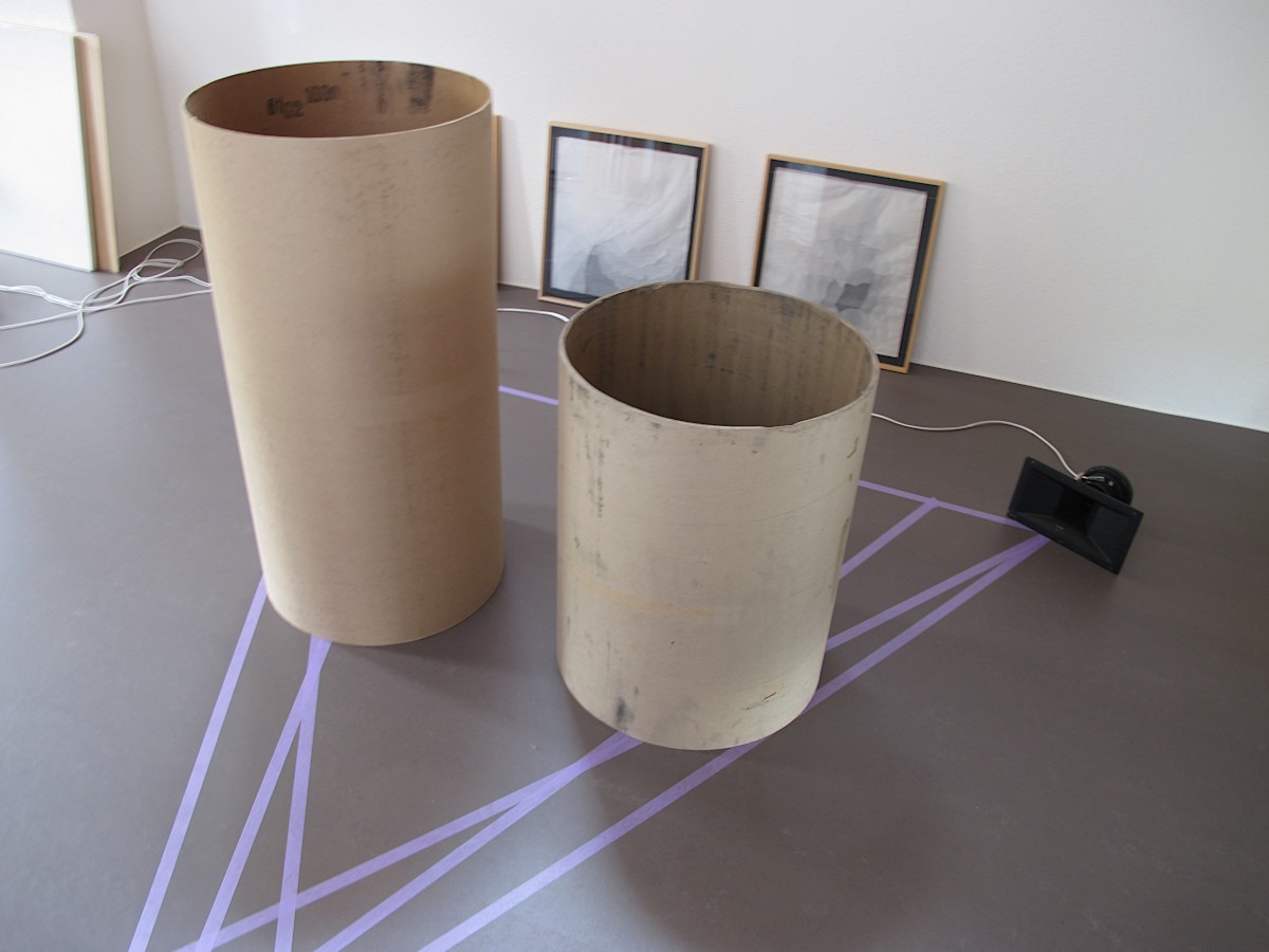

Red graph is x-channel on, a tube at 33cm from the mic/ear baseline, and an additional sagittal absorber in the central plane.
Really and finally, a nice cancelling of the x-talk. No x-talk related notches means that there is nearly no x-talk. There were even some better variants, but which have not been documented. Best one, as mentionned before, was a 2dB match between black and red.
Did I hear someone say Big Is Beautiful?
