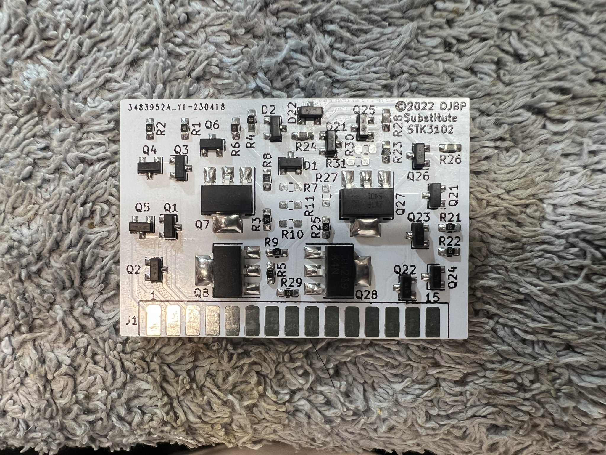

What are your supply voltages. The chains of 18k resistors have almost the entire V+ to V- across them
Without measuring them, the schematic says they’re +/- 79 volts.
Here is the first completed board minus the missing 6 18k resistors.

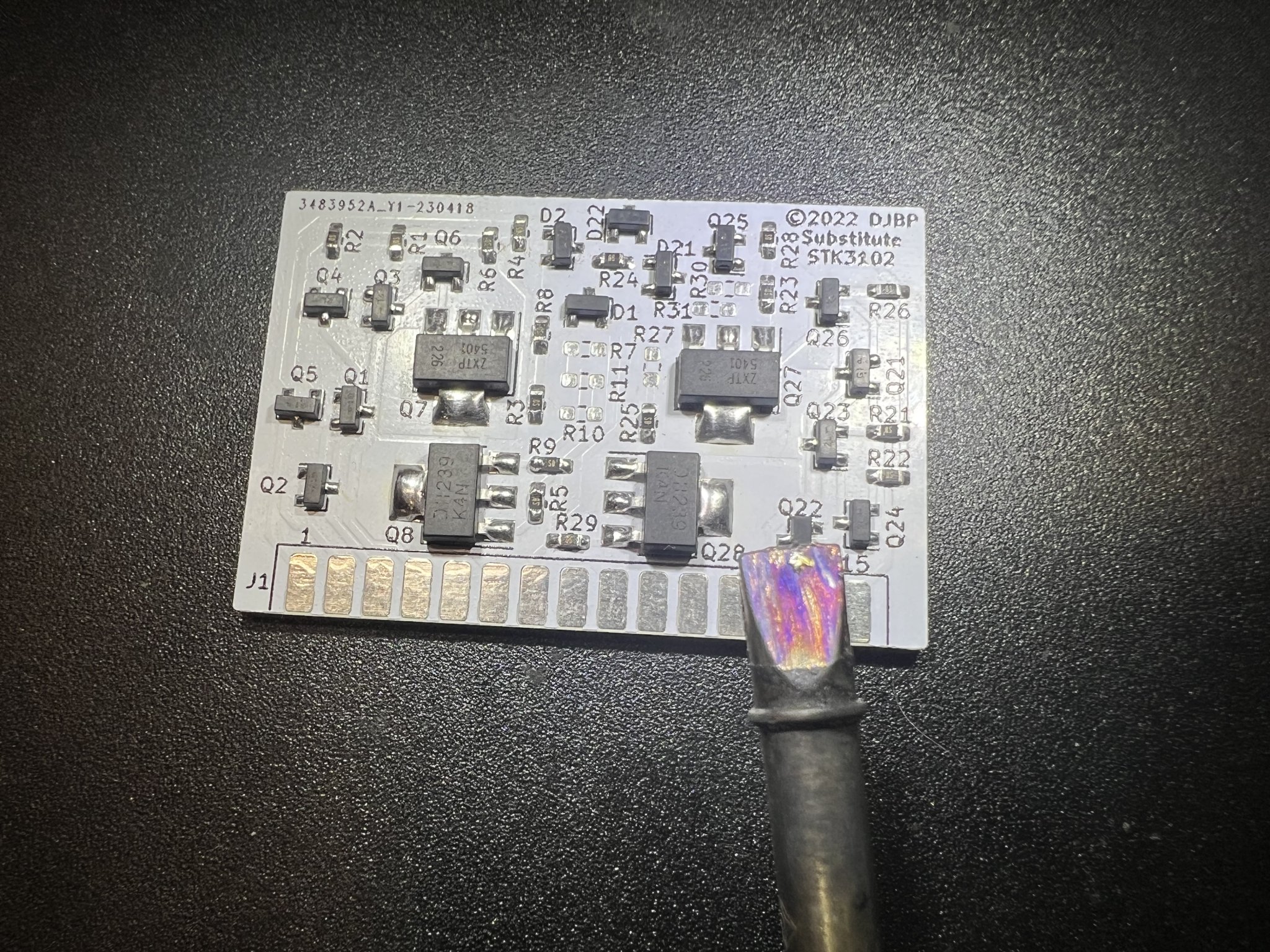

Even with the thick aluminum backing the devices were all easily soldered to the board with the exception of the four larger transistors. I was able to solder the three smaller legs with my regular tip no problem, but when it came to the larger pad the heat sank into that aluminum lol. I had to take out one of the bigger wedge tips. This one has a blue marker, so I want to say it’s an 840 Fahrenheit tip.

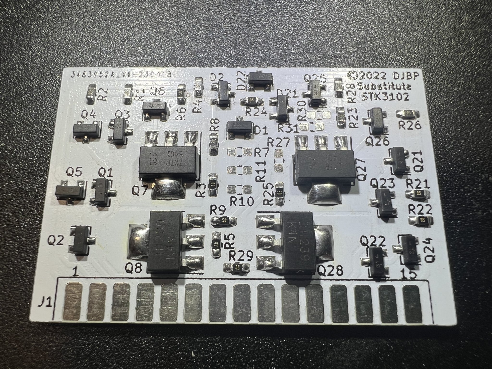

Soldered the large tabs no problem, the solder wetted to the pads in about 1 second. One more from directly above.

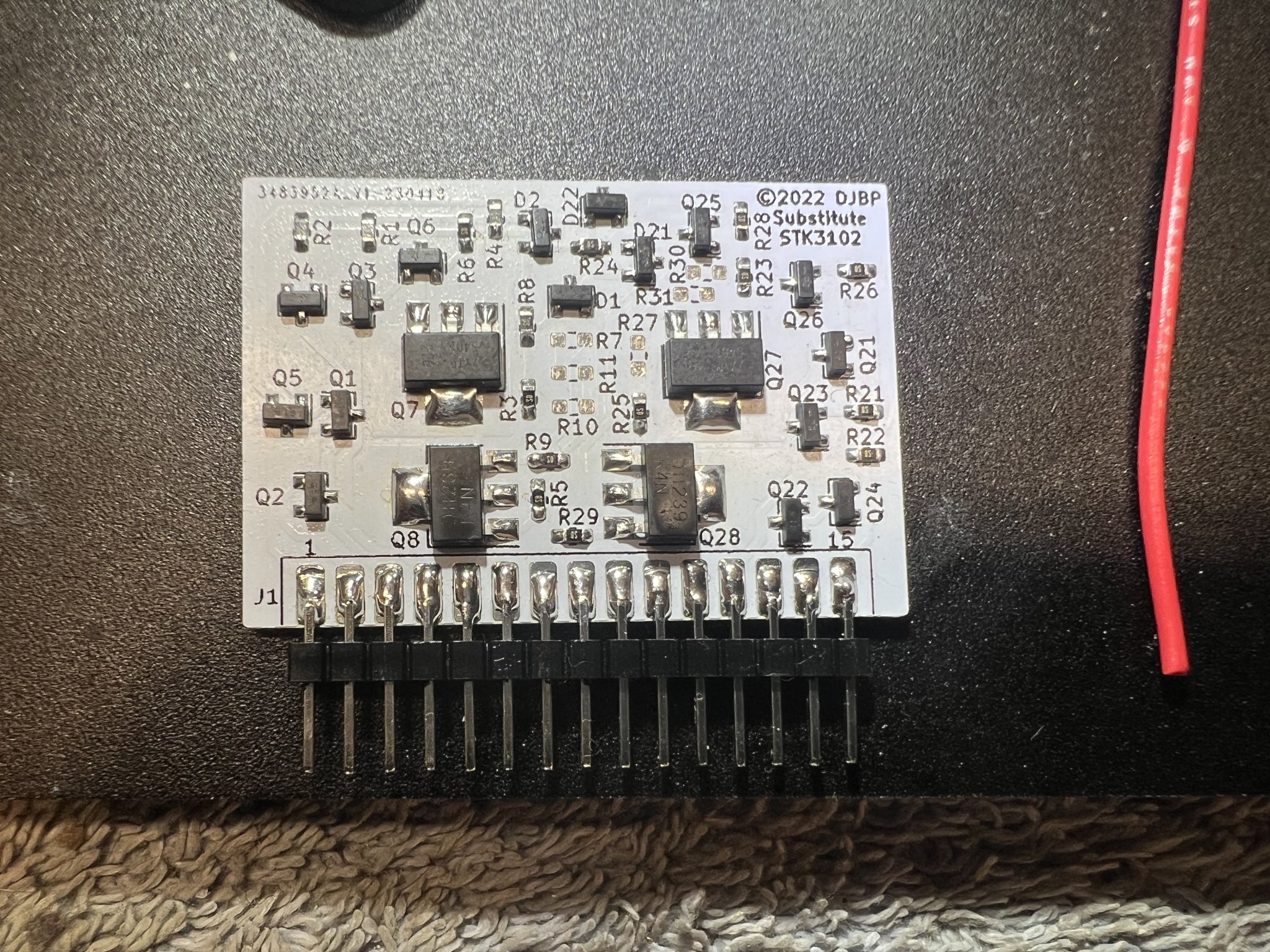

And still have to do the pins of course.

I see that the standard 0603 resistor is generally rated for 1/16 of a watt, the ones I picked out say 300 mW. Since I didn’t see anything specified I’m guessing that the 1/16 watt are okay. Figuring that there is less than 158v across the resistor chain and all of the through hole resistors I use are rated at 250v for the 1/4w I’m thinking one resistor would work. If it would be better to use a pair of 1/4w 27kohm resistors to hit the 54k exactly (as it was in the original BOM) then I could do that as well.
Dan
Due to the high supply voltage, I would go up in value slightly, if anything. You are running at 460mW, so a 56k or 68k 1/2W would work
Okay great, thank you. I powered the amp up on a measured the voltages at pins 7 and 9 and they were pretty close at +/- 76 volts. I went ahead and just bought some 0603 resistors so that it could look correct. I didn’t like the way it looked with resistors hanging off of it, plus if I want to mount a heatsink from the front of the board those resistors would make it pretty much impossible.
Is there an 0603 that you recommend? I saw that they are generally rated at 1/16 watt, the ones I bought are rated 1/10 watt or 100 mW, I couldn’t find any of the 300mW I originally bought in the right value. So if you say that I’m running at 460mW then this string of 3 isn’t going to cut it correct? Is this made to run on lower rail voltages? I’m guessing no. I know the wattage rating of resistors can get different sometimes, surprised when I bought some 1/2w through hole and when I got them they were physically smaller than some 1/8w through hole I had. Not sure how something so tiny could dissipate 1/2w. Should I be okay with these 1/10w resistors? Do you recommend another value still? Like maybe three 20 kohm or 22 kohm instead of the 18?

The current in the longtailed pair is about 2mA, the output drivers about 6mA. This should be OK up to 70V rails, with appropriate driver transistors.
The current through what was identified as a 51k resistor, setting the current through the bias diodes, is proportional to the supply voltage.
This means that at higher supply voltages, more like 100k is suitable. This would be 3 x 33k resistors in my version.
This brings the dissipation in these under control at 75 mW each.
