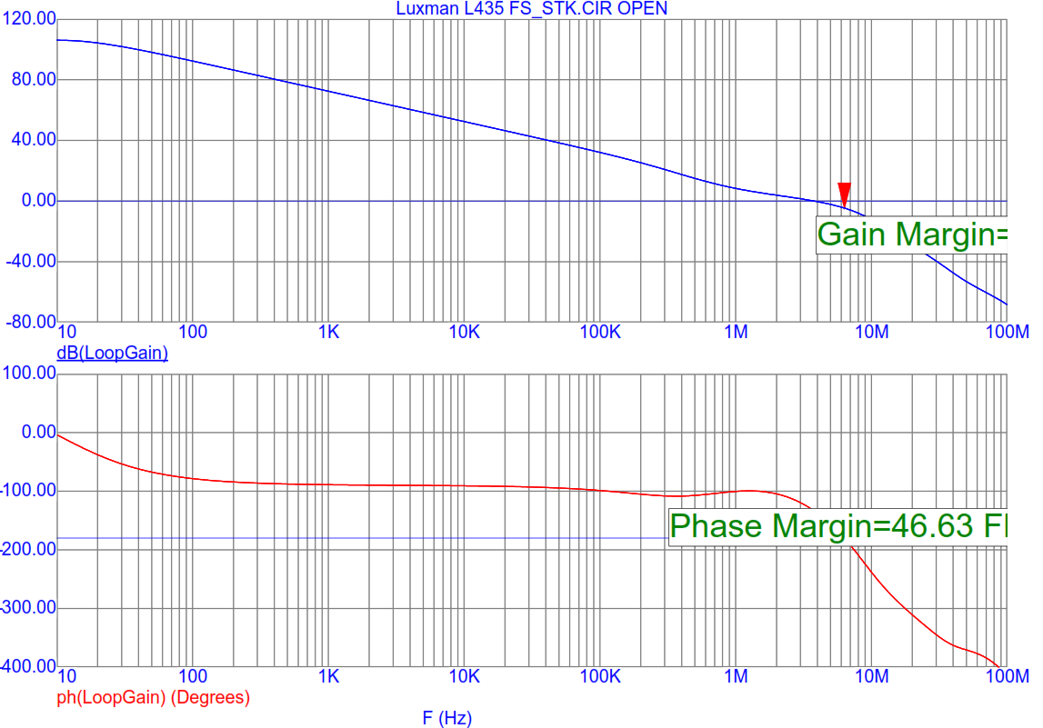

Please explain, better even graphically, what rsavas writes about CRD, LTP, the purpose of the 56k (18k x3) resistor and how it is calculated or selected? How can you improve the stability of amplifiers based on STK3102 mark3, so as not to burn out expensive transistors in the future?

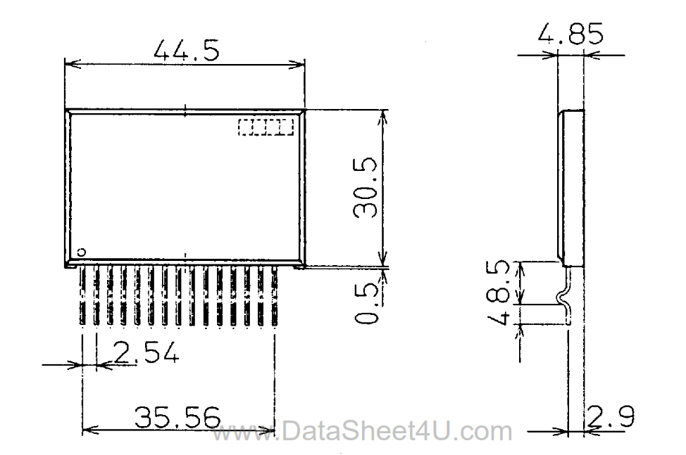

What I do need is more info on the dimensions of the modules, their heatsinking, mounting and space around them.

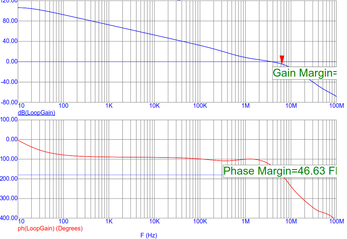

about stability on pahase normal, but on amplitude only 4,6 dB
These resistors will only reduce the loop gain as I understand it!
