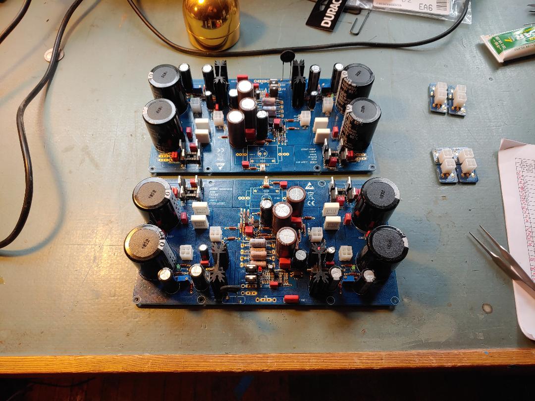

Just finished assembly of my boards.
Quick question,
There is an extra hole next to the connector to the bjt flying leads. What is this hole for?
A few notes to other builders.
I used the BOM/loading guide that I assembled and uploaded. See the very first post in this thread for a link to the BOM. The only error in that BOM is it is missing a 10k resistor (R227). This is a current dropping resistor for the power supply LED, so hopefully you already have some of those laying around. Nothing special needed.
Huge thanks for the folks that assembled the first BOM's and did the error checking. Parts selection is an unpleasant enterprise and very time consuming. All I did was double check everything, create a map for where everything goes, and replace a few connectors/terminals.
This is not a newbie project, since it does require some skill with a soldering iron.
The board is very well laid out, and there is plenty of room to maneuver on the back side. There are a great deal of large copper pours which can make it difficult to wet the entire pad and not fry the part at the same time. I have a $48.00 Hakko 862 clone whose tips do not make good contact with the heating element, so the tip is slow to respond when a copper pour sucks all the heat out. So some experience is needed with dealing with this sort of thing. Don't be afraid to turn the heat up to 400, just get the tip in and out quickly. With a low watt iron at a lower heat setting, it can take too long to heat the pad, and you end up with fried parts.
The good news is that there are a ton of resistors to practice on, and let you get the feel for how the board solders before you move onto the caps.
The board also de-solders nicely, so if you accidentally put and R where a C goes (don't ask), you don't have to fuss over de-soldering.
I also suggest being really conscience about installing the parts in order of the their height. Some of the parts will be very difficult to place when surrounded by towering caps.
Don't forget a blob of silicone under the bigger caps.

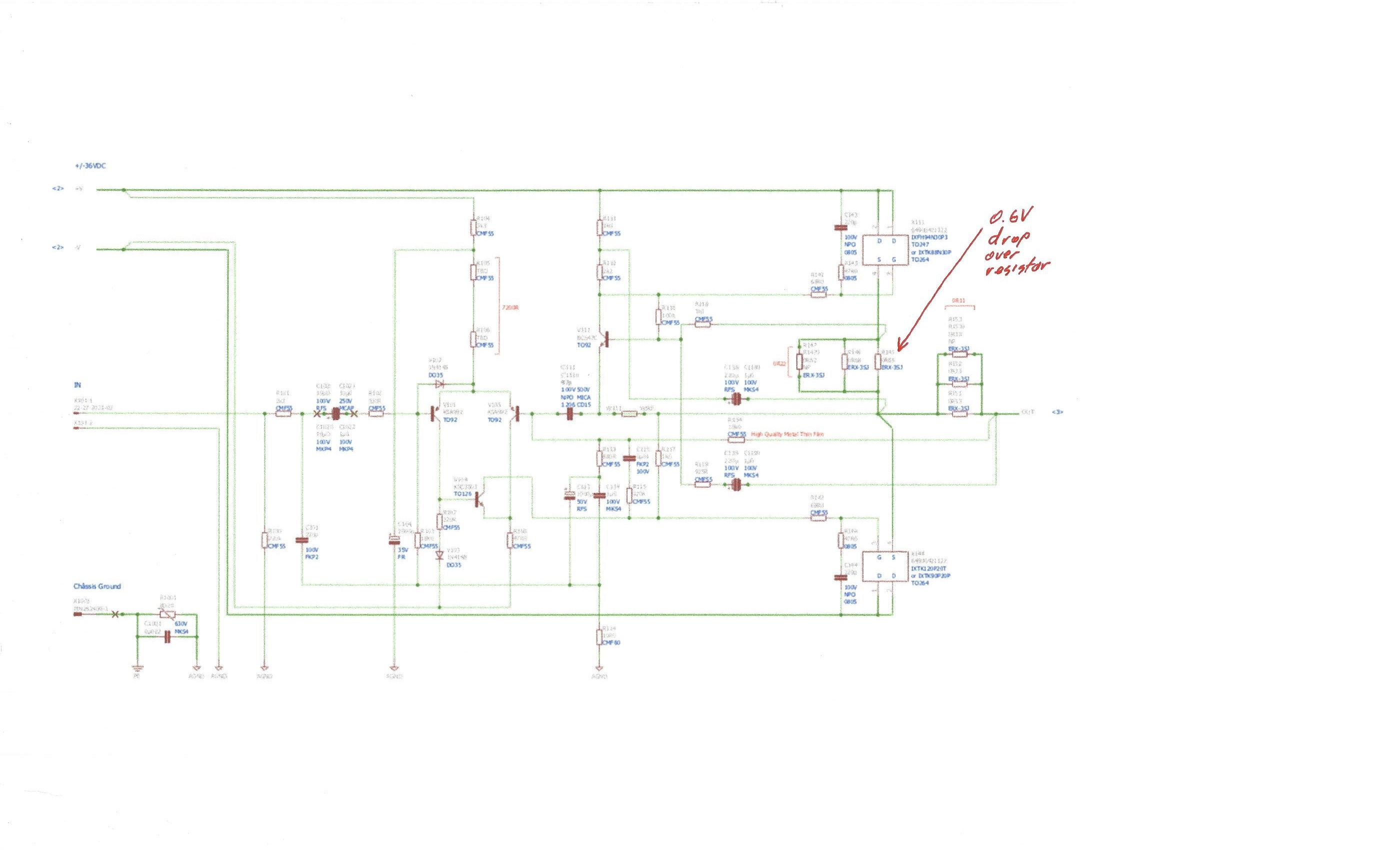

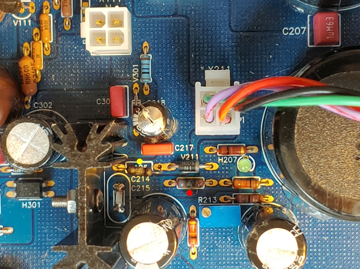

Hi folks, I got one of my amps fired up and running, then I let some of the magic smoke out after I moved it. I had let it run for a good 2 minutes or so on my bench to make sure it would not catch fire or otherwise mis-behave, then I moved it to my computer so I could monitor the temps.
Not sure if the PNP grounded against something, or the 10ohm R126 resistor melted. I had to use one from my emergency stash (story not worth telling) - they are 1/2amp rated, but they are also Ebay specials...
Either way, the PNP lit up, R126 and R214 are smoked, and C218 swelled up.
Before I moved it, I did take a couple of voltage readings.
Voltage drop over R145 (the source resistors) was about 0.6V
Voltage rails measured ~+/-41V

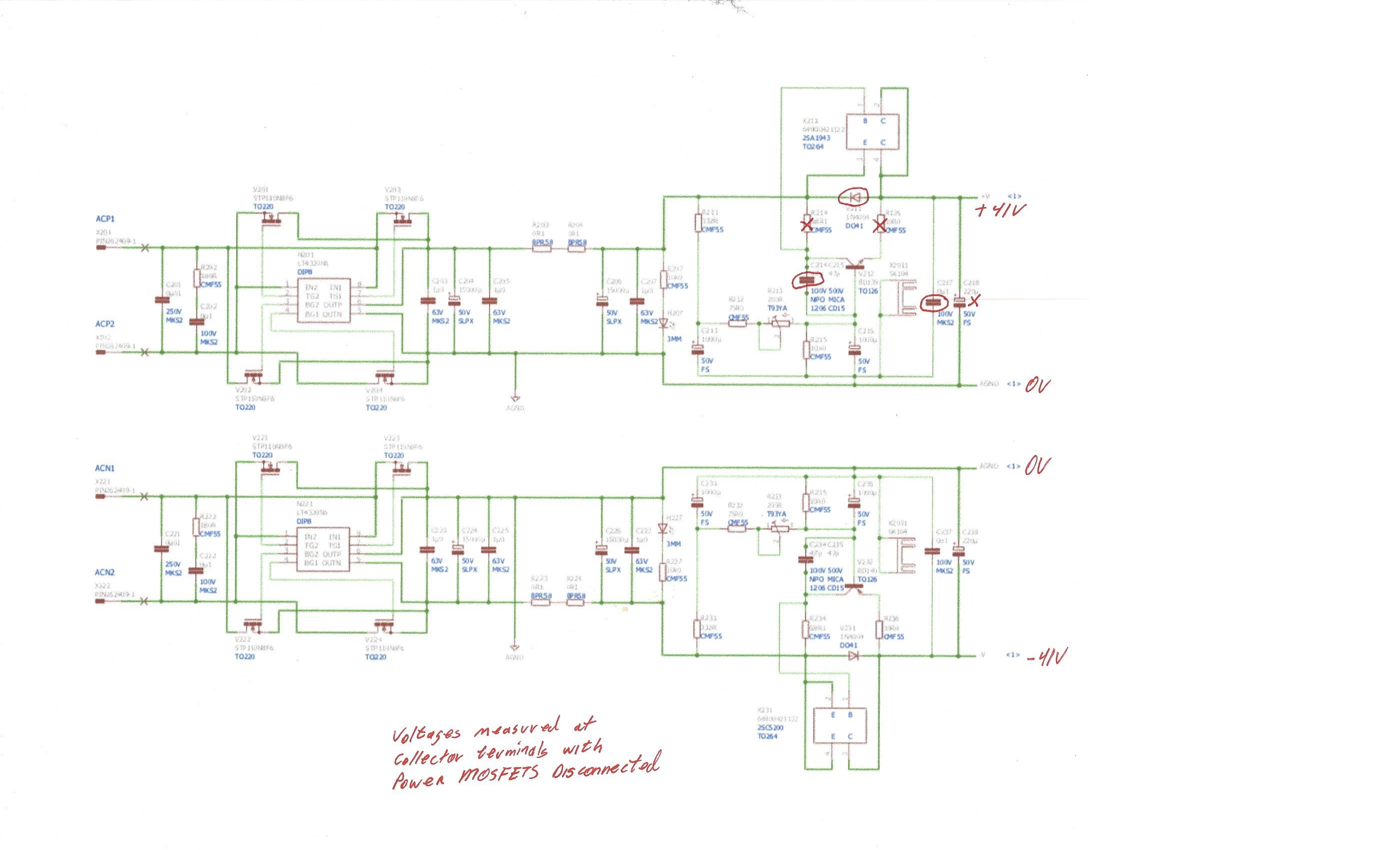

It’s been a while since I have looked at this amp. Can you please markup the schematics with the parts that burned out and indicate the voltages you measured before it blew up.
Hi X, thanks for the quick reply.
Here you go
I marked an X on the 3 parts that are visibly damaged.
I circled the parts I believe should be replaced for good measure.
Thanks again,
-Josh

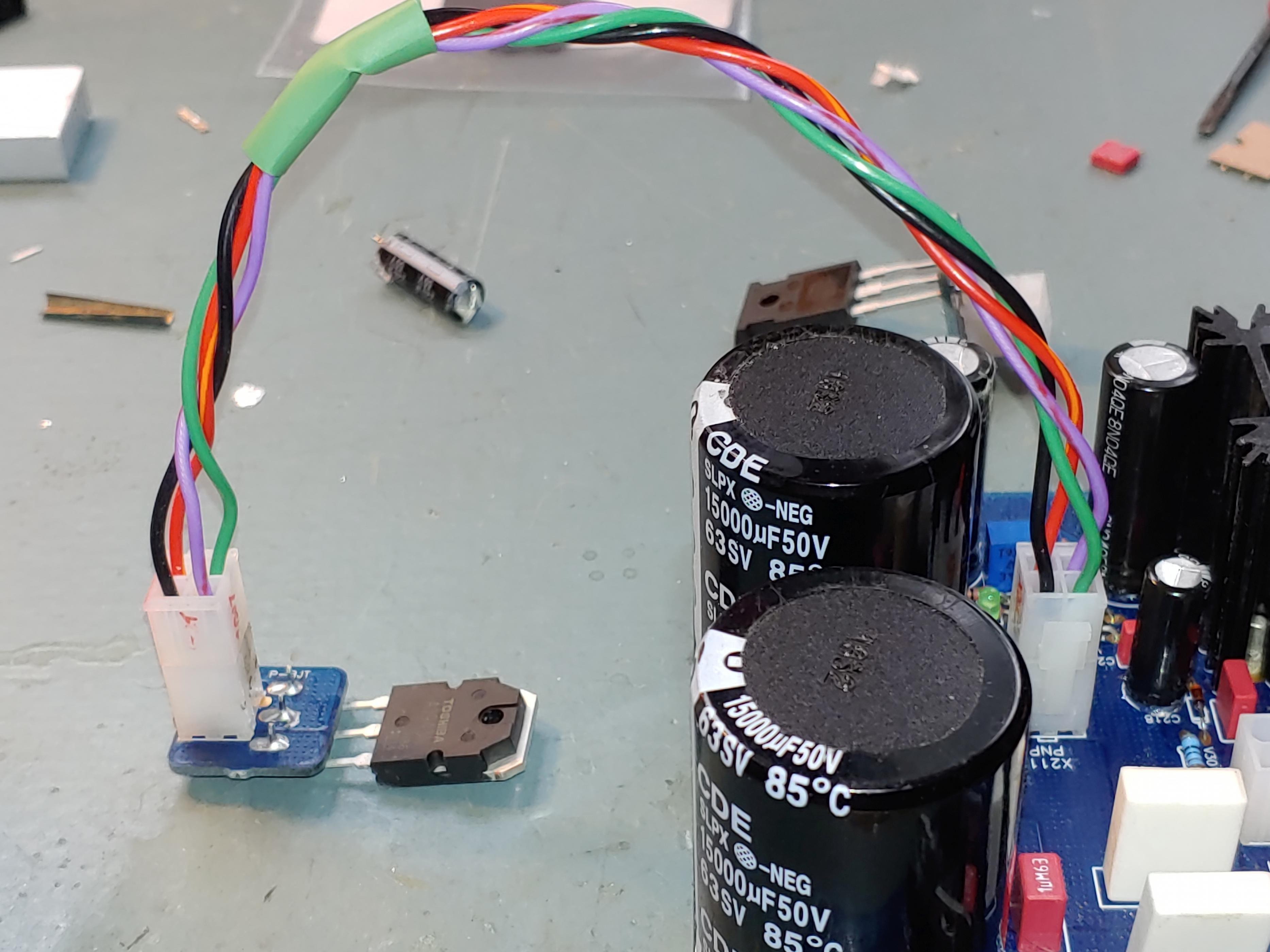

Hi all, sorry for the delay. Work has kept me busy this week.
I ordered replacements for what I knew was blown, and what was available for the rest.
To address a few comments/questions first:
The BJT was isolated from the heat sink, and the whole mess is screwed to some MDF.
Reverse polarity is unlikely since it ran for a couple minutes. Either the Chinese 10 ohm resistor I put in the board blew, or I left something on the desk that shorted the BLT legs.
I checked, rechecked, then checked and rechecked again. It was a couple of weeks between making the connectors and powering it up, and I checked and rechecked again at that time. I checked alot 🙂

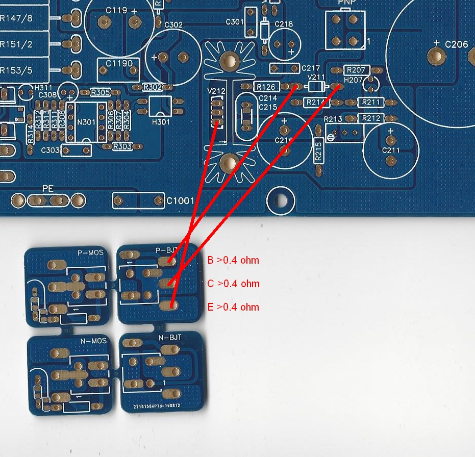

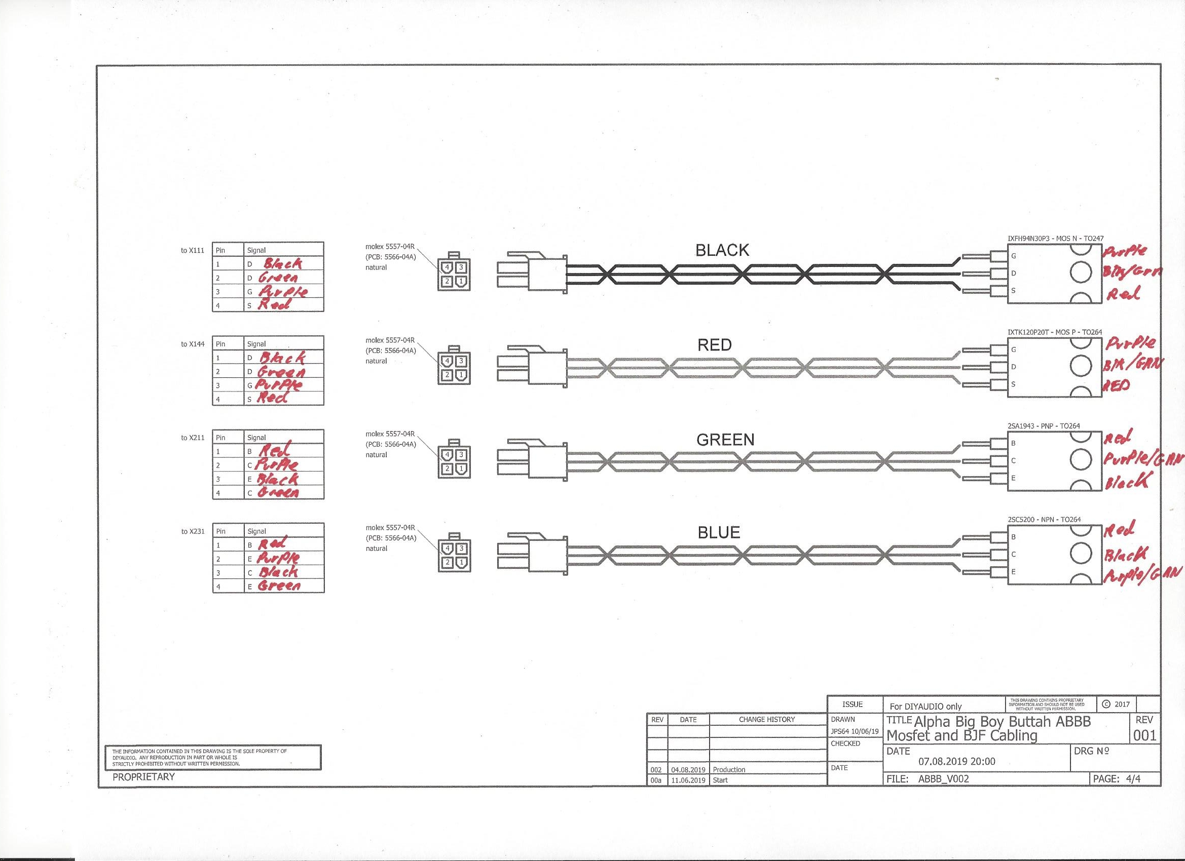

Attached is a pic of board. I drew lines connecting the BJT legs to the pads on the board where I measured. All resistances where under .4 ohm before it blew, and are all under .4 ohm after parts replacement.
Attached is a pic of the amp before replacing the parts. I put a red dot next to the Chinese resistor (10ohm) that blew. I put a yellow dot next to the 68ohm Vishay resistor that also appeared blown.
Attached is a pic of the connector diagram showing the wires, and a pic of the wires themselves.

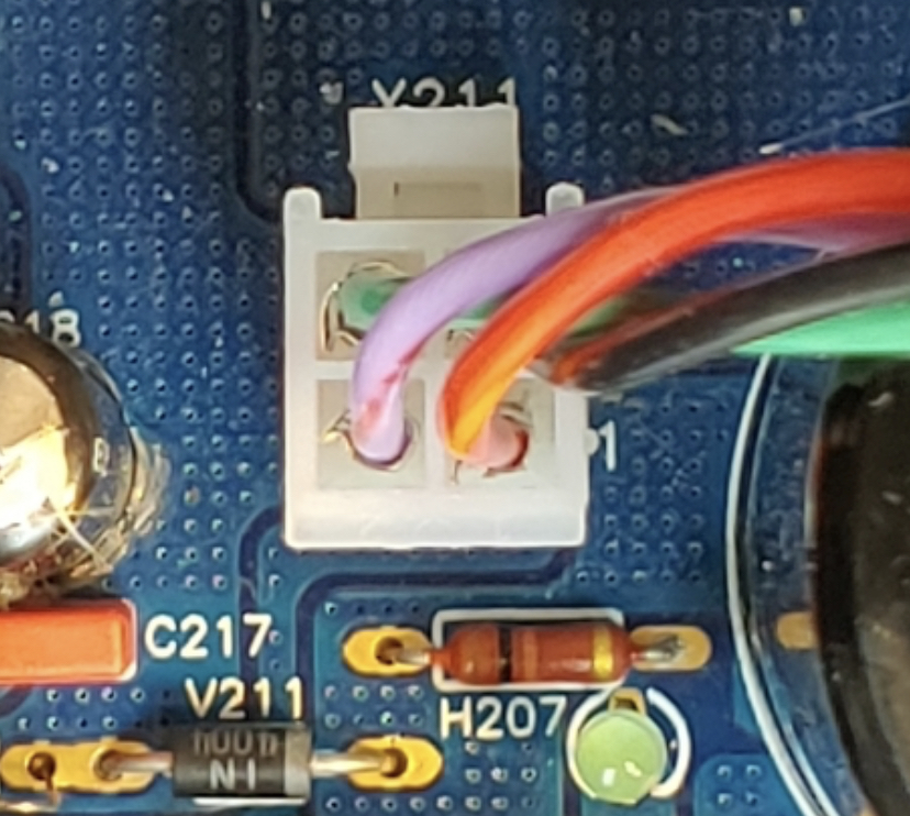

Hi Josh,
The resistors you show as burning out fail when the connection between the PCB and cap Mx BJT goes open circuit. The fact that it was working at one point shows that it was correctly built. The only thing I can see is that in moving it, one of your connections was loose or became loose, and on power up - all the Class A current (3A of it) passes through the little resistors because of lack of path to pass through the BJT collector/emitter path.
Please check your Molex Minifit connectors. Did you crimp the wires properly with a real crimp tool or maybe improvised with needle nose pliers?
attachment.php
Your photo closeup shows pins that don’t look properly crimped. I see wings of the connector that are not tightly crimped around the wire. It should look tight and cylindrical. You may need to invest in a set of crimper pliers.
A good crimp connector looks like this:
