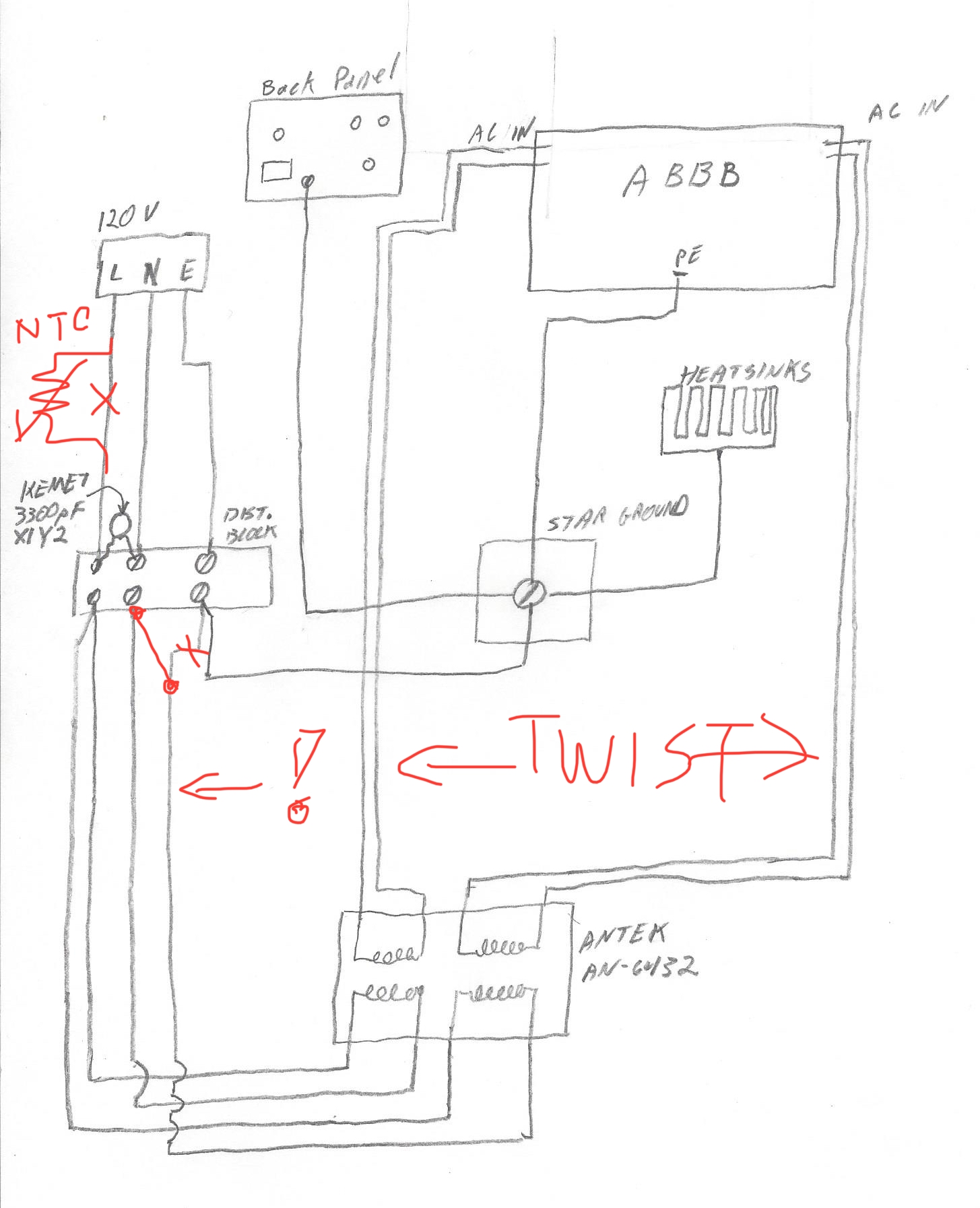

Hi Josh,
Your diagram shows one of the primaries connected to earth ground. I assume that’s a typo. You should add an NTC (CL60 or 8D-20) in series with the line from the wall plug to the primaries. That will serve to be soft start and help reduce hum. Also, don’t twist the earth ground with the mains L and N lines. They will induce hum into the ground line.
Here is my sketch. I think you are already twisting the AC secondary wires?

Thanks for the really fast answer.
Your are correct :(
Yes, you are correct again :)
I went ahead and unwound the earth from the mains, and added a CL-60 along the load line.
Sadly, it didn't help.
My mains power is pretty decent, so I am not too surprised. Winding the earth didn't affect my M2x, but I also use a mains filter on that and good wire. So who knows really...

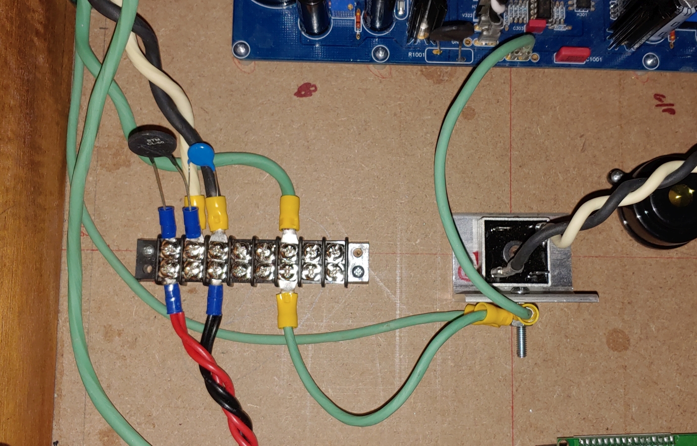

Attached is a pic of the new set up.
Once again, I can't thank you enough for your help.
It is greatly appreciated.
Thanks,
-Josh

You get no hum when playing from say your phone right? But hum when connected to the DAC that’s connected to the mains. This is a common problem. You may have a ground loop from your source - the shield wire on your RCA cable is the ground loop. Can you add to the diagram how the DAC/source is grounded and what it’s power supply is?
What is that diode bridge doing there with thick black and white wire?

The diode bridge is for the 12V supply to the fan controller.

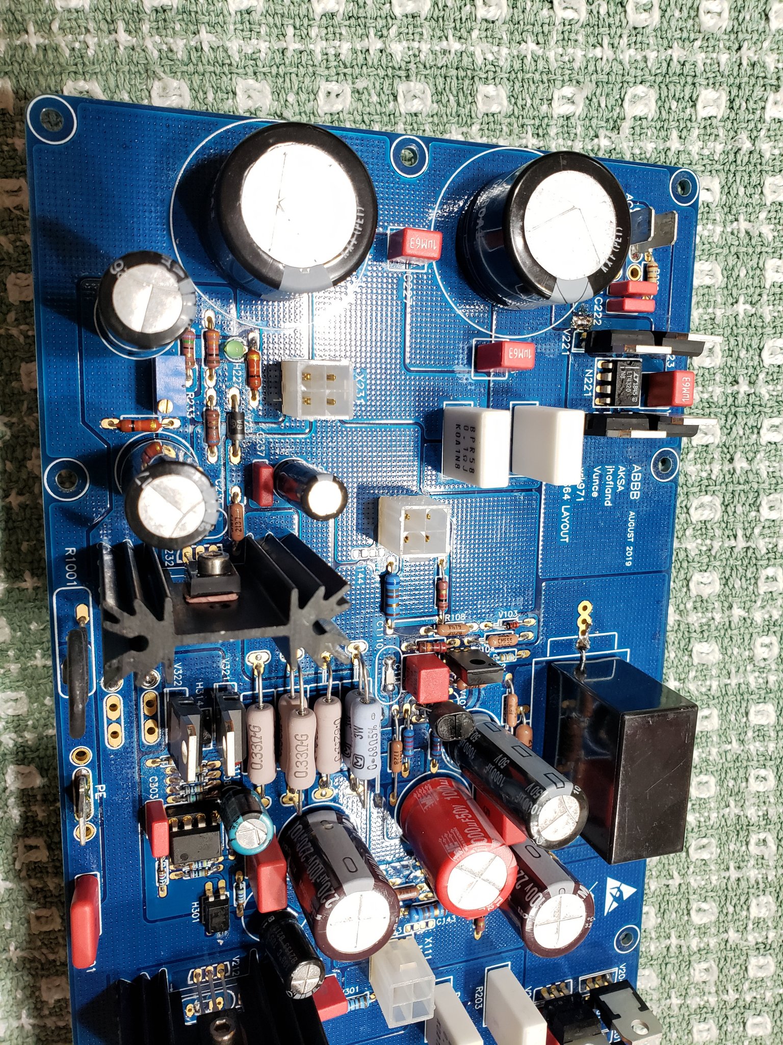

Hi All,

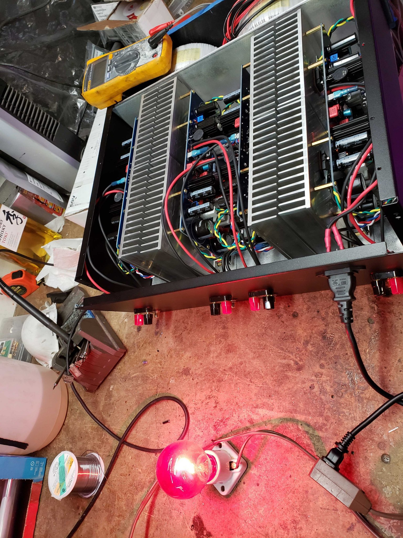

Whelp Id tried to be as thorough and careful as possible in my assembly of a 4 channel amp with these modules but after bench testing with a water cooling setup that I'd abandoned and moving towards a passive/active air cooled setup id managed to cross my bjt and mosfet connections and managed to cause some destruction when I went from my 100watt to 300watt light bulb for power testing.
Id assembled the modules upside down, I think, and crossed the following,
x231 with x111
x144 with x211

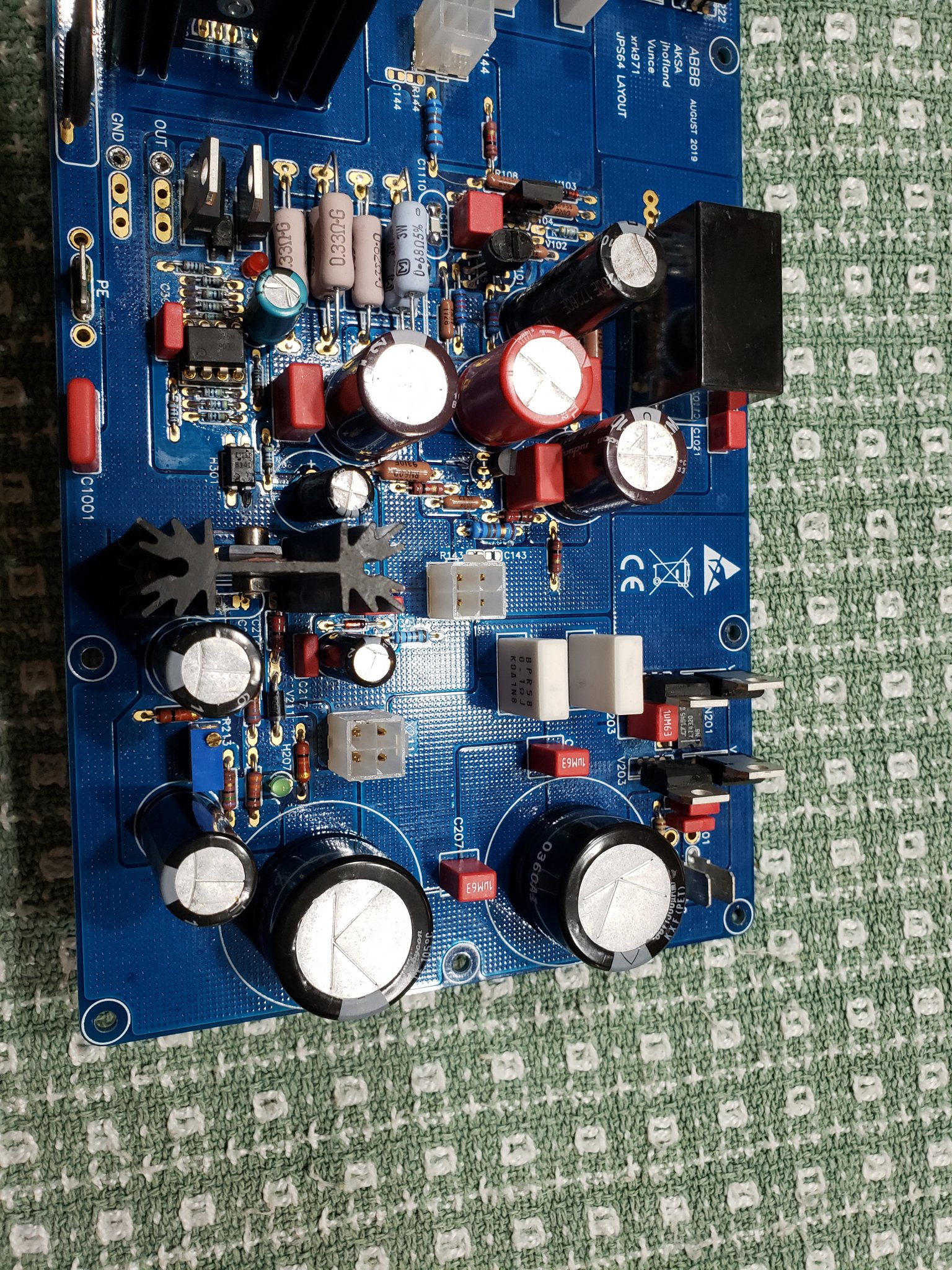

On two boards r234 smoked, but still measure at 68 ohms. And on the other two a trace between c224 / c226 and v221 / v223 got extremely hot and discolored/smoked. I threw the ohm meter on the bjt's and output mosfets and at least from what I can measure they seem ok, not shorted to the heatsinks as well. At this point, after correcting the mostfet and bjt connections all 4 modules have +30/-44 on the output of the power supply stages, and go into protect. There seems to be no activity on the boards (only around 10watts of idle draw even with the output mosfets plugged in). I've attached some pics for reference. Any leads on where/what I might check next?
Founder of XSA-Labs
Joined 2012

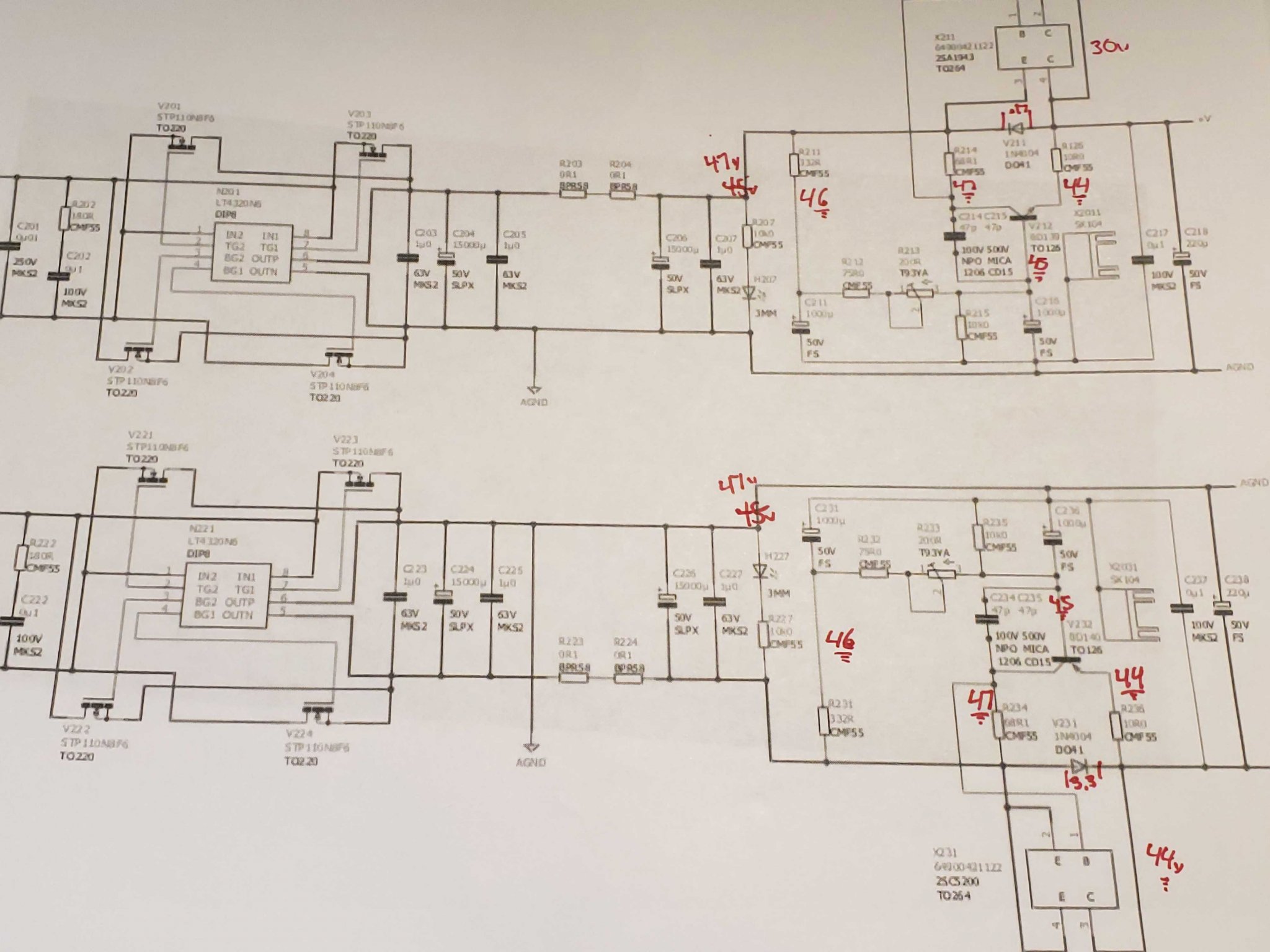

In general, R215 and R235 are the ones that burn if you have a bad connection between the off-board BJTs and the main PCB.
When you say you crossed x231 and x111 and X144 and x211, does that mean you swapped them by accident? That would be bad as the BJTs would act as dead shorts and it would act like a wire and max current would flow. I am not sure if it would damage the BJTs though.
It sounds like there is an error with a component that is causing the amp to not have zero DC offset.
You will need to provide us a marked up schematic with voltages at all key nodes. Where transistors or MOSFETs are, we need the voltage of each pin with respect to 0v analog ground.
R215 and R235 look/measure fine fortunately.

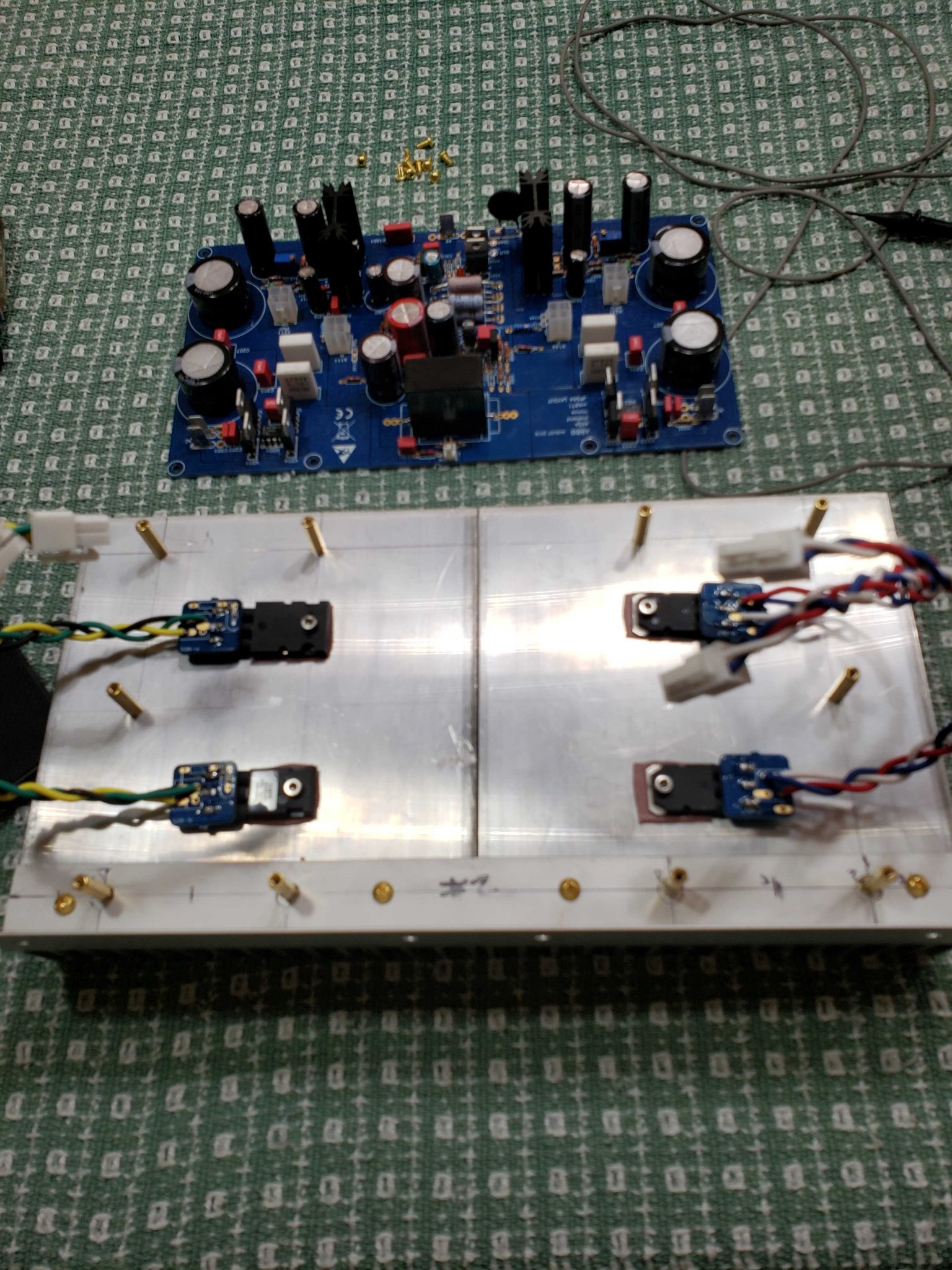

Yea, when I was mounting the transistors to the heatsinks I accidentally swapped them and then managed to miss the board position numbers id written on the connectors when assembling... I definitely feel like a huge dummy to say the least.
I'd re-checked component values across the board and couldn't find anything out of place. My thought was perhaps v232 got cooked.
I'll get working on the additional info, I appreciate the help for sure!
I attached some closer up pics of one board.
I still owe ya a comprehensive list of in circuit measurements, but in the mean time I have removed/tested nearly every diode/bjt/mosfet (using a cheapo DROK tester: seems to work fairly reliably?). Confirming the tester results to their spec sheets at least seems like all of them are fine. I haven't removed v101/v105 yet. I've also re-double checked every resistor as well, I have not checked any capacitor yet. I don't see how this would cause an issue with the rail voltages but I did end up catching that I populated 1500uf rail caps instead of 15000uf for 204/206/224/226.
