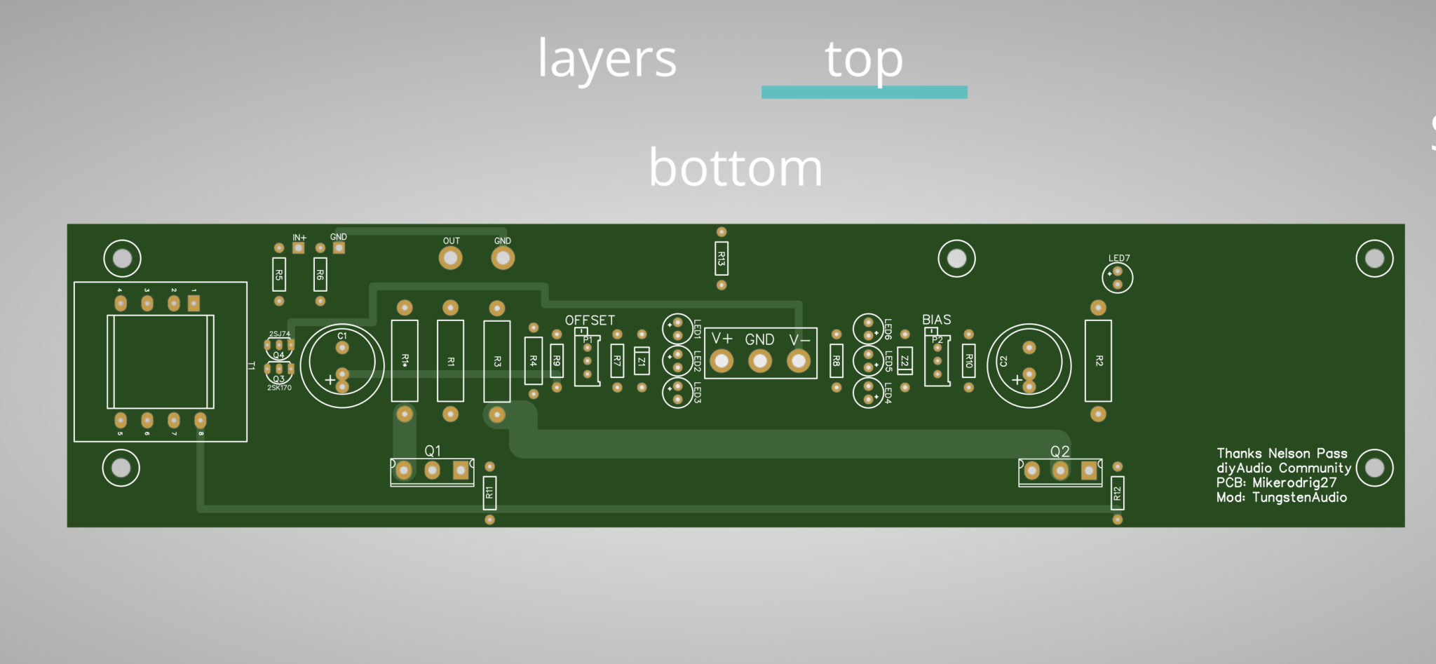

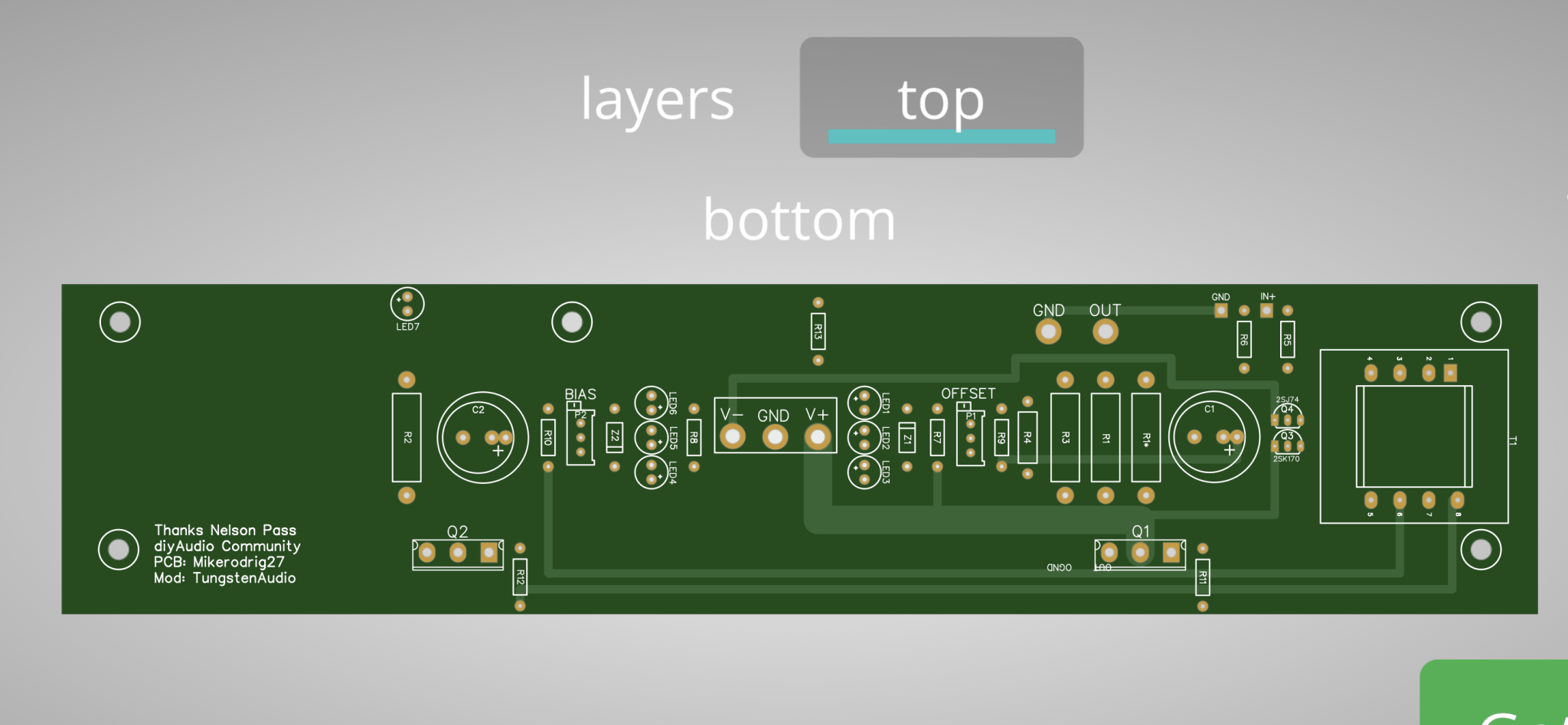

I've had some time to look at the Edcor tri-filar footprint. It is much larger than the Jensen (more pins) and physically larger to the point of requiring an entirely new layout. Still feasible to fit into the overall dimensions of the PCB, but a lot more work to basically start over.
I would like to present the Gerbers for the JFet input PCBs now so our eager builders (greedy boyz & girlz) may get a head start with the Jensen transformers if they have some already or can manage the cost (less $$ in the U.S.)
Nice job, I like that layout better. It looks like it places the output FETs more centrally on the heat sink. I'll have a closer look at the schematica later. it looks really interesting to me.
PCB layout from post 28, excellent work 👍

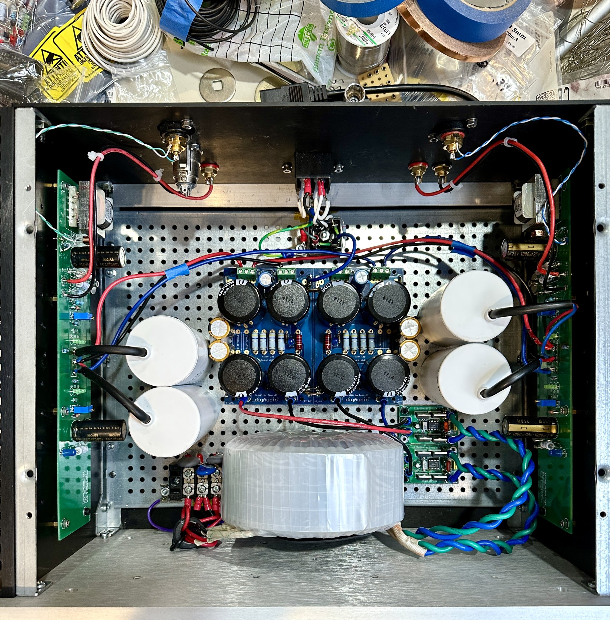

I installed two pairs of motor run caps (big 70 uF polypropylene in oil) in the F6 test bed yesterday. Each pair is effectively dedicated to one of the channels by proximity and short wires. Technically this is still a shared PSU, but the big film caps give a nice approximation of what a full dual-mono PSU would sound like. I got the general idea from the Wiley Zen Mod.
The addition was immediately noticeable, as the soundstage became detached from the speakers. While the sonic landscape doesn’t occupy the entire rear wall of my listening area, it is no longer bound to the locations of the speakers. Height, width and depth are all improved, plus individual instruments have a more palpable sense of being physically present. (Speakers and preamp need to be up to this.) This is the first time I’ve used motor run caps in a shared PSU this way; I‘m plesed with the results.
Just for grins I checked bias and offset this morning, and took the opportunity to goose the bias slightly to 1.65A. Further listening today has been at least equally pleasant. The F6 is remarkably dynamic and liquid in this configuration.
