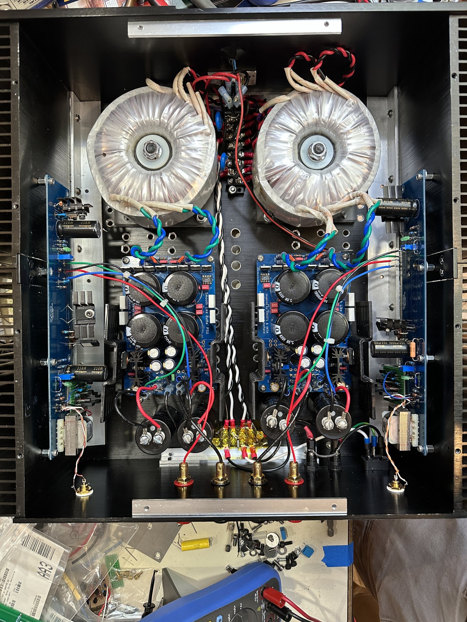

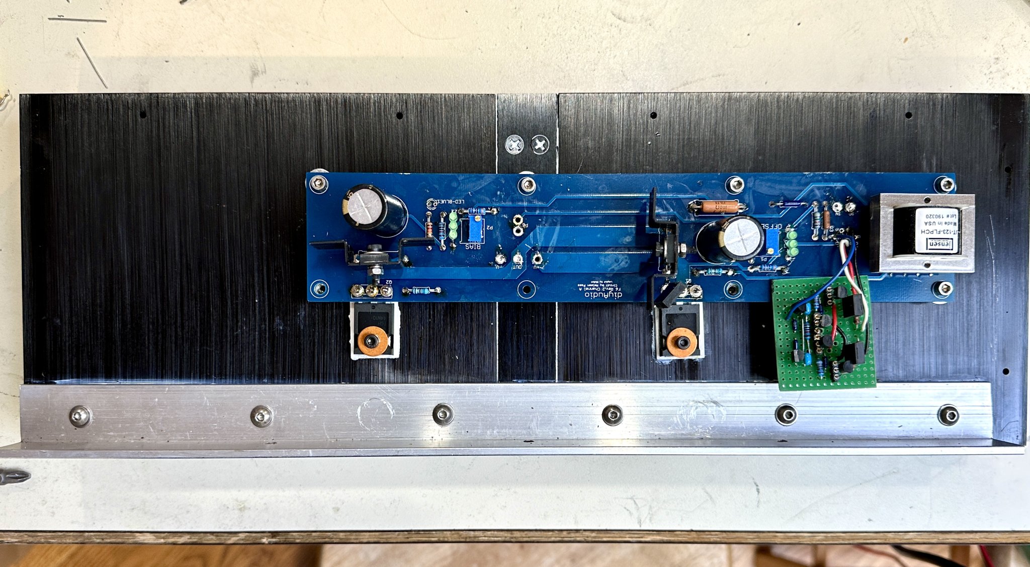

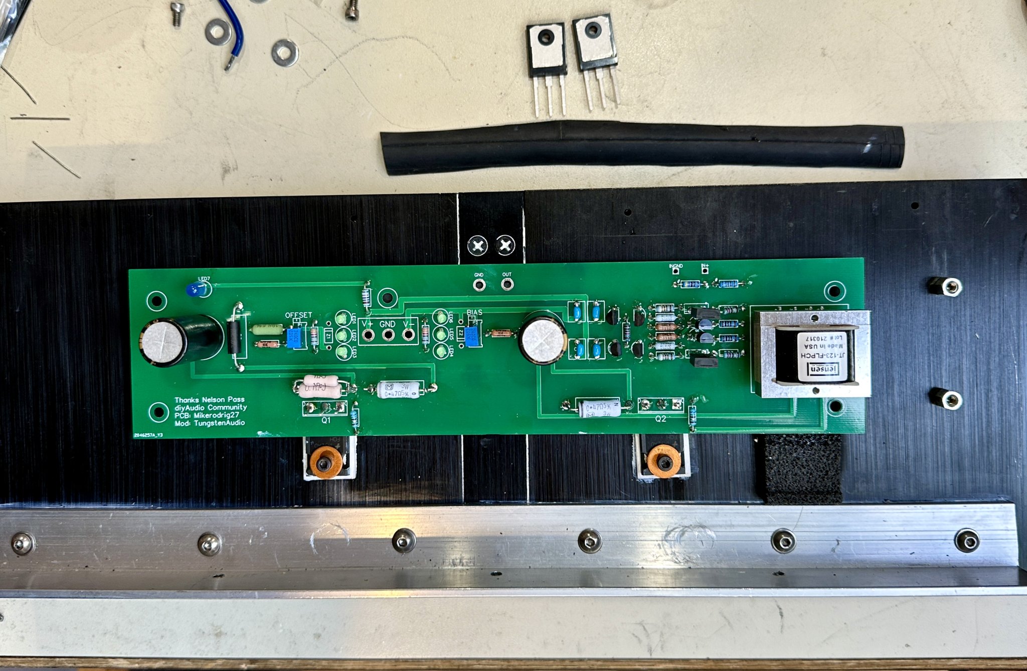

Installation into the larger F6 chassis has become more complicated that I was expecting. This chassis is 400mm deep, as necessary for a dual-mono build with flat mounted power transformers. The heatsinks had no pre-drilled mounting holes. With the original F6 boards from the store, I located the boards to keep the Mosfets more centrally located on the heatsinks. This might not match with standard mounting hole locations on Modushop heatsinks.
Now the new boards can still do this, but with different PCB mounting hole locations. The Jensen transformers are not as far back, but are hopefully Ok. I have taken the expedient route of just using the soldered Mosfets to hold the boards in place, with a rubber strip underneath the upper mounting studs to prevent shorts. If the closer proximity of the Jensens to the power transformers becomes an issue, then there will be other measures to consider.

TA,
If I understand you correctly, the 2 screws through the 2 MOSFETs are holding the PCB in place, as none of the other PCB screw holes are matching the diyAudio store PCB that you had earlier?
The Jensen transformer is some added weight to the F6 PCB, but hopefully you have it under control and the PCB has no tendency of tipping forward?

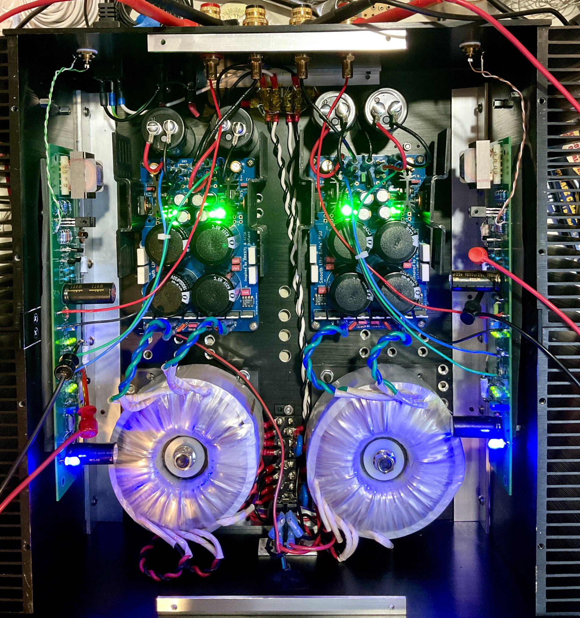

You have that correctly. There is some support from the existing mounting studs, insulated by rubber strips. So the boards are actually fairly secure. I wouldn’t turn the amp on its side and shake it vigorously, but that should go without saying.
I have both boards installed in the chassis. One of them is presently going through its first power-on with bias and offset setting. It has been much easier so far than the previous set. The NTC bias current circuit is observable as the side warms up. Having the green LEDs all soldered into the PCB makes a big difference.

The boards, both JFet and Diamond input, are UMS compatible. The JFet boards were installed in a Modushop 4U Deluxe "jack of all chassis" for testing.
The chassis that is currently being used for testing the Diamond input buffer boards is not a Modushop product. It was drilled and tapped to take the store F6 boards. Given the new Mosfet locations, I could either bolt the Mosfets in the center locations, or bolt the boards to the heatsinks, but not both.
There is probably a way to add a couple extra mounting holes to the Diamond buffer board to better accommodate 400mm deep heatsinks, either Modushop or others.
