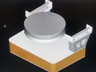

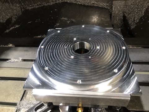

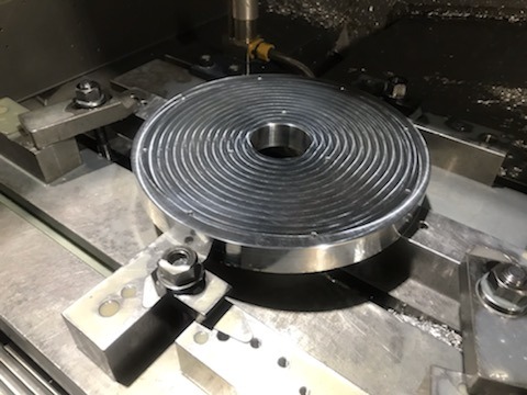

I was approached recently to build 2 more inverted bearing SP10's complete with linear tracking tonearms. The PCB's will be removed from the SP10 chassis and housed is a custom enclosure. To increase motor rigidity the OEM motor housing is being deleted and a custom billet stator and rotor housings will be machined. The ground plane (plinth) will be increased in thickness to around 100mm.
Here is the concept CAD drawing and the pics of the platters being CNCed. I'll post more pics during the build process.

A regular TT bearing has the rotation point at the bottom of the spindle well below the COG of the platter. Try standing this on a table it will fall over. The only thing preventing it from falling over is the journal sleeve which in the SP10mk2 is small in diameter (9/32). This small diameter and slow speed 78rpm (max) does not provide fast enough velocity to create oil swirl for proper hydrodynamic oil pressure so the spindle will wobble in the sleeve. This minute wobble is multiplied by the radius of the platter and is chaotic in nature. This chaotic wobble will cause the cartridge to output an unwanted signal.
A platter sitting on an inverted bearing where the point of rotation is slightly above the COG will rotate with high stability.

That is so cool. Getting hard to make the MK2 any better than thatI was approached recently to build 2 more inverted bearing SP10's complete with linear tracking tonearms. The PCB's will be removed from the SP10 chassis and housed is a custom enclosure. To increase motor rigidity the OEM motor housing is being deleted and a custom billet stator and rotor housings will be machined. The ground plane (plinth) will be increased in thickness to around 100mm.
@donhughes111, the main reason for the update is to make the TT look better, radius's on the corners and a curved front. The new motor housing will significantly increase rigidity in the motor. This will reduce flex in the journal shaft as the platter spins as well as a more direct path to the plinth for motor vibrations. Oh and the journal will be a custom ground solid carbide shaft.
