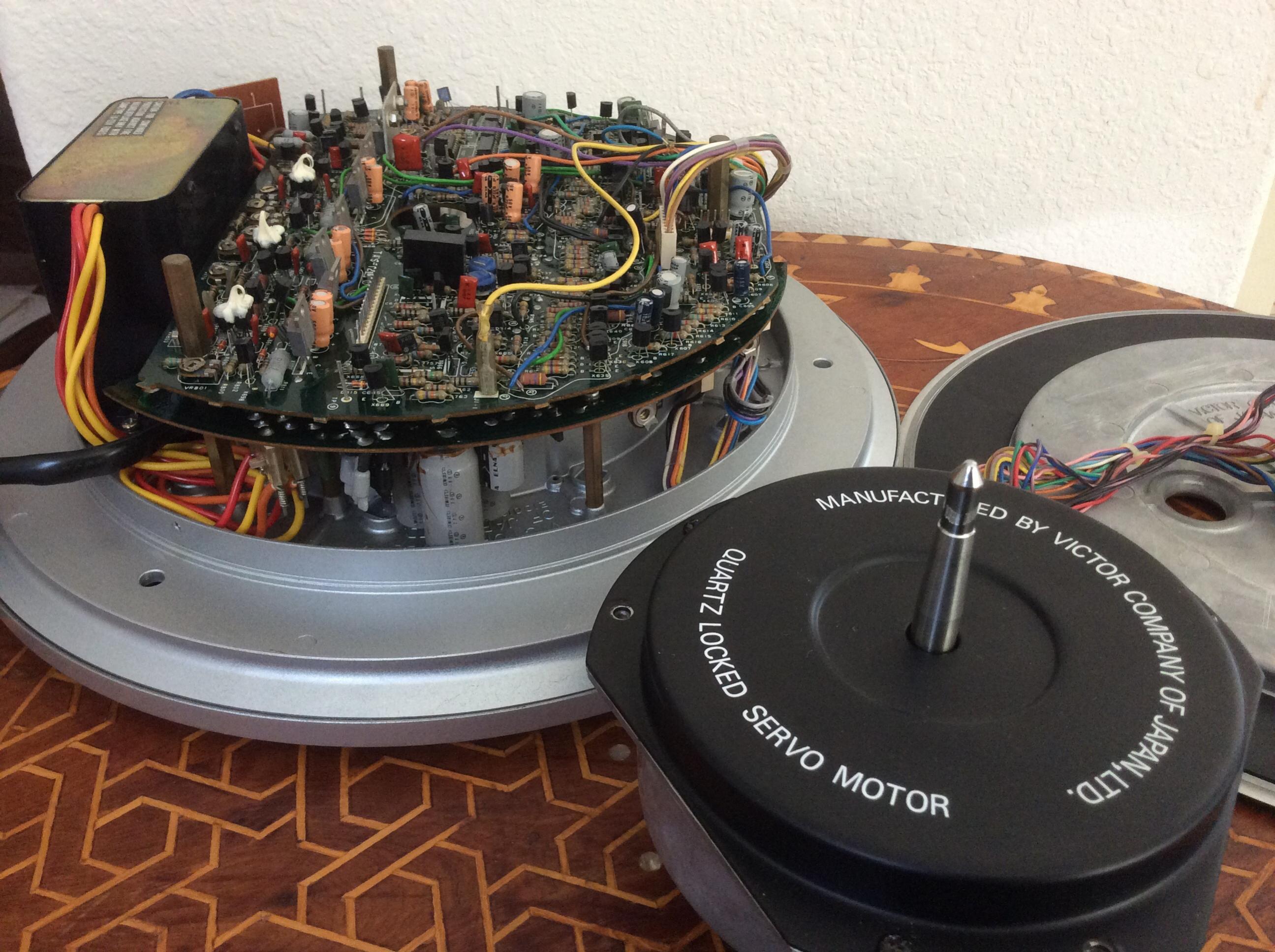

For comparisons sake, here,s my JVC QL-10 guts
37 caps to replace!
It works well with out doing anything to it, but I can't leave well enough alone
42 pounds with plinth.

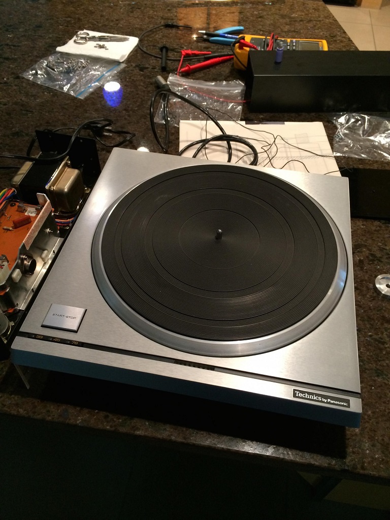

Yeah, I figured out that part. 😀 jp and Jim are helping me out with the plinths. I'm going to dig into the electronics, and maybe do something with the bearing lubrication if that looks like something that needs improving (made a big difference in my VPI). Doing new mats might be interesting- I have some ideas and the ability to compression mold rubber.

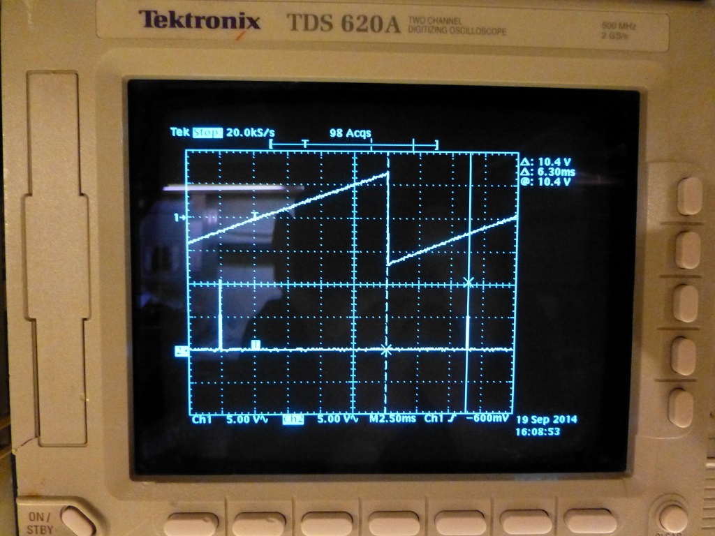

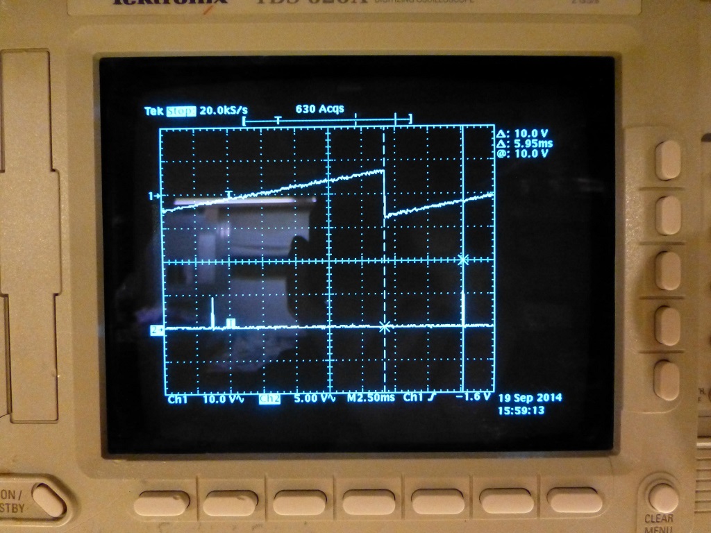

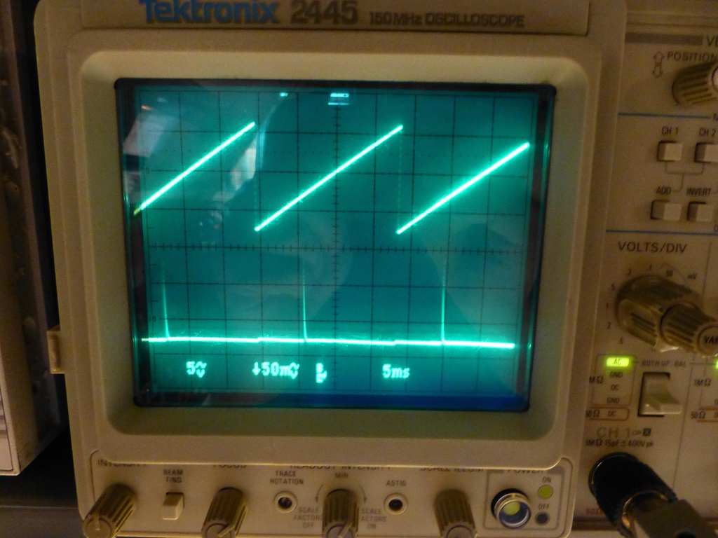

I adjusted the phase tracking today. Using a DSO, I had to stop acquisition to measure as wave T isn't at the same frequency as wave S, so it wasn't showing consistently and there was some noise causing both waves to jump around a teeny bit.
This is at 33 RPM - it's supposed to be 6.3 +/- 0.2ms, and we're at 5.95ms.
attachment.php
And adjusted to 6.30ms
attachment.php

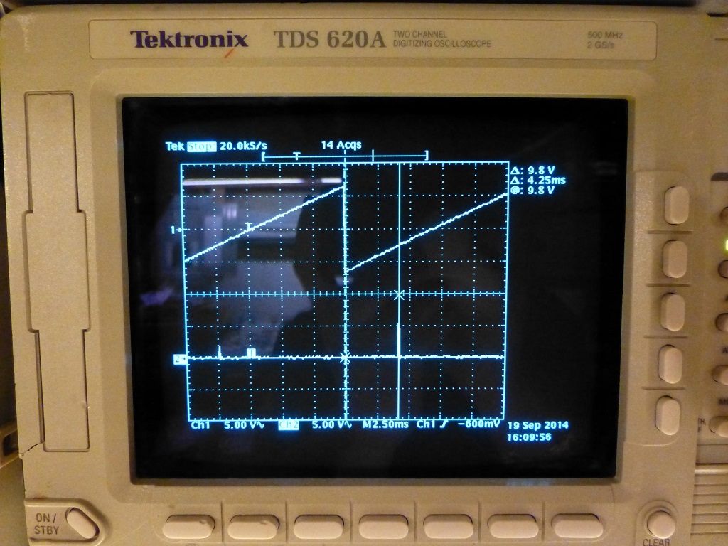

45 RPM isn't adjusted, but should be 4.7 +/- 1.3ms. I'm at 4.25ms, so we're good.
attachment.php

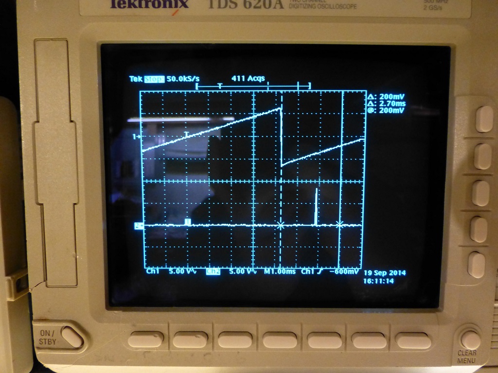

Last was 78 RPM, which was significantly off. The right cursor is where it's supposed to be - 2.70 +/- 0.1ms. I believe it was 1.6ms or so.
attachment.php

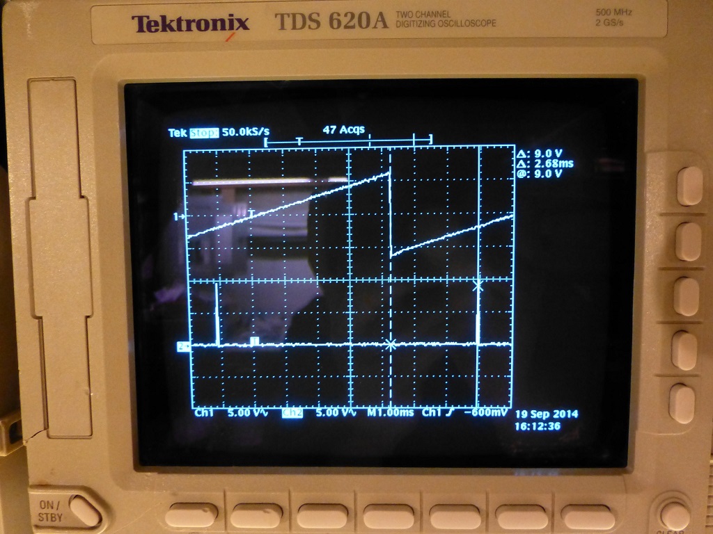

And here it is adjust to 1.68ms. The control on this one is rather touchy.
attachment.php
Last, here's what things look like on an analog scope.
attachment.php
Next, service the bearing and start figuring out a plinth 🙂

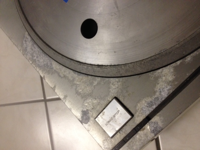

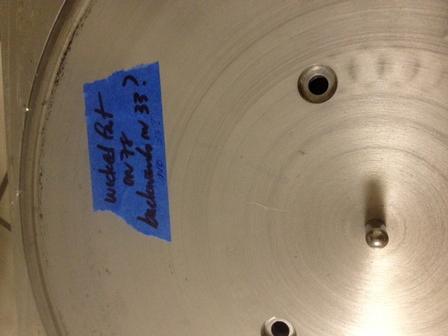

Here's a couple of "before" pix. One of the tables is cosmetically a disaster- looks like someone spilled a caustic substance on it. The other is about like the ones 6L6 is starting with. So the sandblasting cabinet is going to get some use this week.
