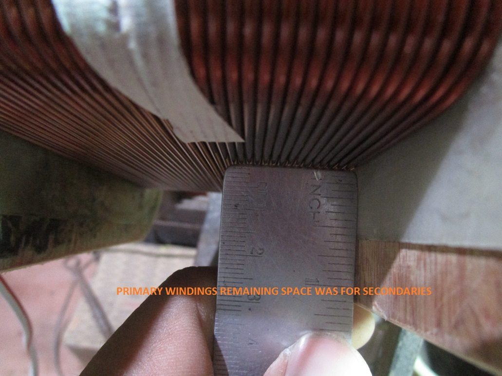

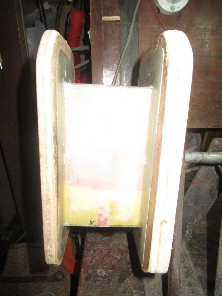

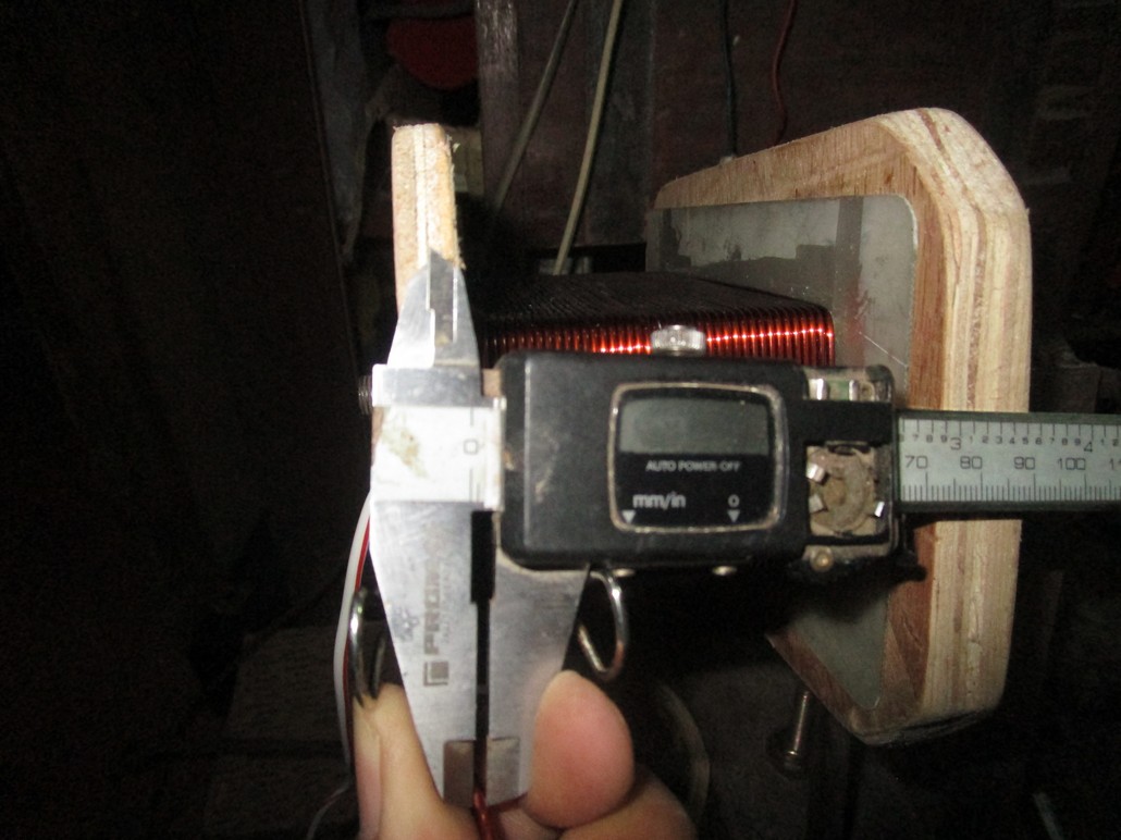

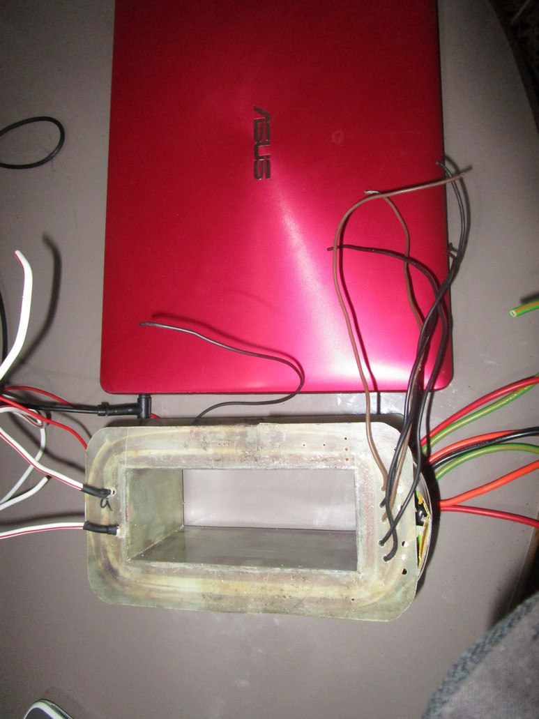

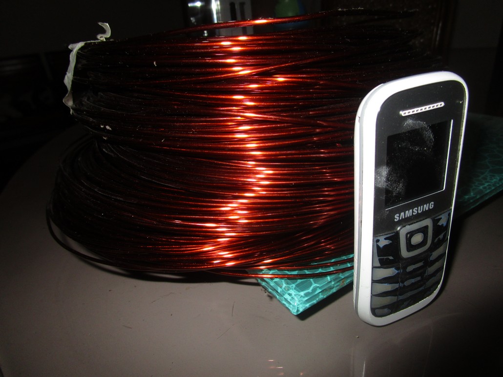

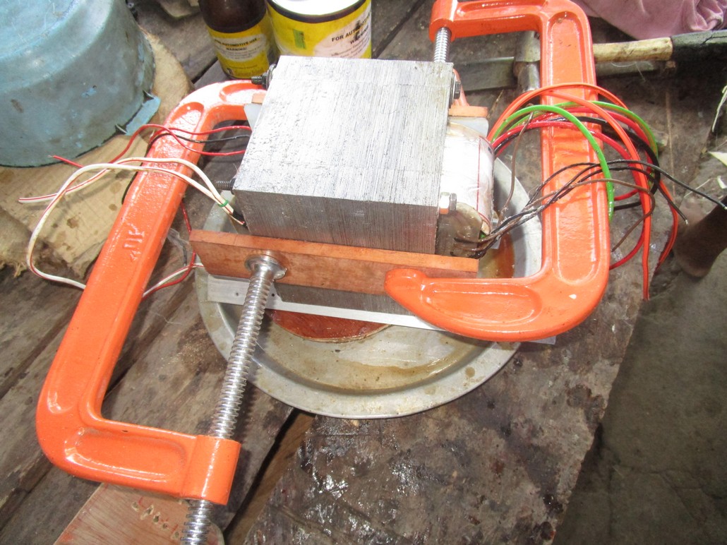

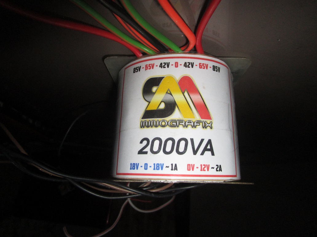

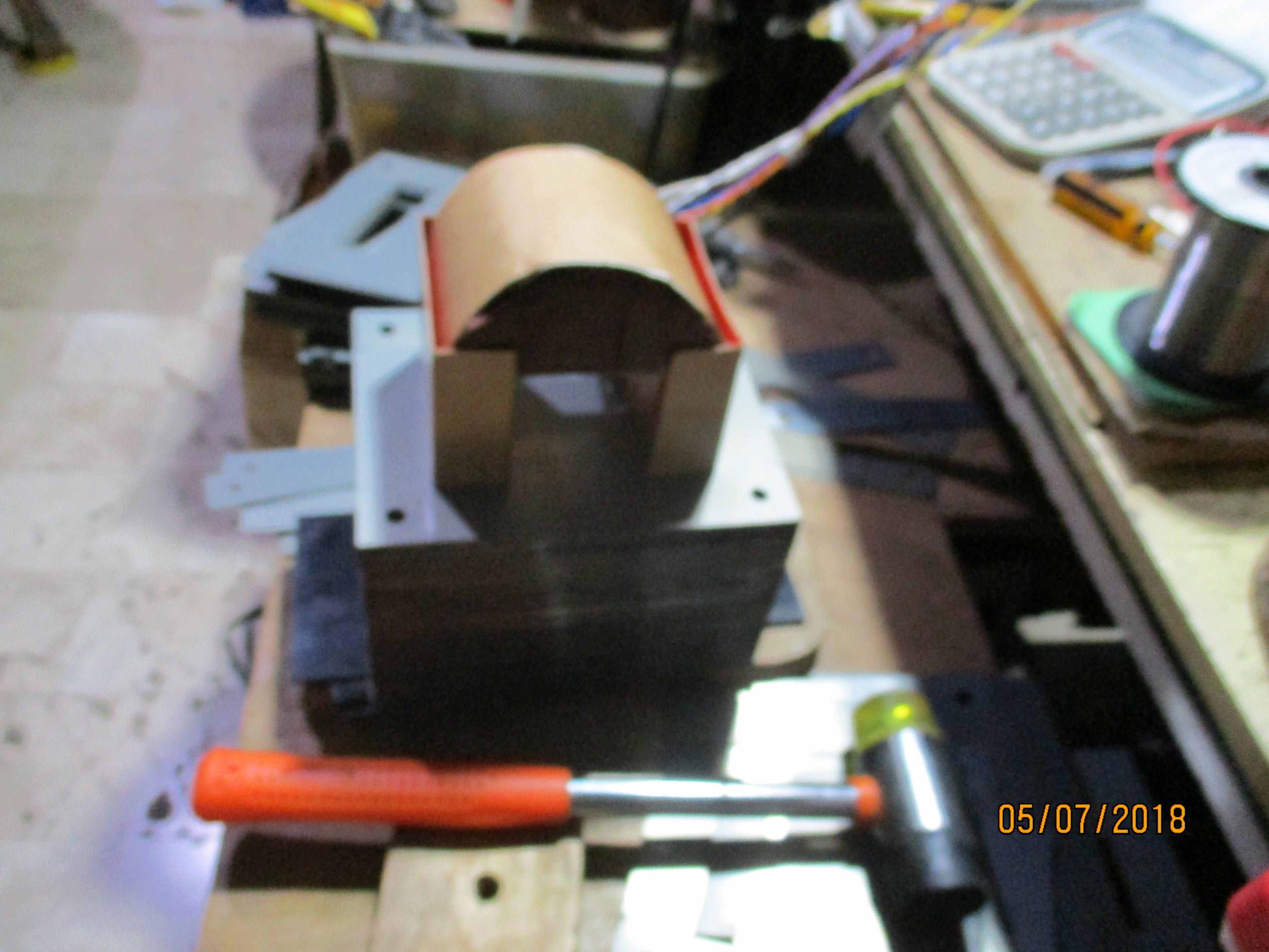

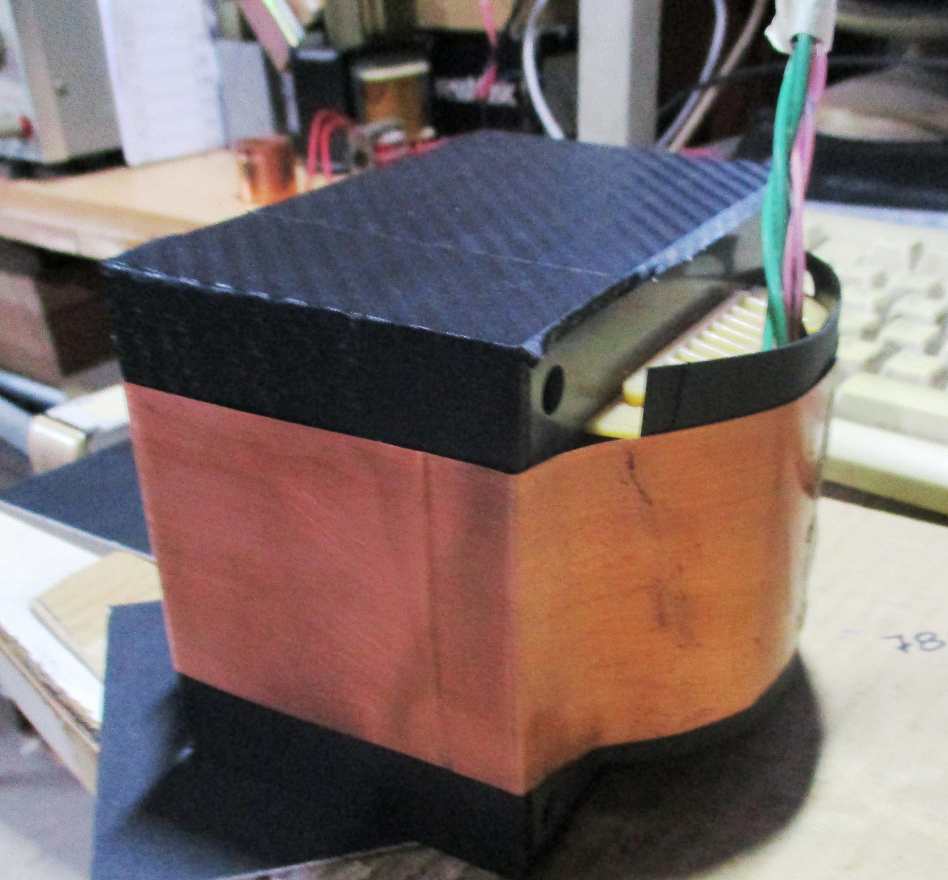

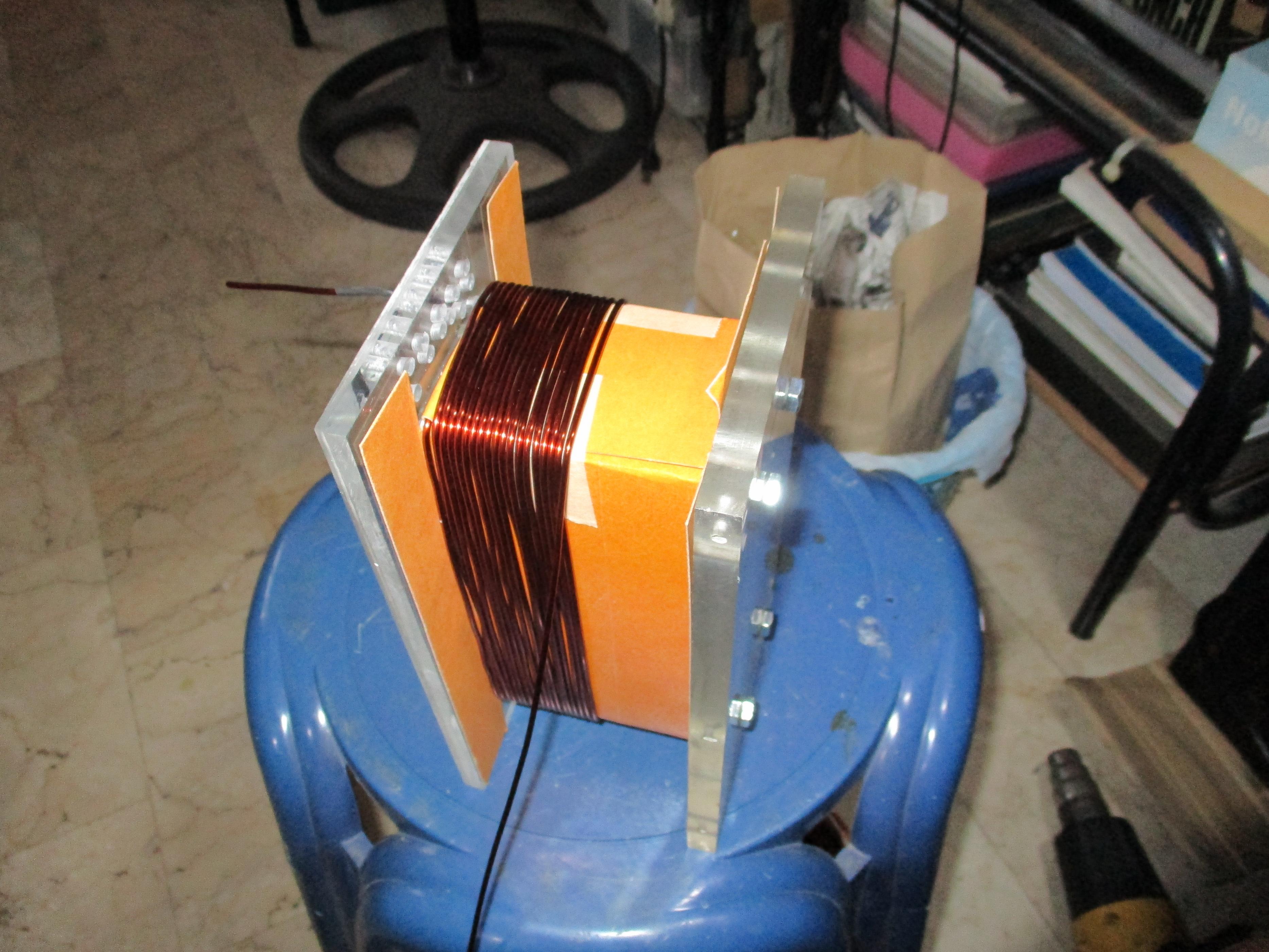

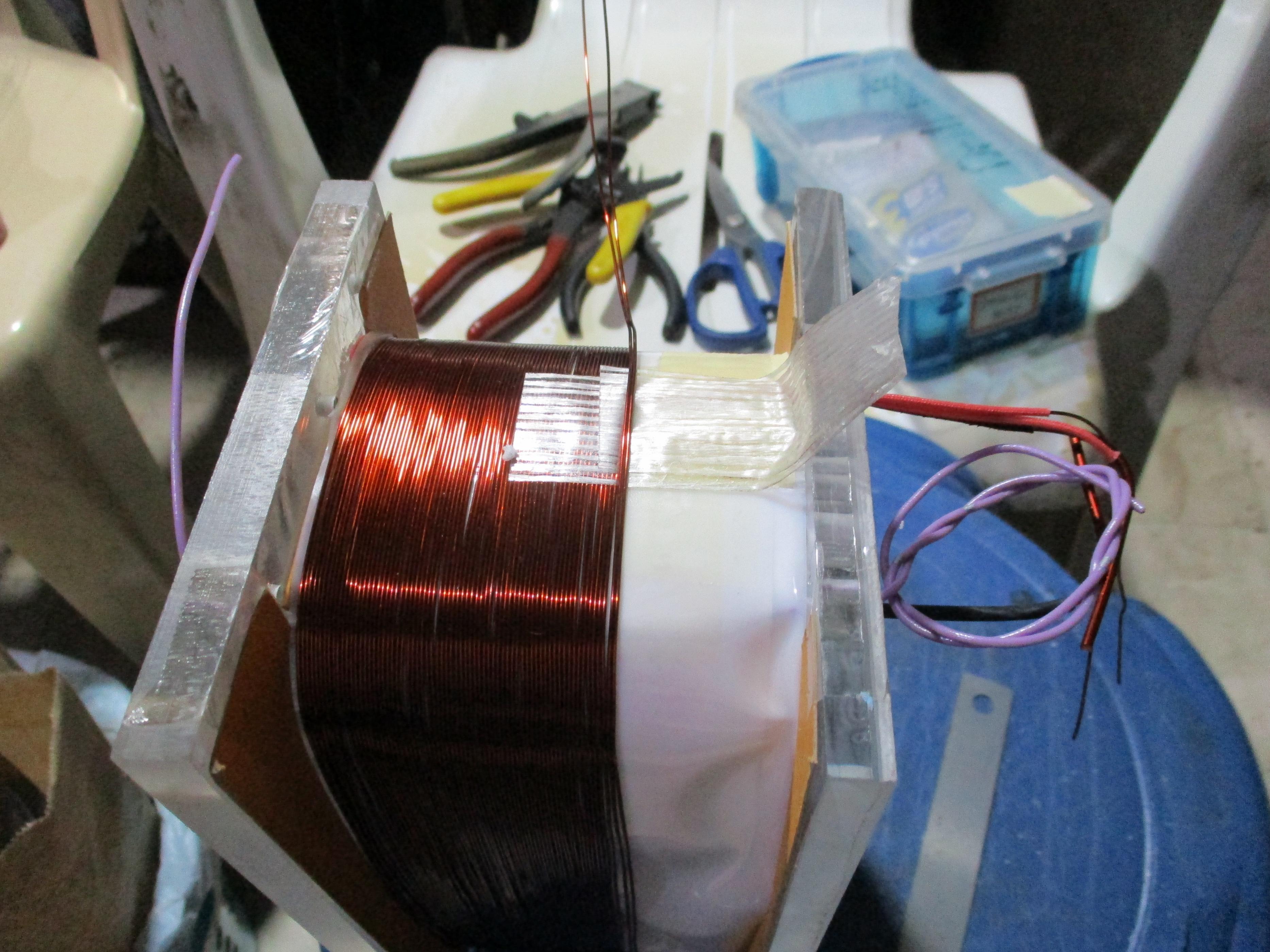

2KVA

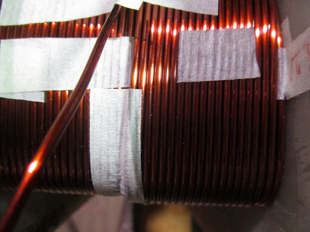

GOOD day sir tony as i have ask before from this thread, (referring to post #967) now i have made the final traffo. it's quite interesting. the traffo was under curing in about 48h now, maybe i will plug it with no load as i get home tomorrow. i have successfully wind number 14AWG and number 11AWG secondaries with 65-0-65vAC. and i have got some vacant space so i have added about 20v+20v to be used for Class H later. here are some documentations
thanks
sam
i thought that too but first, are my computations possible (power:core) ratio?
secondly the way i look at it as i have samples of number 14 wire
in a window of 1"x3" less the bobbin roughly i would take 7/8 x 2 3/4 allowable winding area, so based on actual #14 magnet wires can turn up to 38 in a 2 3/4 bobbin size. I multiplied 38 x 5 = 190, and 5 turns of #14 occupies about 3/8 of an inch.
next the available window left was 1/2 x 2 3/4 unfortunately i do not have #11 sample but as i look into your table turns per linear inch
enamel D.S.C. or S.C.C. D.C.C
#14 15.0 14.20 13.8 i used 14 turns per linear inch as presumption = it works
#11 10.7 10.3 9.8 i used 9 since i do not have sample to compare with.
the bottom line here are my interpretation and calculations based on your table correct?
thanks
regards
the coil build up is what we look at, if that fits then you can go...
#14 has a diameter of 1.63 mm
#11 has a diameter of 2.3 mm
so how many layers for primary?
how many layers for secondary?
this will guide you to make the final decision...

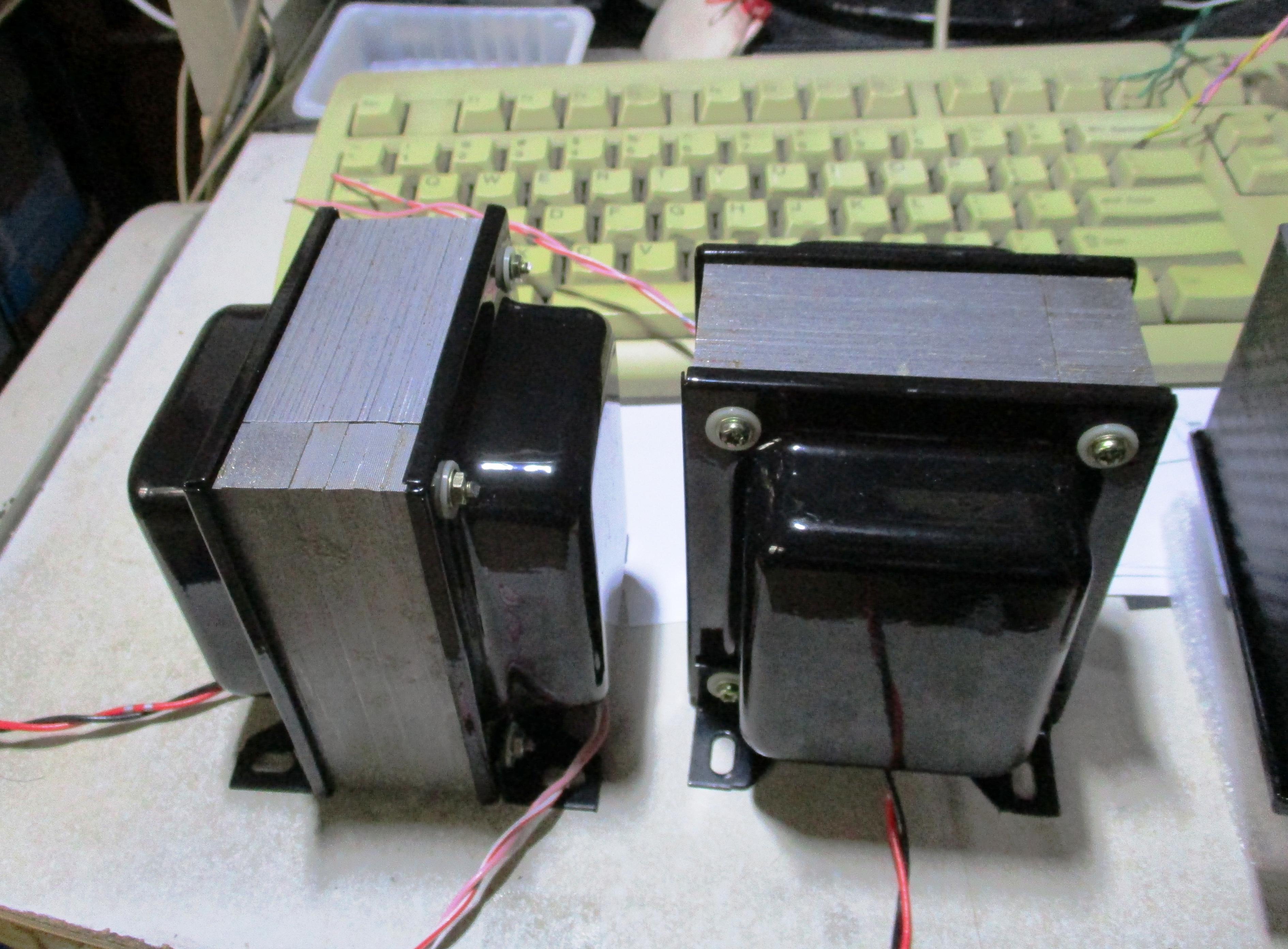

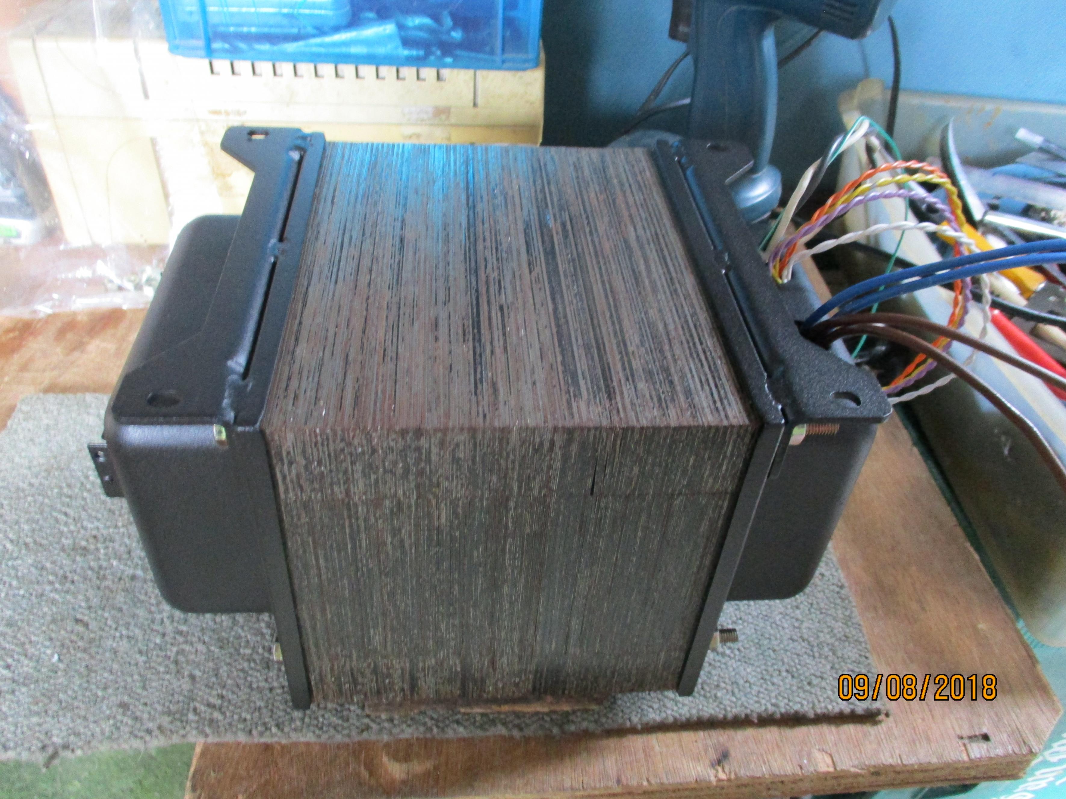

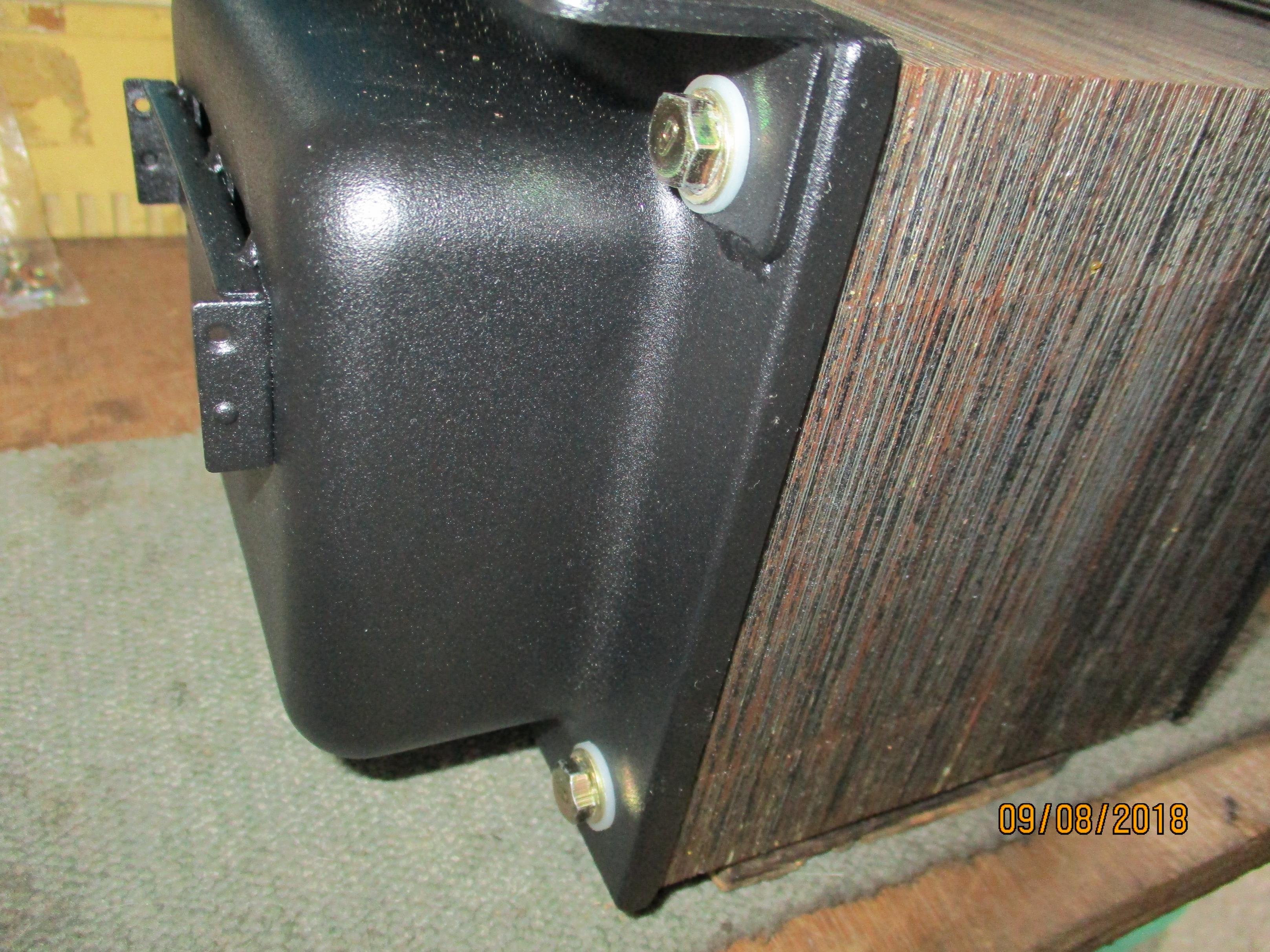

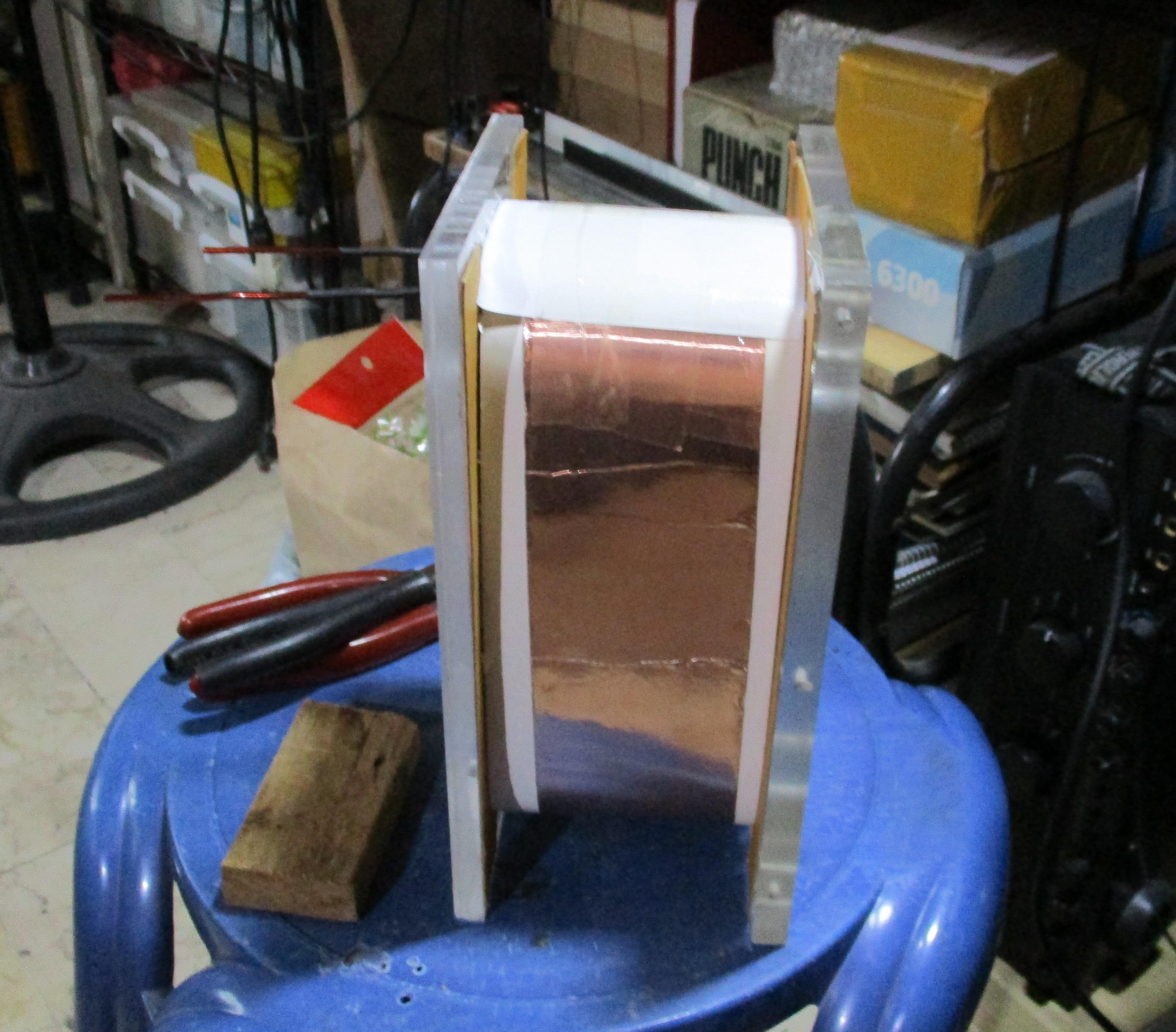

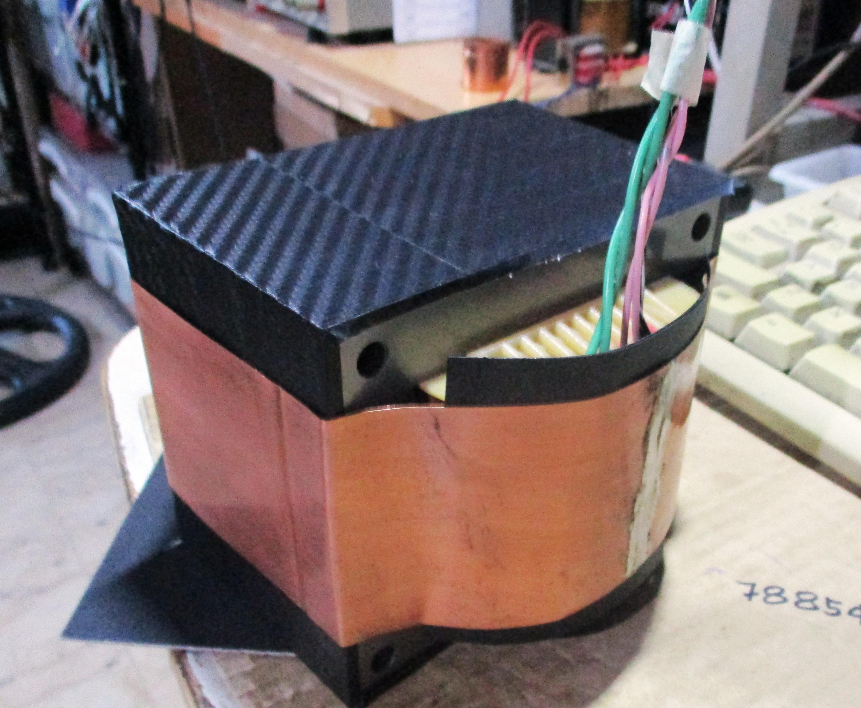

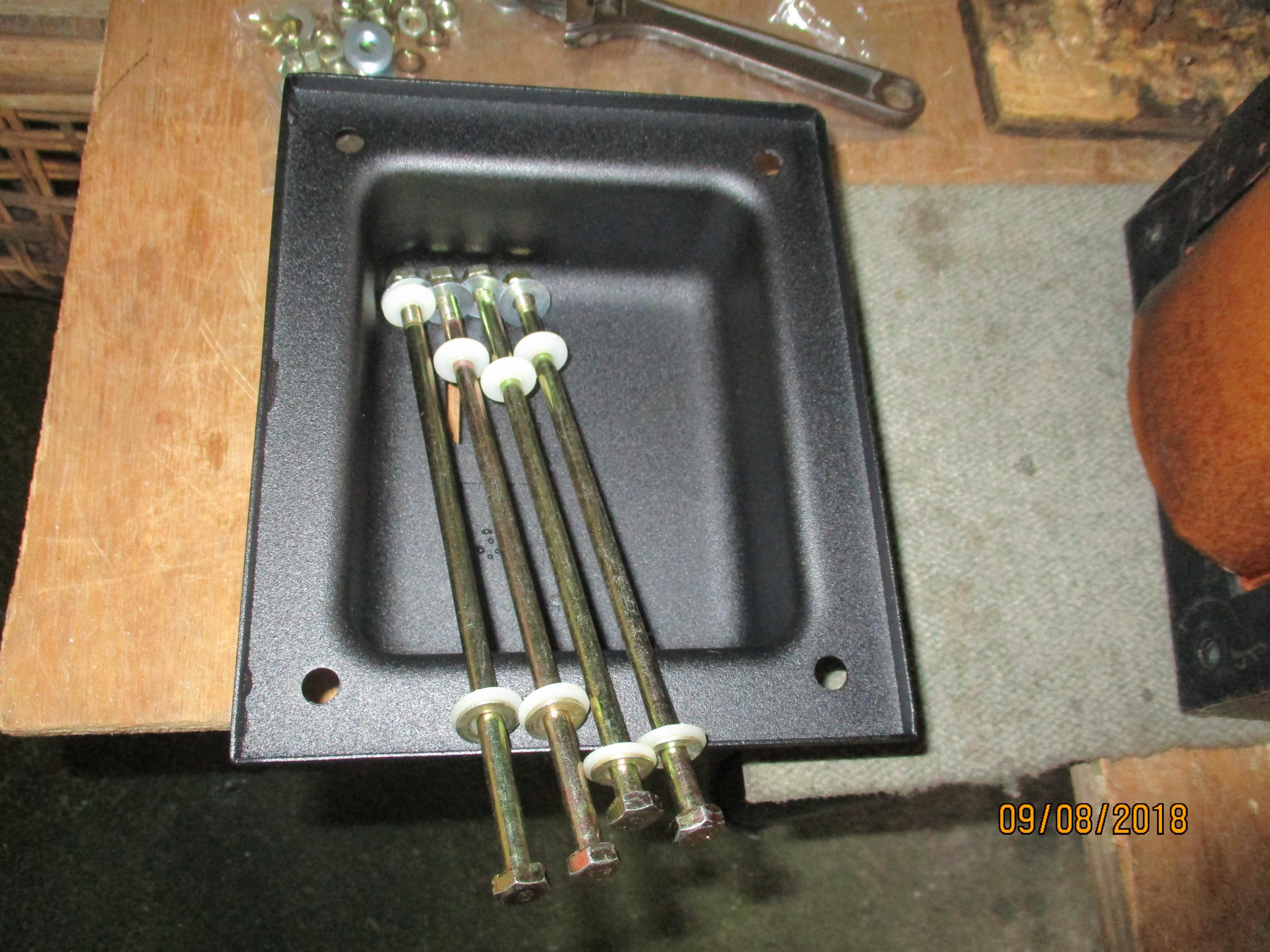

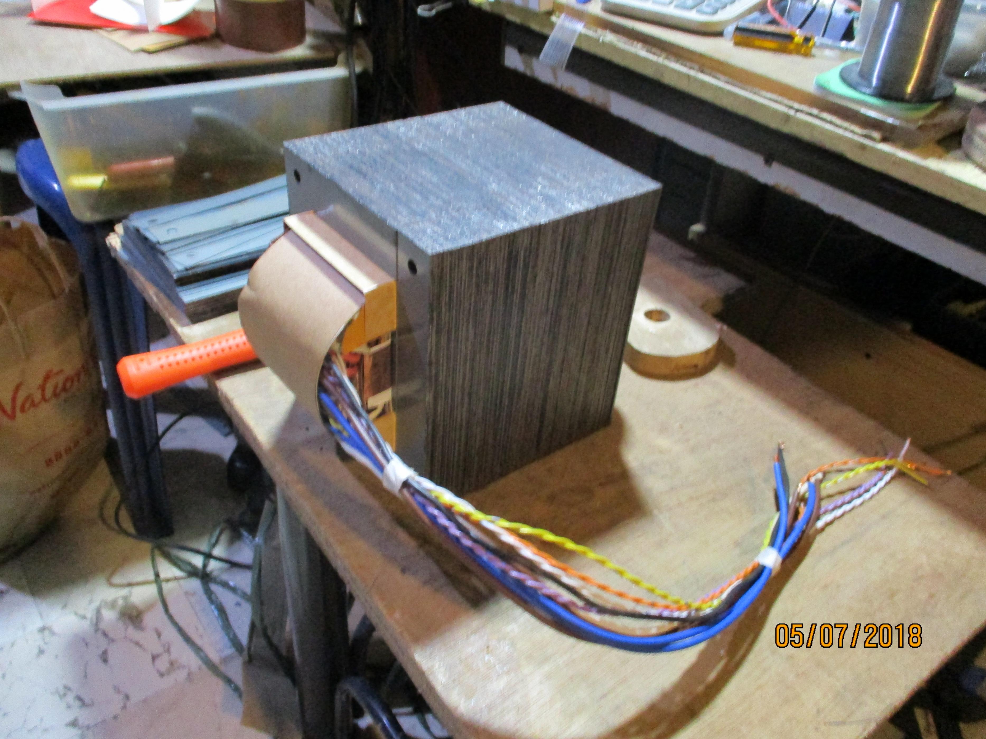

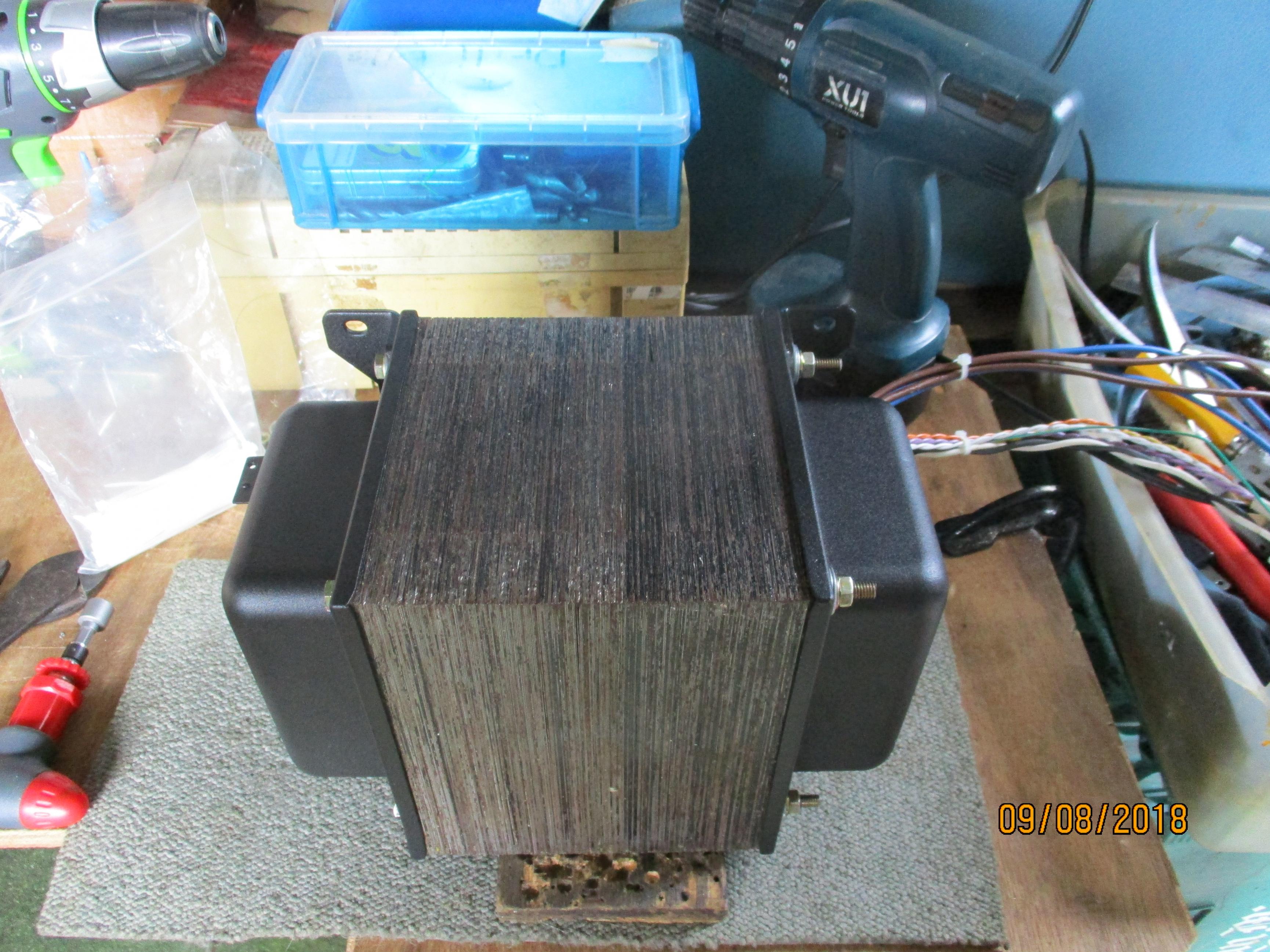

BIG Traffo now complete.....2.25 center leg stacked to 6 inches.....58 lbs beast...
@240 vac primary, secondaries are 2 x 60, 2 x 72, 2 x 12, 1 x 15 volts auxiliary windings....
primary winding is electrostatically shield..
this beast can provide huge amounts of power, for rectifiers i will be using 2 x 72 amp bridge rectifiers and for filter caps, 2 x 68k ufd.100vdc in parallel with 4 x 47k ufd.100v filter caps...fixing bolts are 6mm diam, nylon shoulder washers are used...

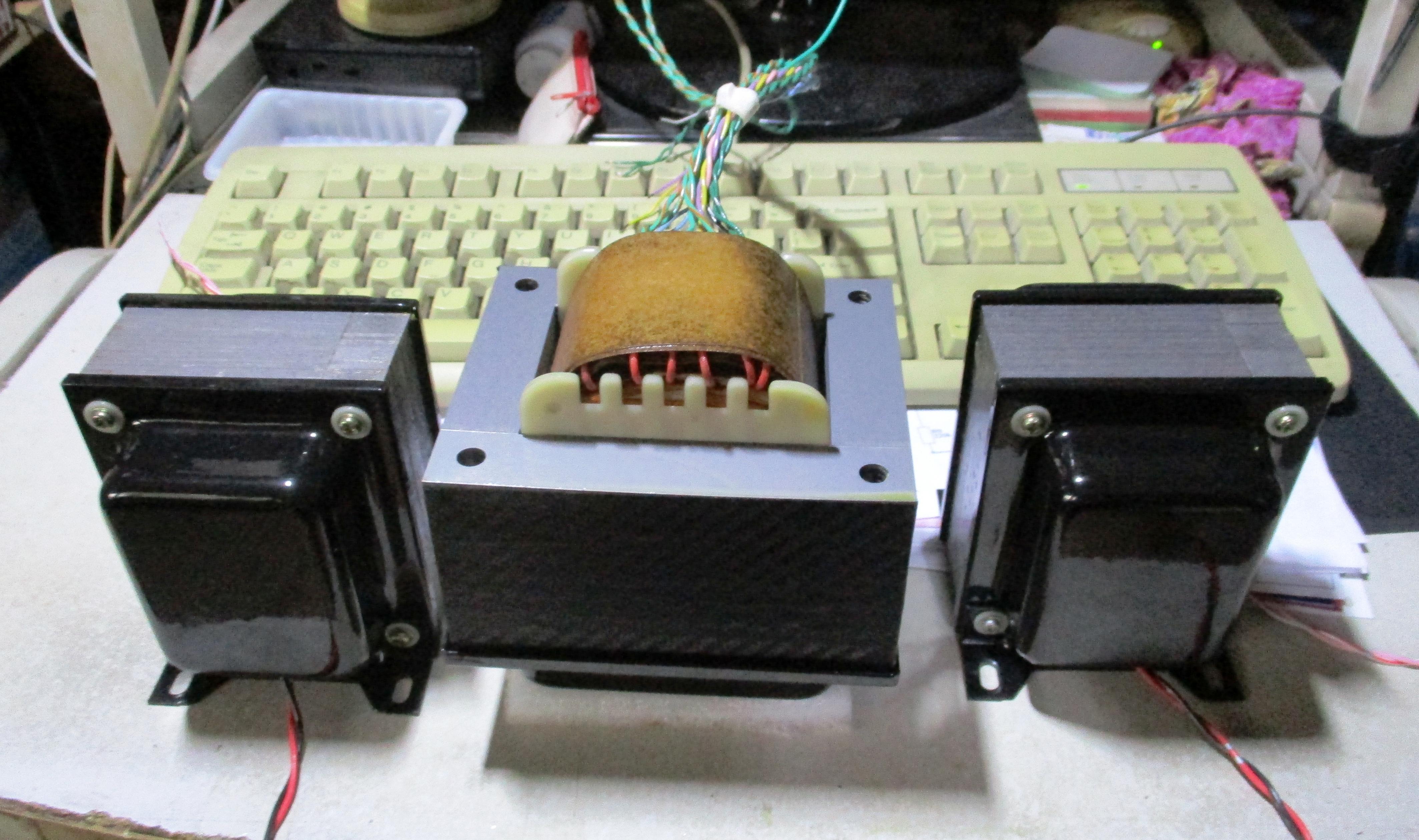

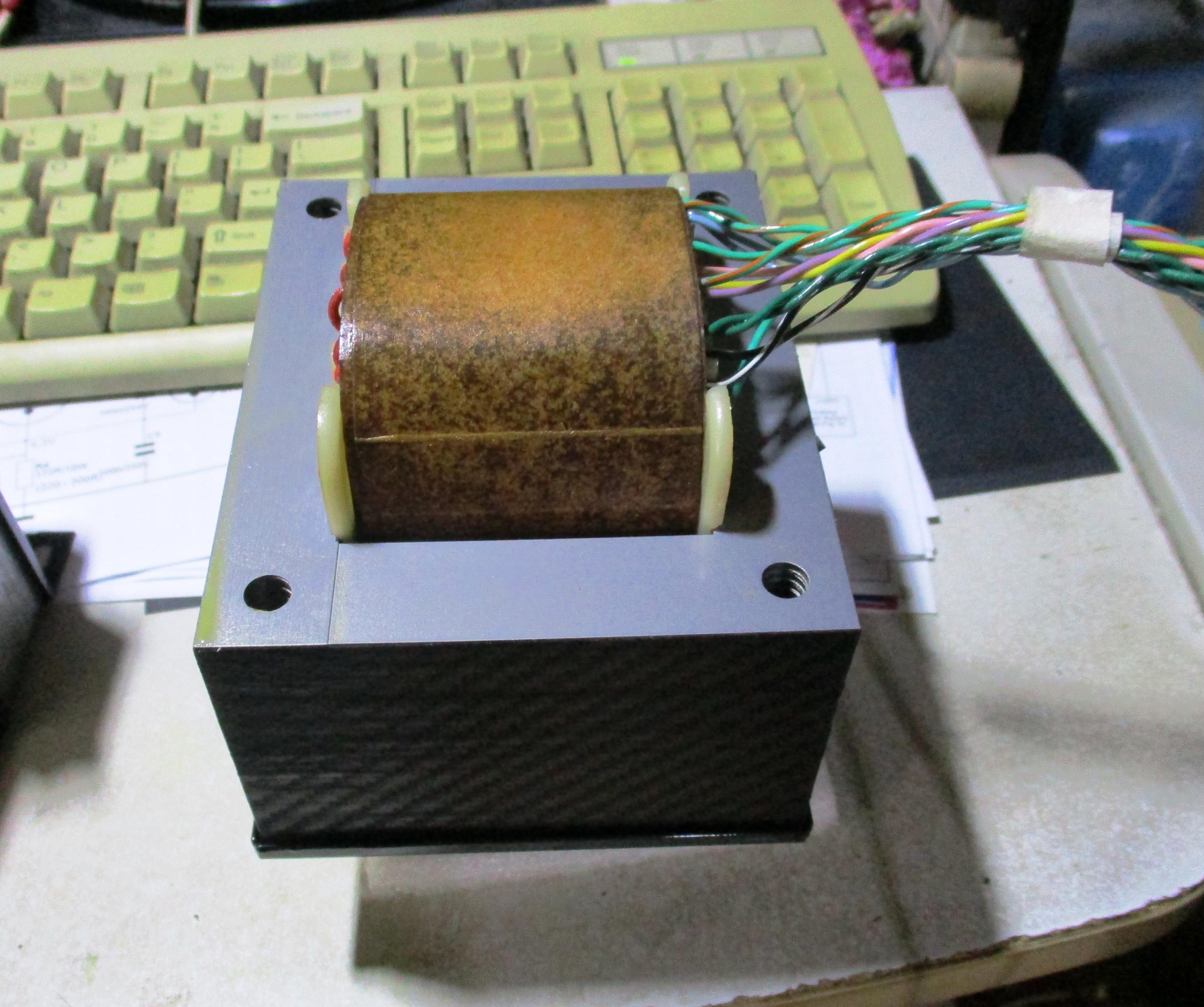

Some questions..
Hi Mr Tony.
Some basic level questions, please if you can cooperate with me.
Before assembling the set, each individual lamination plate E and I has some insulating cover ... (some dielectric varnish for example). ?
For power transformers, there are many differences between using grain oriented and non-grain oriented lamination.
In transformers in general, it is mandatory that the each layer wire must occupy the entire width of the bobbin. ?
Where do you buy and what are the specifications of the lamination you use? . Is the same for PT and OPT transformers ?
I have 0.5 millimeter non-oriented grain lamination available .... but I have my doubts regarding this, final operating temperature, noise, etc.
Can you help me to model a power transformer for TSEII 2A3.
It is now or never, I want to assemble the power transformer for a Tubelab SEII amp, with two 2A3, two 5842 and one 5AR4 valves.....accompanied by two OPT Trascendar 3K/8 ohms.
Several here have used Hammond 370 HX for Power Transformer....
Thanks in advance Mr Tony.
