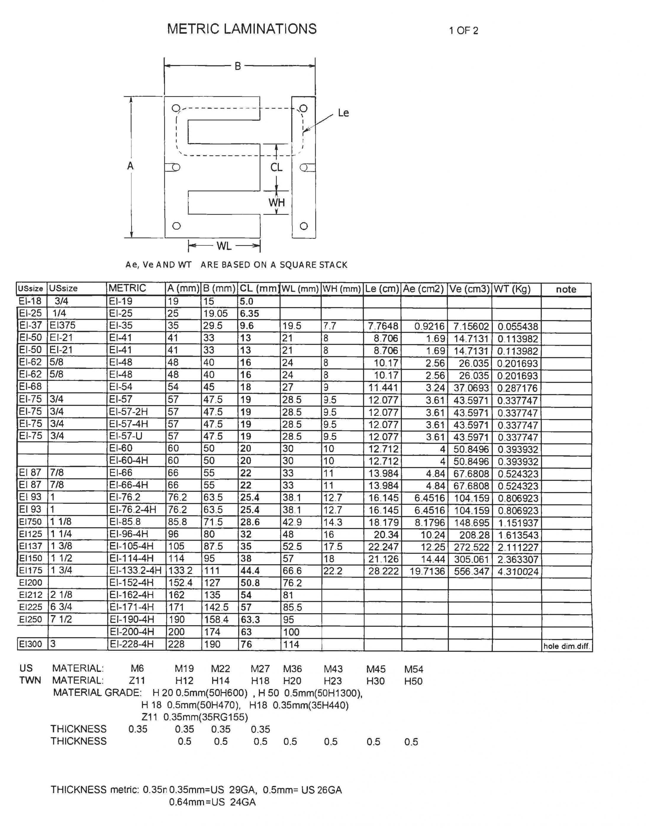

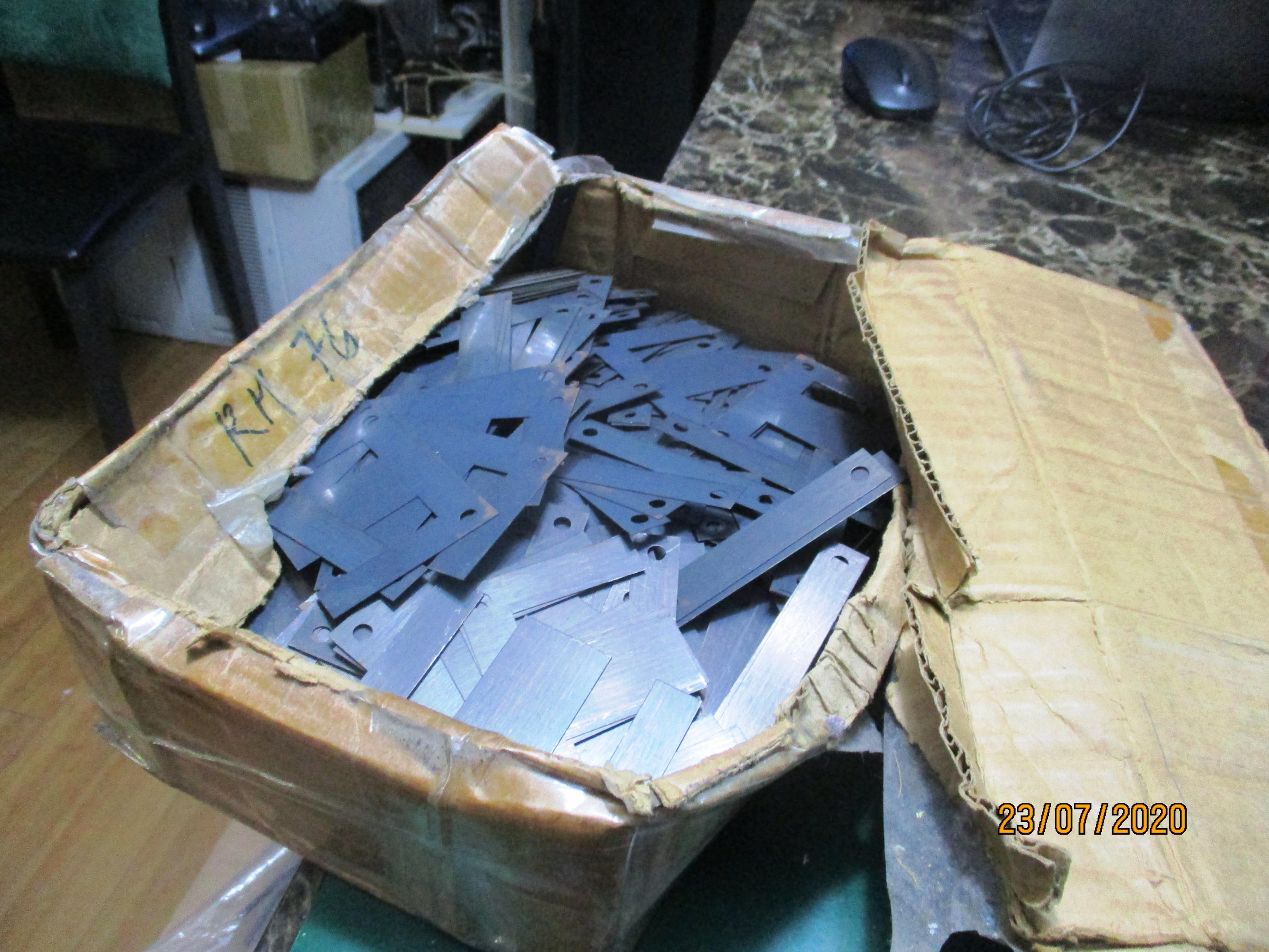

Before assembling the set, each individual lamination plate E and I has some insulating cover ... (some dielectric varnish for example). ?
the thin oxides at the surface served as insulation albeit no a perfect one, just use them...
For power transformers, there are many differences between using grain oriented and non-grain oriented lamination.
goss irons can run at higher flux densities with lower losses than say a noss...
i use the M18 grades 0.35 for power traffos and M6/Z11 0.35mm thick laminations for output transformers..

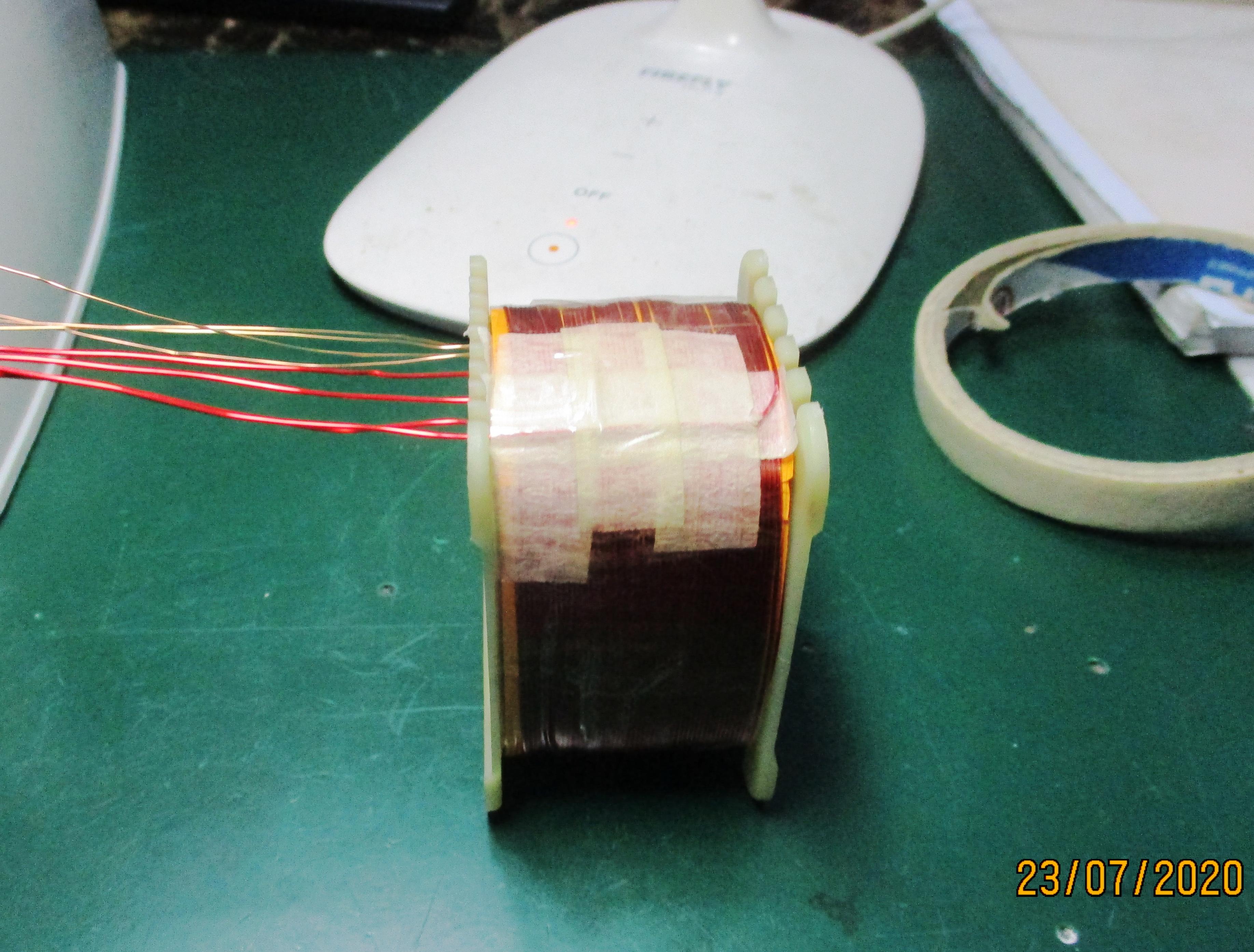

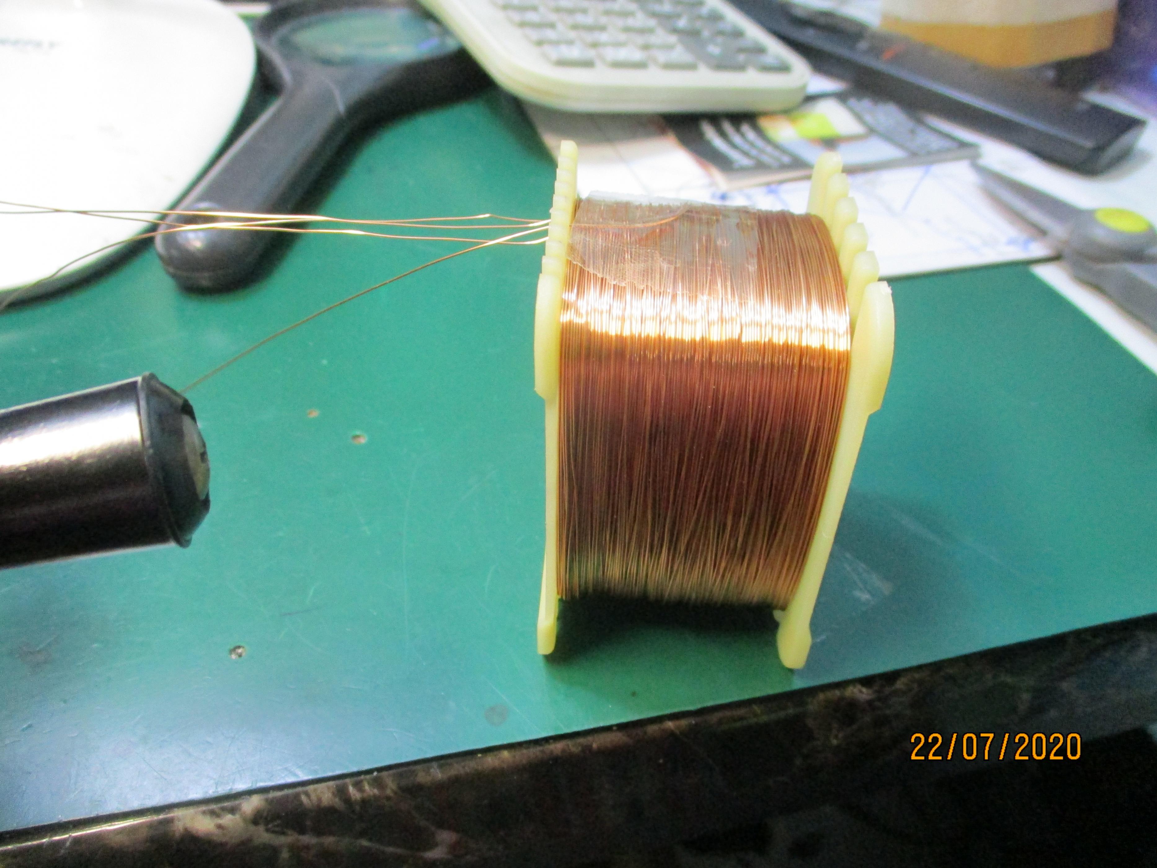

In transformers in general, it is mandatory that the each layer wire must occupy the entire width of the bobbin. ?
yes as much as possible, except in cases of high voltages, where creepage distance is observed....

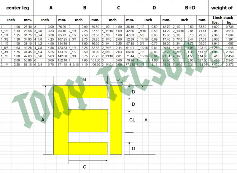

Where do you buy and what are the specifications of the lamination you use? . Is the same for PT and OPT transformers ?
I have 0.5 millimeter non-oriented grain lamination available .... but I have my doubts regarding this, final operating temperature, noise, etc.

0.5mm thick will also do for power transformers, you need to run them lower flux densities though...

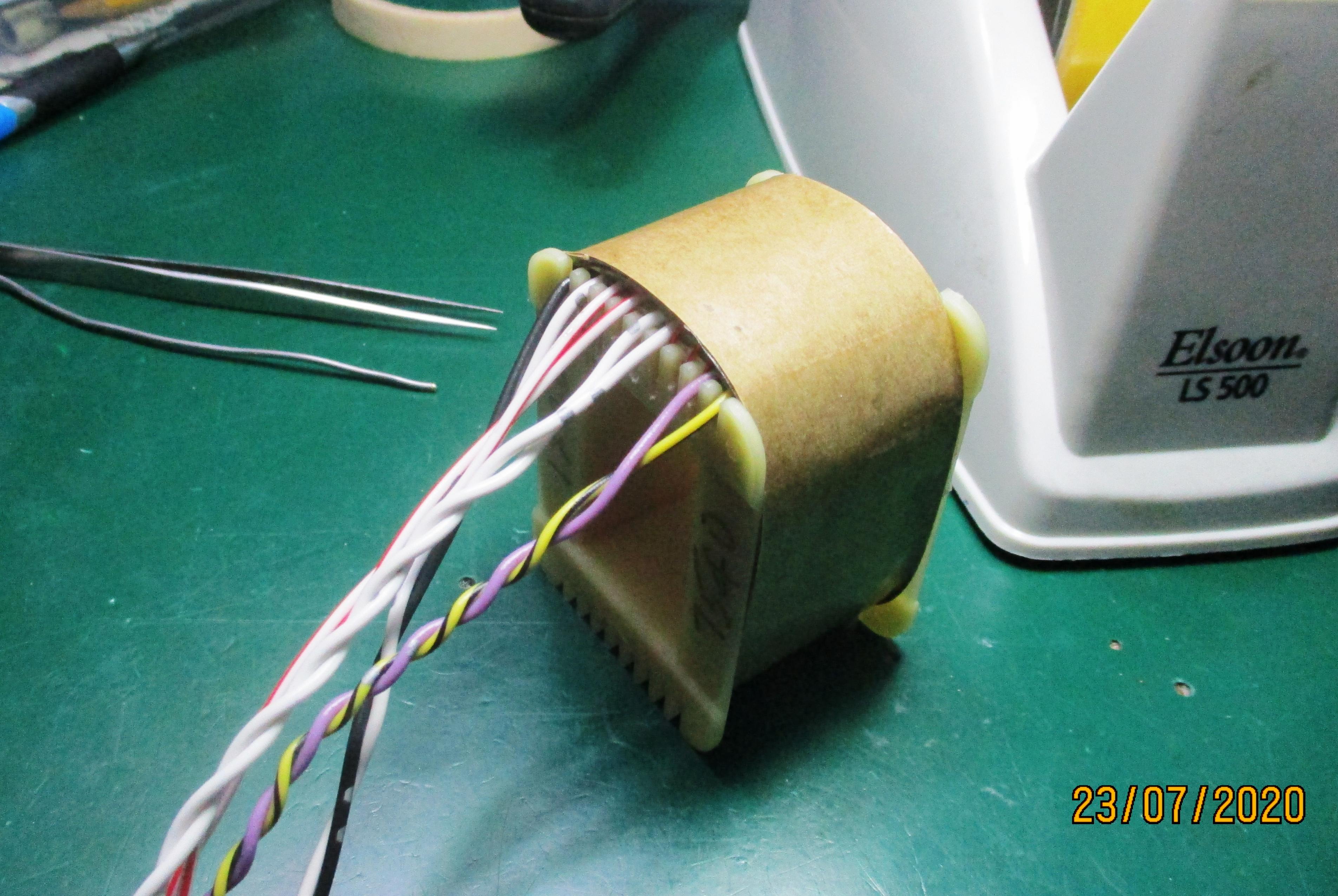

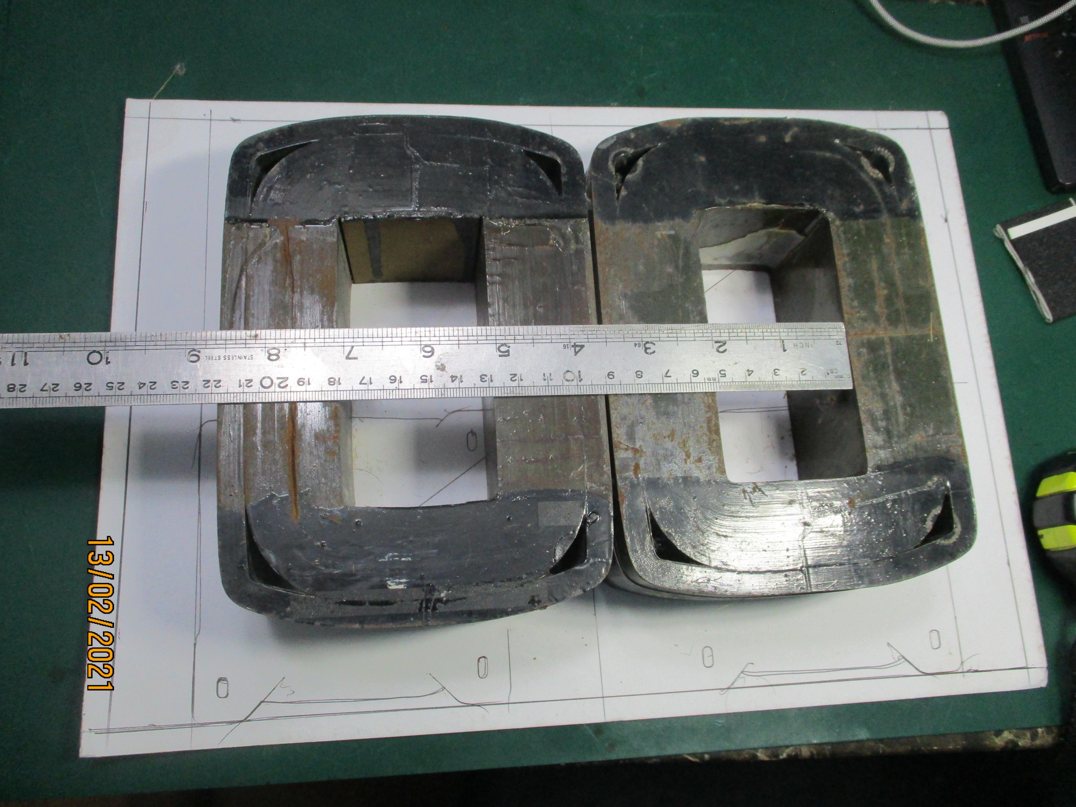

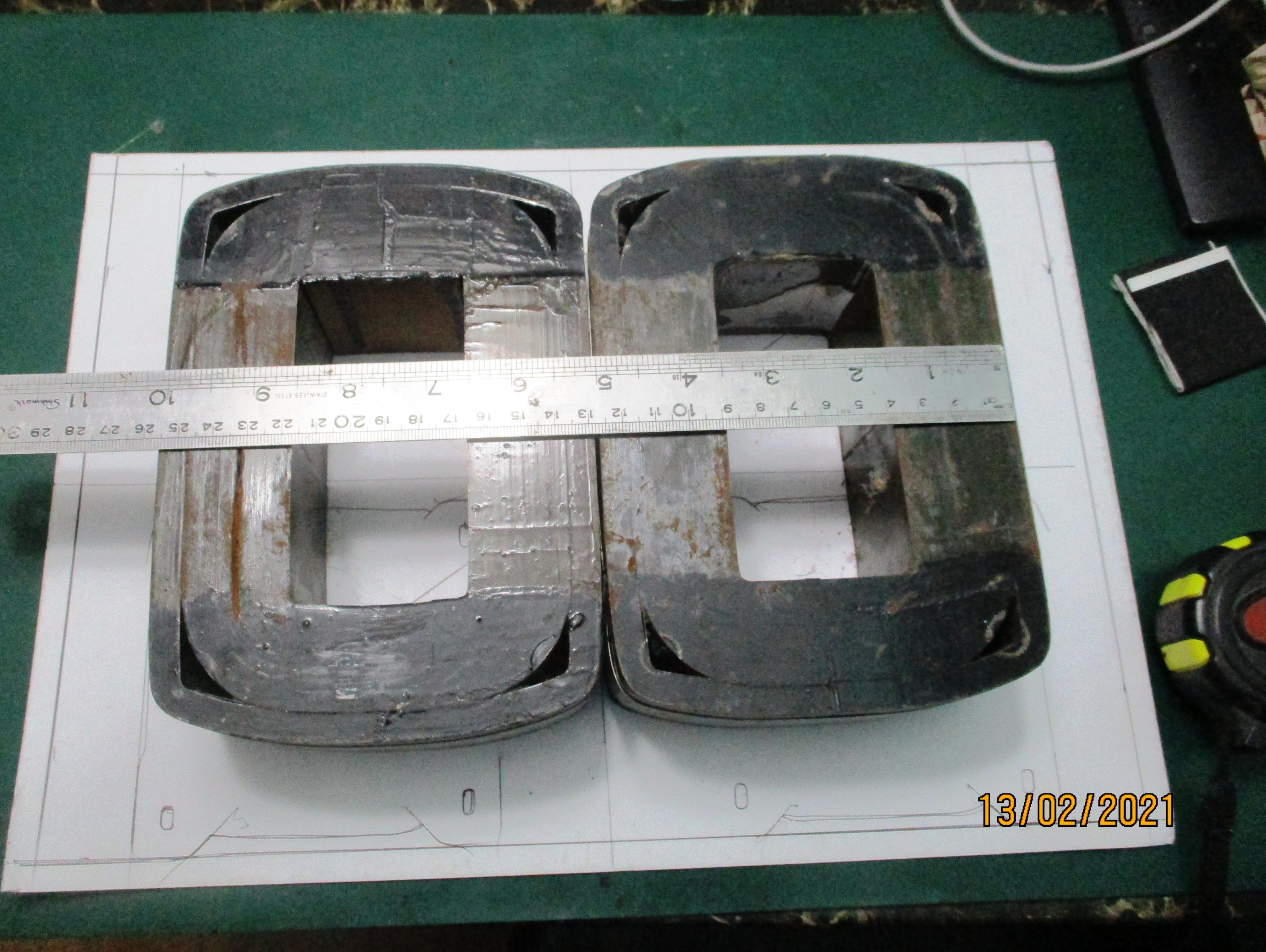

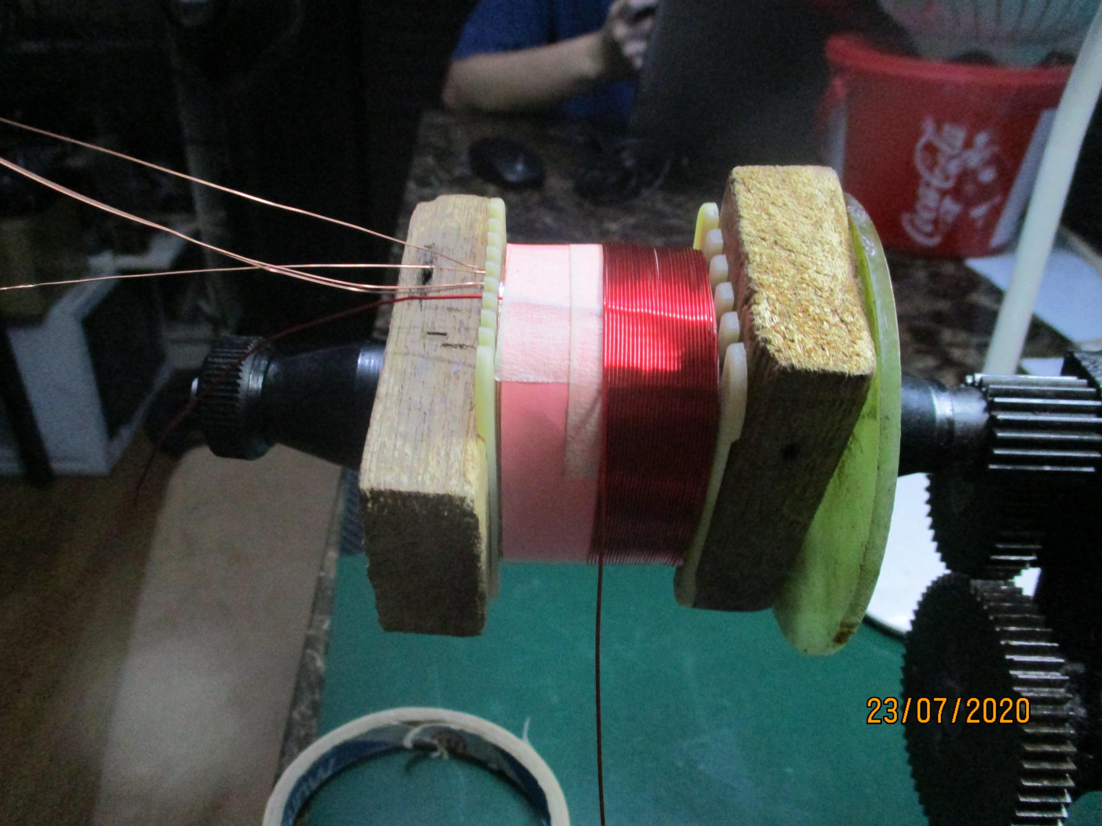

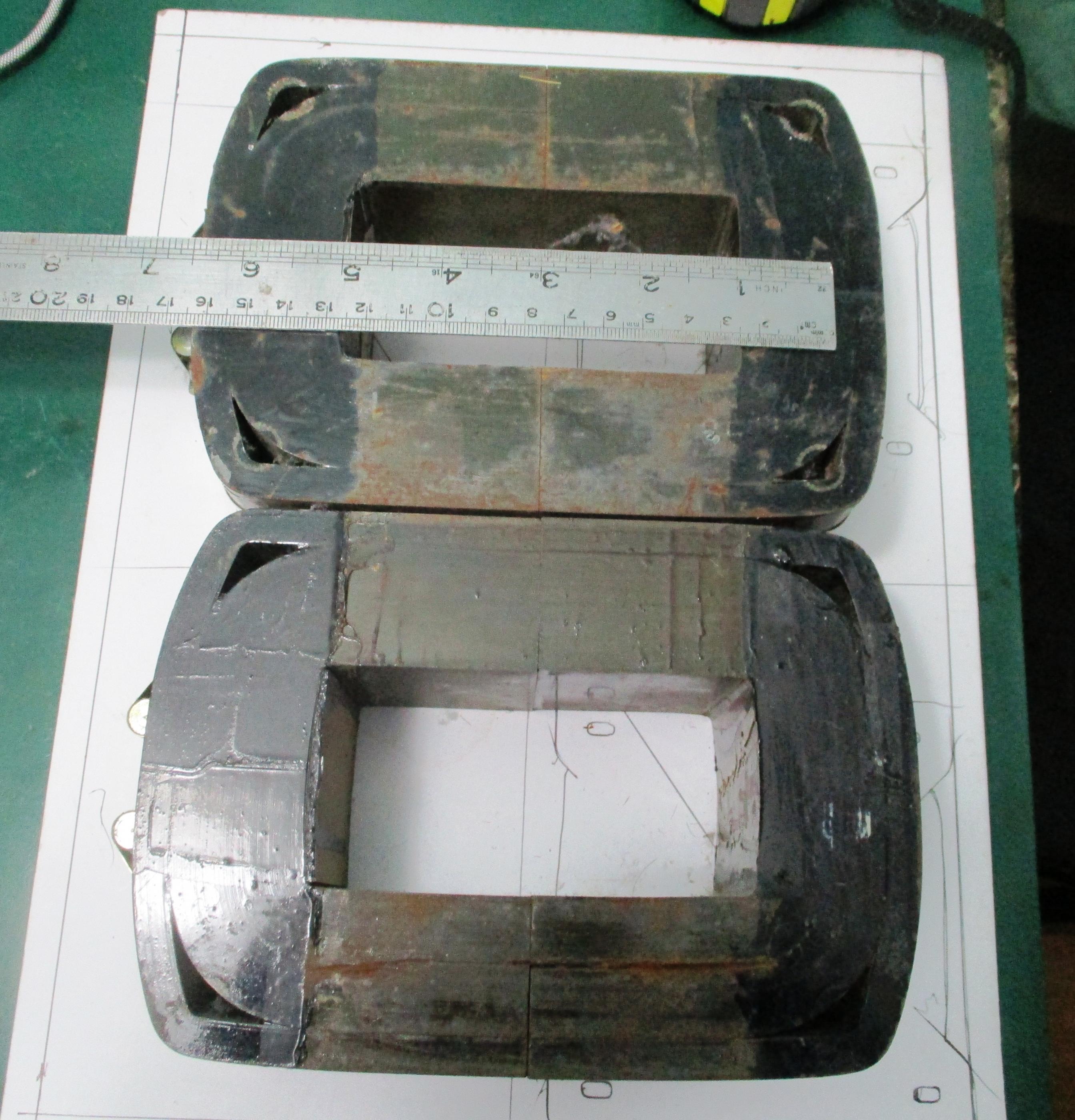

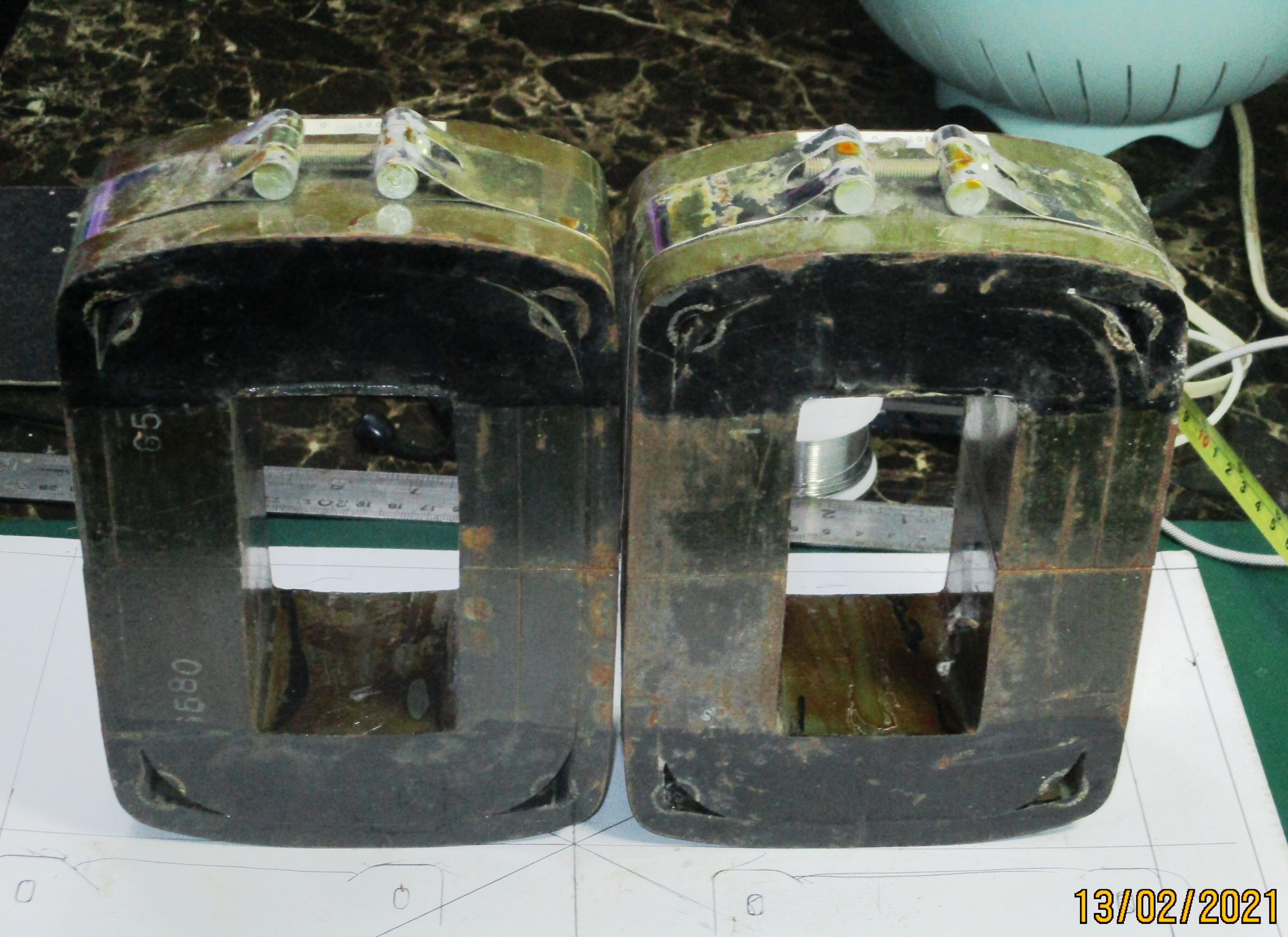

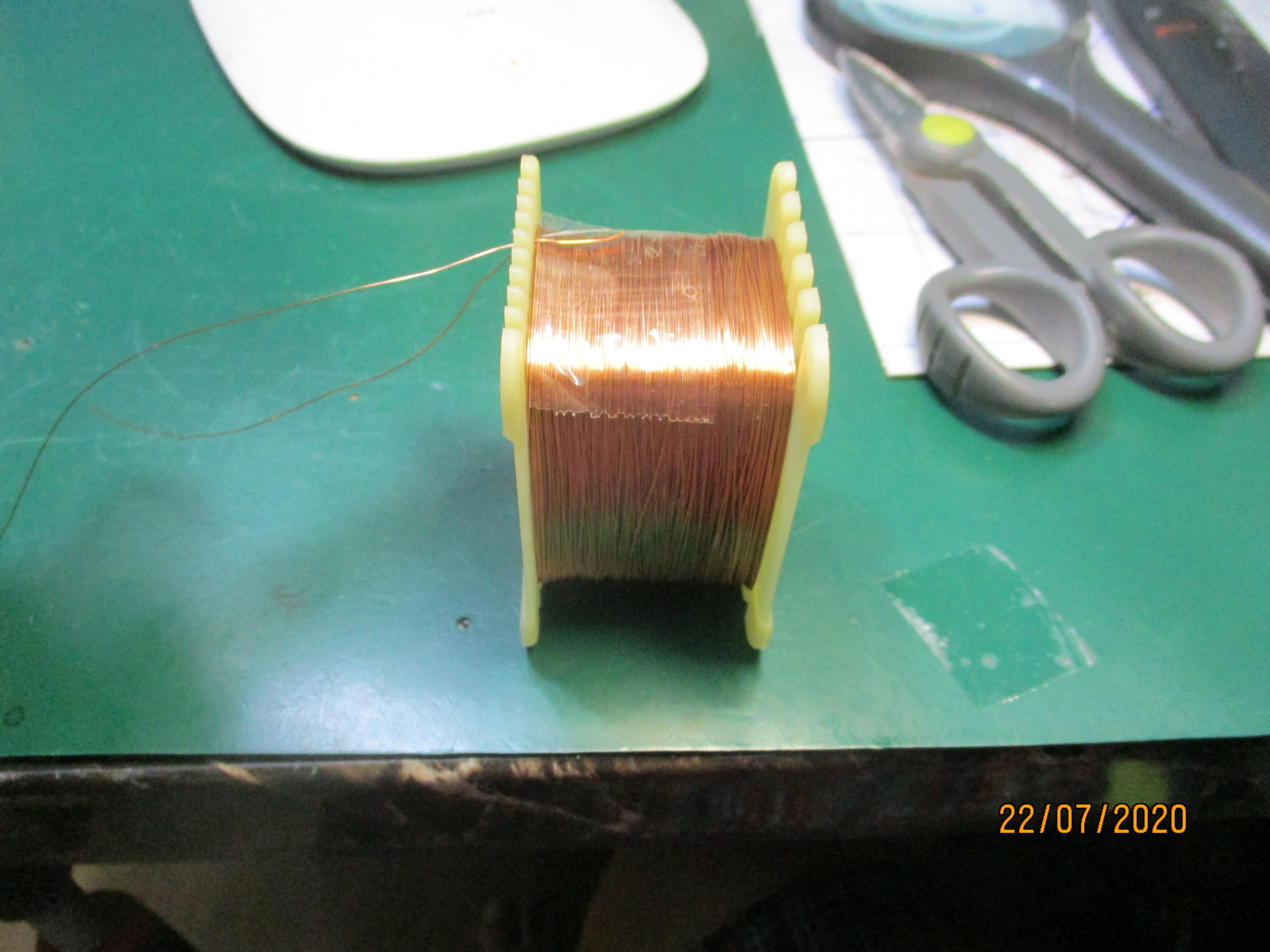

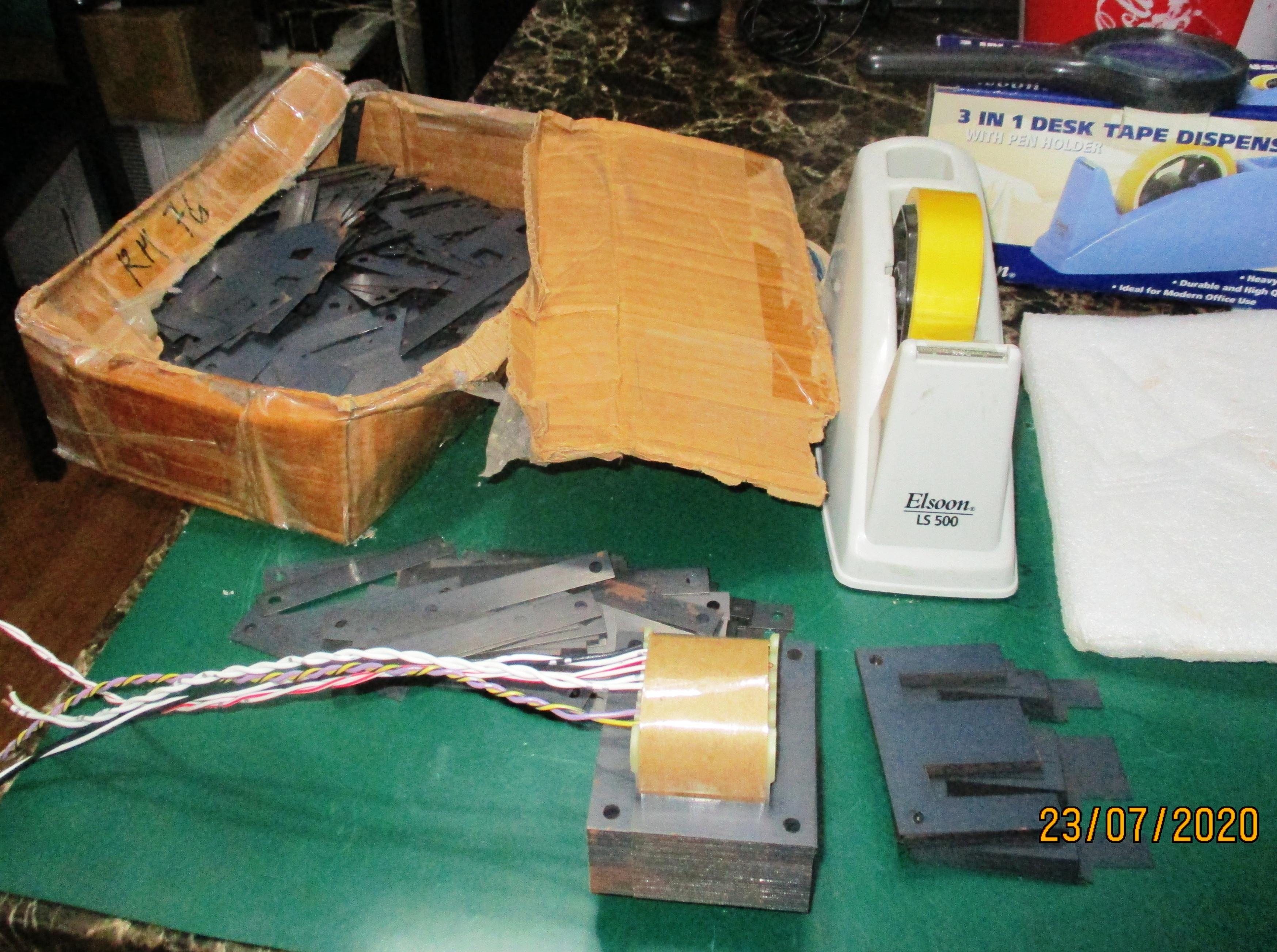

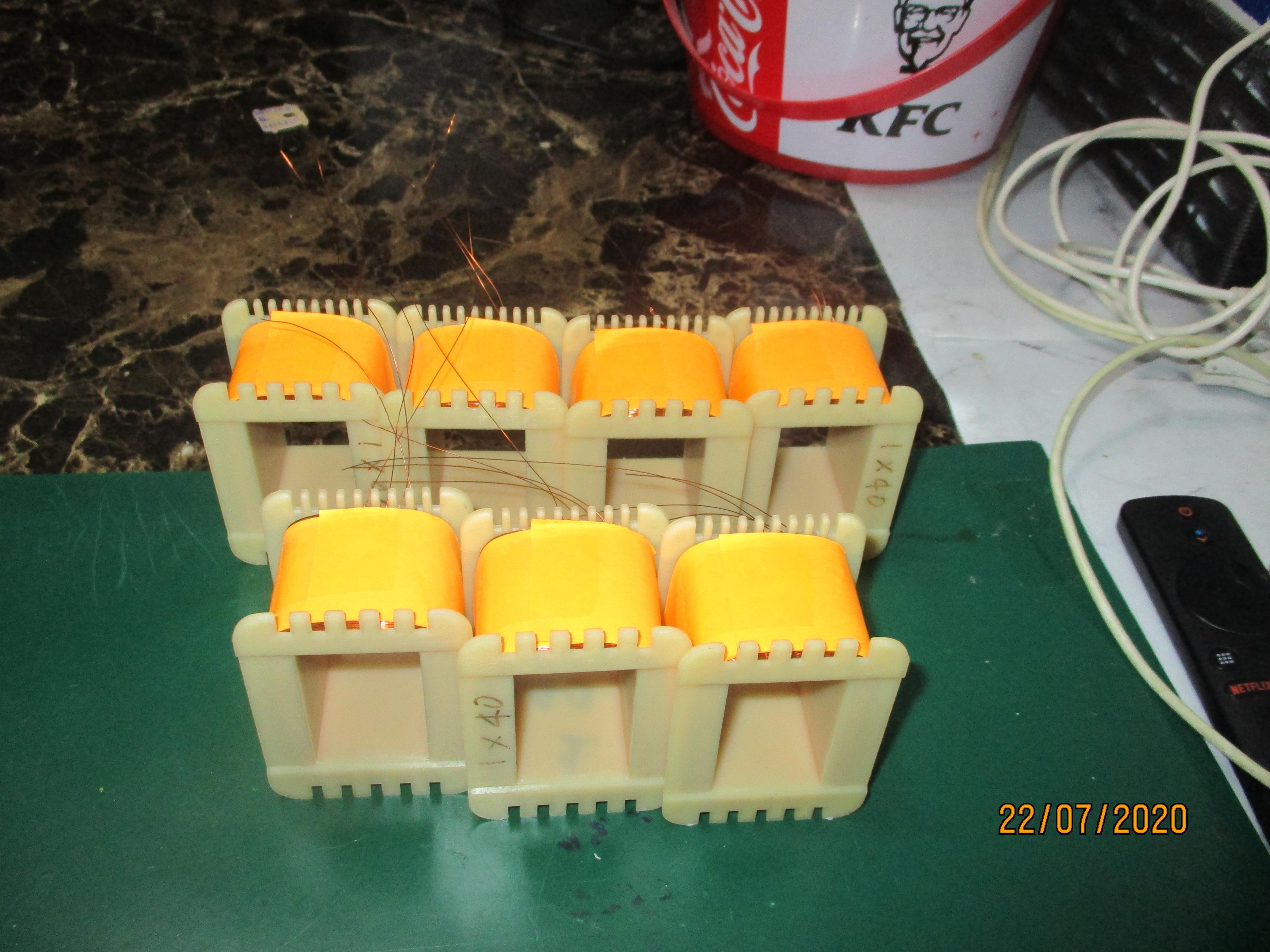

rm18 traffo........for a tube amp......
