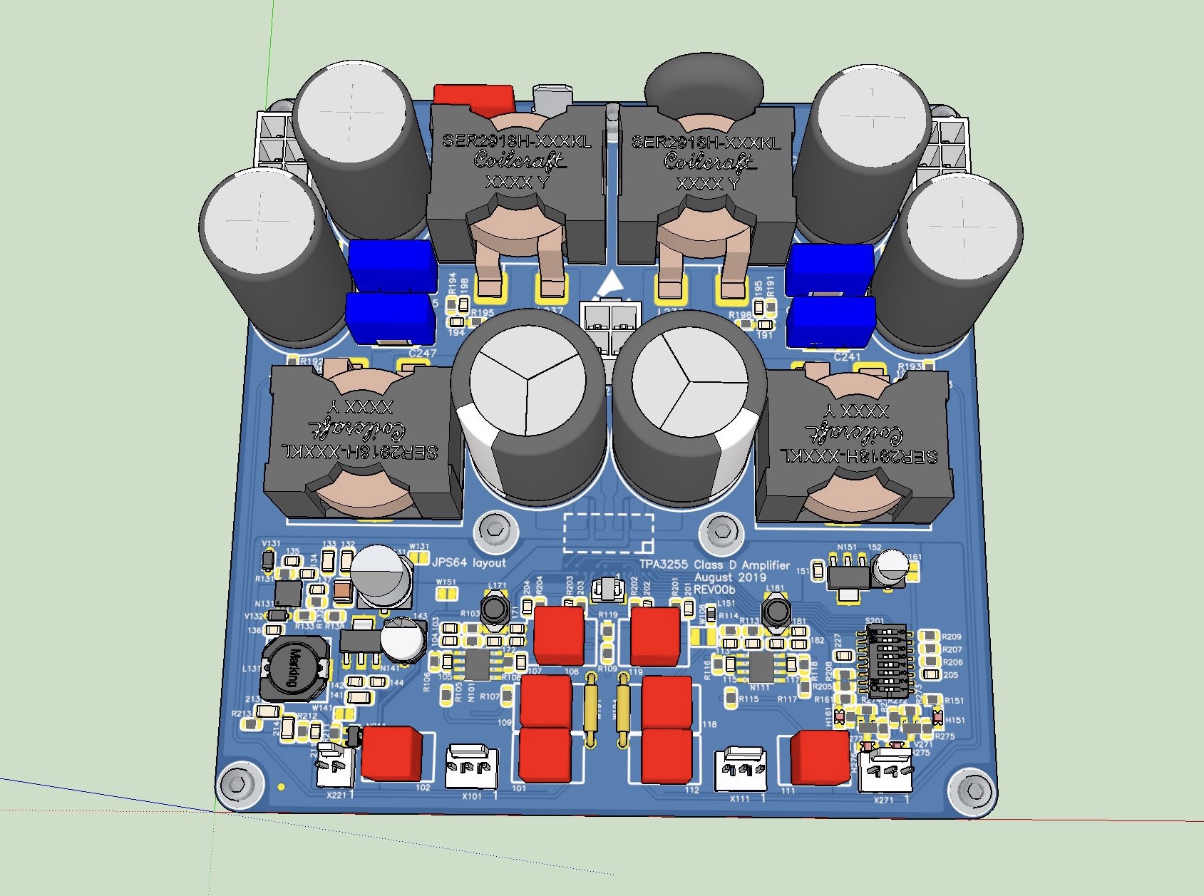

Some more progress from JPS64. We are at 120mm x 120mm x 2mm now.

Hi XRK971
Respect - nice project !!
i am interested , but i am just able to solder SMD but no chip (no hot gun).
maybe an other option - my proposal:
pcb bare
pcb with smd chips (3255, opamp..)
pcb with all smd
complete board
Qeustion:
#post 1 you wrote:

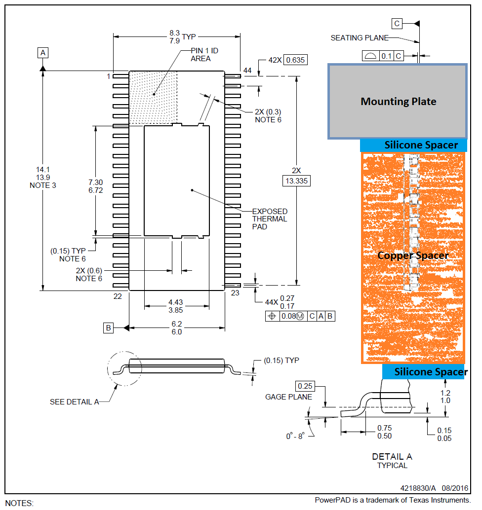

We are also mounting the main TPA3255 chip on the bottom side so that its thermal pad faces down towards the mounting surface. In this way, the board just needs to be mounted to a metal chassis with the usual standoffs and a small thermal conductor block (aluminum or copper) can be used to mount this amp inside a sealed (non-ventilated) chassis, yet still permit adequate cooling.
i am afraid about the exact aligment of this metal plate because of the exact distance of the spacers - otherwise the chip will cracked. how do you handle this?
thanks

Thanks! Good idea about having just TPA3255 and opamps pre-soldered - I’ll see what I can do. I can do a few of them by hand with paste and hot air.
Regarding mounting the heatsink block - use the thick blue silicone thermal pads (circa 1.5mm thick), they have lots of compliance. There are two bolt holes next to the chip, standoffs could be used to make sure it doesn’t compress further than stand-off height.
Founder of XSA-Labs
Joined 2012
According to the datasheet, the thermal "Powerpad" should require no more than a 10mm x 5mm heat transfer area if a thermal conductor were to be used. Something like 20mm x 10mm thick bar stock, cut to say, 10mm sections should work well. The chip itself has 1.2mm height, this plus 10.0mm thick thermal block gives 0.8mm gap for a silicone gasket. Two 0.5mm thick silicone silicone sheets, plus block should give 0.2mm compliance required if using a 12.0mm standoff.

Doing so wouldn't allow to run the 3255 at full power continiously. The silicone spacer most likely do not provide low enough thermal impedance.
Quote from TI support for further calculations:
For the thermal calculation, TPA3251 data sheet gives ThetaJC=0.2 C/W, but if I look at silicon+die attach stack, I get a different number. Mine is a very crude 1D model, so it is very unofficial (don't quote this as a TI number). We really need to do 2-D computer analysis of the total thermal stack for true accuracy. Still, as a napkin calculation you can start with this:
Silicon thickness: 0.4mmSilicon conductivity: 0.117 W/mmK
heat conducting area: ~15mm^2 (assuming mostly from powerFETs)
Silicon: Theta J-DA= 0.23 degC/W
Die attach thickness: 0.05mm
Die Attach conductivity: 0.006 W/mmK
Die attach area ~25 mm^2
Die attach to Case: Theta DA-Case= 0.33 degC/W
Total Theta JC = 0.23+0.33= 0.56 degC/W
Copper heat pad thermal resistance should be negligible, but it needs to help spread the heat from ai internal die attach area of ~25mm^2 to a total external pad area of 48mm^2 (12mm x 4mm). You may wish to use an effective area somewhere between 25 and 48mm^2 to calculate your heat sink grease thermal resistance.
As a bench experiment, to calibrate thermal assumptions we sometimes use the OTW warning to help read the internal die temperature of 125C at different power dissipation levels/heat sink combinations. You also need to know (total power in) - (total power out) to know the dissipation.
The run the 3251 or 3255 at full power cont. the thermal connection needs to be low impedance. (Using no thermal pad together with minimal thermal grease and a milled down/polished thermal sink/heatsink).
This is especially important when using the amp in BTL/PBTL at low frequencies. Just keep in mind, that the effciency is at around 90% at full power. So still 60W of power that needs to be dissipated somewhere. Even when taking crest factor into account, the burst capability is limited by the thermal impedance. So even if your heatsink is capable of dissipating the power, with a high impedance link/interconnection, it won't work.

Doesn't the powerpad require a good electrical connection to the ground plane through the heatsink meaning you can't use a silicon pad between them? Also it looks like the heatsink isn't currently connected to ground at all by the standoffs.
Note T3: Heat sink needs to have a good connection to PCB ground.
Maybe just use a metal block, 1-1.2mm washers to standoff the block with just thermal grease as the interface and in turn mount this to the chassis with an electrical insulator (Else it'll mess up your star ground!).
My other concern is the use of a really handsoldering unfriendly component (N131: LM5010ASD/NOPB) which is then totally surrounded with other components, just looks like a soldering nightmare to me!
The reset supervisor (N211: TPS3802K33DCKR) is also a 0.65mm pitch component! I respect you want to keep closely to the reference design but there must be an alternative that isn't described by TI as an "Ultra-Small" component.
Just seems strange that you have changed all the resistors to 0805 parts minimum then kept these tiny components. The board layout generally looks like it has been designed with a pick and place rather than handsoldering in mind.
Please don't take this as criticism, I'm actually genuinely interested, just want to make sure I can actually assemble this!

Fyrbird,
Thanks for the reminder about heatsink ground. Will see if we can use stand-off bolt then. Regarding parts soldering. This was made with paste solder in mind. You can’t hand solder some of this and paste with hand placed parts is so much easier than solder iron / and neater too. If you don’t have a $40 hot air pencil. Use a $10 hot plate and old skillet. YouTube how to videos abound on this. Check them out. You won’t ever go back to hand soldering with an iron.

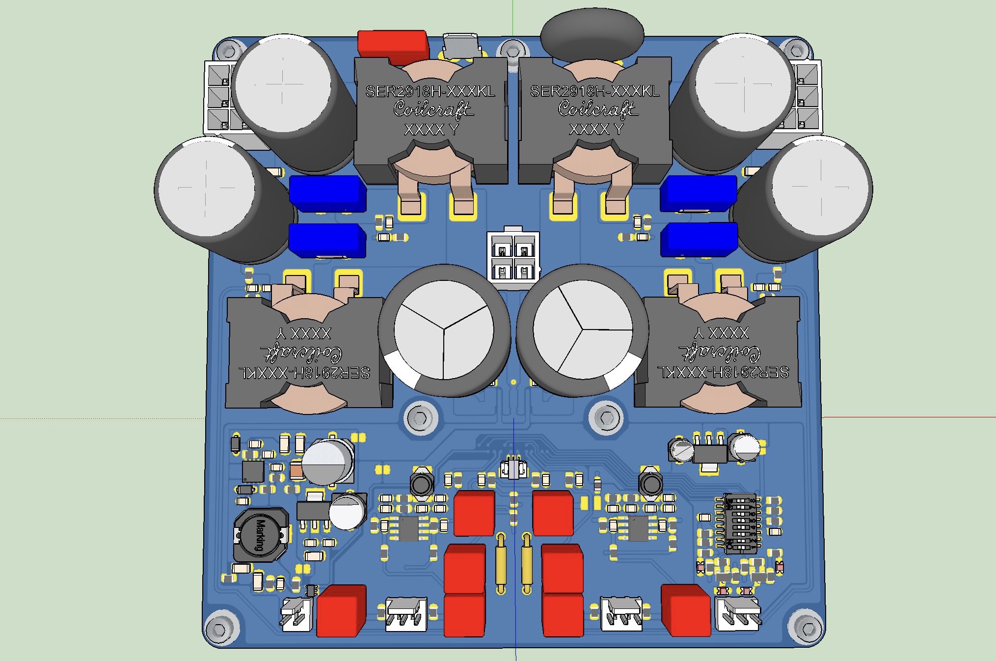

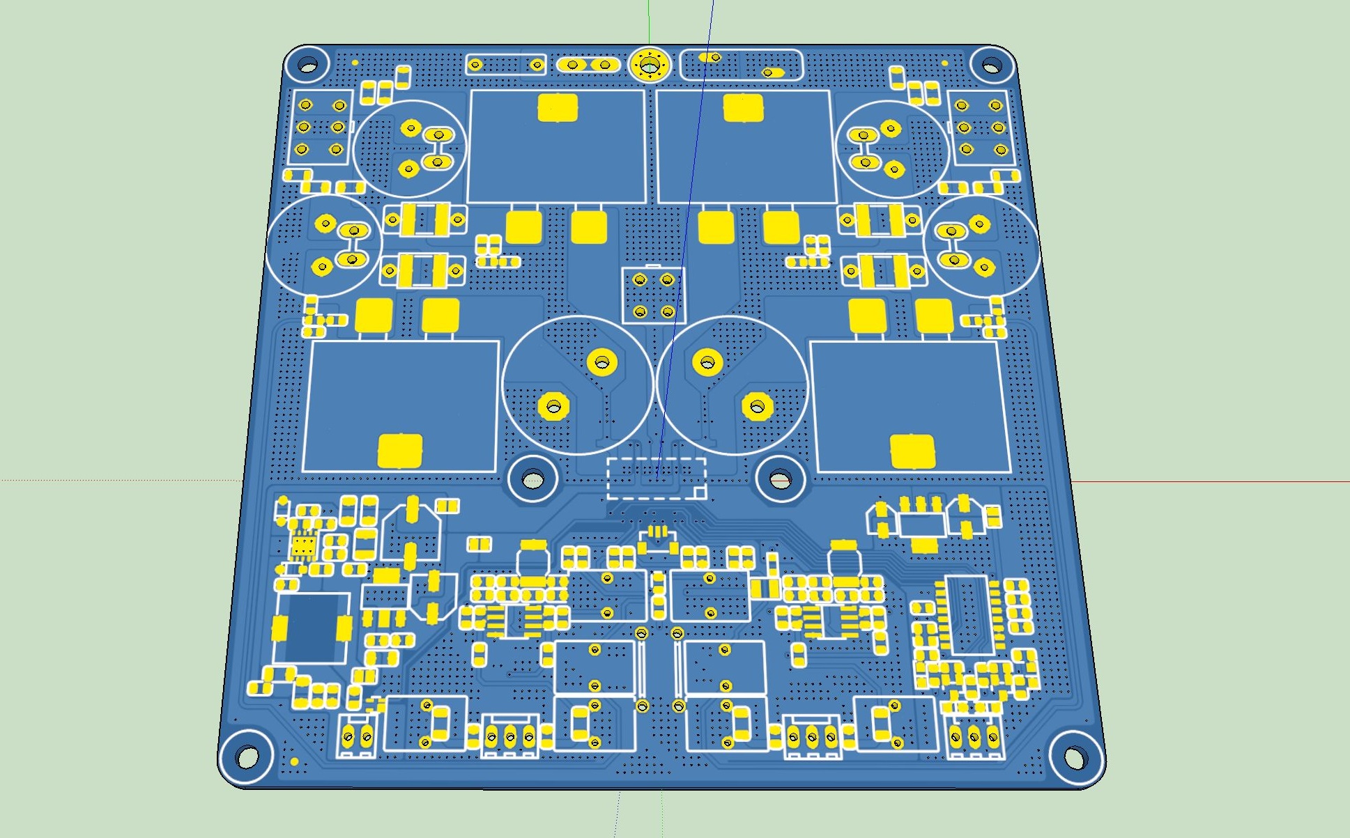

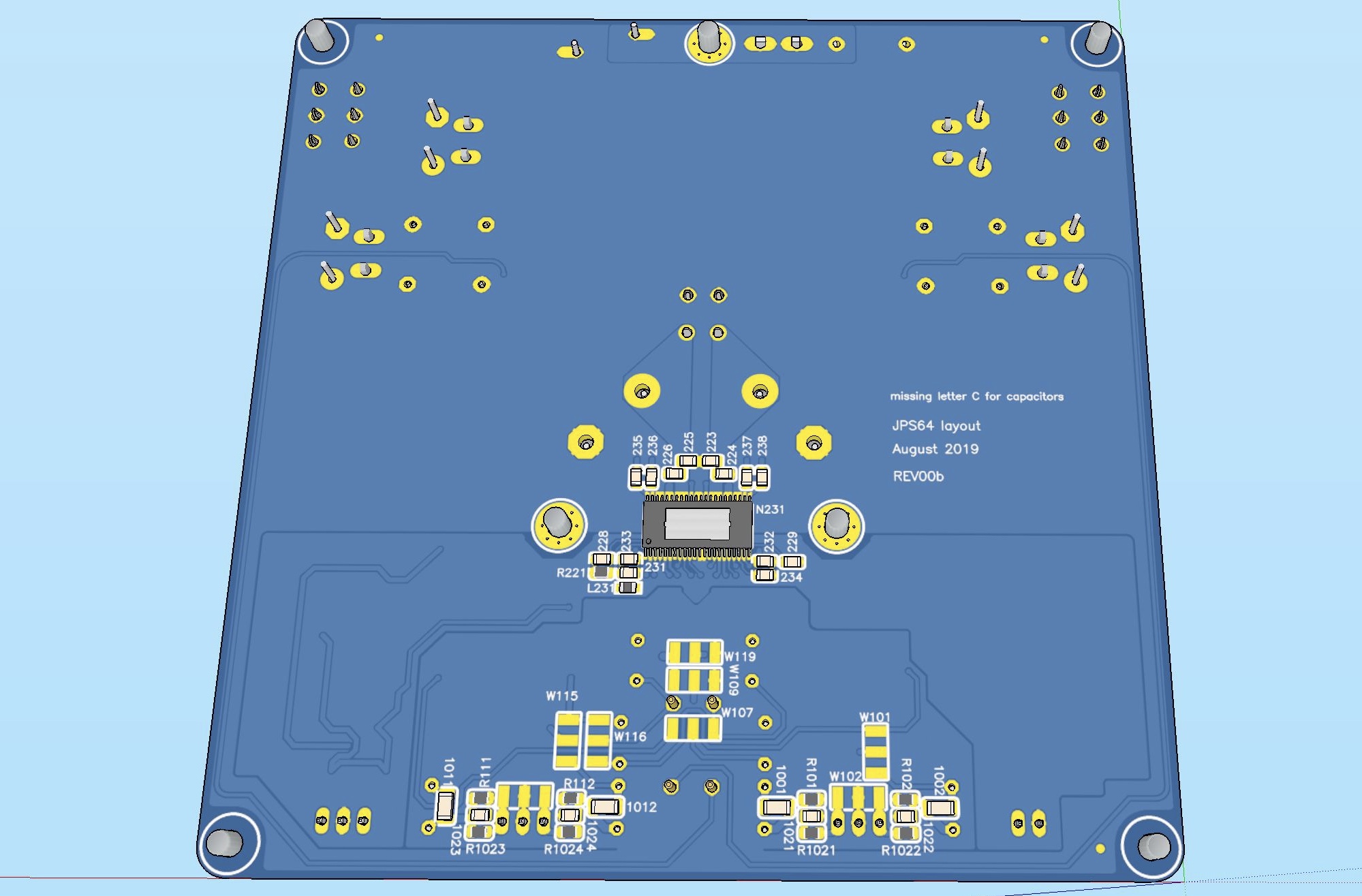

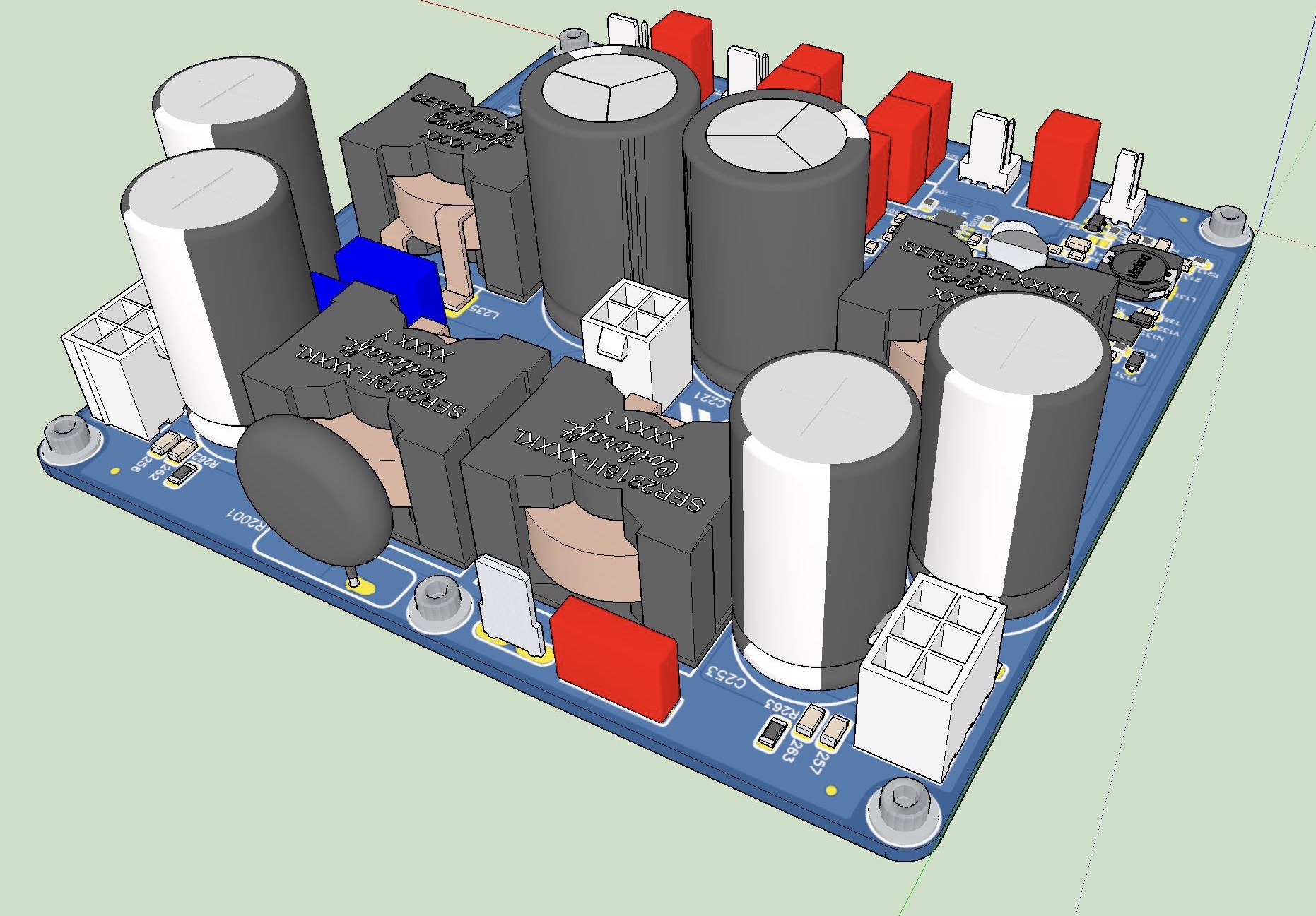

JPS64 just finished all the updates listed below. Thank you to all the folks who gave feedback on the layout and design. I think it’s going to be a killer amp.
Here is a summary of the changes:

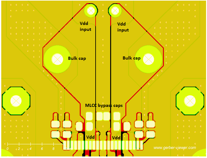

1. Larger low impedance paths for Vdd from power supply input to pins on IC with good connection to bulk caps.
2. Move inductors apart to prevent magnetic cross talk that can increase distortion.
3. Add PFFB option.
4. Add 2k2 and 220pF input RFI filter.
5. Add ground pad on heatsink mounting hole for conductive standoff to ground the heatsink to 0v (but still insulate from chassis ground).
6. Change to MIC8114 shutdown supervisor.
3D renders below along with schematics. Board is 2-layer 120mm x 120mm x 2mm thick with 2oz copper and ENIG.
Thank you to JPS64 for another masterpiece. Truly amazing work for the DIY community!
