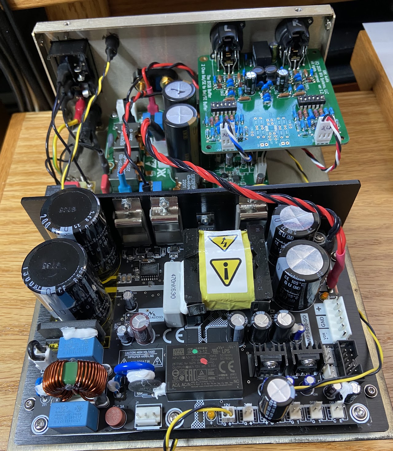

The LM5010 is a known problem and only workaround is to provide an external 15v supply. Many SMPS have auxilary 15v so it’s an easy fix. Just connect it to where the +15v solder bridge is. Add a 2200uF cap to make sure the 15v rail stays up longer than main amp shutdown to prevent turn off thump.
You can see my workaround was to make a connector where the inductor for the LM5010 is. You could use the pads of the inductor and wire jumper from there to 15v solder bridge. Find a suitable ground point.
Basic SOT-223 12v LDO with 1A capability. Really only maybe 100mA is needed.
Look for Input / GND / Output pinout.

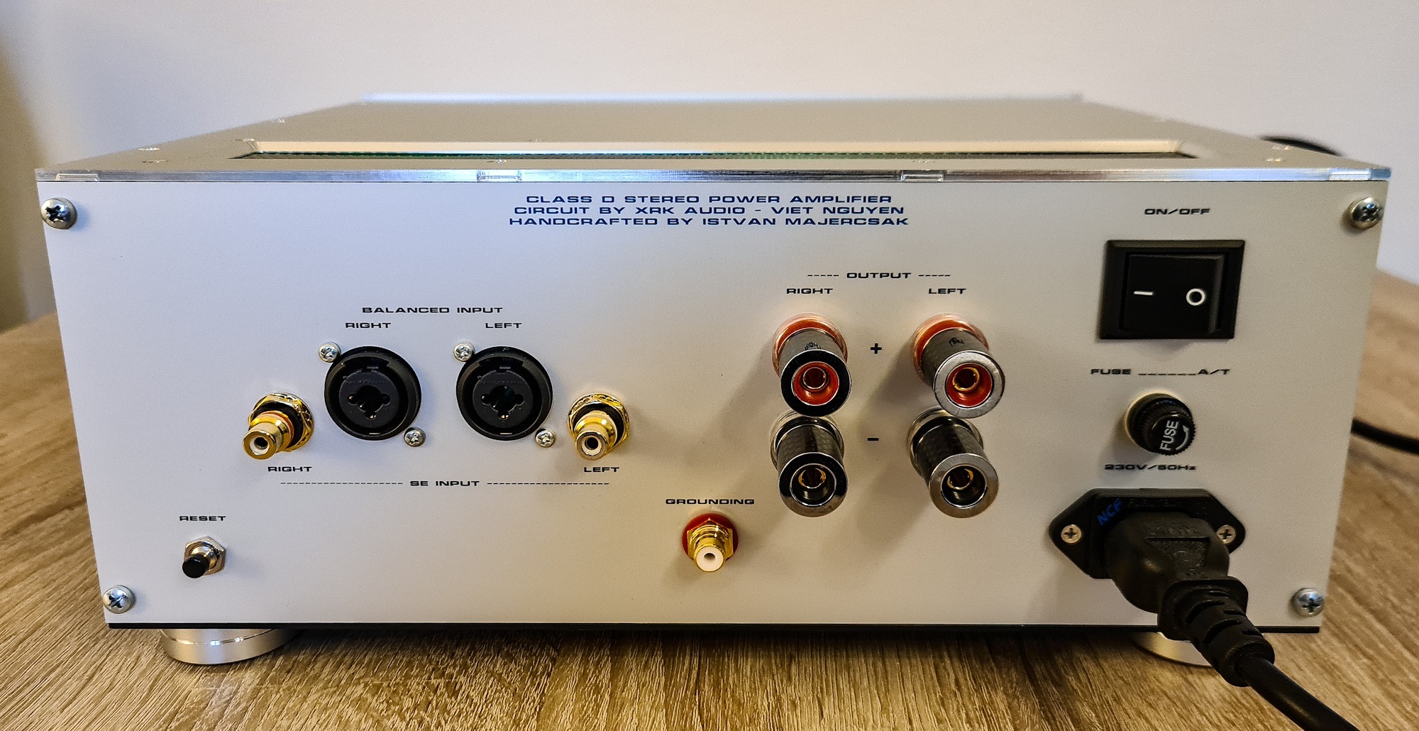

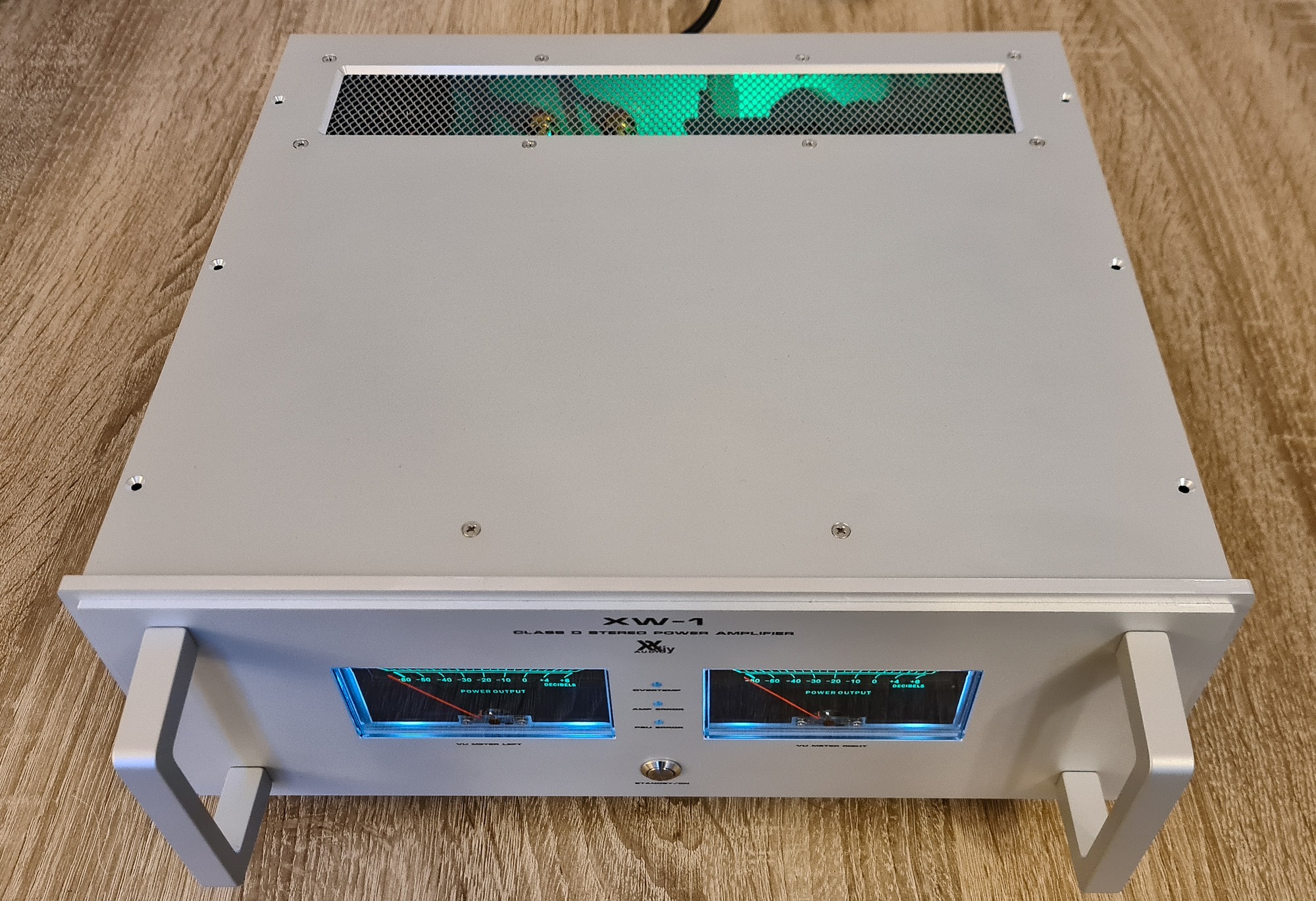

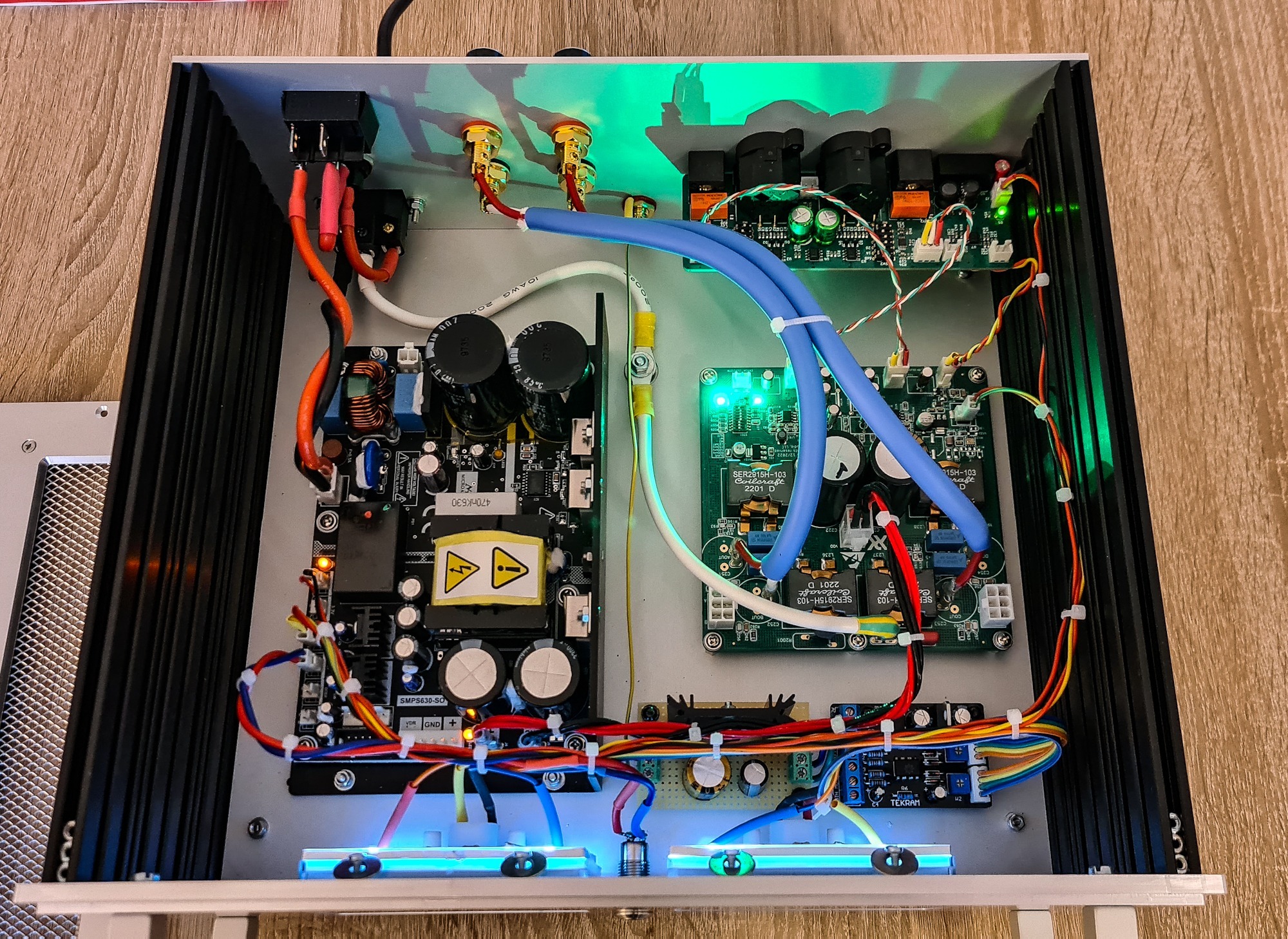

Super build by Mikebarney with detailed write up and build instructions on how to make a complete amp with buffer, PSU and chassis.
https://sites.google.com/site/mpbarney/xrk-tpa3255-amplifier

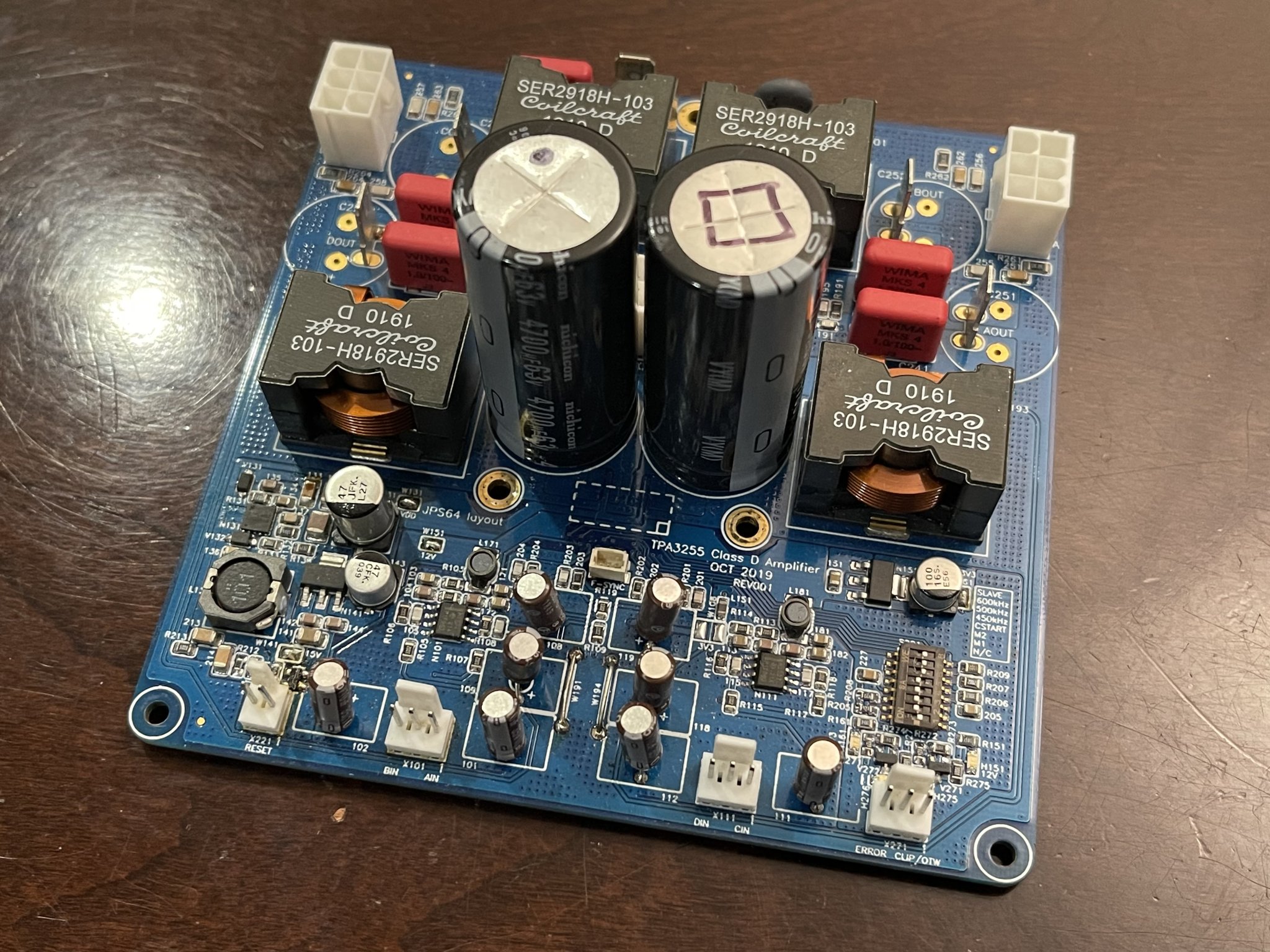

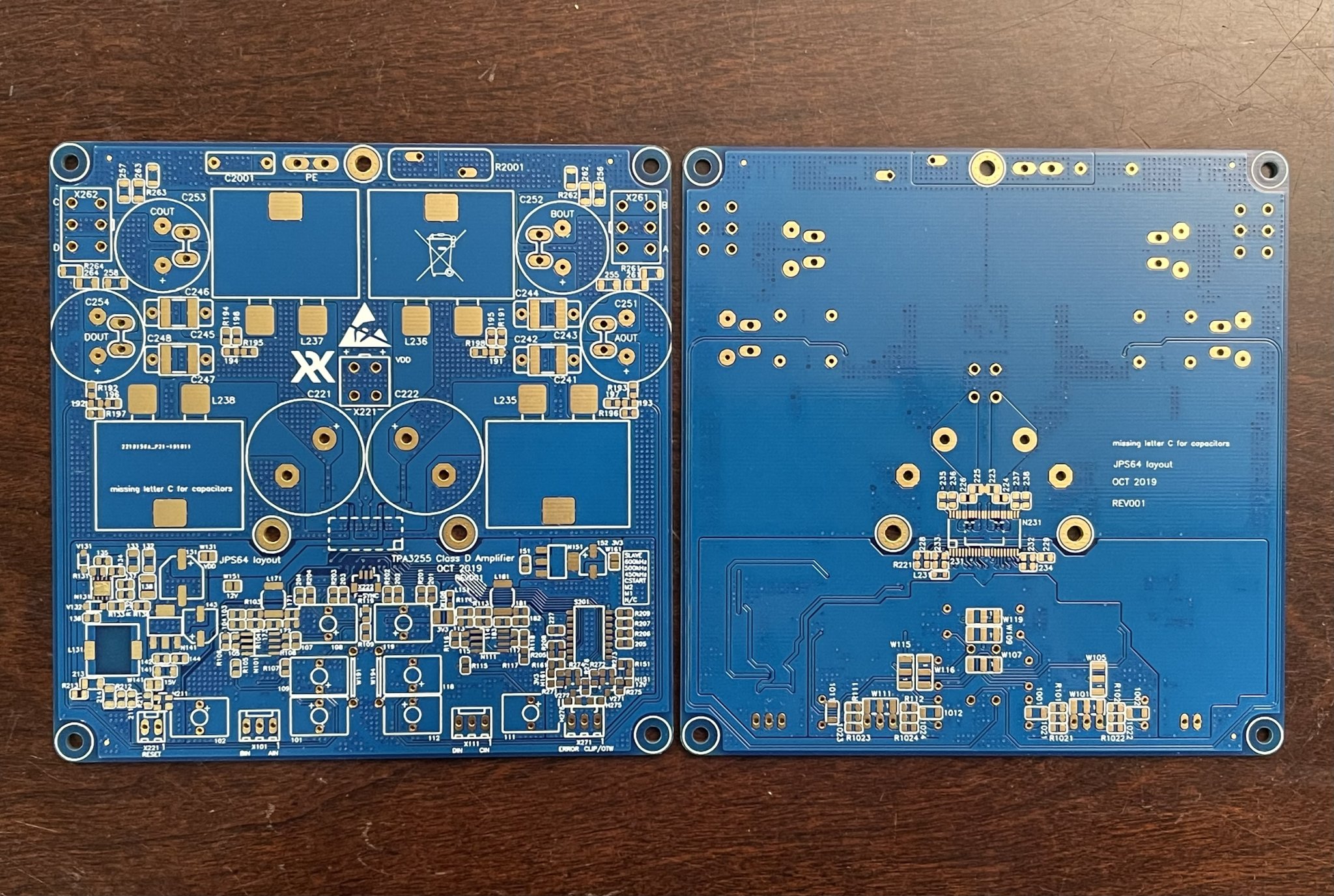

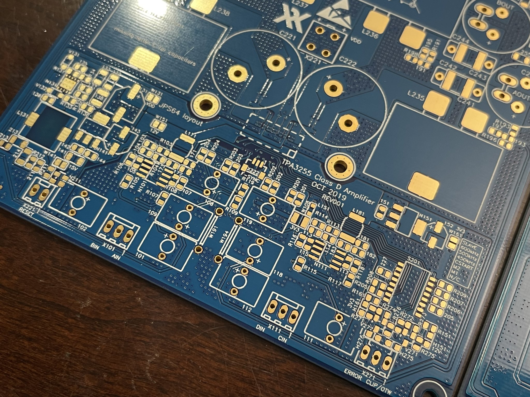

Hi Folks,

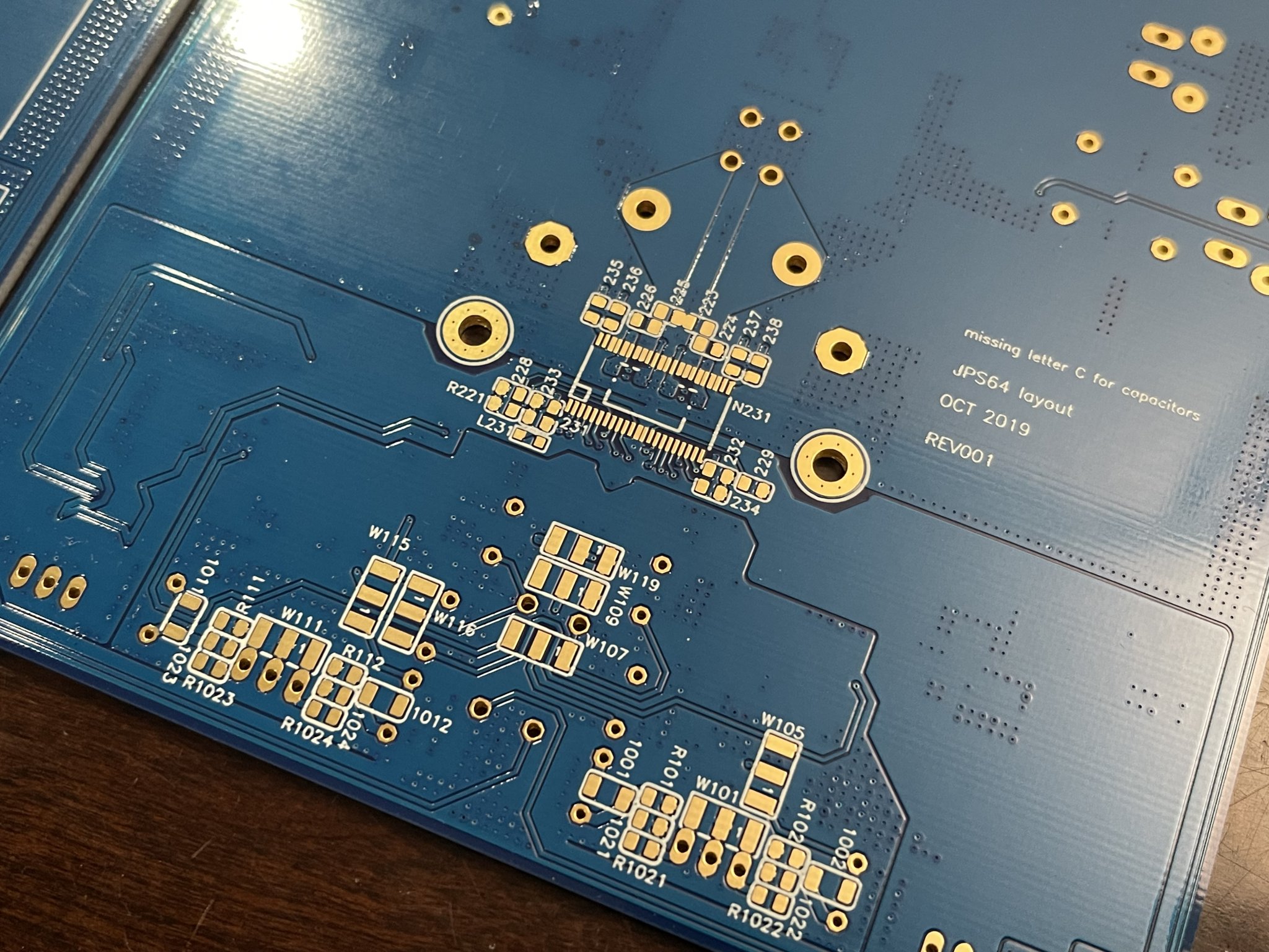

I am re-releasing the non-PFFB version of this amp (Rev001) as a bare PCB. Note that the commercial Warp-1 amp does not employ PFFB either. The sound of no-PFFB amp is superb and distortion is already low enough that I don’t really think it sounds better with PFFB. The DCDC buck converter that was out of stock for a long time is now back in stock, so that makes building this version much more attractive. There are some tricks that this PCB has compared to other TPA3255 implementations out there that still won’t sound as nice. Thick 2oz copper double stitched ultra-low impedance current paths where it matters, unique extra filtering on outputs, a layout that emphasizes low ground loop area, low impedance, and great symmetry.
Blue solder mask, 2mm thick PCB, 2oz copper, ENIG finish. $23ea.
https://xrkaudio.etsy.com/listing/740773357
This is what it looks like fully assembled:
