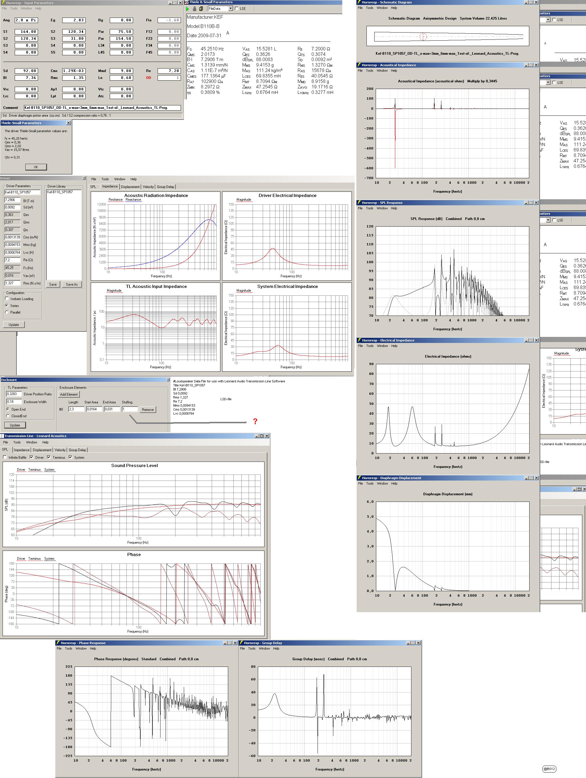

bjorno,
Thanks for the comparison. A couple of things:
I think you may have entered the Start Area and End Area the wrong way round on my software. Start Area is the closed end and End Area is the open end.
Also, what is the length and areas of the HornResp enclosure that you posted the graphs from? I am not used to HornResps input parameters...
As per my previous post, you can now input zero for the stuffing. My stuffing equation is very empirical and so there aren't really any units. But.. 0 is no stuffing, 0.2 is moderate and 1 is alot! It should (and does on mine) make a lot of difference.
Ah, scratch that. I see what happened. You missed a zero out of the End Area so it ended up bigger than the start area.
Try it with 0.0031m² and zero stuffing and the graphs are almost identical to the HornResp ones. Phew! Thats a relief!

The System length is 2.3 m; S1 area= Closed end and S4= the terminus. The driver is at an offset of 75.5 cm counted from S1.
You are right concerning the areas:By a mistake 😱 I entered the wrong value for the End area: I wrote 0.031 m^2 ,should be 0.0031m^2.
When entering the correct area the graphs became very congruent as should do. 😀
Great Program!
IMO, Anyone who want to design a OD-TL (Offset Driver Transmission Line) can IMO with confidence use your program for achieving a good result.
