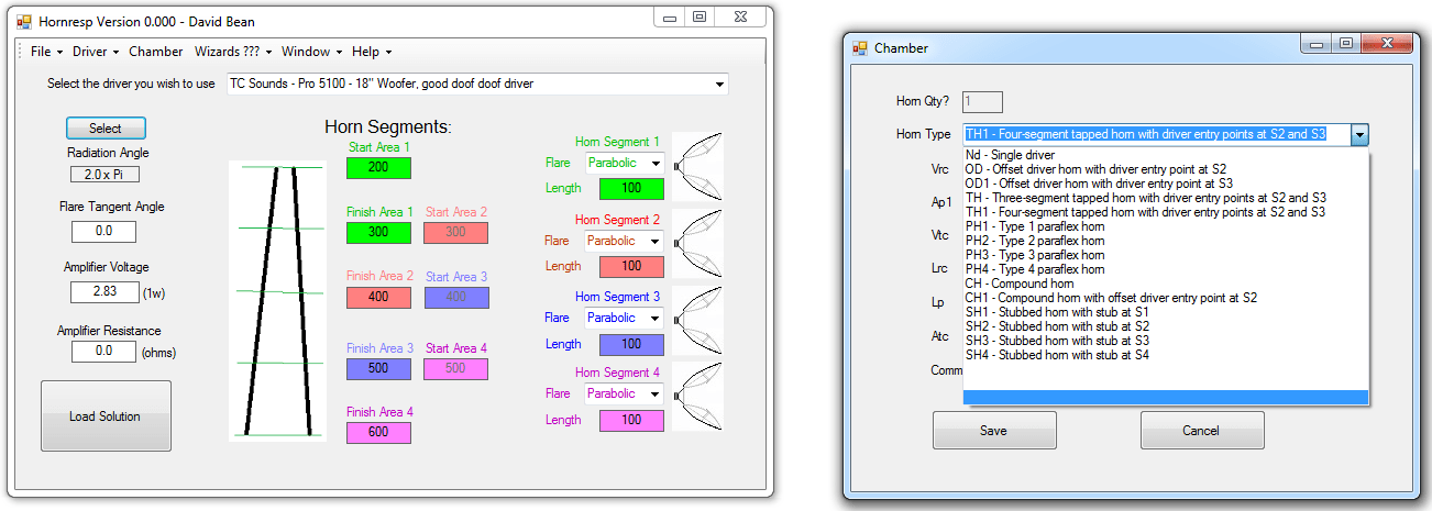

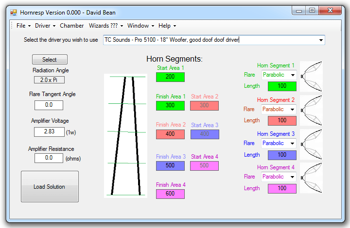

If you would like I could knock up a quick GUI (no code) for you to take a look at and see if it warrants a change. If you decide it doesn't I won't be offended. As a programmer we have to be happy with our own creations, but for me, being a visual person, seeing different options helps me decide what I like and what I don't.
Had nothing better to do so I started mocking up what I might design if I was doing it...

Wow, that's amazing, what you have done in less than a day would take me ages to come up with :).
Just to clarify what for some reason seems to be a very common misunderstanding, the driver parameters you show as Thiele-Small parameters are actually the electro-mechanical parameters of the driver, with only Sd and Re also being T-S parameters.

With regard to the GUI, one key thing that I wanted was for all the main parameters to be on a single window screen, so that they could be seen at a glance whether viewed directly, as a screenprint, or as a hard copy printout (as shown in the attachment).
The main input parameters window layout is divided into four sections, and that is reflected in the Help file descriptions also:
1. Radiation, source and mouth parameters
2. Horn parameters
3. Traditional driver parameters
4. Chamber parameters
Decisions on layout and functionality are only taken after much consideration of all the consequences, with controls being positioned down to the last pixel. Hornresp is now an extremely complex piece of software with many more features than would normally be expected in such a seemingly modest program. The context-sensitive interactions between different parts of the program are very complicated indeed. All these things need to be taken into account when thinking about the user interface. Also, it is not just horn loudspeakers that Hornresp needs to deal with, other system types need to be accommodated as well.
Thanks for going to the trouble of producing the GUI examples, it seems that GUI preferences are a very personal thing with everyone having their own idea of what makes best sense. For example, I would consider things like the Loudspeaker Wizard, etc, to be tools, not input parameters.

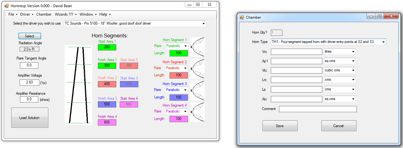

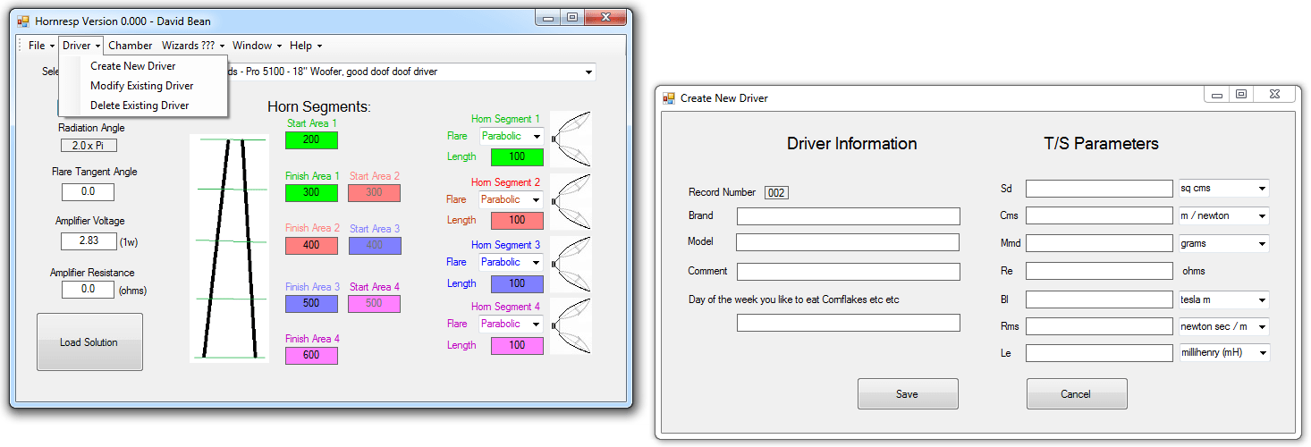

What I put together wasn't anything like a final version, more like a concept. I don't understand what half of the things do. It was an attempt to put what I thought was related in one place to make it flow in a more logical way. I used the descriptions at the bottom that had similar words to group them. At first glance I thought they were all related, but only after dissecting what was on the main page and splitting them up did I discover there were different groups of related items. Obviously there is speaker and box information, but I didn't naturally see four groups of information.
I don't see why you couldn't still produce the exact same report, as long as the information is still contained within the application somewhere it is still possible to correlate it all together.
Sometimes when we allow feature creep to take place we need to go back to the drawing board and see if our initial way of doing things still makes sense. What made perfect sense when it was a limited amount of features, can sometimes lack cohesion once new parts are introduced and needs to be redesigned to incorporate the new features. I don't know how many times I have found myself in this position because I get too excited about starting the project I don't do a proper UML and I add features as I think of them, causing me to redesign the interface over and over.

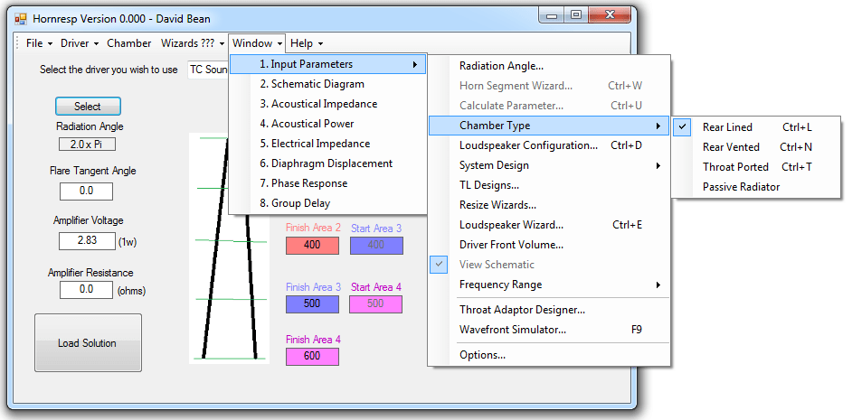

I don't understand the program well enough to be able to 100% know where everything should be, that is why I put a tab Wizards??? in there as it would seem like there should be a tab like that for the input wizard that is under help. Without looking at the code it is hard to say but if there are a number of wizards, perhaps it would be best to put them in one place, as long as it doesn't upset the flow of everything else.
