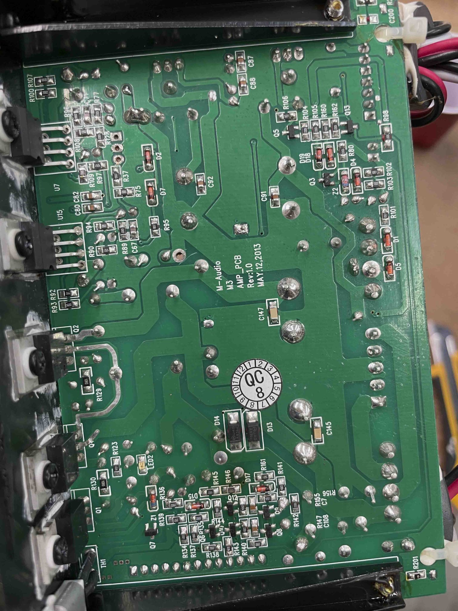

long story short I have a pair of m-audio m3 6's and one of them got smoked, tried taking it to a guy who repairs audio equipment and he said there's nothing he can do without the schematic.

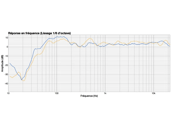

As much as I know you hope this will be enough, I'm sorry it won't. It's the response of the filters we need, not recorded with a mic but directly at the terminals, and separately for each driver.

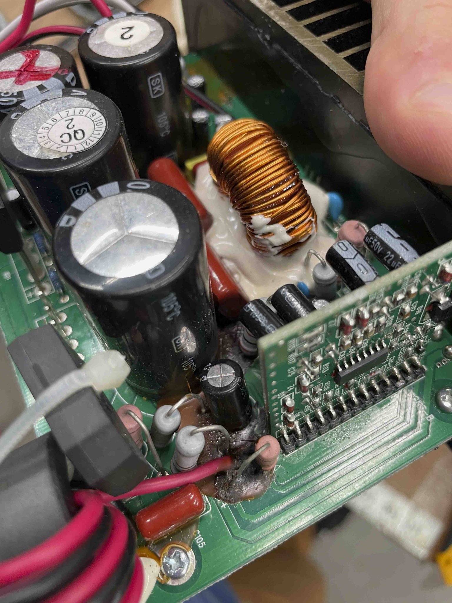

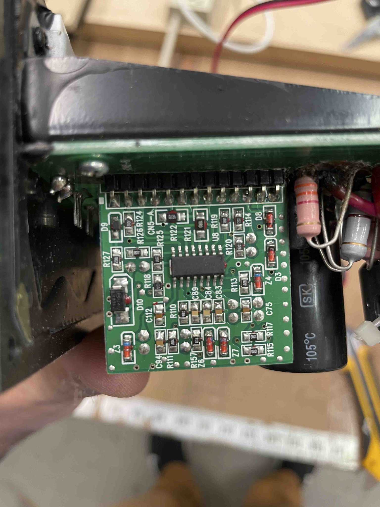

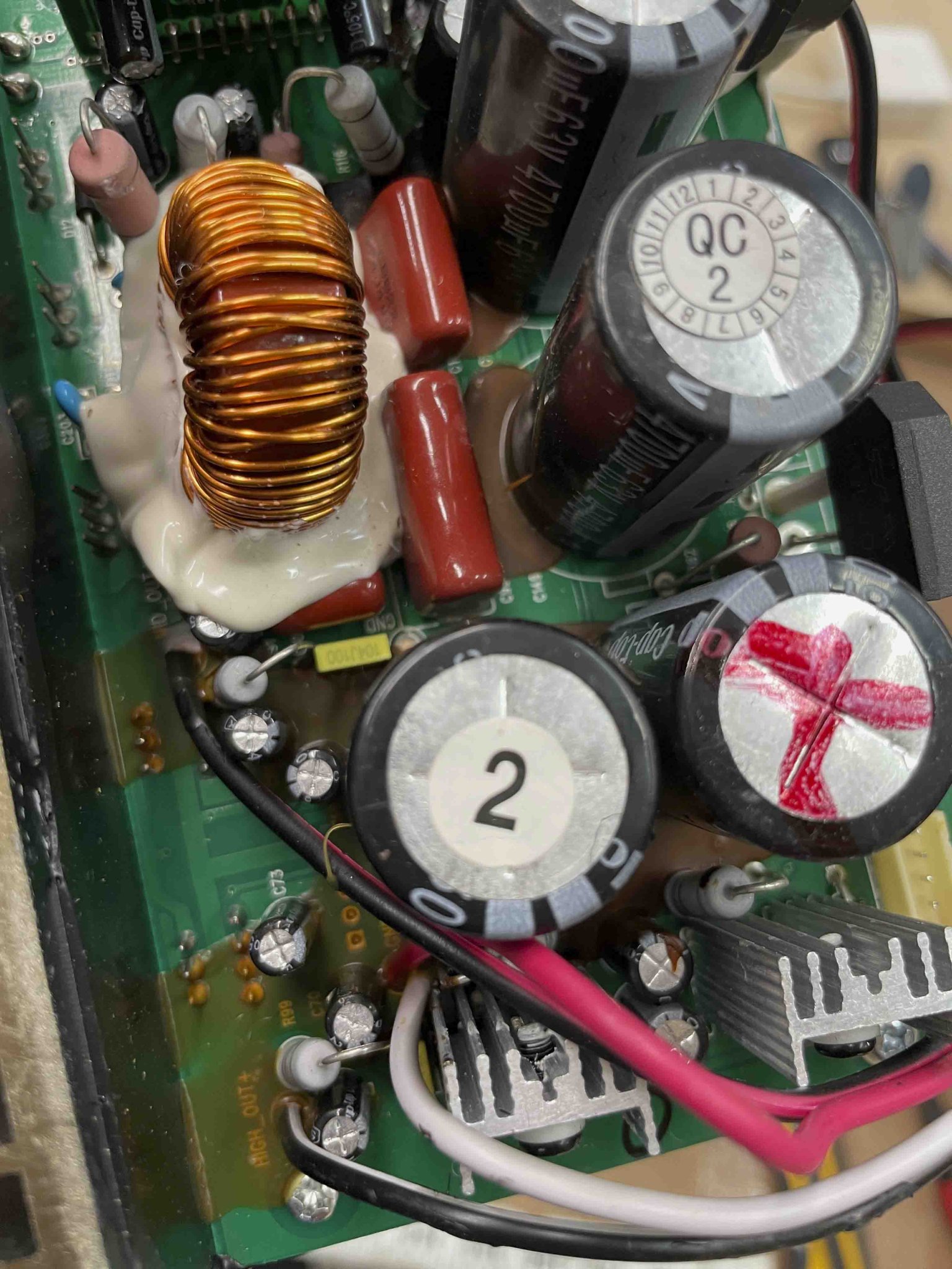

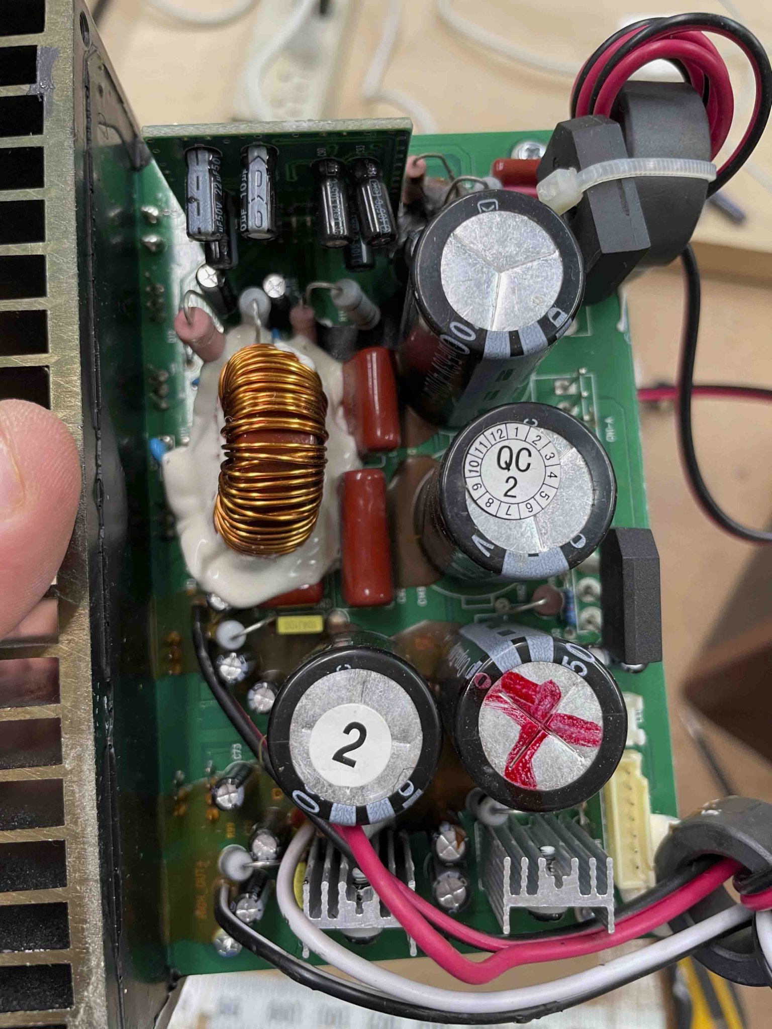

when it was on longer than an hour it would just start buzzing with some audio coming threw.
there is one resistor that looks chared at the board

If it's still acting this way, then perhaps you can determine if something's getting hot in there?when it was on longer than an hour it would just start buzzing with some audio coming threw.
