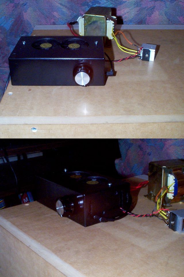

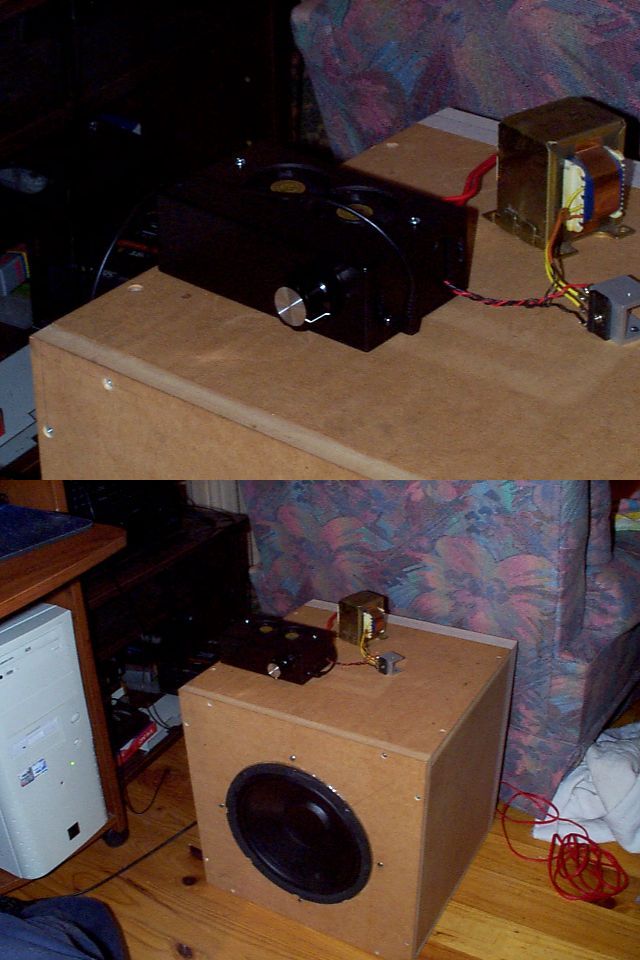

A few more pictures of my "Ugly lookin' amp" and the subwoofer that I may or may not drive with it... lol
The volume control is backwards (lol) and the fans blow air into the case, should they perhaps suck it out? lol As you can see, the powersupply is external.. LOL and there are a few too many holes in the case LOL... Total cost was nothing.... I already had all the parts that I bought for other projects, or that were recycled..
Hanzwillem said:did you really put the fans in series? not parrallel?
either way...this is good audiophile construcion
Series.... cos I am using +-24volt rails
This is bad audiophile construction.. :S lol

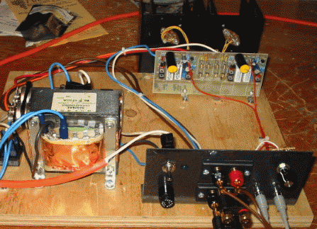

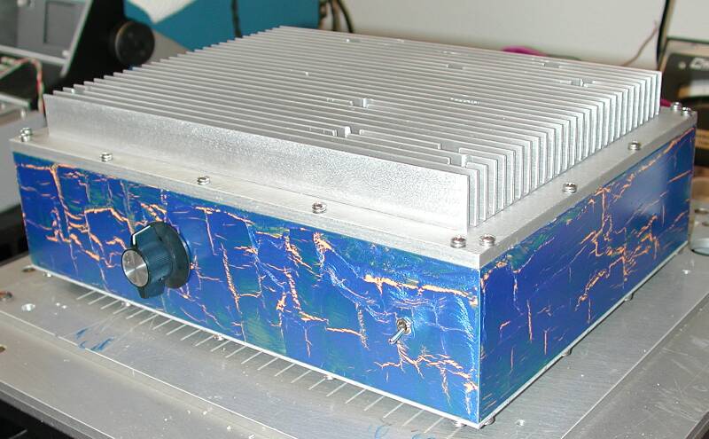

Here's my ugly amp, built into a box I picked up at a local scrap yard. The box is from a cellular phone base station diversity antenna amplifier (I think). It is 13" x 5" x 10". The walls and the base of the heat sink are 1/4" thick. The fins are about 1" high by 11.5" long.
I was able to use some of the existing holes in the box to mount the line cord socket, the fuse holder, and the input jacks. I filled the remaining holes with bondo, then drilled a few holes of my own for the power switch, volume control, and output jacks.
The nice thing about this box, besides the good size, massive amount of heatsinking, and ultra low price ($15) is that the walls are a separate piece from the top and bottom covers. To build the amp, I mounted everything on the heatsink (top cover), wired it up, tested it, then simply wired the connectors that were mounted on the walls.

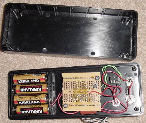

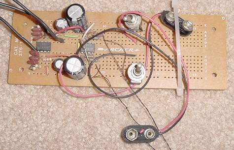

I made two versions of the amp, one on perf board and one with the parts just flying all over the place. I don't like either and will replace them with a PCB, possibly a four channel one. I used a single point ground for the entire amp, and I mean EVERY ground connection goes to that point. There is no hum or noise of any detectable amount coming from either channel. I used the non inverting schematic on the front page of the LM3886 data sheet and added a parallel R and L to the output to prevent oscillation with capacitive loads (such as my electrostatic speakers). It works great! DC offset is about 600 uV in one channel and about 1 mV in the other. I did not use any blocking caps at the input.
I used a 320 VA, dual 18V power transformer that I picked up at Tanner Electronics for $25. I would have used a higher voltage for more power but this is what was available. Note- I chose the path of heresy (convention?) and used 54,000 uF per side of the power supply. The ICs are bypassed at the leads with 470 uF electrolytics and 220nF ceramic caps. It's strange , but I don't have any "weakness" in the bass.
The walls are finished with primer, followed by a base coat of tangerine orange acrylic paint, followed by a coating of crackle medium, followed by a coat of metallic blue acrylic, and finally acrylic clear coat. This was practice for an antique horn speaker that I intend to refinish to match my 1927 Neutrowound Super 6 radio.
I made a shaft extension for the volume pot out of a piece of 1/4" OD brass tubing from Lowes and a short piece of urethane air hose, slit and tie wrapped to the two shafts. It has just enough give to prevent side loading the shaft of the pot which would decrease its life considerably. It also gives a nice soft feel to the detented rotation. It absolutely does not slip. I used an ugly knob I had laying around, but I will look for a little nicer one when I get the chance.
I used politically incorrect sticky rubber feet on the bottom of the box, and equally non PC, non gold-plated bananna jacks for the speaker connections.

- UGLY Looking Amp! - but good working
