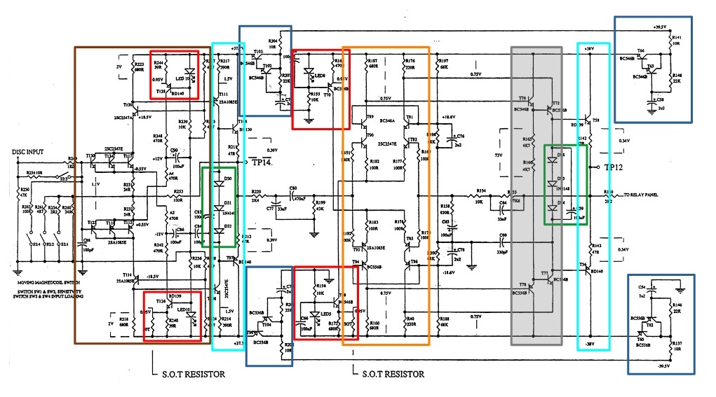

I am challenging myself at understanding my integrated amp's MM/MC phono stage so I can service it if needed and also make a DIY clone. It is a somewhat complex design and as a hobbyist I'm out of my league. The circuit looks a bit like an op-amp built out of discrete parts, so I have taken the typical op-amp block diagram as an inspiration and color-coded the sub-circuits I think I recognize but I'm not certain of anything except the constant-current sources and sinks as I recognize their LED voltage references.
The amp is a Rega Elicit mk. I; it is a very nice sounding amp overall and the phono stage is superb. Sorry for the poor image quality, the amp is almost 35 years old and all I have are those scans of the schematics (They're not even of the right board revision but are close enough). Image taken out of Hi-Fi Engine Library : https://www.hifiengine.com/hfe_downloads/index.php?rega/rega_elicit_schematics.pdf
Below is the block outline color legend:
  • Blue: Darlington pair emitter follower current buffers
  • Red: Constant current sources and sinks
  • Brown: Cascode differential input stage ( Emitter follower feeding common base, current sources and sinks for bias)
  • Green: Level shifter
  • Cyan: Class AB output stages
  • Orange: Long-tail pair diffential amplifiers with constant current sources and current mirror active loads performing single-ended to push-pull conversion
  • Gray: Unknown configuration...
I would appreciate any help in correctly identifying the sections and type of the building blocks so I can study each sub-circuit in depth. I am in the process of porting the schematic into LTSpice but I see no point in trying to analyse a simulation if I don't understand the basics first.
I am also not 100% sure how is the RIAA equalization performed. R220 (2k4) and C77 (33nF) do look like a low-pass filter and the time constant is very close to the 75uS pole. R155 (97k6) and C64 (33nF) looks like the 3180uS pole, while R154 (10k) and C64 (33nF) looks like the 318uS pole, combined and fed as NFB to the second differential amplifier as an active filter?
Every piece of information will help me resolve this puzzle. Many thanks in advance.
Joris
Your analysis is accurate.
The pre-amp is comprised of two cascaded discrete transistor op-amps. It was designed when fully complementary transistor amplifiers were in vogue.
The op-amps use cascode stages because the supply voltages are high.
The brown box is an op-amp that provides voltage gain.
The 75uS pole uses passive equalization on the op-amp's output. There is one DC blocking capacitor.
The 3180uS pole uses active equalization in the second op-amp's feedback loop. There is a DC feedback capacitor.
The gray stage is a level shifter followed by a voltage amplifier.
The cyan stages are biased high enough to remain in class A.
This is a no-holds-barred design. The only faults I can see are the series resistors on the input, and the cyan stages could have been class A only. The high voltage is a brute-force approach to getting headroom (reduced by the series resistor in the 75uS EQ).
BTW, this is the first phono pre-amp I have seen that uses more transistors than mine. ;)
Ed

The dark blue things are meant to filter off ripple on the supplies: RC low-pass filters followed by voltage followers.
A weak point of the design is its equivalent input noise current when you use it with moving-magnet cartridges. It should work fine with moving coil, but for a 500 mH moving-magnet cartridge, the total collector bias current of the input stage is about 100 times the optimal value for minimum noise.
Thanks Ed for a very complete reply! Yes the voltage is quite high and I find there is some power wastage in there. The stage is built to use the same regulated supply as the rest of the amp, but I intend to build my DIY clone to work with a lower voltage supply - something like +/- 24V or even down to +/-15V if I can while maintaining enough headroom for the passive eq loss. That is why I need to fully understand the design if I'm to tweak it. I believe the cascode implementation is a keeper though as it has advantages in terms of high input impedance and isolation?
[...] The only faults I can see are the series resistors on the input, and the cyan stages could have been class A only.
I'll investigate the design of a class A-only stage, if I'm not mistaken one needs to have a higher bias and this can be achieved with the so-called Vbe multiplier or "rubber diode" circuit instead of the three diodes in series?
What value of input resistor would you suggest? I'm guessing it is the 1K you would lower, as the 10R is already quite low?
Actually I am a bit discouraged at the number of TO-92's I'll need to solder in my DIY implementation :eek: I'll probably replace the discrete darlingtons with integrated ones to try and reduce the parts count a bit, However if voltage headroom is tight I might have to revert to a discrete "Sziklai pair" to save a Vbe drop on each rail... The 10R feed resistor could be reduced as well I think.
Interesting! What value of collector current would be a good compromise between MM and MC performance? I'll integrate this mod in my design, as it is basically merely a change in resistor values. Can you provide links to some reference texts regarding the relation of collector current and cartridge? Thanks in advance.
No selectable input capacitance either, so wide-open to RFI.
This is another tweak I can easily integrate in a DIY build, and I already had this in mind. Have to check some implemenatations, if you have pointers that would be greatly appreciated. Off the top of my head I guess that's probably just a 3-position dual pole switch hooked to some polystyrene caps.

The cascode has multiple benefits including input shielding and elimination of the Miller effect.
My pre-amplifier uses only class A stages. Class AB is a vestige of IC op-amps. Biasing it into class A eliminates the crossover notch but leaves the components. You should not change this unless you are capable of designing an op-amp.
I can't make out "K" versus "Ω" on the scan. The input should not have series resistors.

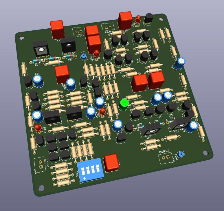

I have finished drawing the schematic in KiCAD and tried a tentative layout to see if I could cram the design on a 10x10cm PCB so it can be had cheaply as a prototype board from JLCPCB and the like. Man that's a lot of transistors - 38 count for a single channel without power supply. There is ample space around the caps to account for size variations of actual parts when I source them, but looks like I can also fit a few more small caps and a DIP switch for capacitive loading choice too.
The clone is needed as a backup for my main amp as the old thing needs to have its electrolytics replaced; but with the tweaks we are talking about I believe it will be a potent preamp in its own right. It will also serve as a platform to safely test component upgrades before porting them to the Elicit.
Now back to LTSpice for simulations and study. I also have to figure out what's the best PCB stack-up for low noise. I have currently opted for a single top-side ground plane.
Thanks again,
Joris

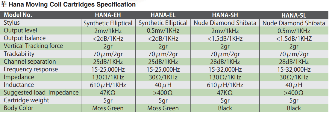

According to https://www.denon.com/en-us/product/turntables/dl-110/136623.html your Denon DL-110 high-output MC cartridge has a nominal impedance of 160 ohm. If that is at 1 kHz, the inductance must be less than 25.5 mH. The optimum for this specific cartridge must then be somewhere between 1 mA and 4 mA for the sum of the collector currents of the six input transistors - 1 mA if it is mainly inductive at 1 kHz, 4 mA if it is mainly resistive at 1 kHz.
A very nice design. The input stage aims for lower noise while the second stage aims for lower distortion. They are basically the same amplifier with different goals in mind. The input stage employs masking and some how mimicks a jfet, you should probably have a switchable input stage between bjt masking and jfet masking and see which you prefer in AB testing. However just as it is its a superb phono stage. No need to match the input parrallel input transistors, the purpose is to assist them correct each other so they essentially should have different characteristics.
500 mH is pretty normal for MM; some are around 200 mH, some 450 mH, some 700 mH.
......If that is at 1 kHz, the inductance must be less than 25.5 mH. The optimum for this specific cartridge must then be somewhere between 1 mA and 4 mA for the sum of the collector currents of the six input transistors - 1 mA if it is mainly inductive at 1 kHz, 4 mA if it is mainly resistive at 1 kHz.....
When searching the net, I found that most manufacturers seem to specify impedance at 1K without stating resistive and inductive components.
The exception seem to be Hana, specifying total impedance and inductance. Assuming that the inductance value of 0,61mH is typical of HOMC pickups it seems the higher current value is the one to go for.
