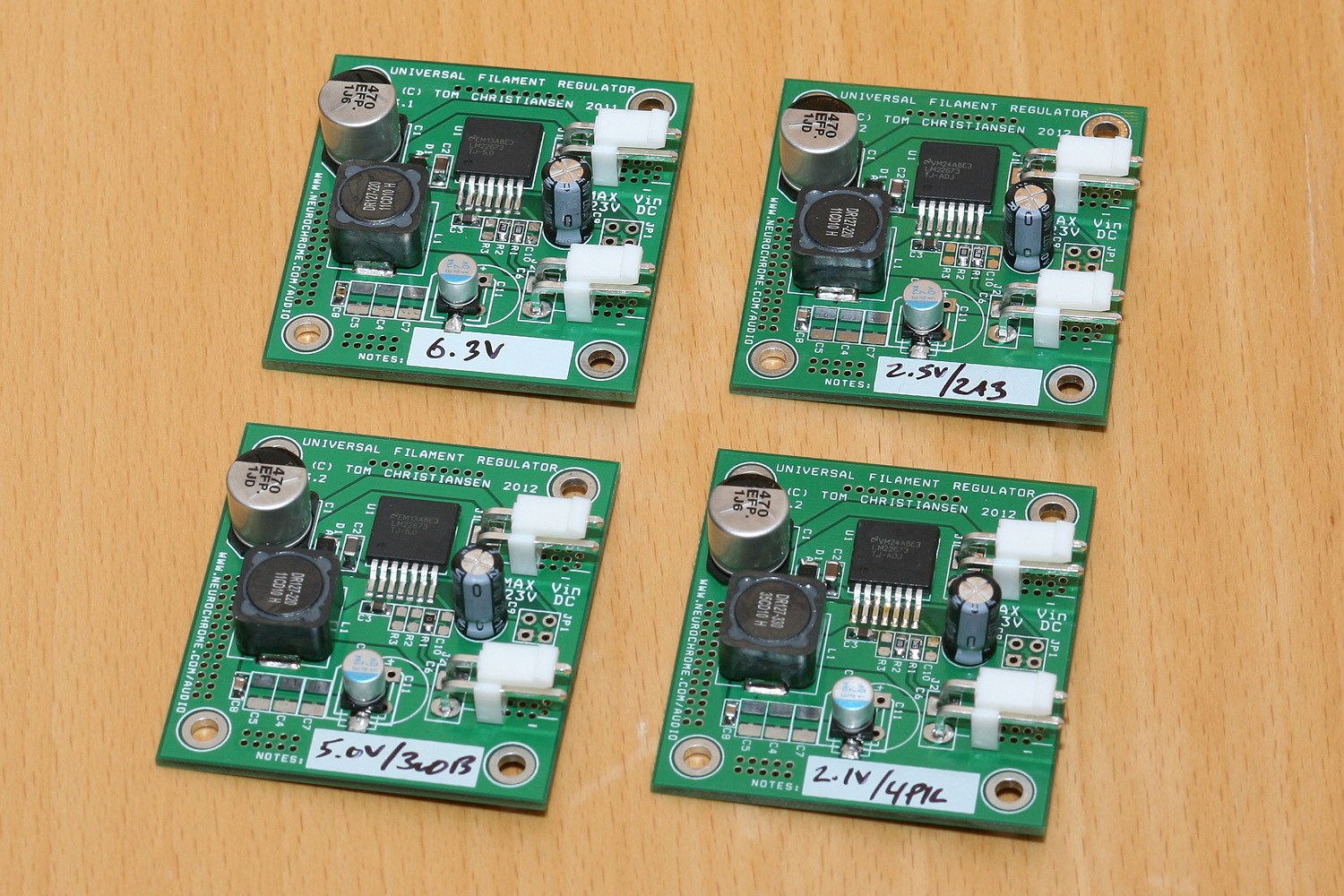

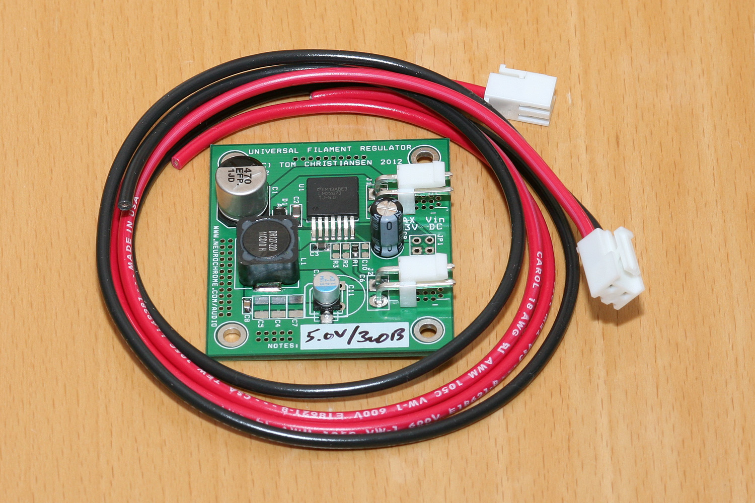

I have decided to make fully assembled and tested Universal Filament Regulator Modules available for purchase. This should help out those who prefer to not deal with the soldering of SMD components.
I maintain a small stock of components for the most commonly used tube types: 2A3, 300B, 26, 4P1L, 801A, and various 6.3 V tubes. I'll add a few others to the list as I complete those options. I'm open to custom configurations as well.
The modules are assembled by hand and tested before they're shipped.
You can find the assembled modules on my website: Neurochrome.com : : Audio : Universal Filament Regulator

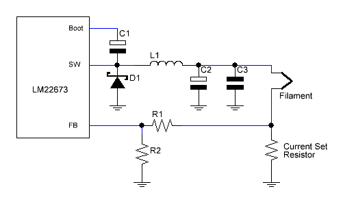

Hi Tom,
Does it pose any problem if I modify your regulator to regulate current mode like attached? This way I can easily change tha value of current setting resistor for starved filament operation. If you think that it is fine then which regulator is recommended to supply an 801A from the choice available in your store? Thank you.

I haven't tried running it that way, but it seems worth a try. With Rev. 3.3 of the Filament Regulator you have access to the feedback pin through Pin 2 of the output connector.
Pardon the belated response here. Somehow the email notifications from this thread stopped coming so I didn't see your post until now.
Tom
